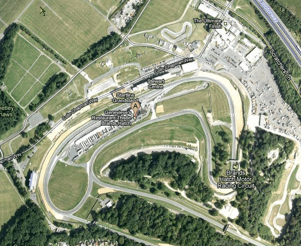

Top end of the pits, past where you did your noise check at trackday. And we shall be located by the trees on the far right of the picture, not far from the scrutineering bay.
Far end of the pitlane. Just follow everyone else. Lol
Yes, I remember where the noise test place was, which tree, a special one?
