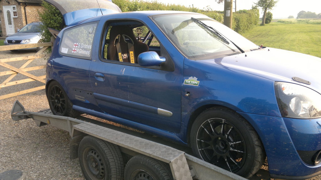

Moved onto the damage - drilled of the rivets holding the sill trim on - then noticed that I needn't have bought another as it would look OK with out. Damage there is just contained to a deformed sill and the floor pan is OK. Will just get it all pulled out to a reasonable standard.
Moved onto the door, the door hinges will require some re work as they have been punted in and up a bit (is reworking these even possible?). Guess if I was to do the work I'd just hammer from the inside and maybe a bit on the hinges to get level again. Door - got a new one.
Drivers wheel - fair bit of scoring - will get this on mates balancing machine to see if it's still straight - seems to be. Rub down and a spot of black paint.

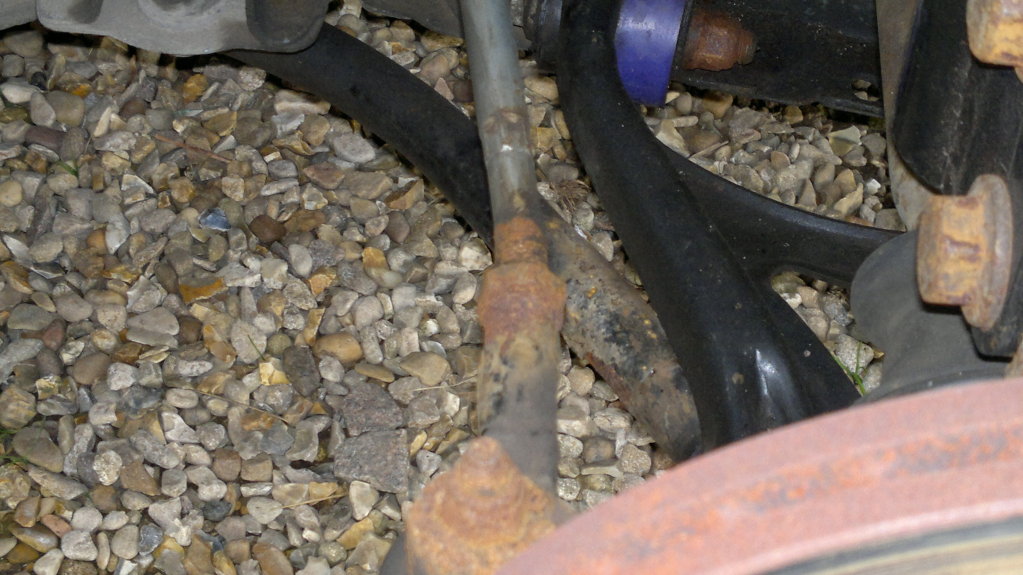

Before the impact the steering wheel was off to the right a bit whilst driving straight and after the impact noticed when Sam was going straight the yellow steering wheel marker was also straight - so wasn't surprised to find this;
Track rod and end a bit bent.
Looking around the internet, Eurocarparts for one, track rod and end seem to be around the £20 - £25 mark. Cheaper I suspect than OEM but up to the job?
Should I be looking for any other steering damage? Will get it all tracked etc after the new rod + end fitted.
Id be sticking with OE one mate, not sure what the non gen stuff is like. Renault ones arent that expensive iirc.
non genuine track rods are a touch shorter, but there's plenty of thread still used, and there's nothing wrong with quality
Genuine are £53.51 each

Pulled the sill out, quite a bit of a job as creased to France and back.
Hung new door so gap was same all round, knocked hinges out as both out of true.
Checked wheel over for true etc
Fitted new track rod, track rod end and bottom ball joint.
Painted sill (just blue no colour match, bothered...no)
Refitted sill trim.
All for £80....

If proper mates can't sort you out who can? Nice to see the car looking back to its former glory you wouldn't know what had happened to it.
Car is looking good again.
Nice to see that you got it sorted quickly and for not a lot of cash.
Yes, it's not been as bad as I thought getting it all sorted...
