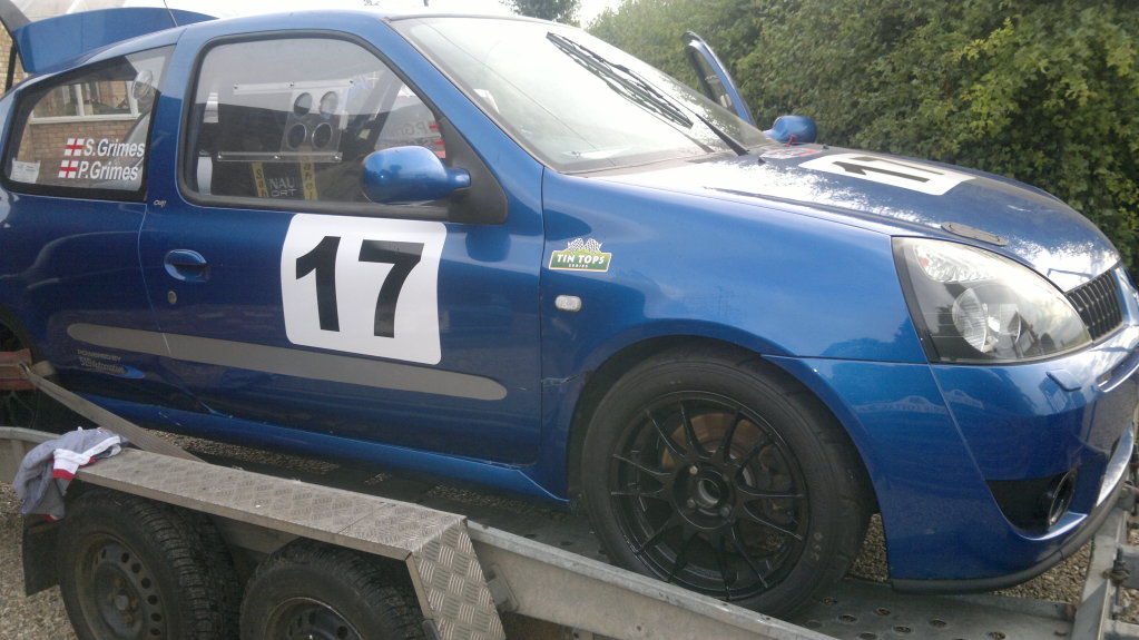

Brands damage all repaired - removed all door trim and replaced with a silver stripe, sliver is a bit dark but it covers up the holes left by the trim.
Go the pax seat back in and all that's left to do before Mallory on Sat is give it a clean.
