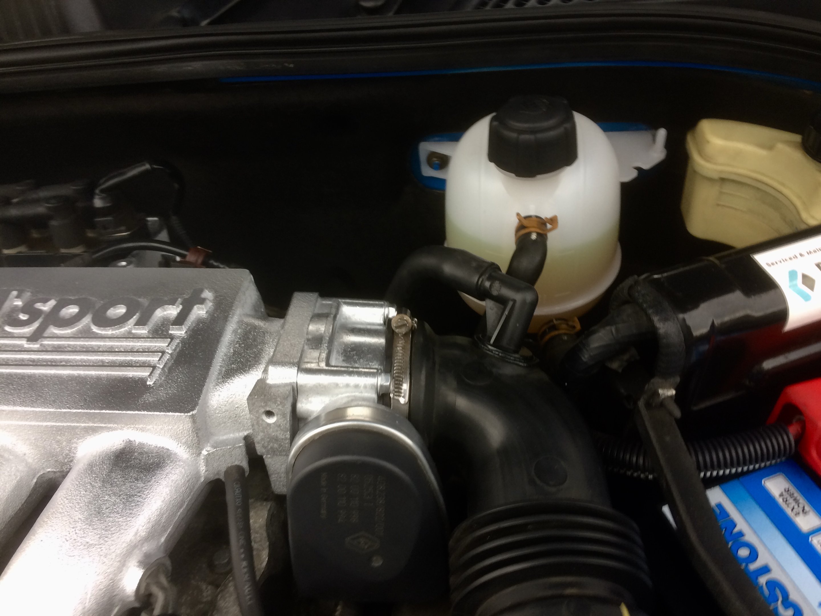

So my new coolant tank arrived this morning

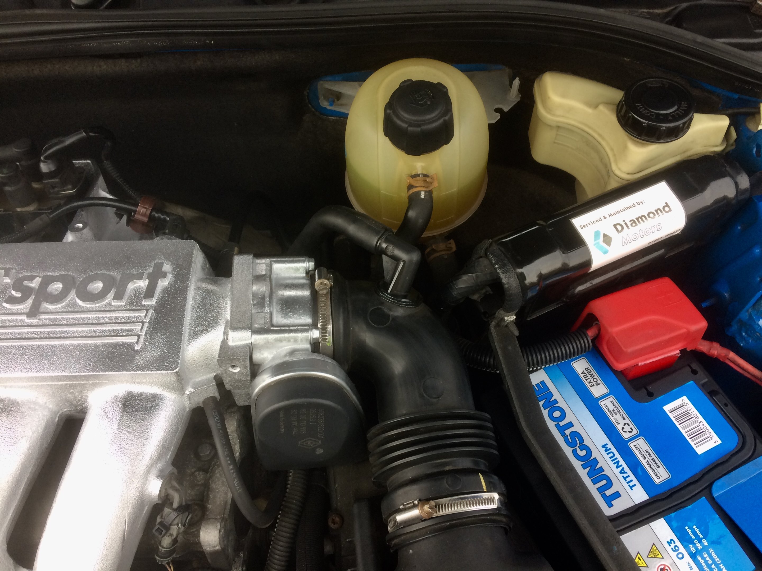

Old

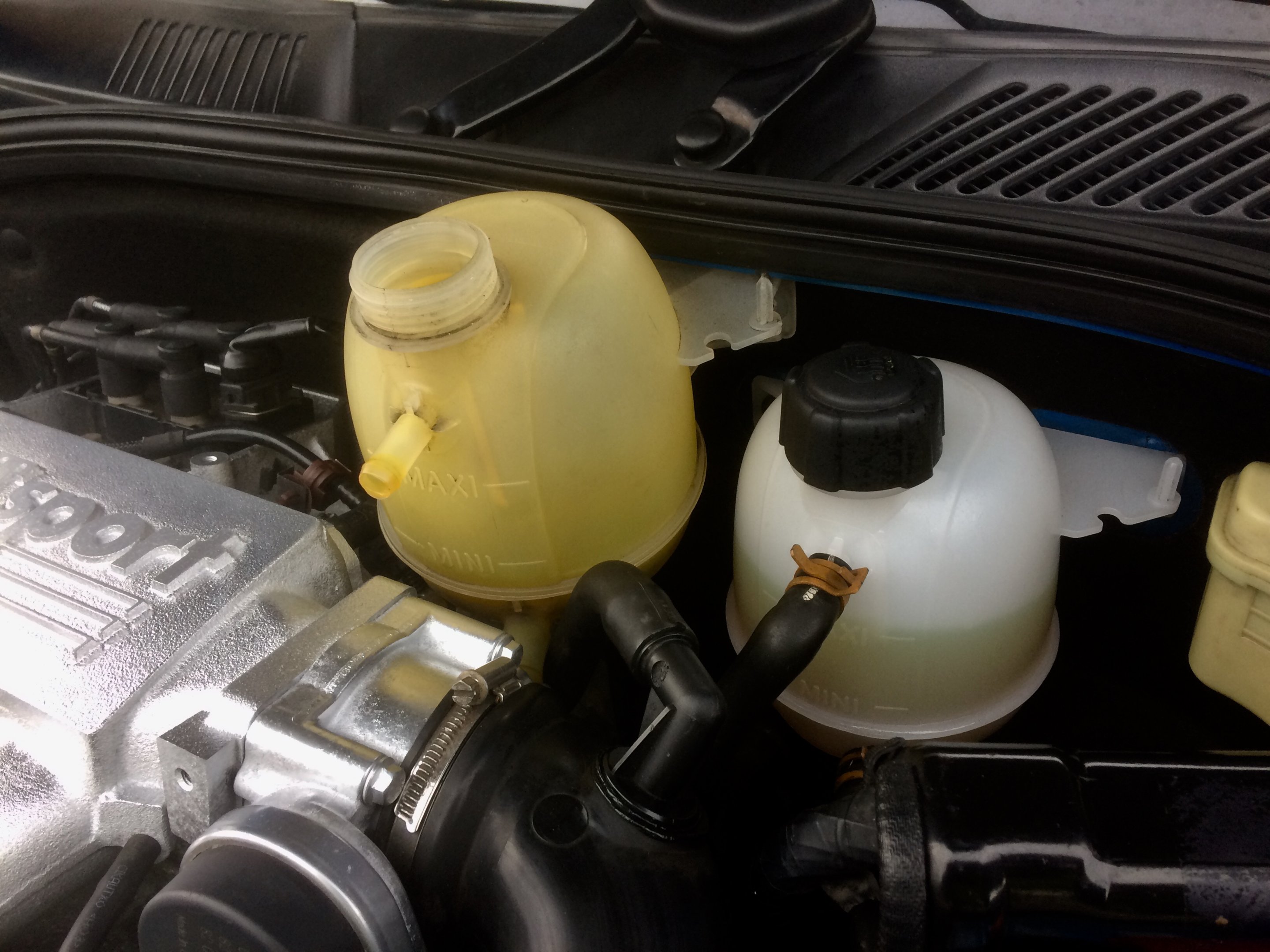

Comparison

No offence to diamond motors, but the sticker had to go, its also nice to see the ecu bracket in one piece lol

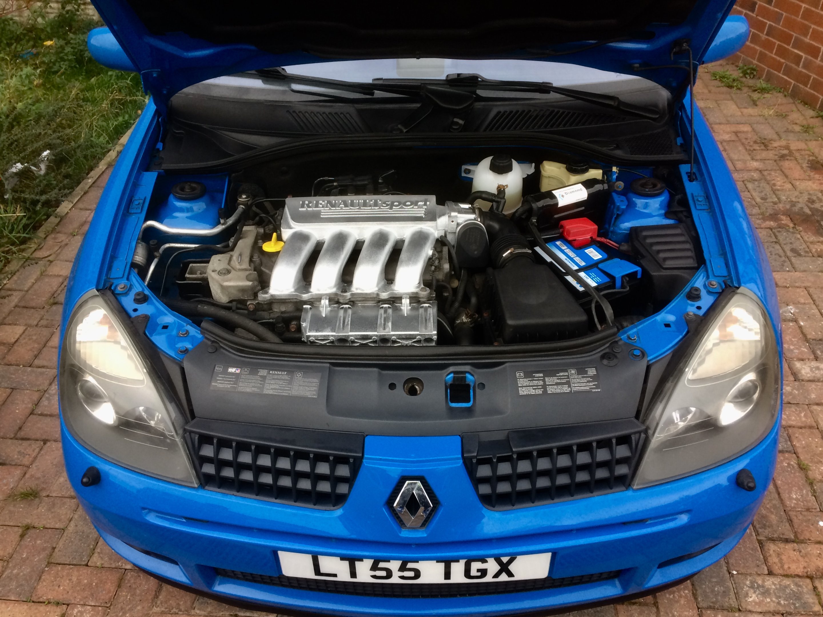

Looking good mate.
How'd you change the coolant bottle and how easy was it to do?
piece of piss mate, unbolt both 10mm bolts, remove top hose clip with pliers, pull off hose, then take tank off both bolts and lay it on its back so you lose no coolant, then take bottom clip off with pliers and remove the hose(zero coolant lost)
Pour coolant out of old tank into new tank, then refit in reverse.
Obviously the correct way is to change the coolant, but i forgot to buy some so this is how i changed the tank without loosing any.

That's some graft you've put in Tom. I've had my car 18 months and those jobs are still on my to do list[emoji23]
Haha cheers mate, theyre only small little things, but they make such a difference to the appearance.
New coolant bottle is like night and day with the difference, yet again small steps that make all the difference :up:
Cheers steve, yeah its well worth the money, itll look even better with fresh coolant :smile:

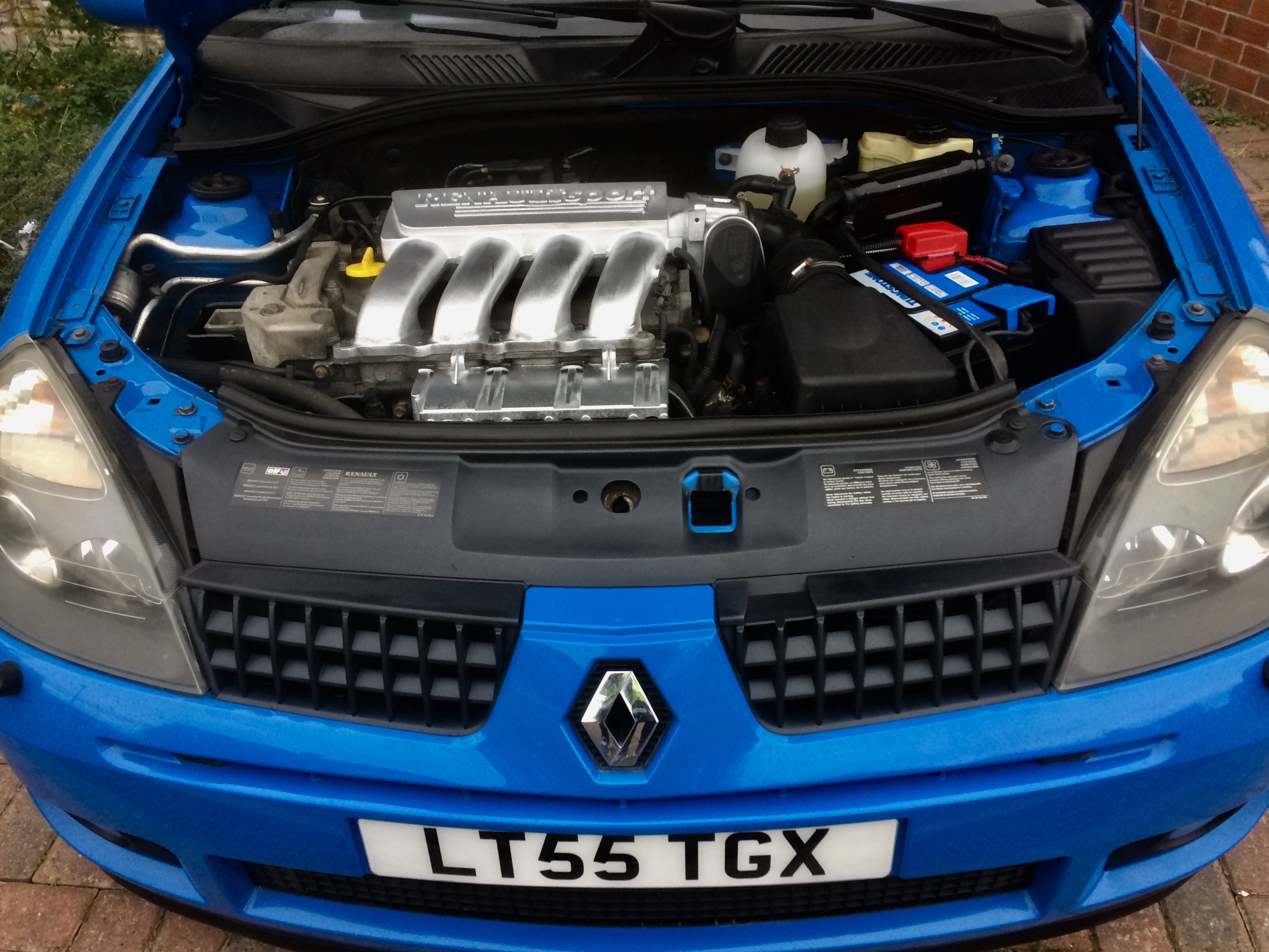

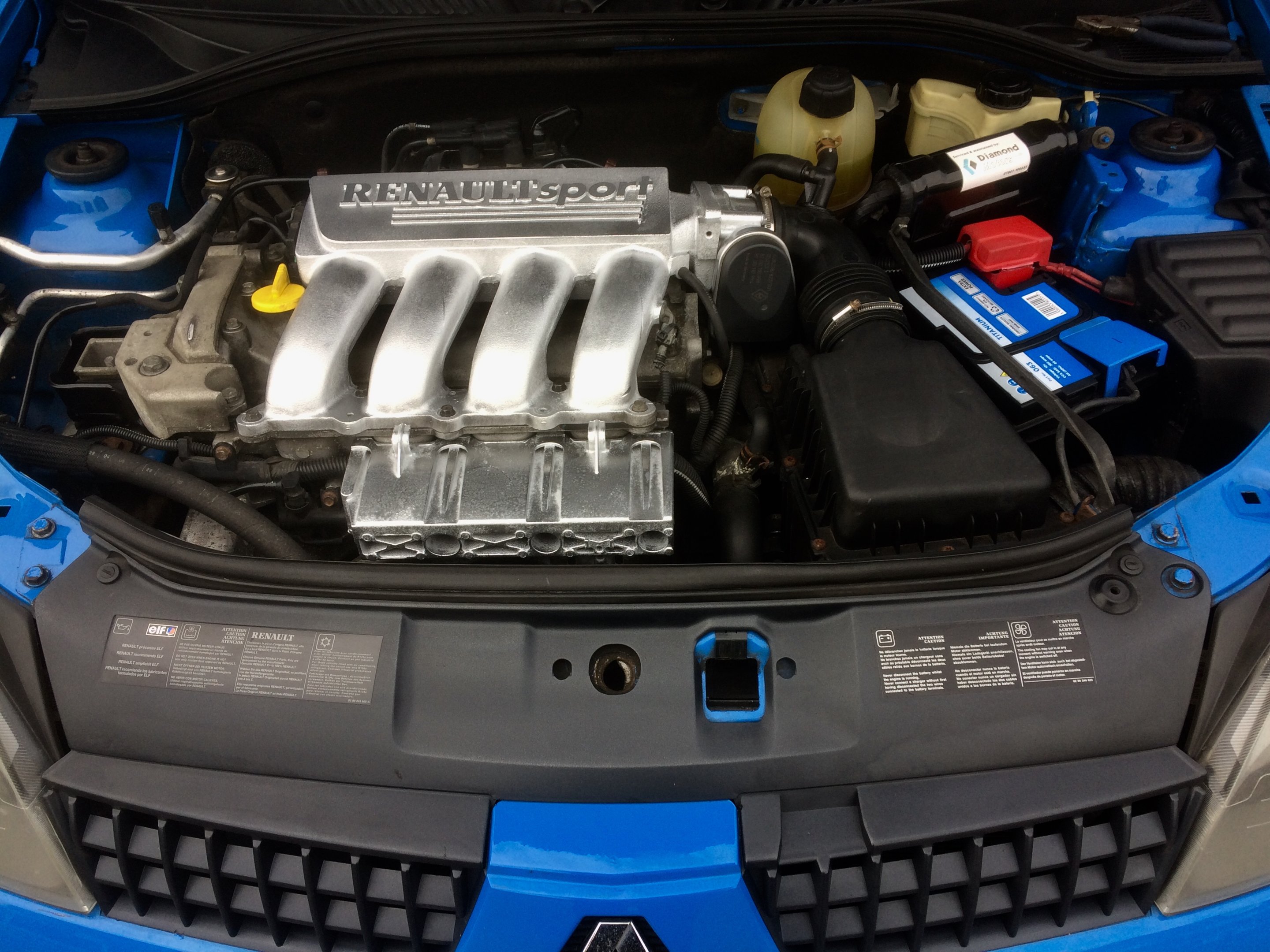

The inlet mani looks fantastic, what paint did you use if you don't mind me asking?
Has it darkened on the top because of the heat over time or was that your doing?
Hi mate, no its not darkened at all, thats just the shadows and relections from the bonnet carpet, it looks better like that tho haha, i used halfords chrome paint, its really shiny, not quite chrome, but shinier than silver, itll look better when i do the engine brackets and rocker cover etc so it all matches :up:
