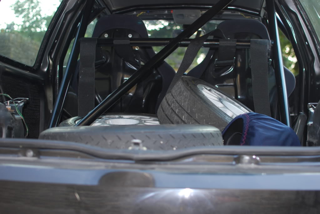

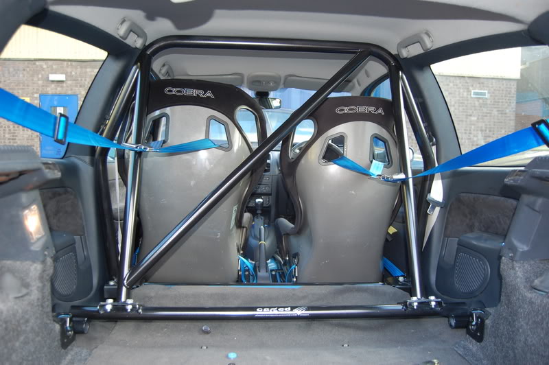

The Cage as fitted to Kev's 182 Clio -

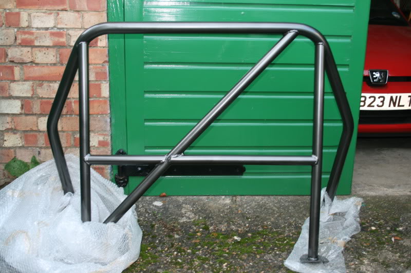

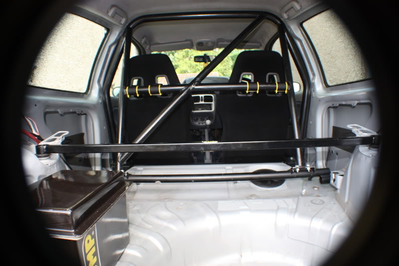

And the Cage as collected from Tom, ready to go into my Silver 172 Cup -

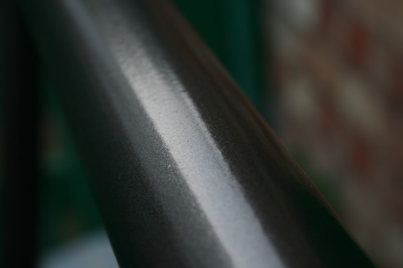

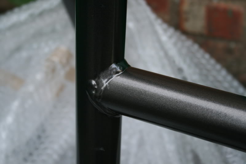

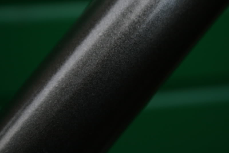

Tried to get a photo of the finish, but its a bit difficult -

Nice. Seen that a few times, why are the harnesses fixed to the back mounting points and not the ground?!

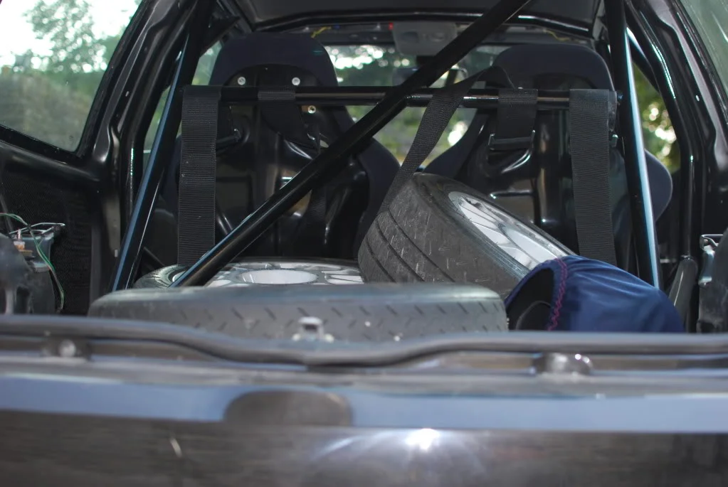

Adam, What harnesses are you running?

How will the harnesses secure to the bar, just buy a loop through fastener and cut the ends off the harness?

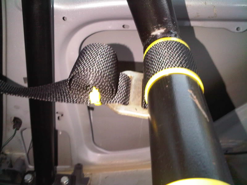

heres a closer look at the harnesses they are just 2" omp ones i want to upgrade to 3" soon though

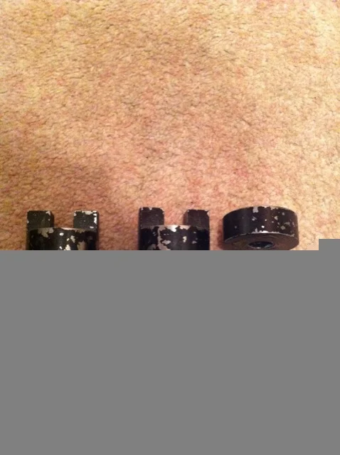

if you want i can try get some better pics tomorrow of the fixings ect... i had to put spacers inbetween my cage as well as its to small to reach across i will get photos tomorow to show what i mean.

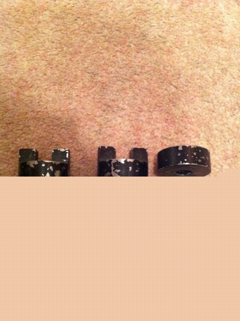

That would be great if you could mate, I have some 'spacers' that I presume go on the subframes somewhere
big spacers go on the rear subframe with the longer bolts, the smaller ones on the front with the shorter bolts.
You need to just nip one side of the subframe piece into the thread, then do the other side, then do a couple more turns so they are in but not tight. Repeat with the other subframe piece. Then fit the cage, which will square the subframes up so you can tighten it all up :)
It doesn't look like it will tighten up at first but once the cage is on it all comes together :)
Do the spacers go between the subframe and mount point or on the 'outside' of the subframe?

J, I've got those exact harnesses, they can be wrapped round the bar with no problem.
Be warned though, they have a specific way of being threaded through the buckle that will make mensa seem like the sun crossword!
