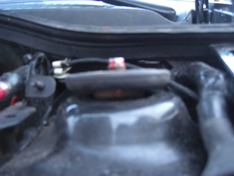

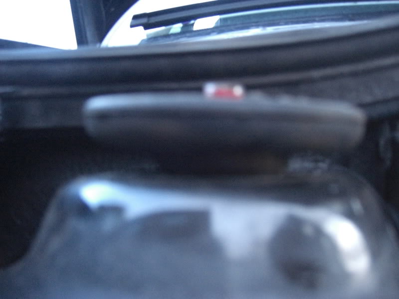

I've just fitted my Apex front struts and the top mounts seem to be very 'unsecure'. It also make a big scraping noise when I go round corners. When I turn the wheels, the top mount turns with it and lifts up slightly. Pics of top mounts when on full lock:
As you can see they don't fit into the place they're supposed to, which is quite bad. Any ideas where I've gone wrong?

is it on both sides mate cos it happened to me on one side and we just changed the things around and it sat much better ever had any bother since

Both sides yeah, it's only that big when I turn it on full lock though.

lol, you muppets the top part of the top mount is not supposed to be flush with the panel, they will change their height depending on steering lock it's perfectly normal.
What's making the proper loud noise then? Can someone take pics of theirs that are normal so I can compare how much mine's stuck up with theirs?

When I screw mine as far as they will go, they stick up approximately just under a centimetre from the base they should be flush with.
Is this a problem with my suspension then? The top mounts were fine on my standard struts, since I changed them to Apex they've started doing this.

Air gunning the fucker up will only f**k the mount. The top half is nylock and it's only purpose is stopping the damper falling out of the body when the front end unweights (air over a hump back bridge etc) rest of the time the weight of the car is acting down on the bottom part. So as I said no need to wind it up FT with a scaffold pole or airgun. ;)
