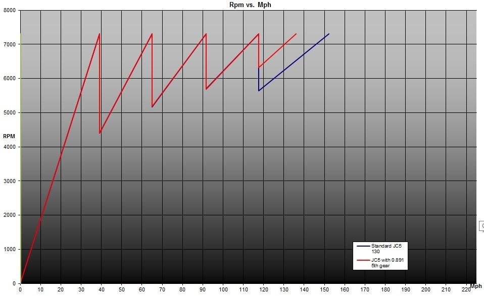

Something I put together a while ago for my PH1, may be of help.
CarPowerWeightP/Wdrag coeRev limitratio 1ratio 2ratio 3ratio 4ratio 5ratio 6ratio 7FDWheel diam (M)
Clio
165​
1.035​
159.42​
0.358​
7250​
3.09​
1.86​
1.32​
1.02​
0.79​
4.07​
0.576​
MPH
38.90​
64.63​
91.06​
117.85​
152.16​
Hollidog
  182
This is from the PMS website, seems to be accurate to me, ignore the last red line as this relates to installing the 5th gear from a Megane box.
Clio
165​
1.035​
159.42​
0.358​
7250​
3.09​
1.86​
1.32​
1.02​
0.79​
4.07​
0.576​
MPH
38.90​
64.63​
91.06​
117.85​
152.16​
Was this for a 15" wheel?
  LY 220 Trophy+IB PH1
