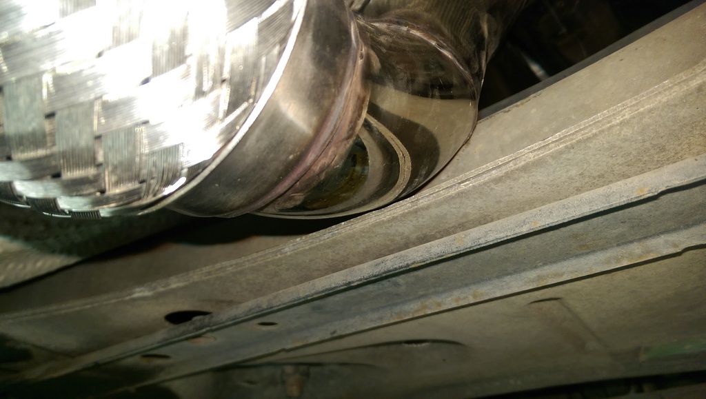

hi all,
i purchased a toyosport manifold to replace the standard as the flexis had gone on the original, got it fitted friday and had a call to say there was a problem with how close it comes to the crossmember touching on idle. i have uprated all the engine mounts to powerflex to remove the roll from the engine as i had been advised to do. how have people tweeked the manifold to fit? can it be done on the car? any advice appreciated thanks james
picture below to show how close it has become.

Surely adjusting the upper engine mount ( torque arm ) a few mm, would move the engine a few digrees, to give the clearence needed.
Will be in contact with toyosport tomorrow as they've messaged me saying heat the manifold and bend it to fit the mechanic has said he will but I first want to know if they'll except the manifold back if this doesn't work (cracks) as I don't want a shagged manifold and them not to accept it back

Ive got a similar problem on my 197, tapping off subframe with a new aftermarket manifold i put on. My old manifold i scapped though as it was cracked all over the top but i really need this sorted! Have any luck with yours or did you put the kriginal back on?
in the end i got it heated up and bent away from the subframe has stopped it rattling under idle but very heavy load when the traction control kicks in it can still hit which is a bit annoying.

Ive just had that done to mine now, heated up and bent in but still no difference tbh.. Are the engine mounts expensive to change? See if it has an effect if i replace them.. What a carry on mind! Haha

I'd just sack it off chap, they're utter shite! Next thing is you'll replace the mounts (at around £200 in parts) and then 12-18 months down the line the shitty Toyo will have broken somewhere (Normally at the slip ring joint to the Post-CAT) or it'll knock its tits off and drive you insane to the point you get rid of the car.
It's not cheap but just swallow it (I tried that line with the wife on Monday and got shot down)
mines already blowing its tits off and under full load (heavy acceleration) it hammers its self off the cross member even with bending and all 3 engine mounts+ gearbox mount.

At the minute, the KTR unit is looking like the best alternative to the Renault unit, which is double the price and still nigh on impossible to source. The only other alternative is to replace broken flexible sections on your existing manifold.
What ever you do though, replace the worn engine mounts as they are the reason the manifold has failed
