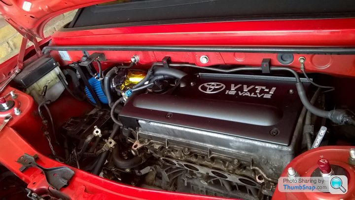

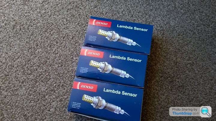

So after Brands Hatch on Tuesday and on our first lap we had hesitation under load I disconnected all the O2 sensors and the car ran ok all be it running rich .

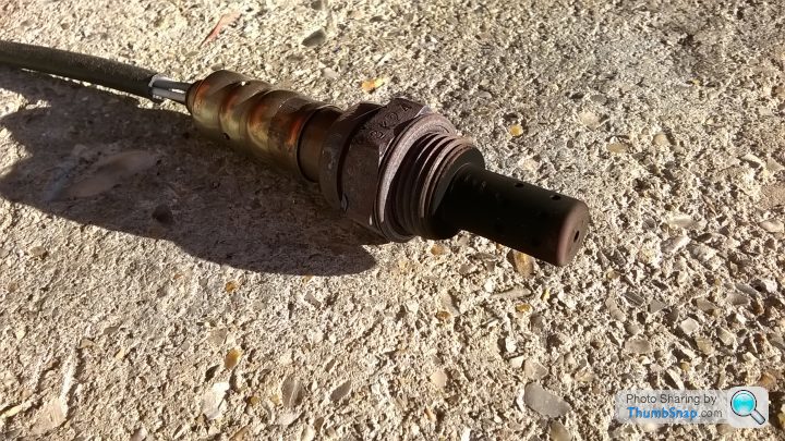

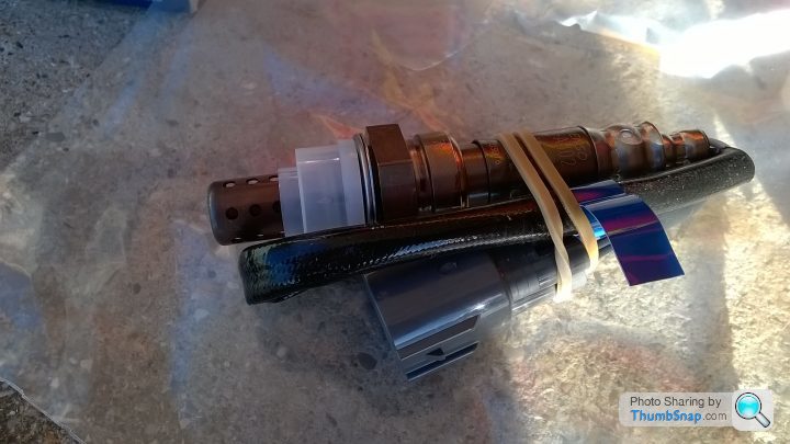

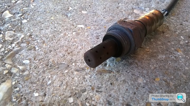

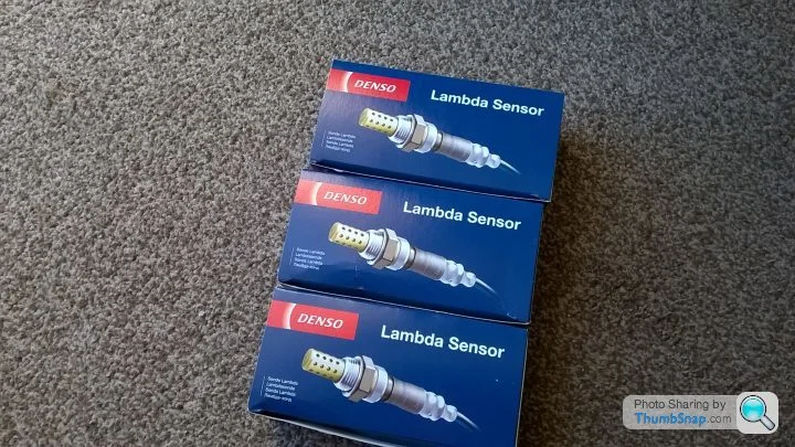

Yesterday I replaced all the x 3 O2 sensors with some new Denso units and tonight will give the MAF sensor a good clean change the spark plugs to see if this will fix the problem .
New Denso units
Old units
We are off to the Ring on Monday so if this does not work I will look to just run the car with them unplugged again as im out of time on this one .
I hope to get some better luck soon

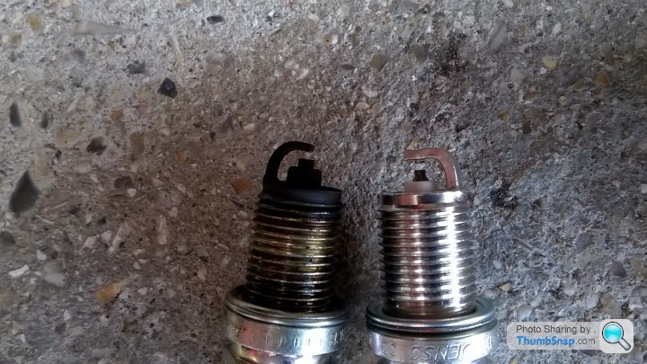

The car was playing up after Brands hatch so with no time to look in to the fault ( hesitation under load ) I thought this should be a falling O2 sensor so replaced all x 3 of them and new spark plugs as well and gave the MAF sensor a good clean .
Old and new spark plugs ( car was run with the O2 sensors disconnected so was running very rich )
The car was still playing up now and then but cleared after about 10 mins and was running well again .

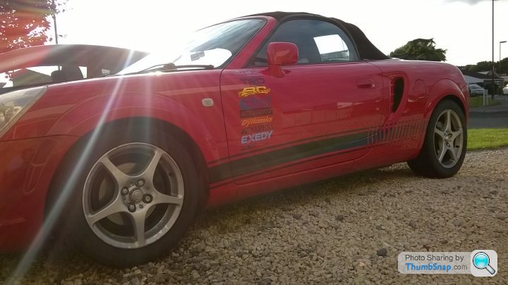

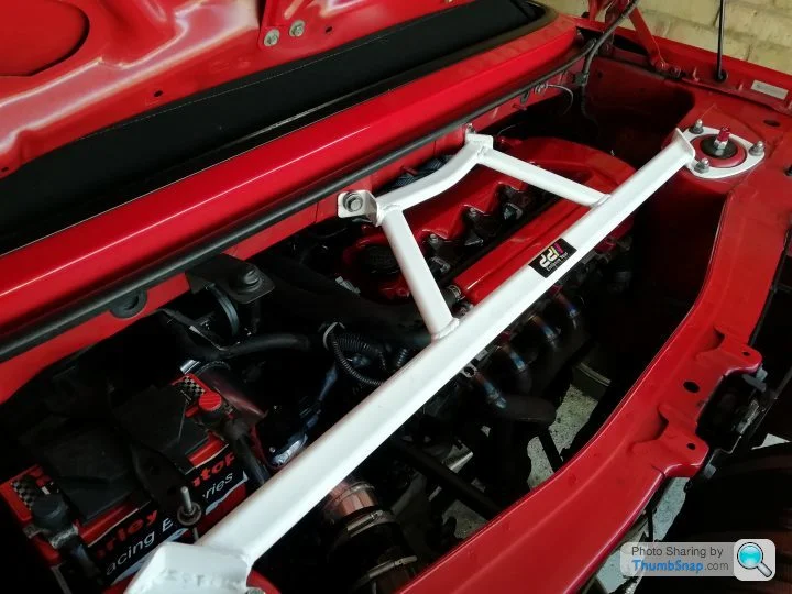

Small update to the car in the form of the front was sitting a bit hi on the stock coilover right height and with there being no weight at the front I have dropped the front by 25mm that should help the front out as it was sitting with the nose up a tad .

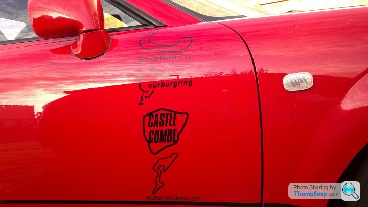

Also had a bit of fun with some decals ( some to cover the small dent where I had a little off at Castle Combe ) to give the car a bit of colour and keep a list of the tracks we have done so far .

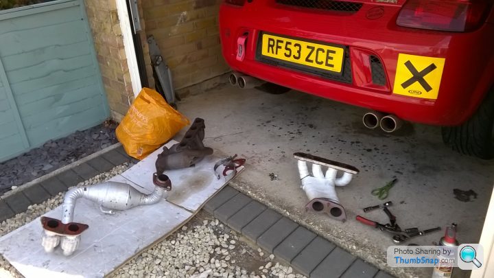

Few pics of the car being stripped of 1ZZ parts to sell .

I have been thinking about this on and off and was looking to do this myself but though I would get this done correctly .
£ 500 sounds like a great price as the donor Celica I have got for the swap is £ 1200 ( 72000 miles 2006 reg )
I still don't think im at that point with the car where more power is needed as I think my driving skill and experience is still fine with the 1ZZ in the car ( 140 BHP 125LB/FT 900 Kg 0-60 7.5 ish ) but it will be something I will want in the future so I thought now would be as good as time as any .

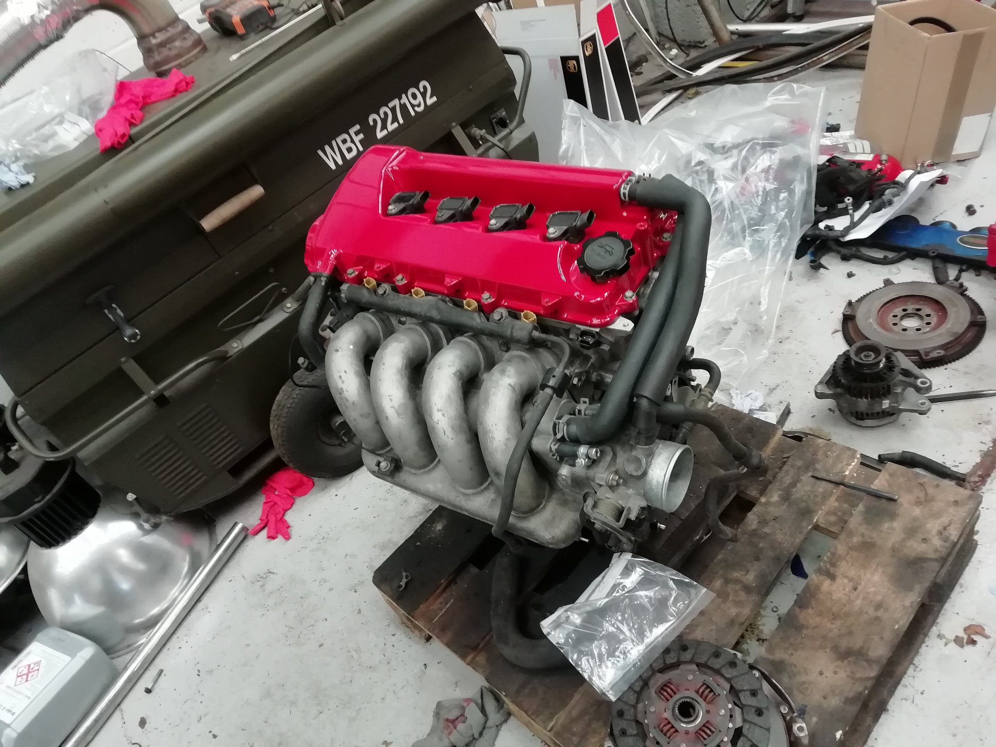

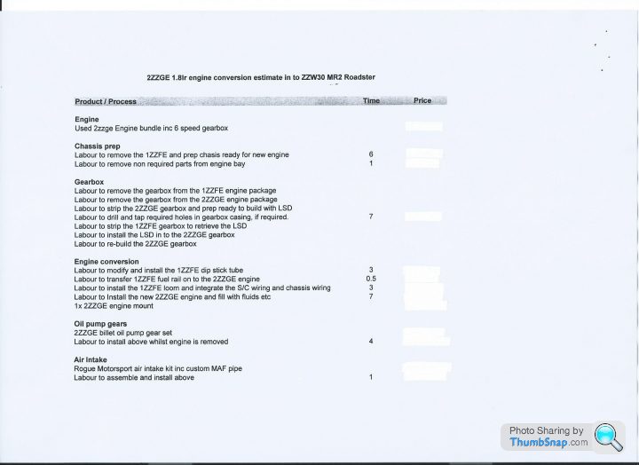

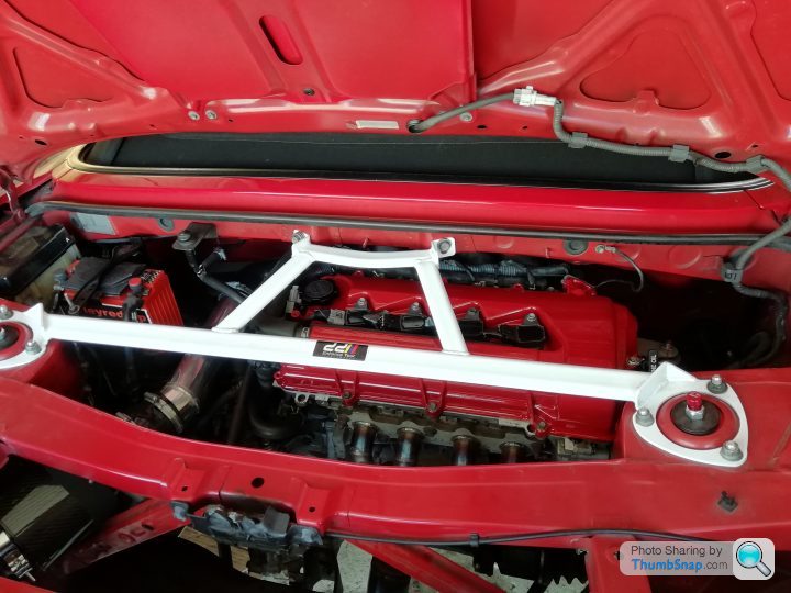

Update time

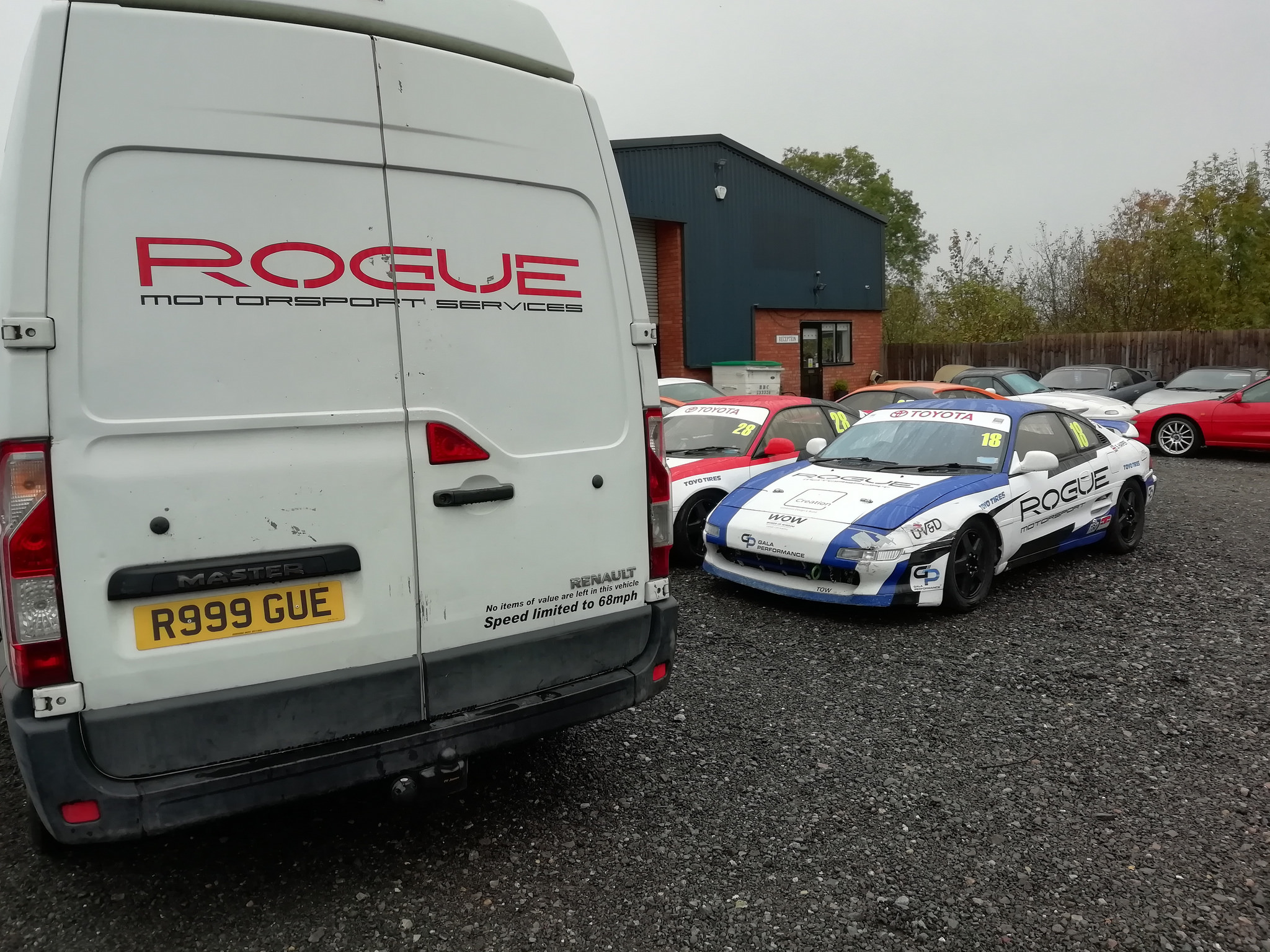

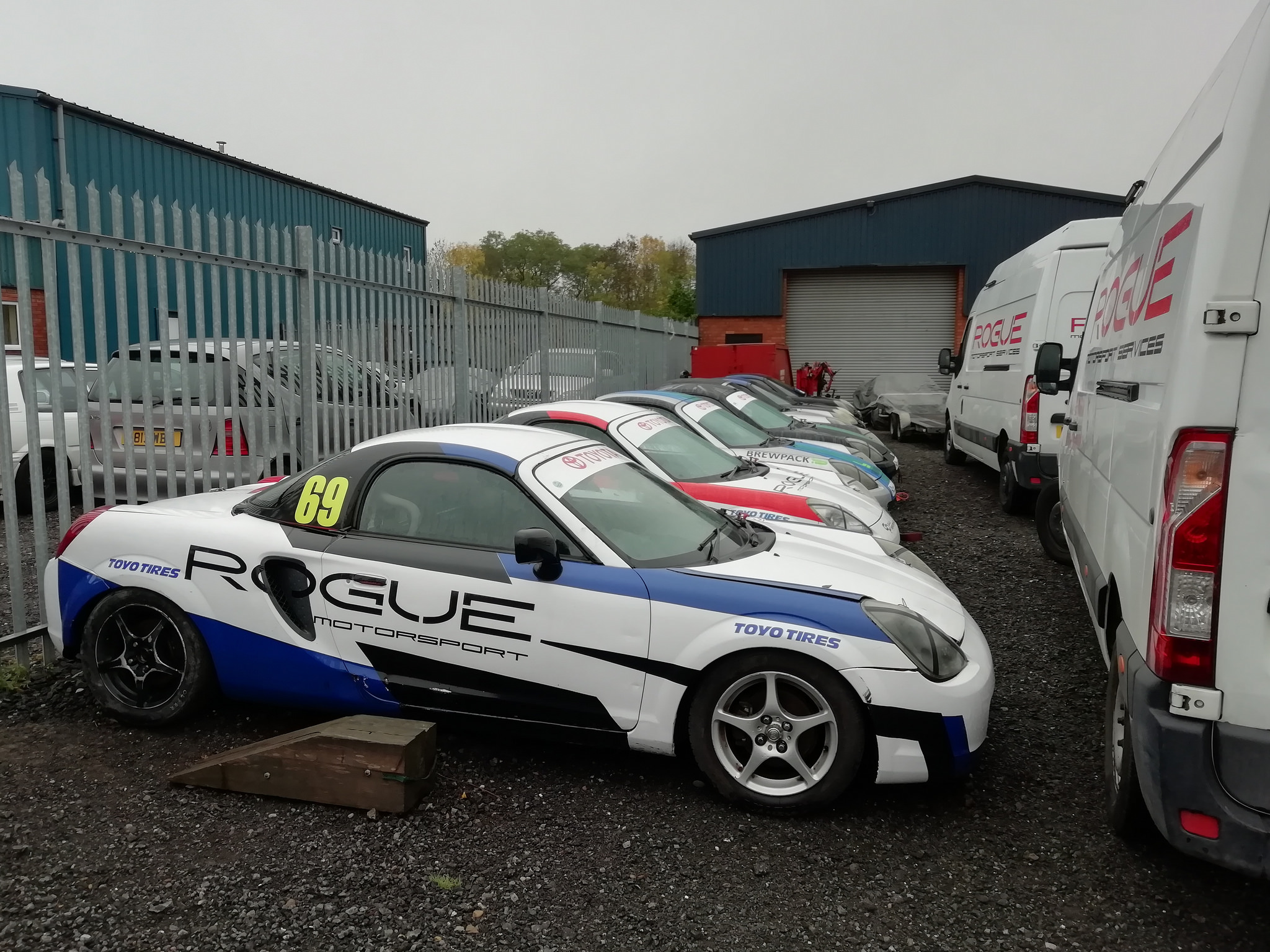

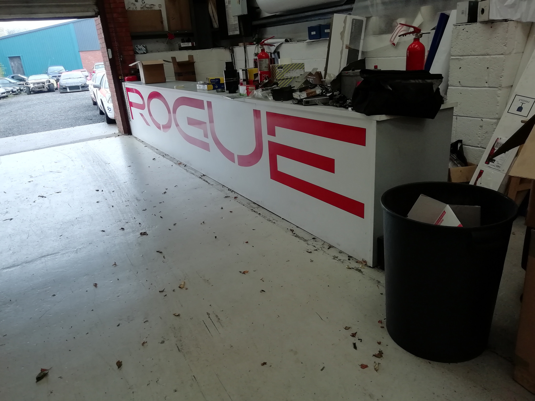

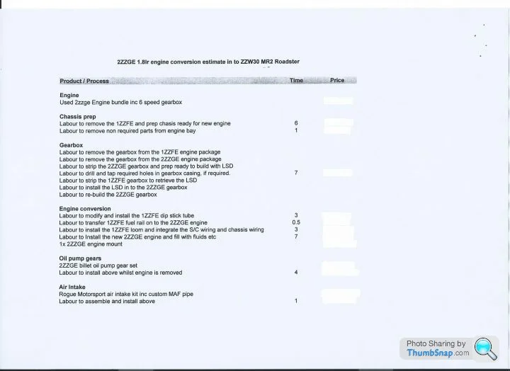

Just got back from dropping the car off ready for the engine swap and a few other bits at Rogue motorsport .
The old 1ZZ engine is coming out along with the old C63 gear box then having the LSD removed from the old C63 gear box to be used in the new C60 close ratio gear box .
The donna 2ZZ engine and gear box is from a Celica with 62K on it and has been inspected and new lift bolts installed and the rocker cover painted .
The oil pump gears have also been changed for stronger billet units and the flywheel has been changed for a lightweight competition clutch unit .

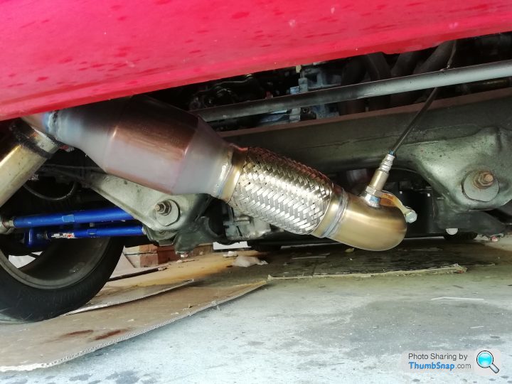

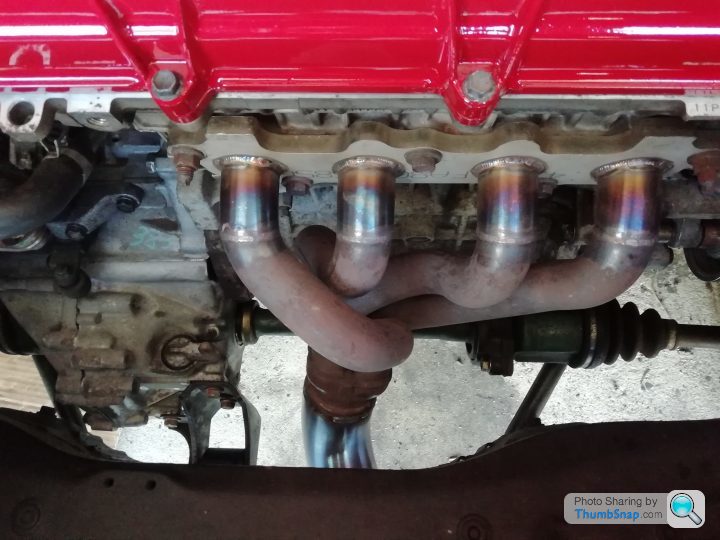

The final part will be the 4-2-1 custom manifold and 200 cell sports cat .
The new engine ready to go in .
IMG_20181016_102455 by Alan Kaveney, on Flickr
A few of the other cars at Rogue

Pick up will be next week and yes they are using the Celica ECU and all the other bits for the conversion not cheep but will be worth it .

I hope it will all be fine as instead of doing it on the cheep or with an ok company I have gone the hole hog and gone with the expensive option along with changing a few bits on the engine like the oil pump but nothing is bombe proof .

Big update time
I dropped the car off at Rogue motorsport to have an engine swap done so taking out the stock 1ZZ 138 BHP unit and putting in the 2ZZ 190 BHP engine .
For those that don’t know Toyota did two ZZ engines a 1ZZ that had 138 BHP and 125 LB/FT 7000K RPM and was more for economy but still a nice revving thing and then the 2ZZ with 190 BHP 135 LB/FT 8200 RPM
That was developed with Yamaha and is a copy of the Honda Vtec system and have the race style cams that come in at a given engine speed and was used in the T sport Celica , Corolla and Lotus Elise and Exige .
https://en.wikipedia.org/wiki/Toyota_ZZ_engine#2ZZ...
I was also having the close ratio C60 gearbox installed that has shorter gears and final drive and also having the LSD transferred from the stock gear box .

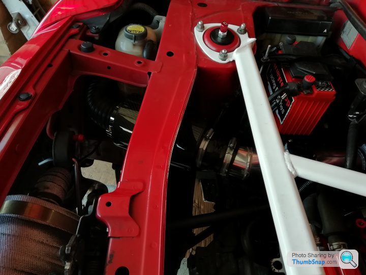

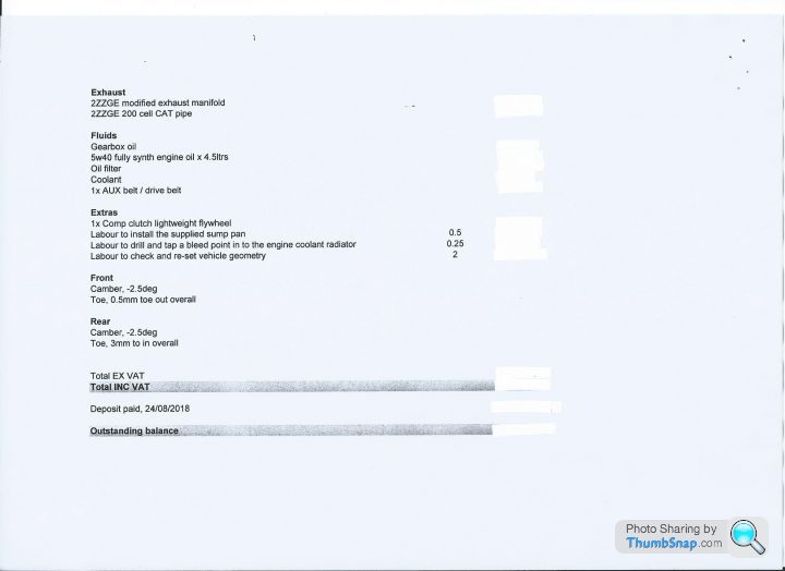

I also got the below bits done as well .

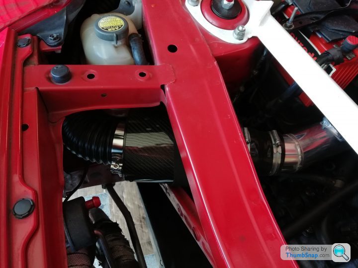

Billet oil pump gears ( the stock oil pump gears are a week point and can fail esp if the car is used on track a lot )

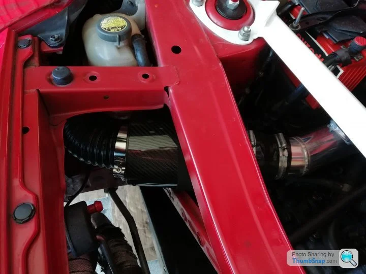

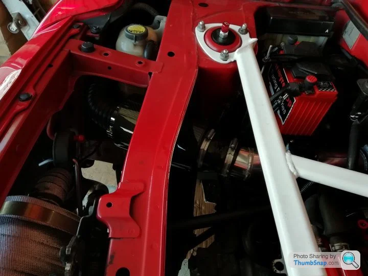

BMC carbon induction and MAF inlet pipe
Transfer of my baffled sump on to the new engine
Competition clutch lightweight flywheel 5.4 Kg

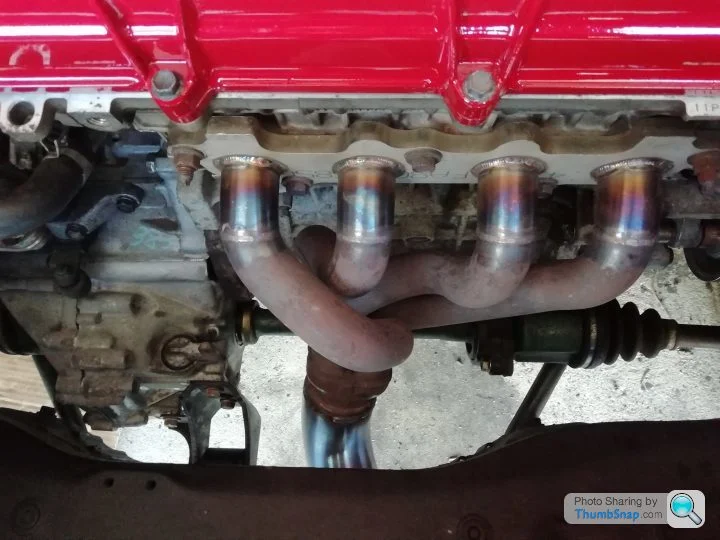

Rogue 4-1 exhaust manifold

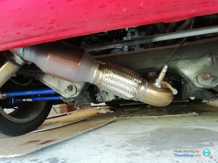

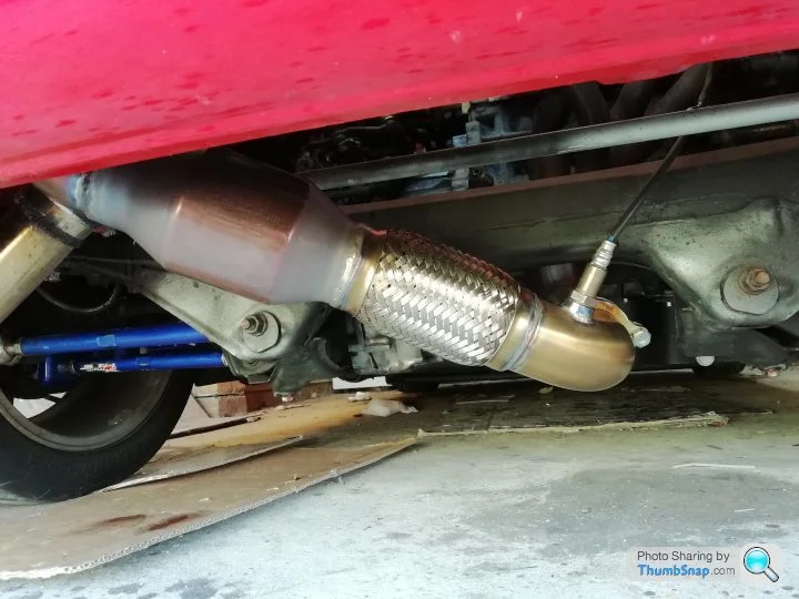

Rogue 200 cell sports cat

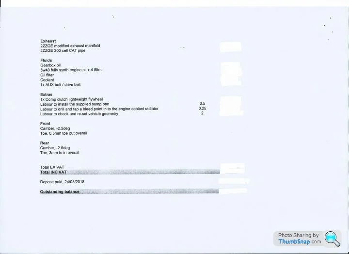

Geo set up below
Front – 2.5 camber 0.5mm tow out overall
Rear – 2.5 camber 3.0mm tow in overall

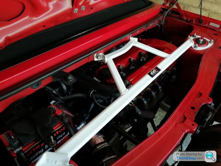

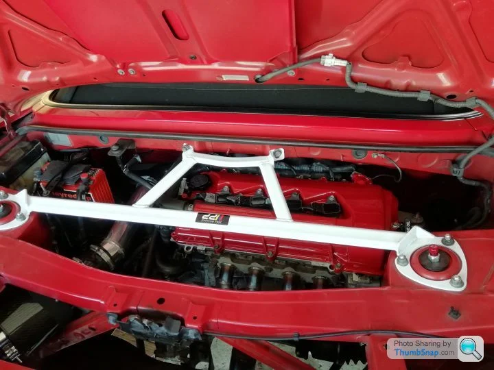

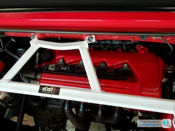

Some pics of the engine
Pic of the induction set up
Pic of the manifold
Pic of the 200 cell sports cat
And the build sheets
Impressions so far is that then engine is very different from the old 1ZZ even before the 6200 RPM lift change over it is quicker revving and the pickup is a step up from the 1ZZ unit .
At 6200 RPM when lift is engaged the car really picks up and feels much like some of my old Honda units that I have had in my Accord ( H22A ) and the Civic EP3 ( K20 ) and even with the enclosed induction the induction noise is very nice .

On the Geo set up I think this will be just about right for us to start with as we need to learn the car more and get more experience .
