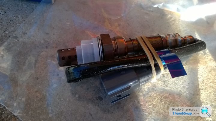

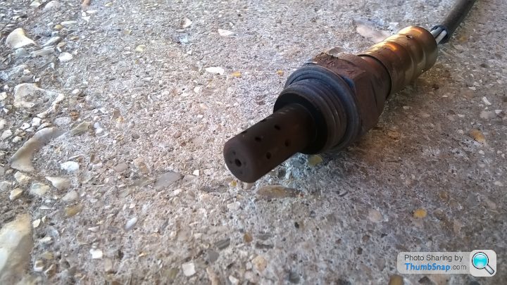

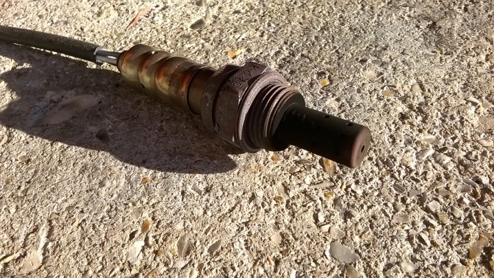

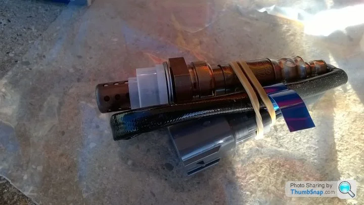

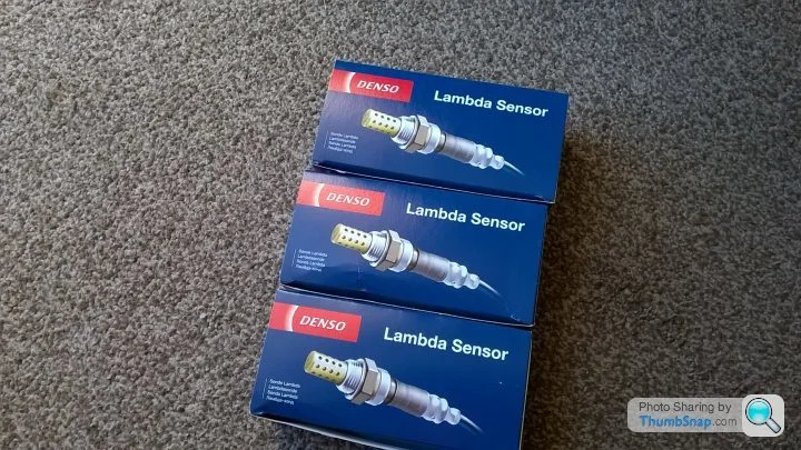

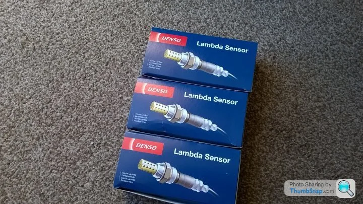

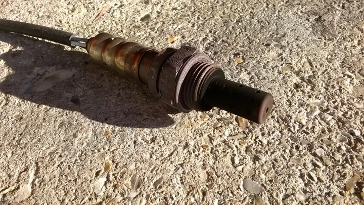

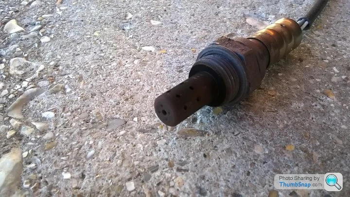

Small update when the car went in for the engine swap I removed the new O2 sensors and have now installed them in to the new engine but the new set up only uses x 2 one pre cat and one post .
New Denso units
Old units

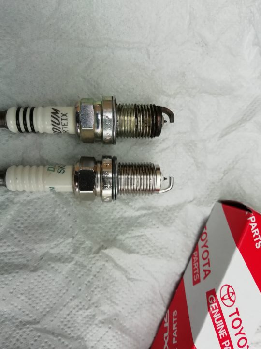

First was to change the spark plugs that to be fair were nearly new from the engine swap but as I have them I change them anyway .

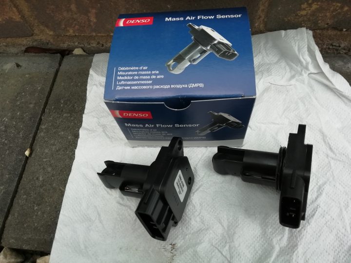

Then as the old MAF sensor was used from the old 1ZZ engine I thought I would get a new fresh one to go along with the new O2 sensors .

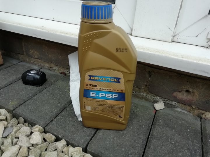

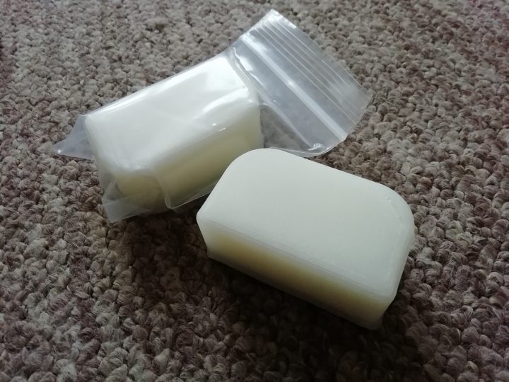

Next up was the E-PSF that I did a quick flush and top up .

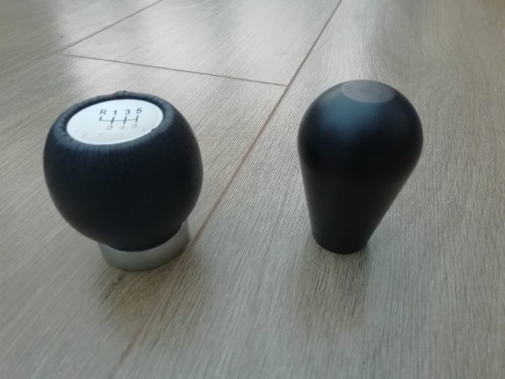

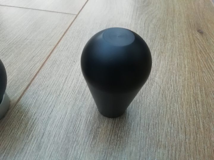

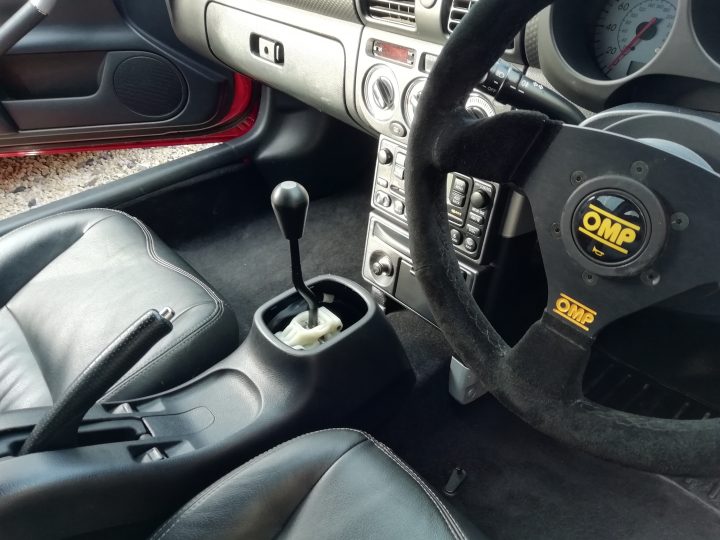

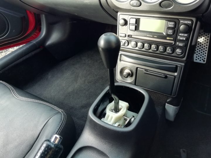

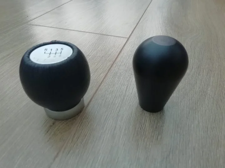

Then was on to change the gear know for a smaller nylon unit .
Old and new
Installed

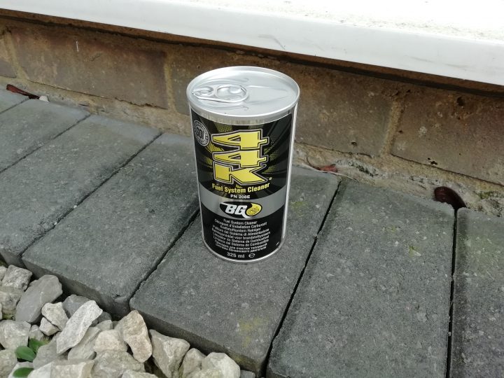

Then was to put in some fuel system cleaner BG44K as I have used this before and rate this stuff .

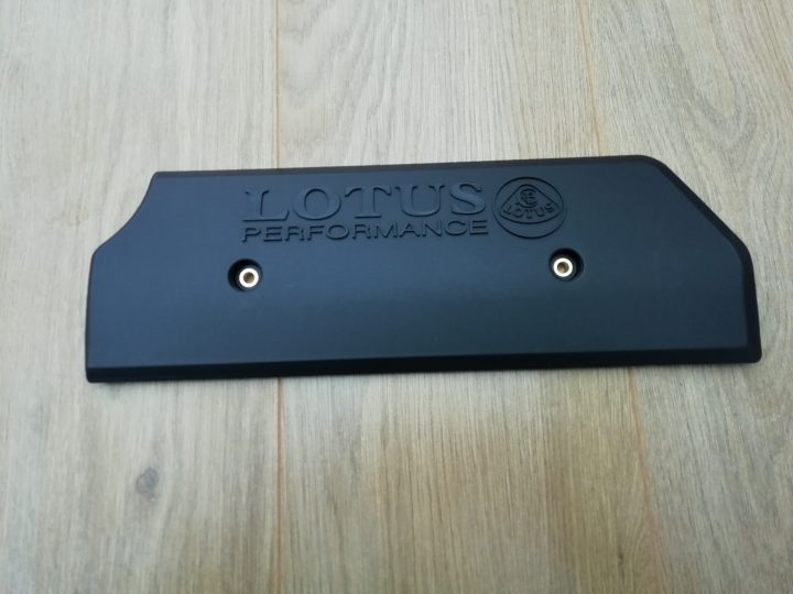

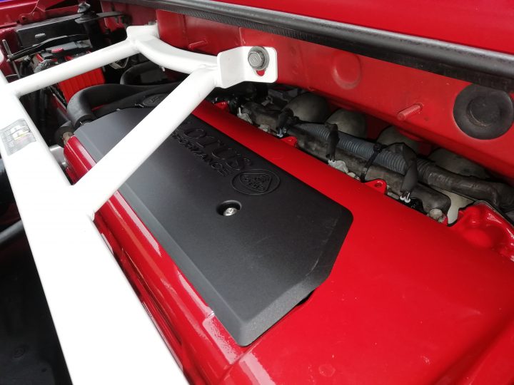

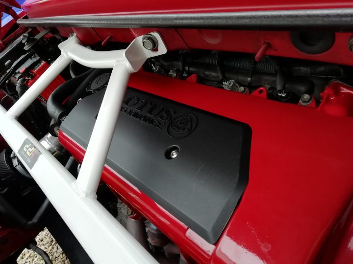

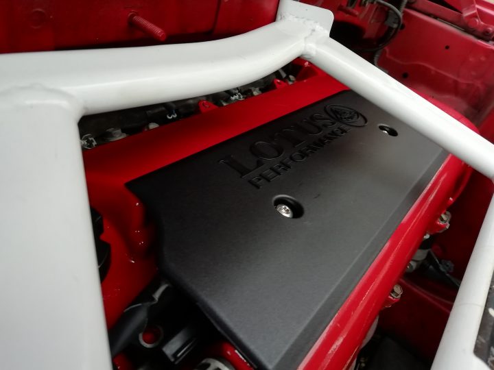

Last of all was to fit the Lotus spark plug cover .

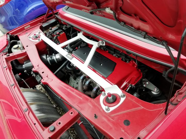

As the 2ZZ was never used in the MR2 when the conversion is done the coil packs and spark plugs don’t have a cover and water and get in so this will be a good little cover and looks nice too .

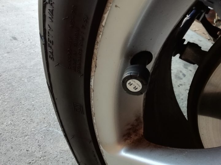

Another small update in getting the car ready for this year’s track season .

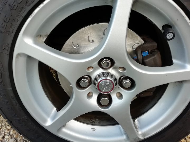

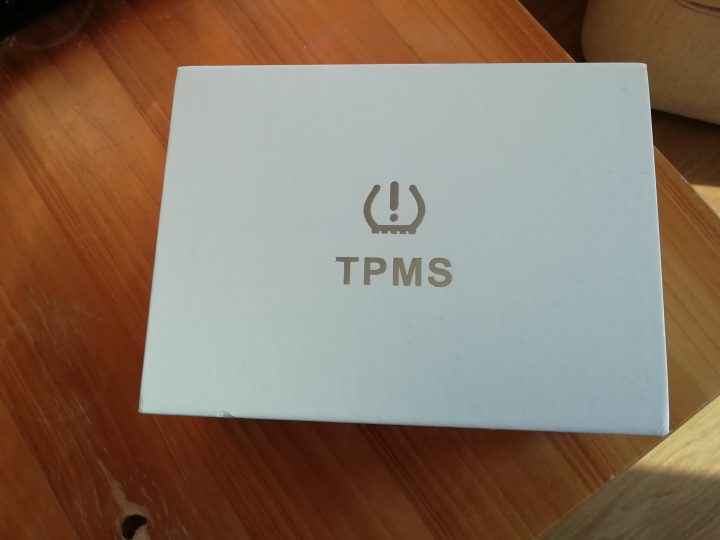

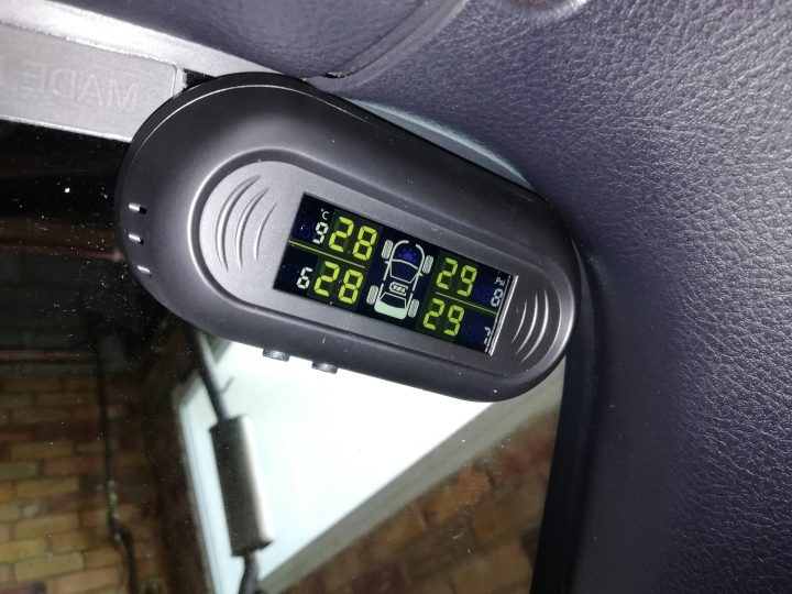

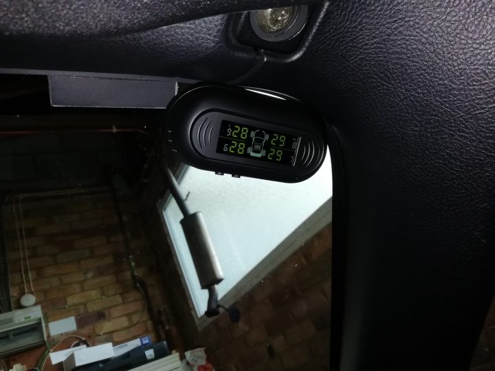

I thought it would be a good plan to have a TPMS so I can check pressures and temps but wanted something small that would not get in the way so I have located it at the top of the window .
Next up will be an engine flush new oil and filter fresh brake fluid then book some track days .

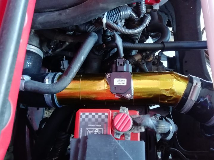

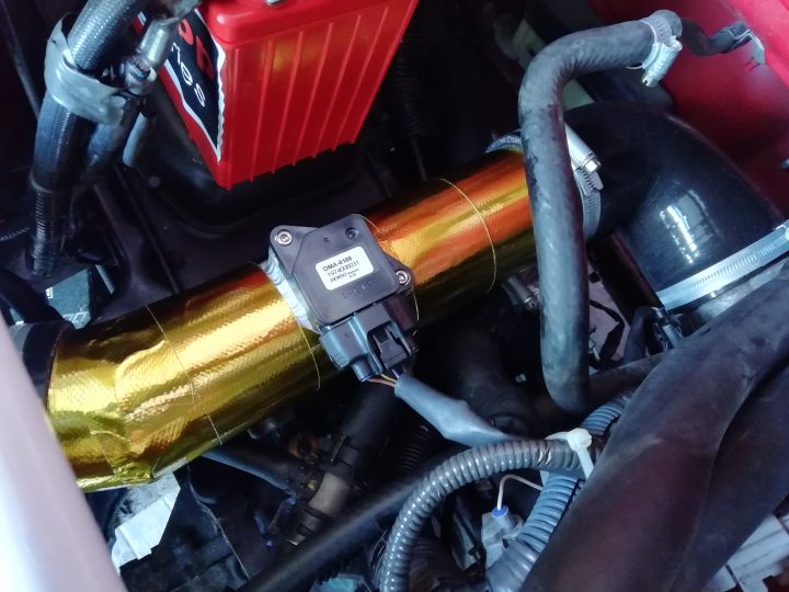

Then as I still had some DEI gold heat tape left over I thought I would wrap the metal induction pipe to help keep the intake temps as low as possible .

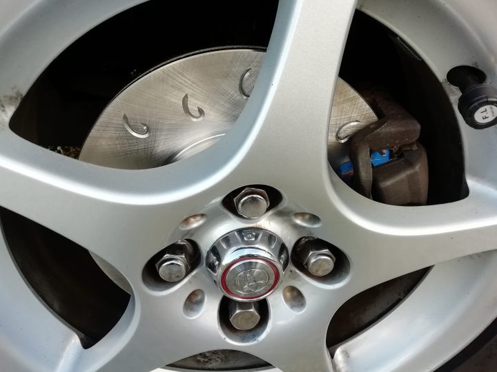

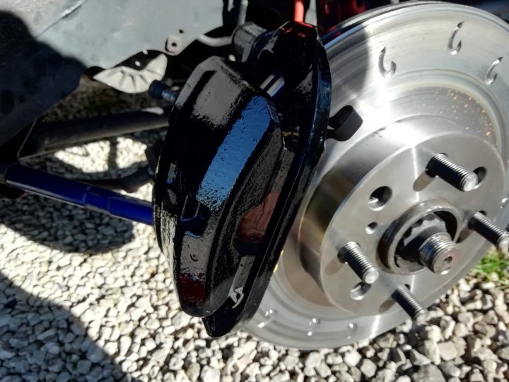

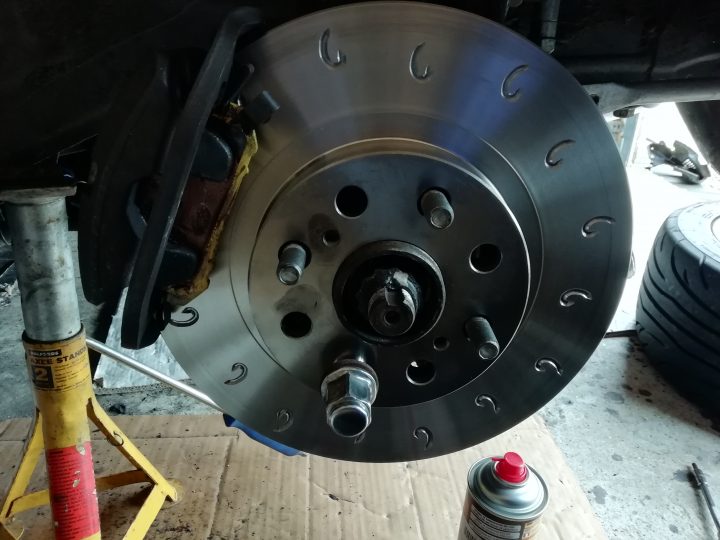

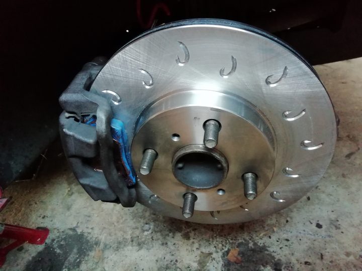

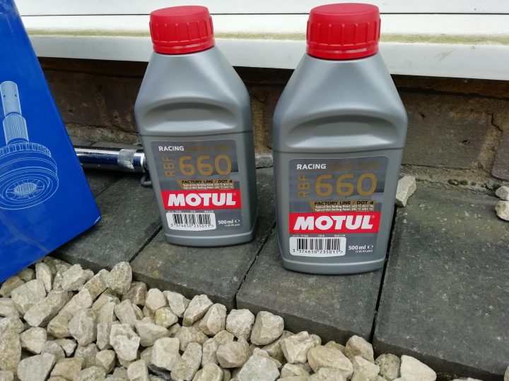

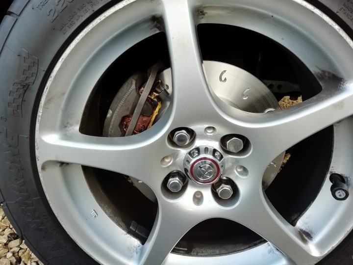

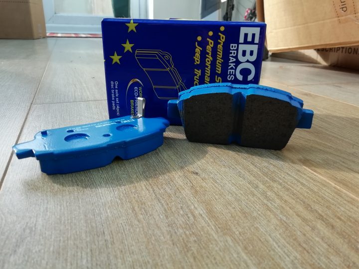

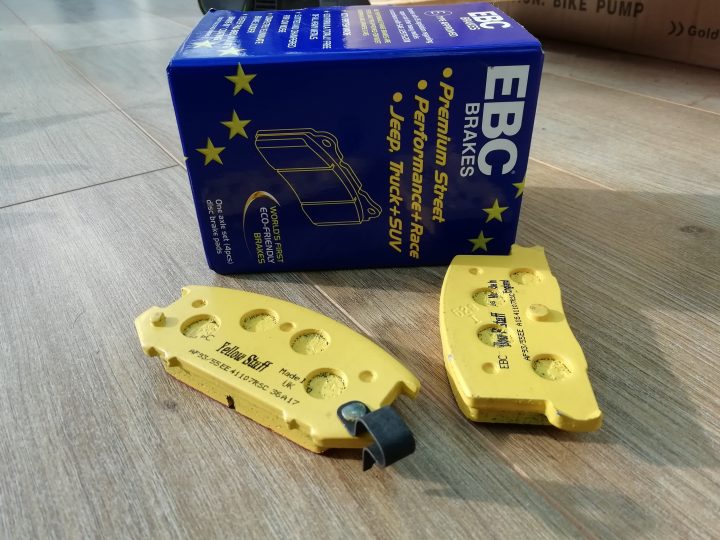

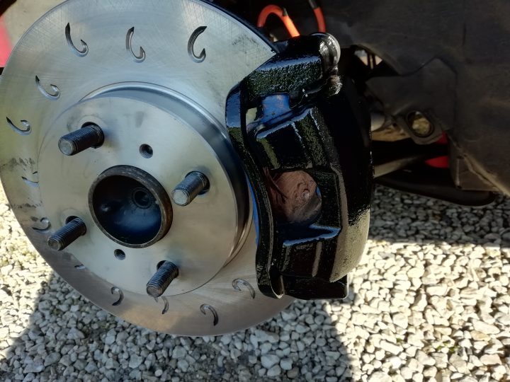

So another weekend done and got some more bits done to the car in the form of a brake change .

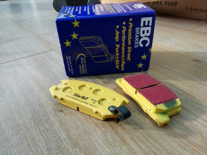

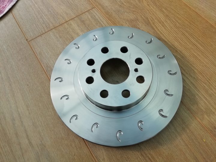

First was the rear and to change the old discs for some Mtec C hook discs .
Then some new Yellow stuff rear pads .
And all fitted .

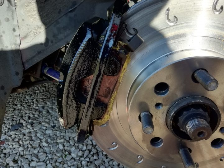

Then on to the front with the new discs .

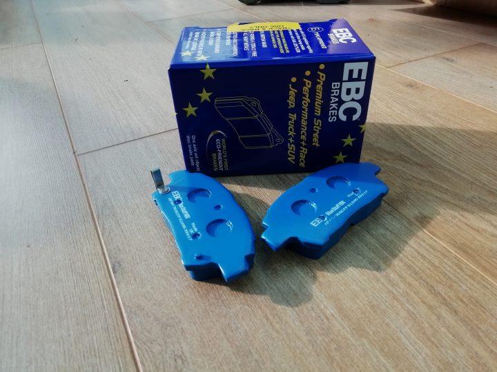

At the front I will be running the stronger Blue stuff pads
Fitted

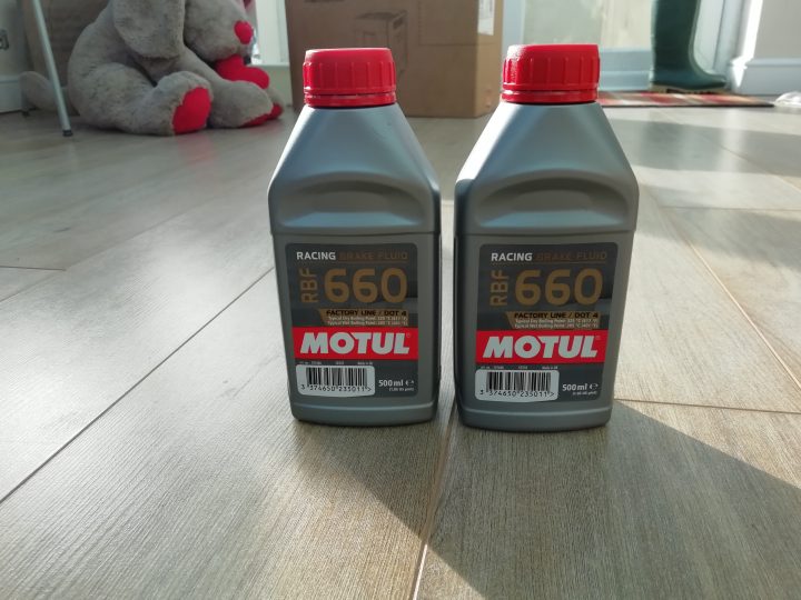

Then to finish off some fresh Motul RBF 660
This little lot should give a bit of an upgrade from the set up last year as I was running stock discs and yellow stuff pads front and rear and this was a great set up as the stock brakes on the MR2 roadster are one part that does not need upgrading that much as they are such strong stoppers and then add this to - 90 Kg removed from the car and the new little upgrade should do nicely on track .

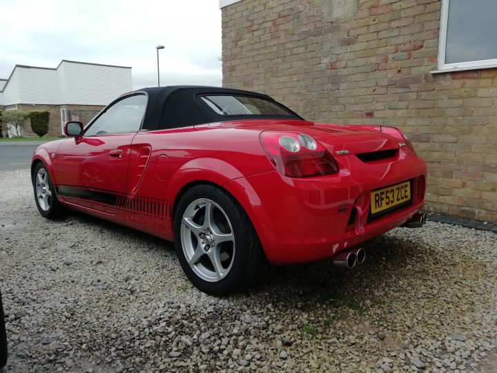

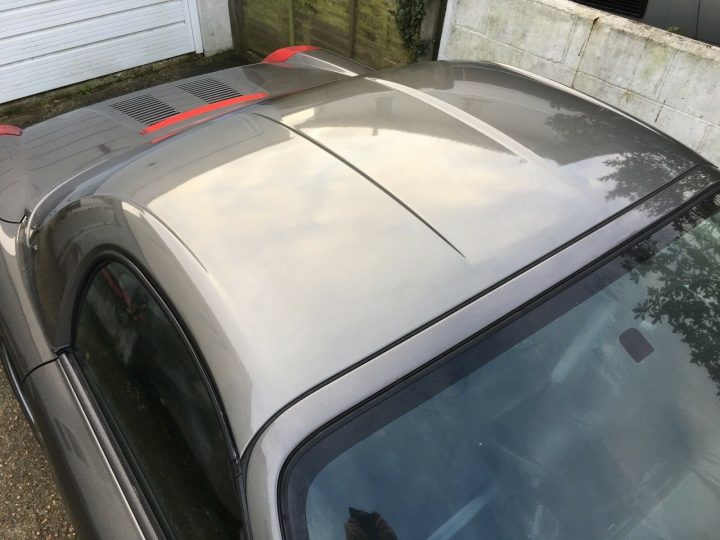

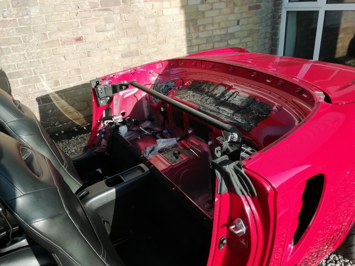

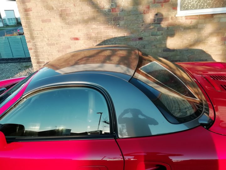

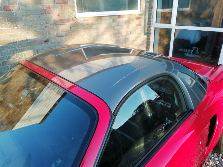

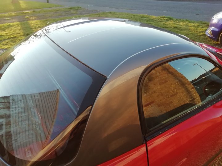

Time for another update .

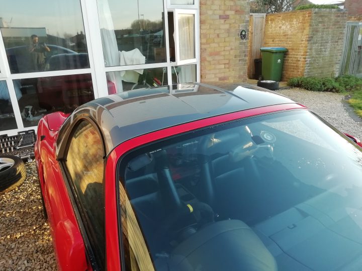

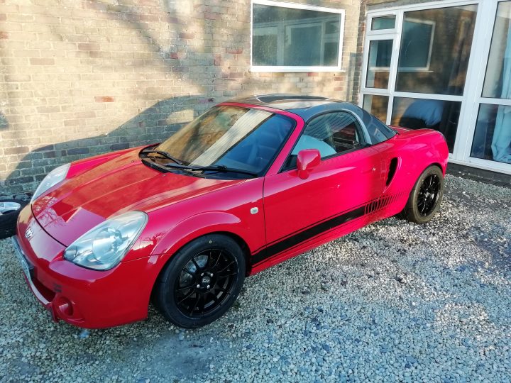

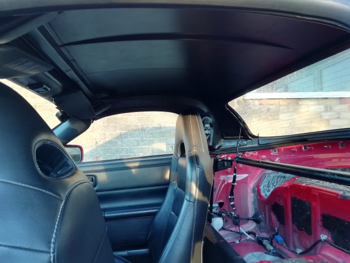

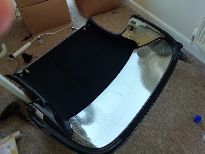

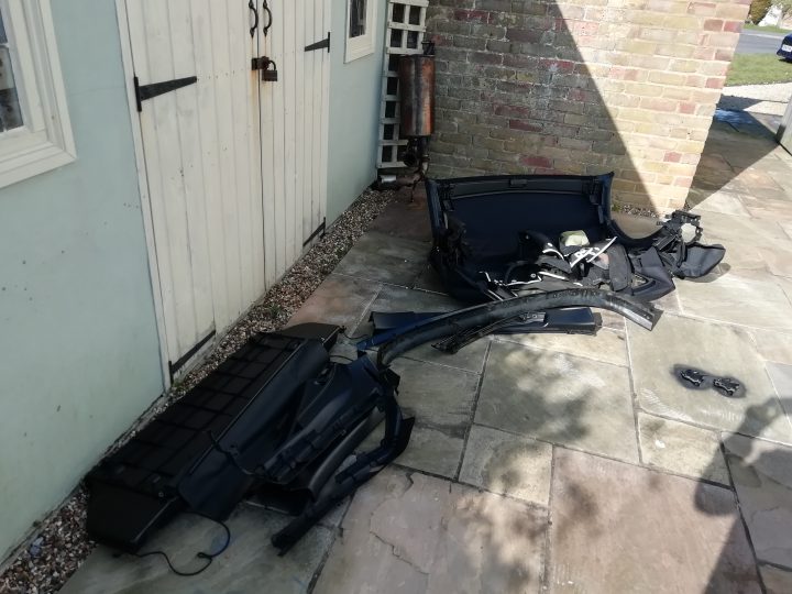

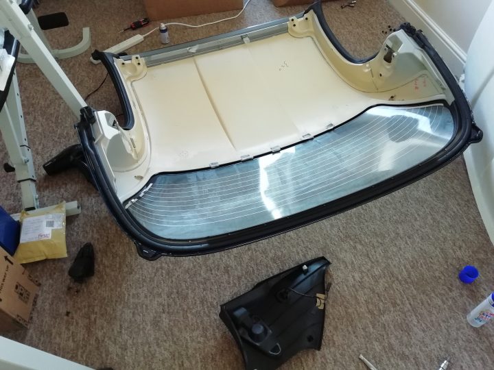

I have been after a hard top for the MR2 for a bit now but wanted to do the other bits first .
First up the cost of the hard top is not cheep and they come in at around £ 500 and then another £ 200 for the fitting kit and £ 20.00 for the de mist cable so it is a £ 700 + item .
The hard top will give the car some extra structural rigidity , a weight reduction of around 10Kg from the soft top and a touch more safety ( at the end of the year the car is going in for a MSA 6 point full roll cage ) and also looks nicer I think .

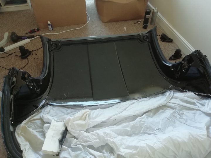

One came up for sale not that far from me in a colour I was after so I picked it up last weekend .

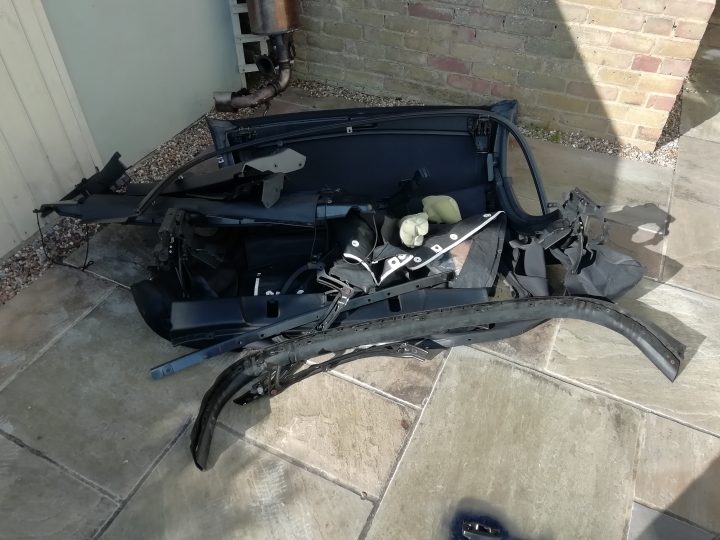

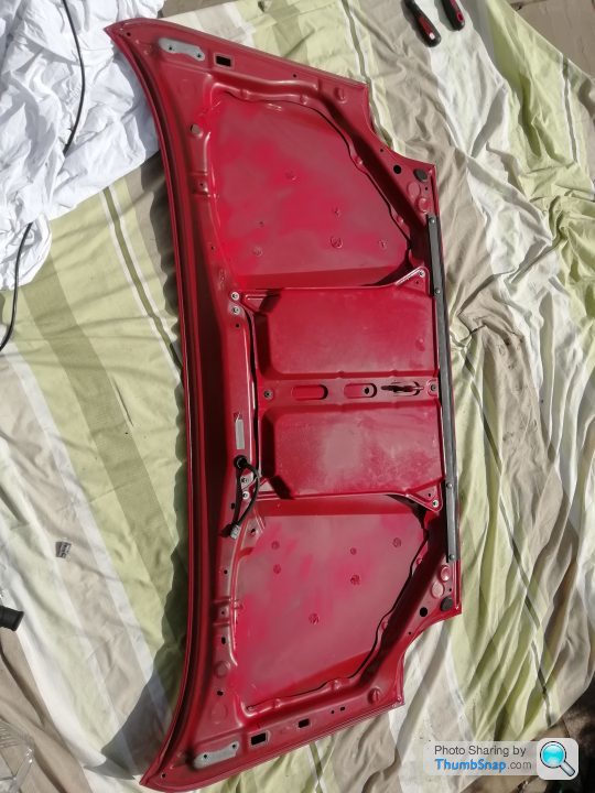

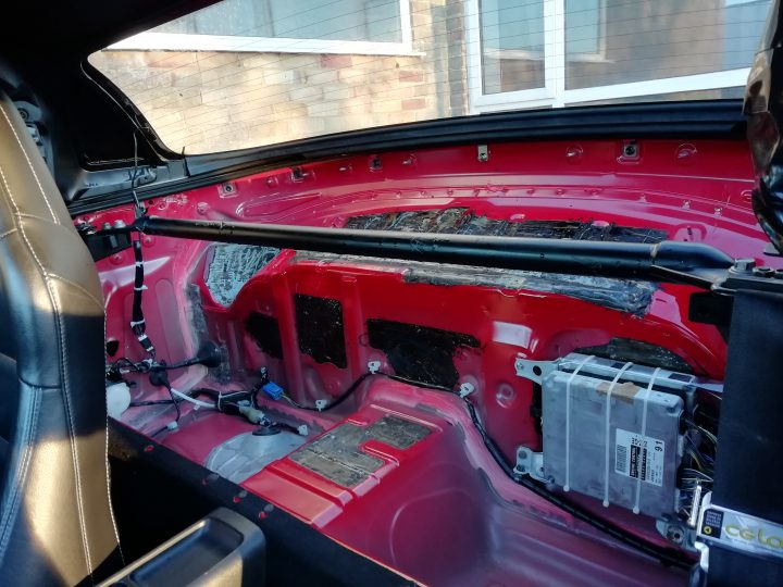

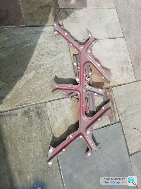

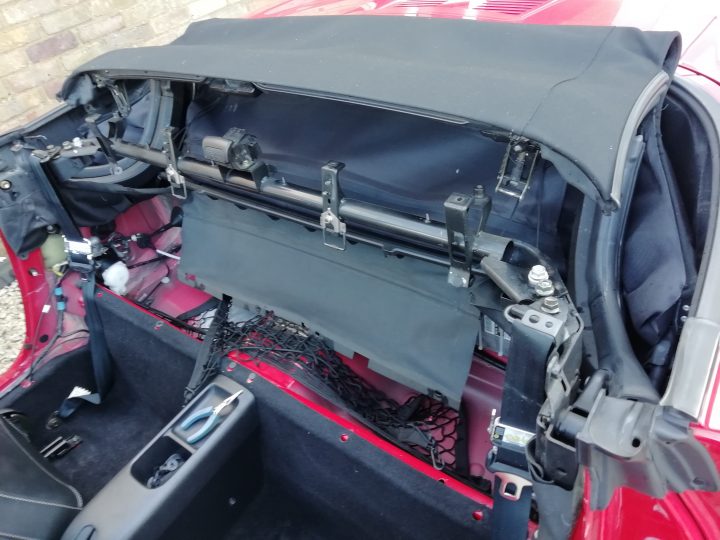

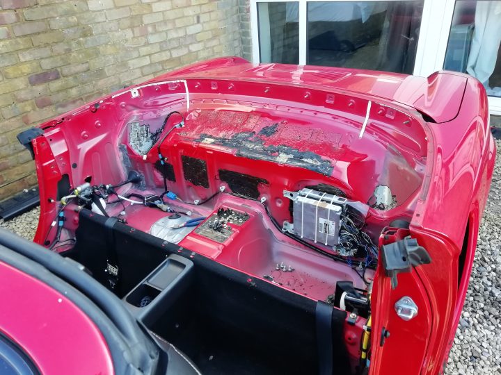

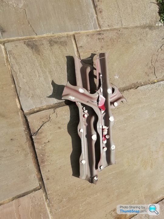

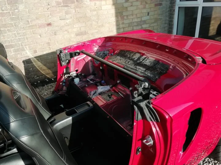

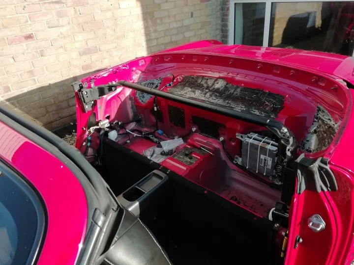

Then yesterday I started to prep the hard top to remove some weight from it so removed the headlining plastic housings and other bits .
Then a quick spray of satin black to tidy it up a bit .

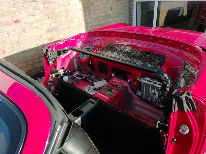

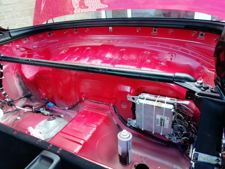

Then it was on to remove the soft top .
If you are keeping the stock seat belts you need to do a bit of cutting to keep the seat belt mounting points and cross bar .
I also jut some of the soft top fixing mounts from the cross brace and gave it a quick spray again to tidy it up a bit after the cutting .
Then to install and bolt down the hard top super tight .
And installed
And as I had some time left I gave the brake calipers a quick tidy up and paint .

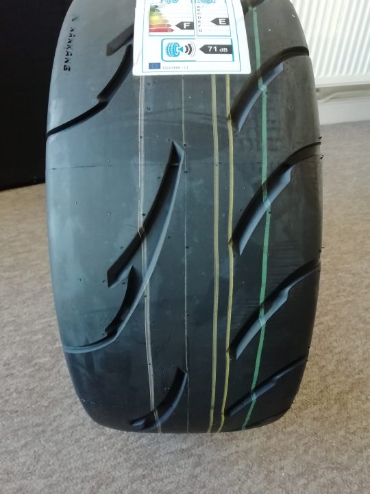

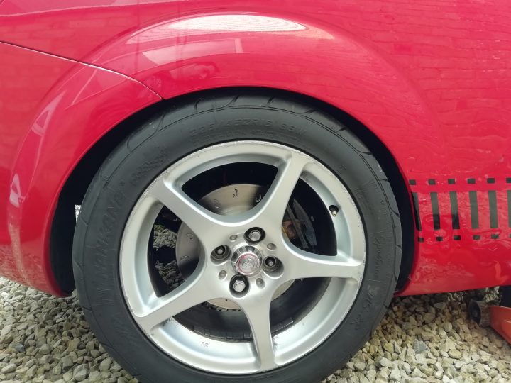

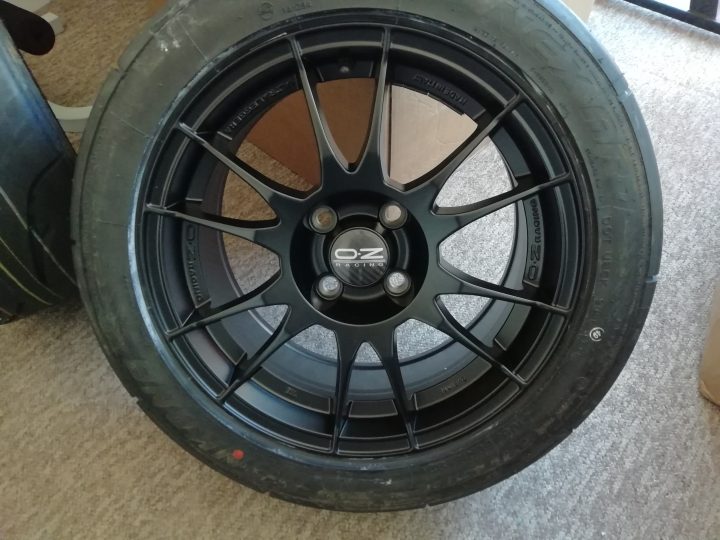

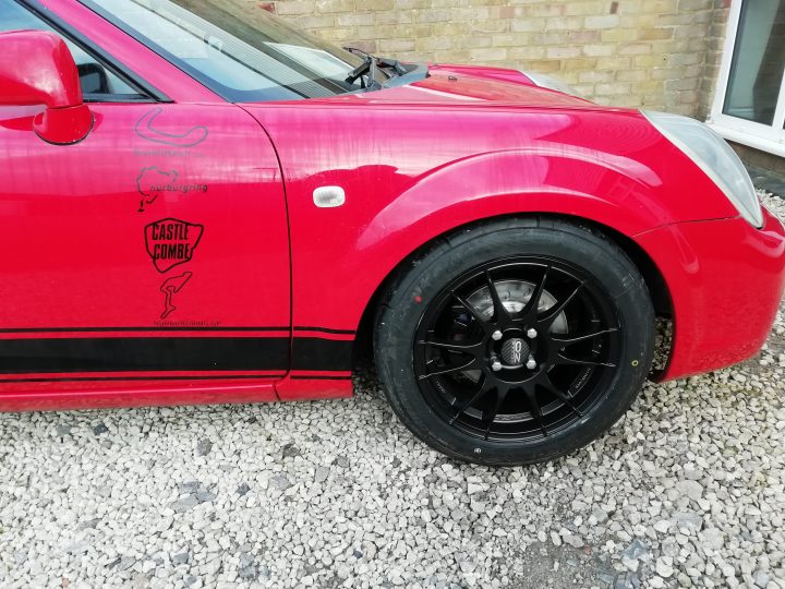

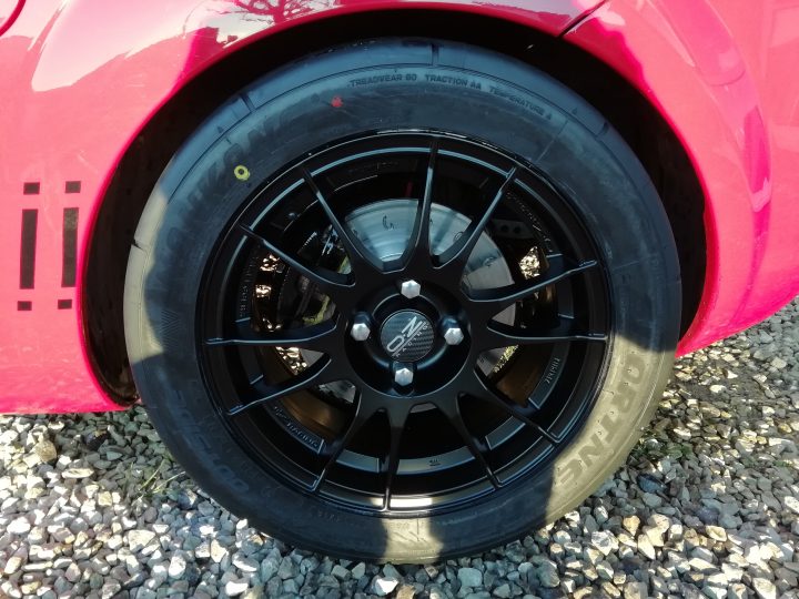

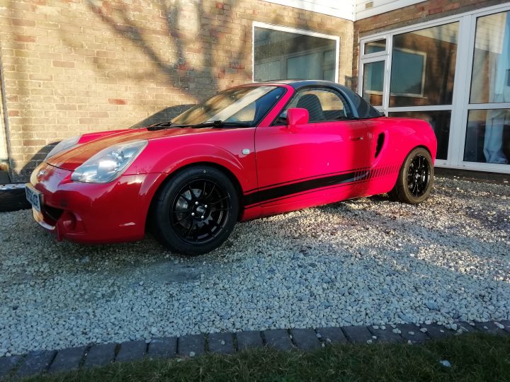

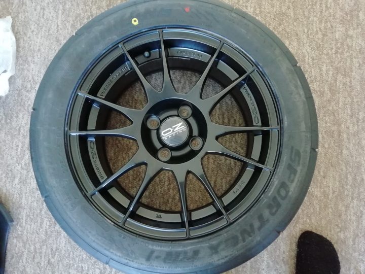

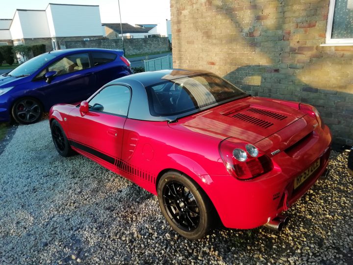

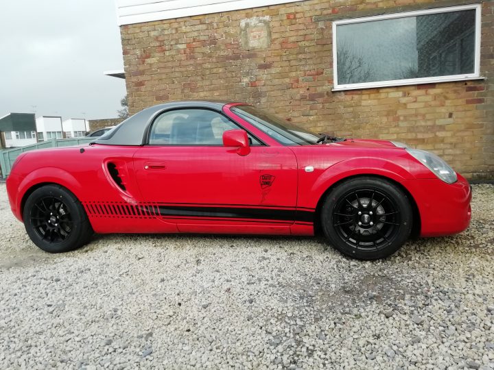

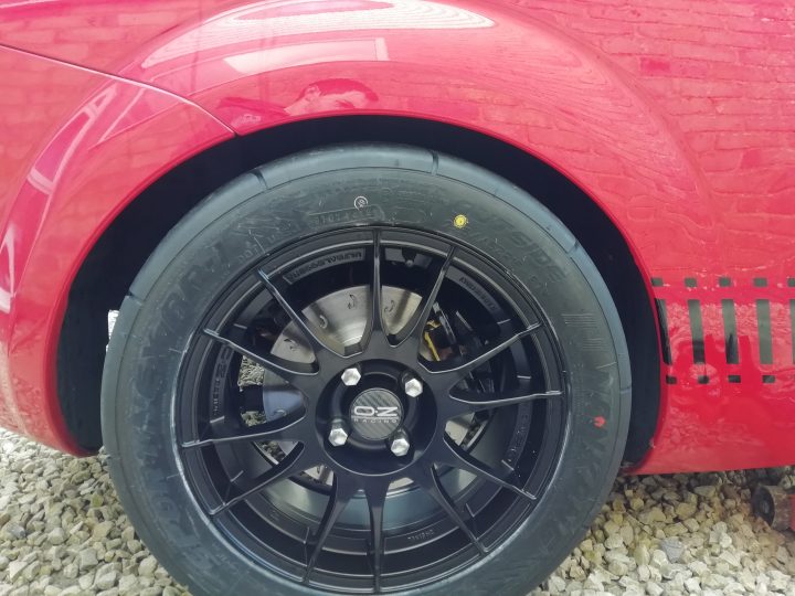

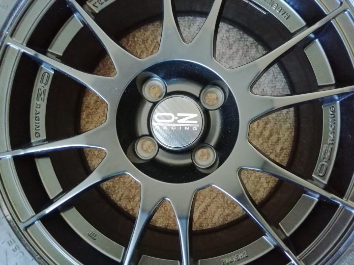

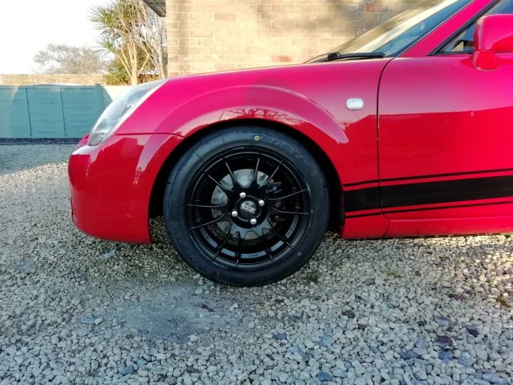

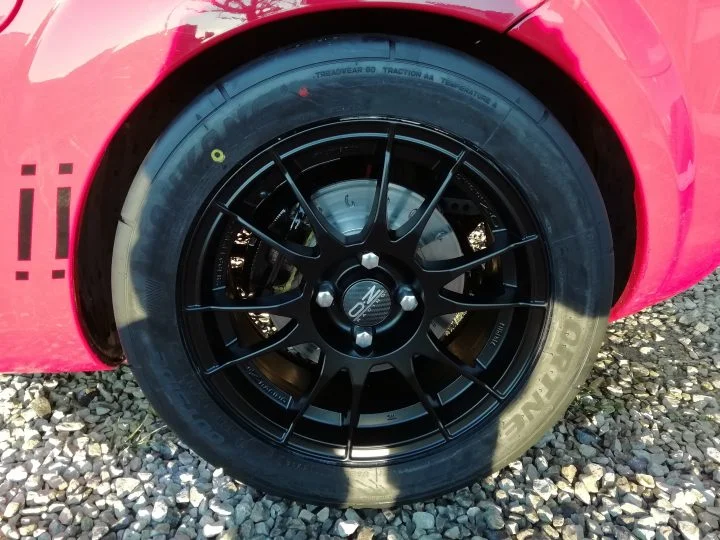

As I had a day off yesterday I got round to yet another upgrade in the form of wheels and tyres .
I have planed to run two sets of wheels this year one dry set and one wet / road driving set and was looking at used Toyota wheels in the face lift staggered format 15 front 16 rear .
After not getting much luck finding a used set of Toyota Mr2 face lift wheels I was looking at pre face lift wheels that are 15 front and 15 rear but the max rear tyre size you can run in the compound I want is 205/45/15 not the 225/45/16 im running at the moment .
The other more expensive option was to get some new wheels so I started looking in to this and as the car is all about low weight the OZ Ultraleggera were looking good .
As the stock Mr2 wheels are light anyway you are never going to save loads of weight but every little helps .

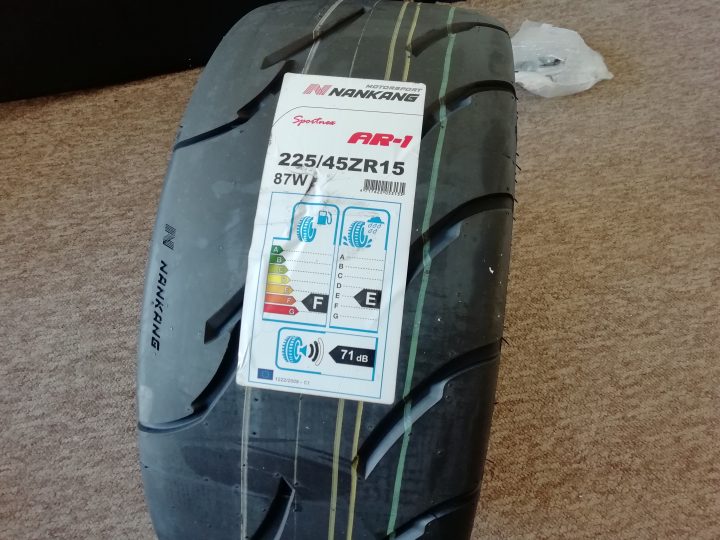

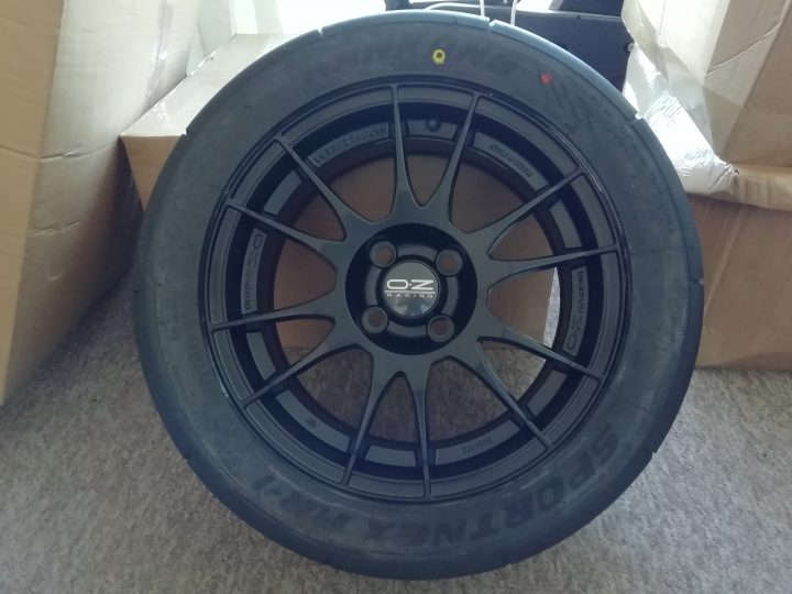

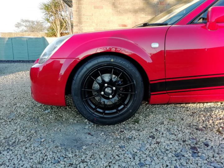

I went for the OZ Ultraleggera in matt black and for 15 inch all round with a 7 inch width so I can still run the 195/50/15 front 225/45/15 rear tyres .
New 15 inch OZ Ultraleggera

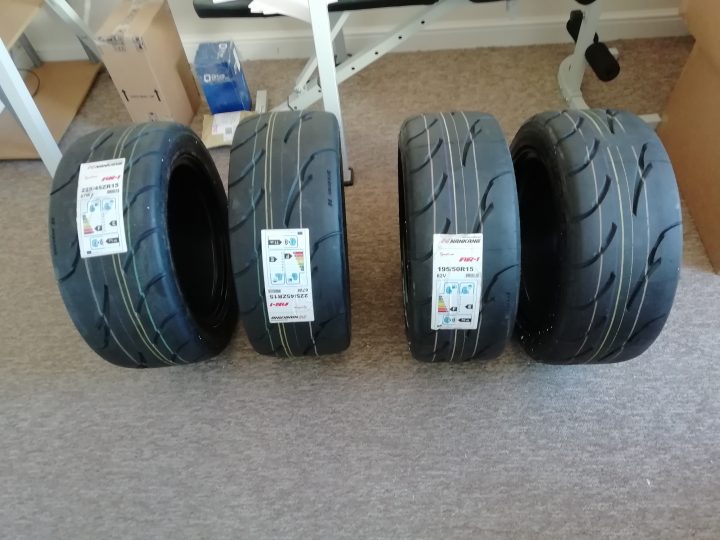

And the tyres are Nankang AR-1 in 195/50/15 front and 225/45/15 rear

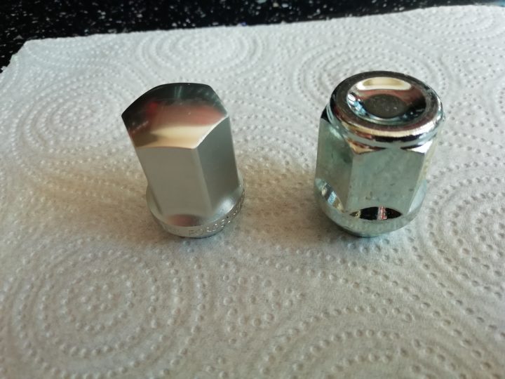

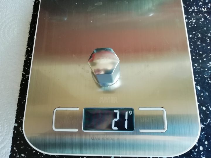

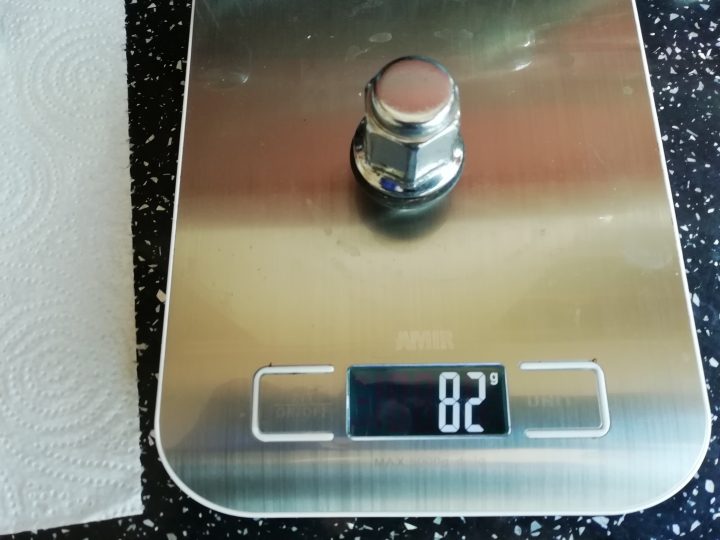

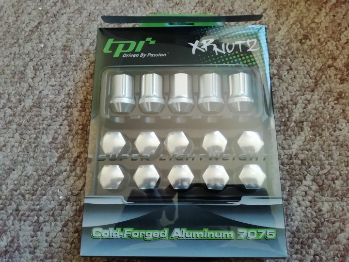

And light weight alloy wheel nuts
Old and new nut

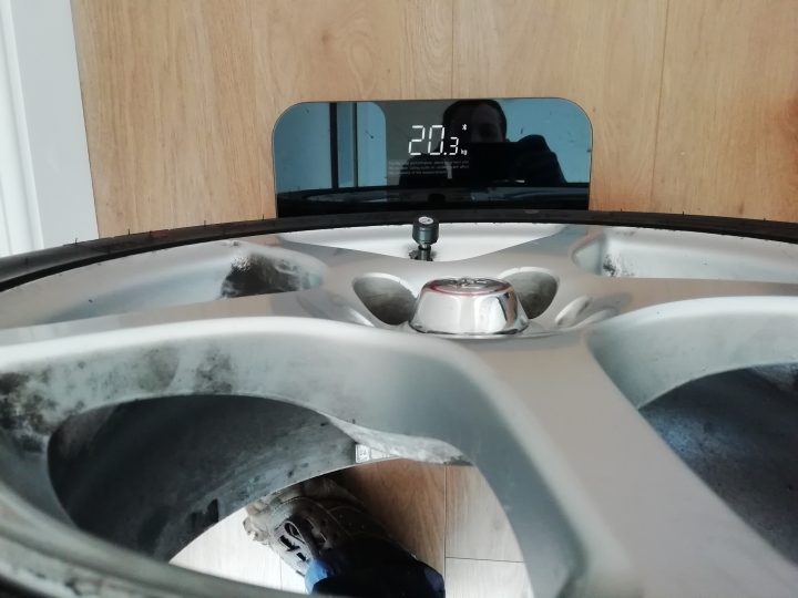

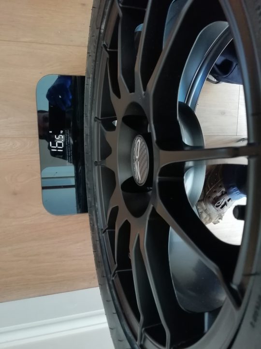

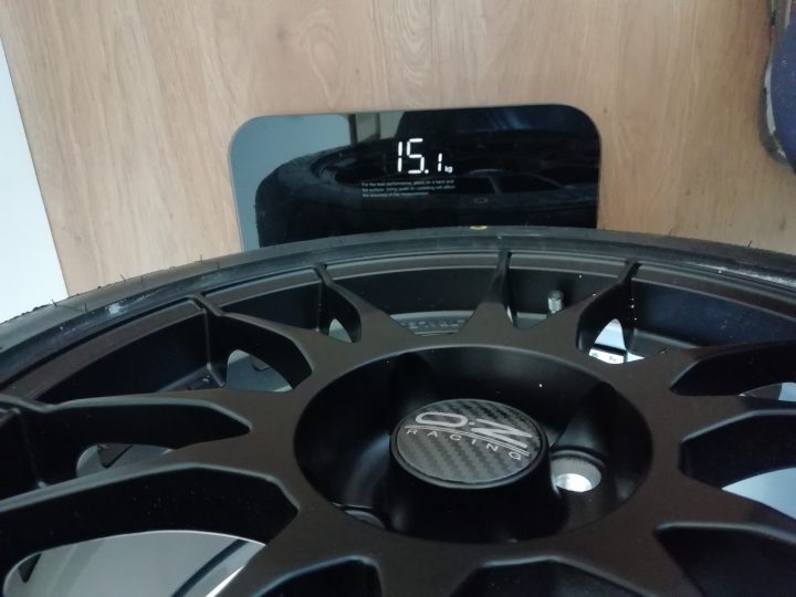

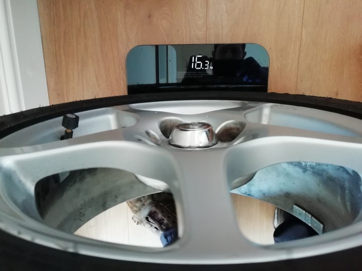

Then to see what the difference is in weight
Old Toyota nut
Light weight nut

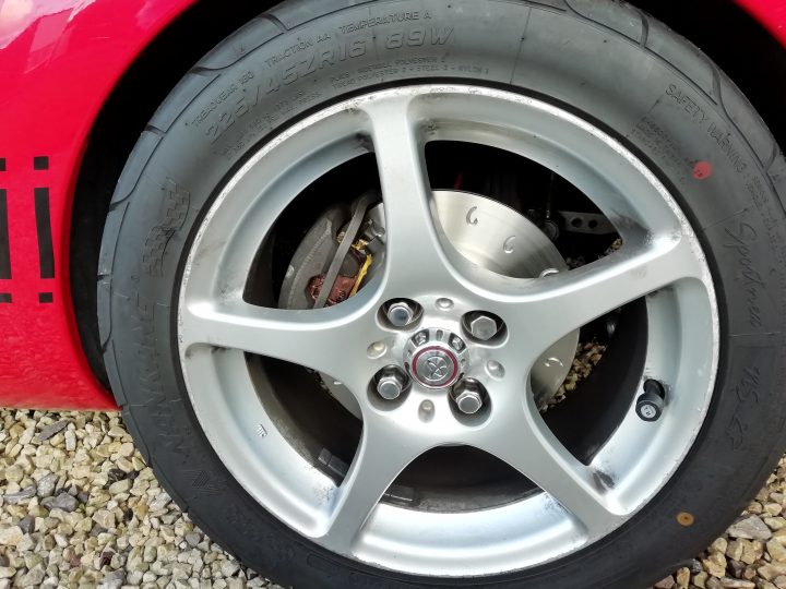

Front 15 inch Mr2 FL wheel
Front 15 inch OZ Ultraleggera
Rear 16 inch Mr2 FL wheel
Rear 15 inch OZ Ultraleggera
Adding the numbers this should reduce the un sprung weight by 11 Kg and I can still keep the tyre size I want on the second set of wheels .

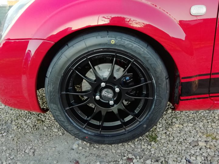

Then fitting them to the car .
Wheels and tyres look good. Once out on track keep an eye out for those tapered wheel nuts coming lose due to the paint on the new wheels. I very nearly lost a wheel on the Celica 190 because of this.
Good tyre for the money.
They were £ 474 all in so not too bad .
Should be loads better than the Nankang NS2R 180 for grip .
Good shout that I did not even think about this and will check .

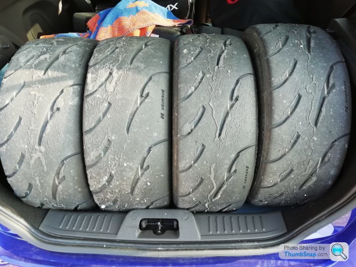

Looking on point. Semi slicks are heavy though! My full slicks on superleggera weigh in at 11kg a corner
I does look very nice but looks are not on the top of the list and im sure they will get banged up on track :)
Next I have a custom exhaust being made for me now then 6 point roll cage , bucket seats and harness .
It did start off as a cheep track car but I think I have got a bit carried away .
Looks fantastic on those wheels, keep up the good work.
In the right hands its around BMW M4 pace on track I am told but sadly I will be driving it so might be more like Nissan micra pace .
I cant wait till the 30/03/19 and will try not to bin it on the first lap .
Still think I should have kept it stock until I had done more than 3 track days but it should all be fun learning :)
Looking forward to seeing this out on track driven in anger. Should surprise some much higher spec machinery.

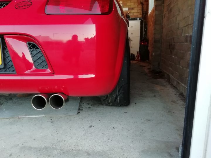

Another small update .

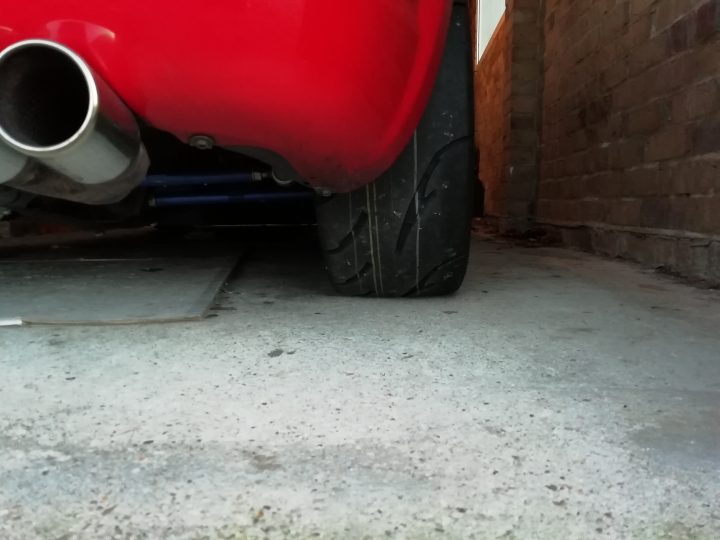

With running a 15 inch on the rear and a 16 inch for a wet set up I have adjusted the rear coilovers to cope with the two wheels sets .
Dry set up at the rear with the 15 inch wheel
Wet set up / road driving at the rear with the 16 inch wheel
The fronts are set to there max but as there is so little weight in the front this is them at max that is spot on for me I think .
And how the car is sitting on the dry set up now .
Also gave the rear a quick tidy up and spray in Toyota Red .
Old
New

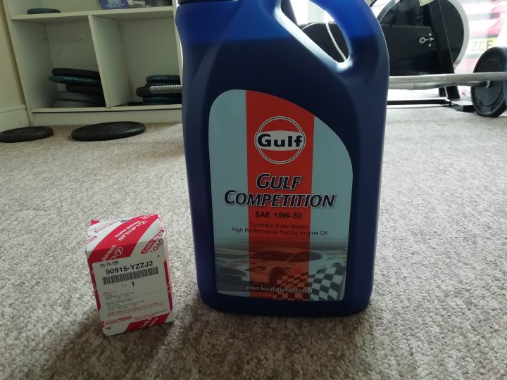

At the weekend i did some last bits before the first track day of the year at Bedford next Saturday .

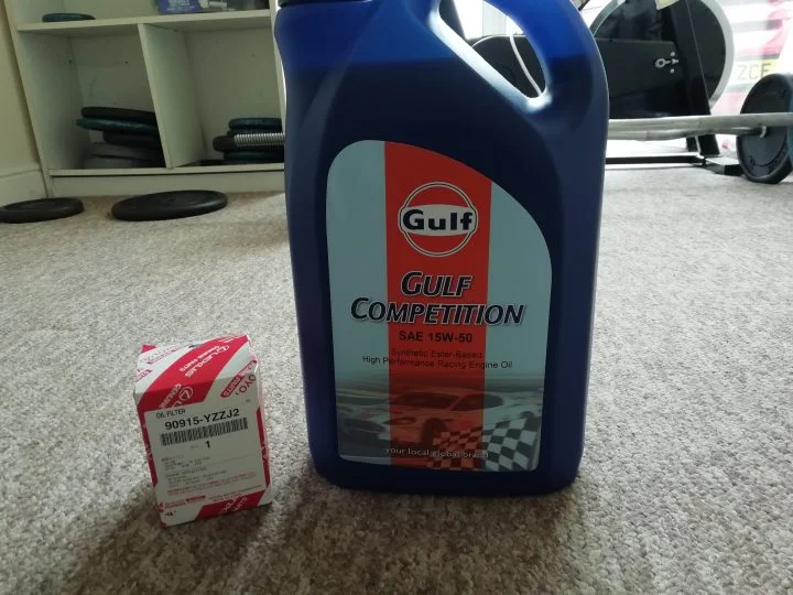

First was to change the oil again for some 15W-50 grade .

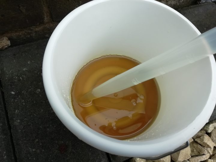

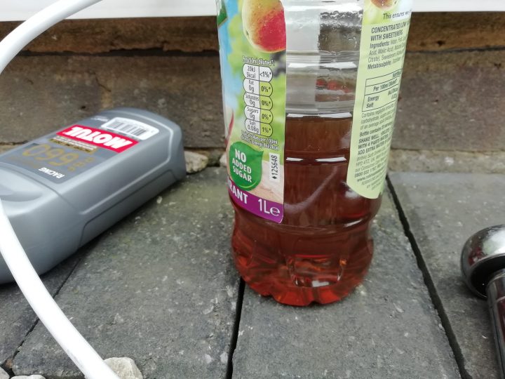

Then to change , flush and bleed the brakes with some Motul 660 fluid .
Old brake fluid

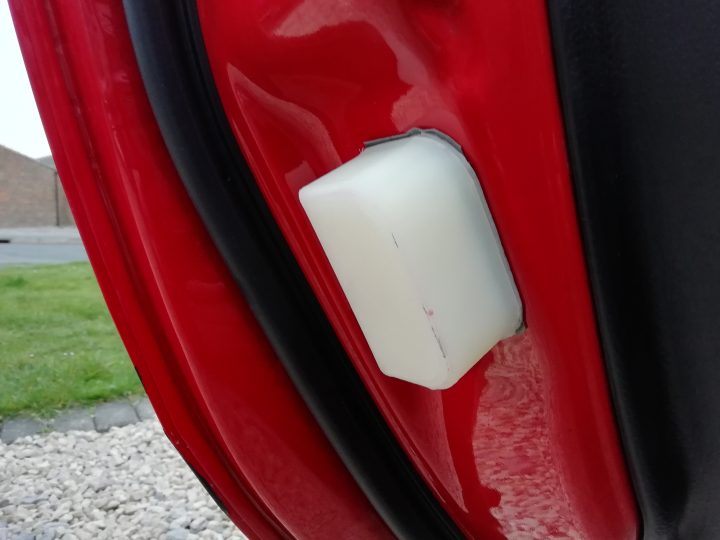

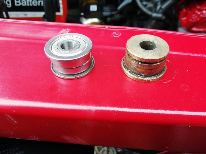

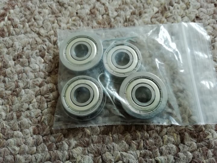

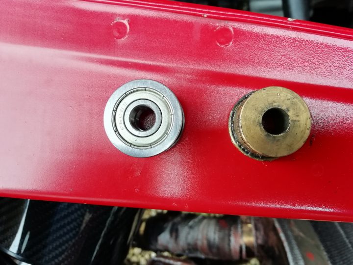

Then to change the shift bushing from the speed source solid brass units to some bearing units

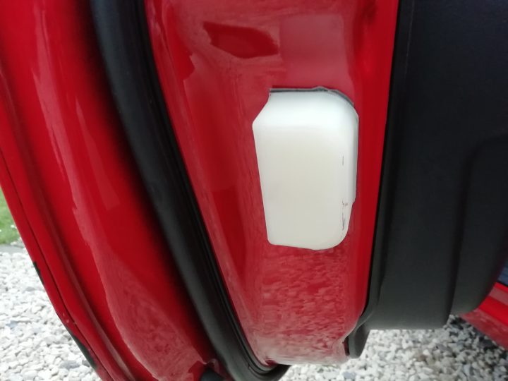

Then to finish off i installed my door bushing units .

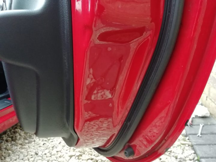

They are from the USA and act the same like on the MX5 to increase chassis rigidity by connecting the door to the frame
Then a quick shake down drive to check everything is ok .

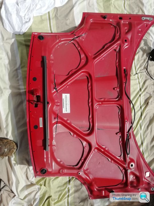

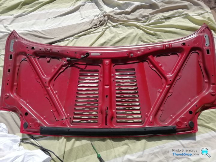

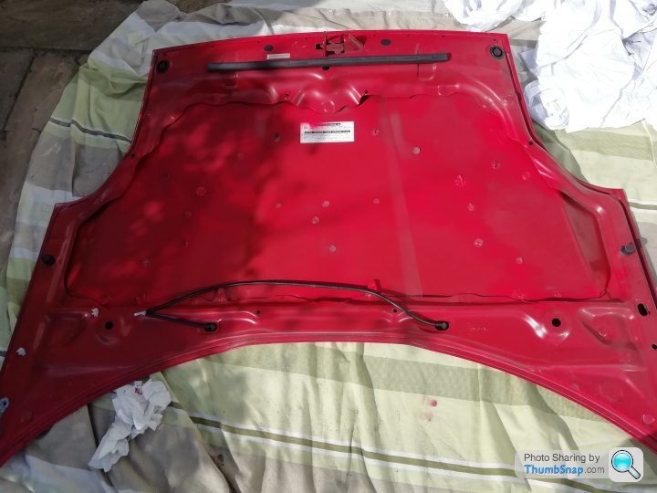

I was looking at lightweight bonnets but as the stock front and rear bonnet are all ready very light weight there was not much of a weight saving to be had and they are not cheep to buy .
Looking at the stock units there is some webbing that can be removed to save a few Kg .
Rear engine bonnet stock
Removed metal webbing
Rear engine bonnet now
Front bonnet stock
Front engine bonnet now
Only around a couple of Kg but every little helps .
Just looking at the stock weight of the car in pre face lift this was 975 Kg from Toyota .
My face lift that has the 6 speed bigger rear wheels and more bracing but no A/C is around 1000 Kg give or take .
Below is what has been removed from the car and im sure i have missed a few bits off but is just a rough guide as most bits i did weigh but some will be more and some will be less .
So the car should now be around the 879 Kg mark give or take .
WEIGHT REDUCTION
SPARE WHEEL 12KG
SPARE WHEEL BIN AND LID 5KG
TOOL KIT 3KG
REAR STORAGE BINS 6KG
FLOOR MATS 2KG
WIND DEFLECTOR 1KG
EXHAUST HEAT SHIELD 1KG
EXHAUST SPLASH BOTTOM SHIELD 1KG
FOG LIGHTS 1KG
OLD EXHAUST MANIFOLD WITH PRE CATS FOR NEW 3KG
MANIFOLD HEAT SHIELD 1KG
OLD STOCK CAT AND DOWN PIPE FOR NEW 6KG
OLD EXHAUST SYSTEM FOR NEW 4KG
REAR STORAGE SOUND COVER 2KG
AERIAL 2KG
ALARM 0.5KG
ASHTRAY 0.5KG
BRACKETS 0.5KG
AIR BAG SENSOR & MODULE 1.5KG
SOUND TAR 5KG
ECU PLATE 1KG
STUFFING FOOT WELL 1KG
MANIFOLD BRACKET 3KG
STRUT BRACE PLATES F / R 1KG
REAR BUMPER BAR 1KG
DRIVER AND PASSENGER AIR BAG 7KG
LIGHTWEIGHT FLYWHEEL 5KG
RACE BATTERY 8KG
FRONT ARCH LINERS 0.5KG
LATCH BRACKET 1KG
FRONT SOUND RUBBER 1.5KG
AIR SCOOP & BRACKET 1KG
ENGINE LID SENSOR BRACKET 0.5KG
OEM AIR BOX + BRACKET FOR NEW 2.5KG
OEM WHEELS FOR OZ ULTRALEGGERA 9.5KG
LIGHTWEIGHT WHEEL NUTS 1KG
OEM SOFT TOP FOR OEM STRIPED OEM HARD TOP 12.5KG
CHARCOAL CANISTER AND PIPEWORK 2KG
BRAKE DUST COVERS 0.5KG
EXHAUST HANGER 0.5KG
HORN 1KG
FRONT & REAR BONNET WEBBING 2KG
TOTAL WEIGHT REMOVED 121KG

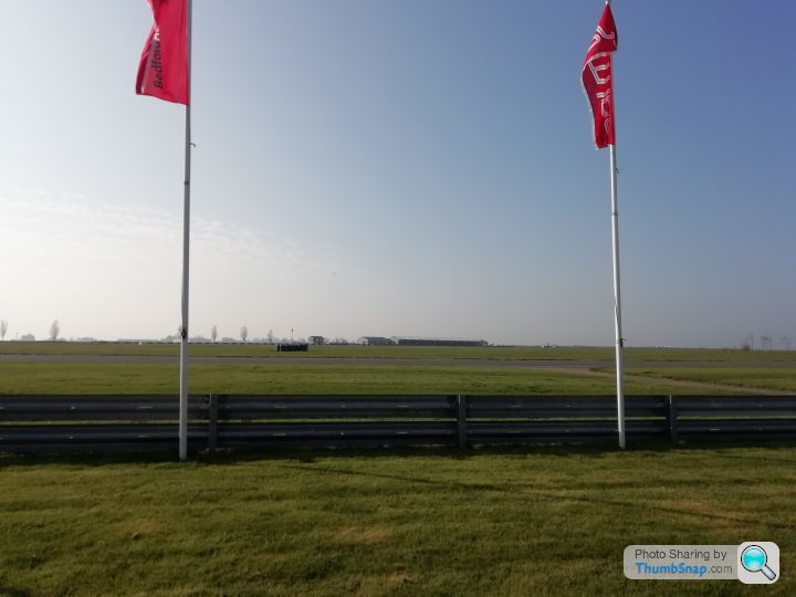

On Saturday i had my first track day of the year at Bedford GT track .

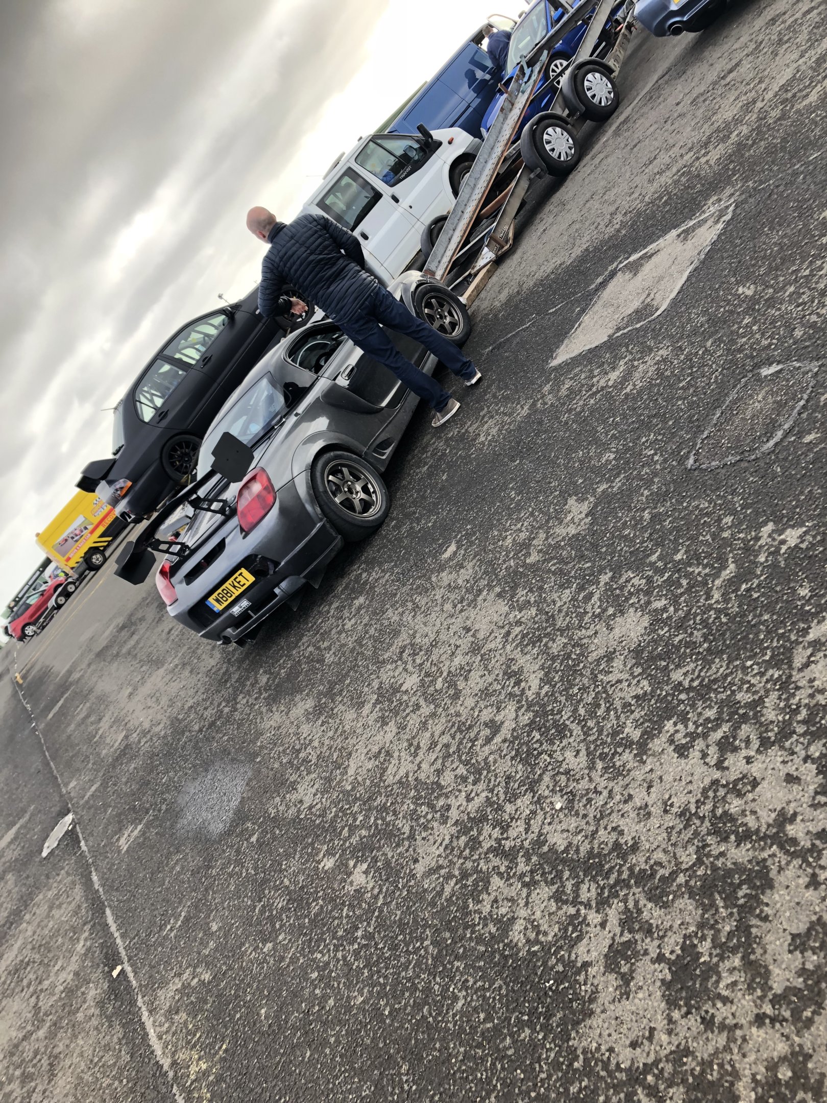

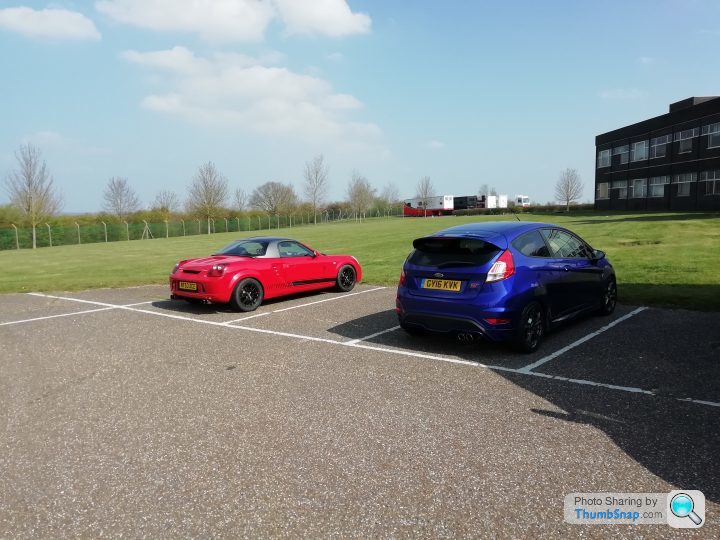

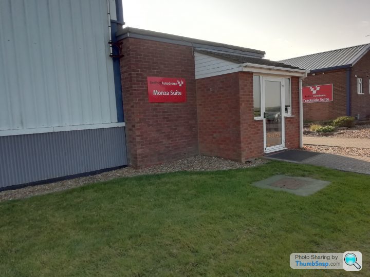

The car drove spot on and we had a great day .
There were some really nice cars and very friendly people and the weather was great nice and warm and dry and sunny .
Noise test was done and was ok at 95 DB
Random pics from the day .
We did some sighting laps then a few sessions each then went for lunch at the Fox and hounds pub .
We came back and did a few more sessions before we called it a day at 4.00 PM for the 3 hour drive back home .

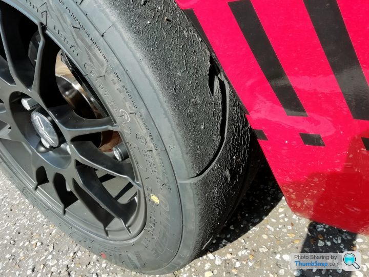

The car drove spot on and the Nankang AR-1 tyres were amazing
The only bad part was that the Go Pro did not seem to record that well and only recorded one session in the morning so is missing the out braking and back end stepping out at hangar hairpin .
