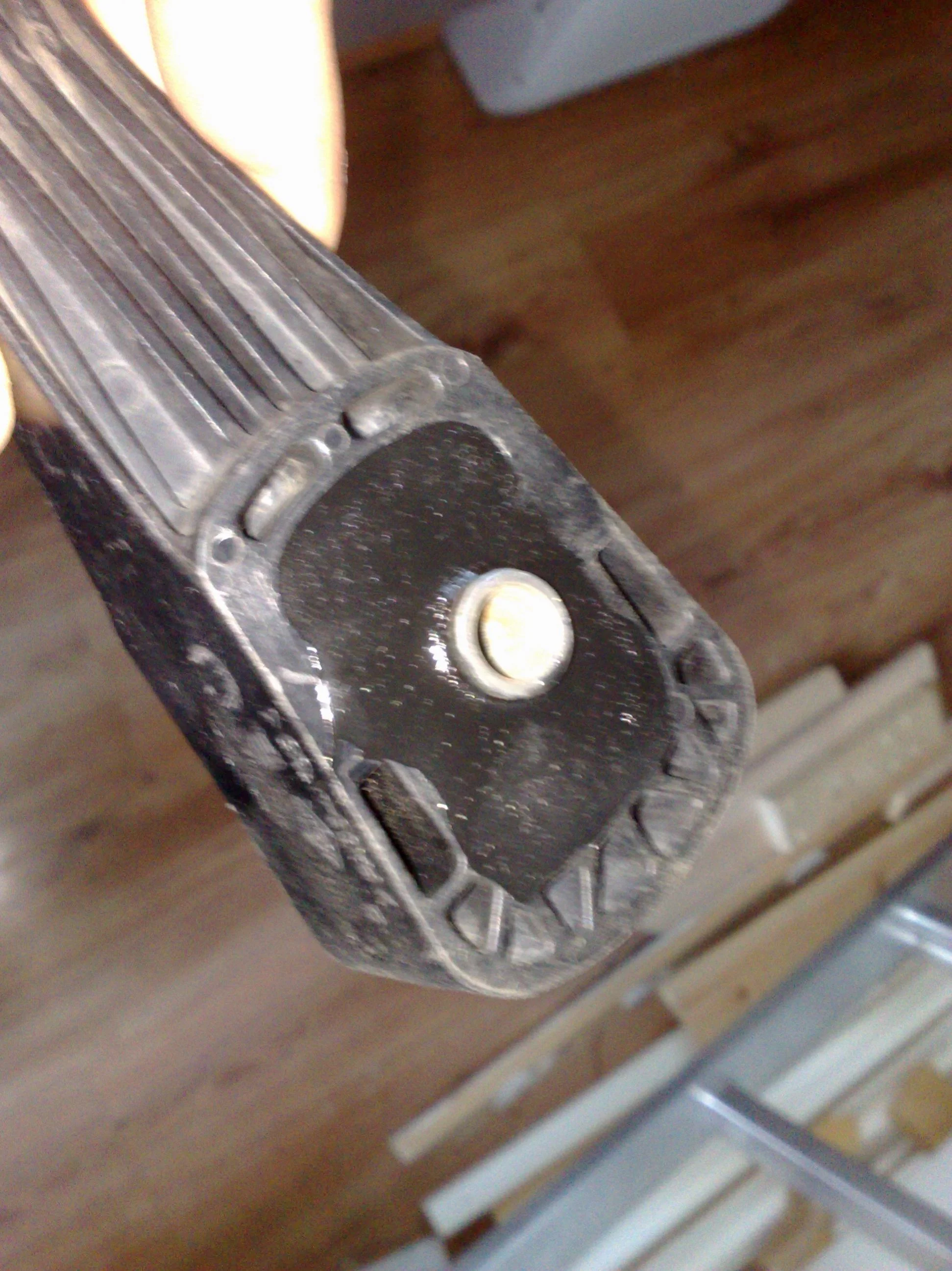

  RX8, Clio II 1.6 16v
I did a few weeks ago it and it worked. :rasp:
I awaited the delivery of the flexane for a very long time, and then had to do the job in a hurry, so I did not take decent pics.
The mount definitely firmer than stock - nice crisp gear changes now, and not much louder.
I used the flexane to fix the two main exhaust hangers too, as they were trashed. and I still had a bunch left over.
Just dropping in to report a year on the mount is working fine with no visual signs of any deterioation. I'd recommend this as an uprating of the mount for non sport cars where the powerflex bushings are not availible. I'd have got better value out of it if I was more organised and used the batch of flexane to fill the other two mounts.

Hi Fredii. The stuff I bought is this.
http://www.lawson-his.co.uk/scripts/products.php?cat=Devcon%20Flexane%20Liquid%20Urethanes
I found USA retailers selling no-brand stuff which is exactly the same material for 1/3rd the price - but could not source it in the UK.
When I did the job a majority of my time was spent removing the old material and prepping the surfaces with sandpaper to ensure a good bond - the rest was quick. I just used fabric tape wrapped around the mount to make the mould, poured in the goop and popped it in the oven at a low heat for a couple of hours to help it set.
The product comes in two parts which are mixed to start the curing process (just like epoxy), but they must be measured very precicely which is easy to when you use the full bottle but hard to measure if you use just part. The best thing to do would be to find other people who need their mounts doing and share the batch - I guess you would get 4/5 mounts from 500ml.
