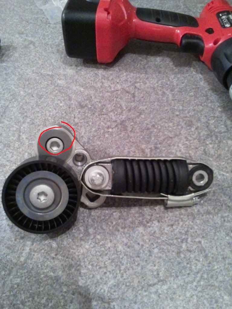

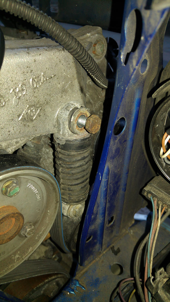

This is the tensioner (ignore bolt sticking out) to me that looks like it's compressed when it shouldn't be!

I had to move the whole bracket underneath the alternator to fit this new pulley. when doing so I had to undo the circled bolt, when fitting this back together I tightened that bolt tight.
My thinking now is that it should be loose to allow the tensioner to be able to move for it to actually work as a tensioner if that makes sense? Can anyone confirm?
BashRacing
That Allen key headed bolt on the tensioner needs to be tight Dan,
The bush that it runs through should rotate freely,
If it doesn't then the bush is seized and the tensioner needs replacing

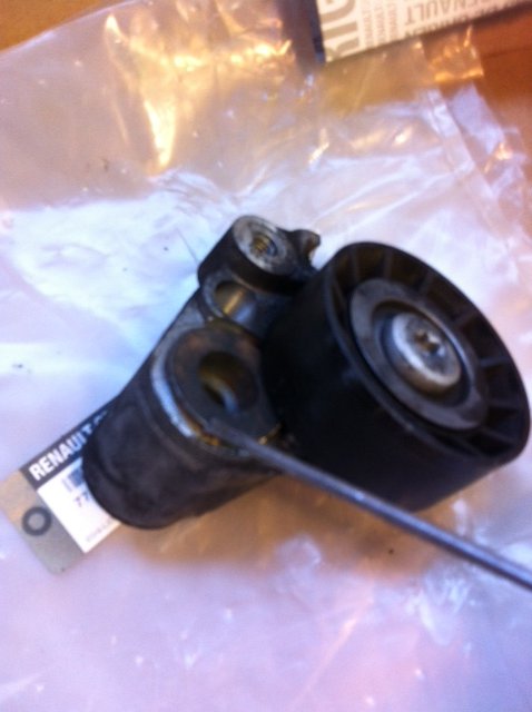

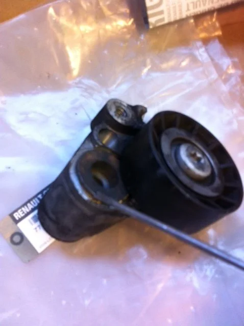

Mine had done the same when I removed it,
Taken from when I did mine
This is a picture of the tensioner i removed it was 36k miles and 3 years old and was completely seized on the collar pointed out in the picture which is a very good reason to listen to renaults advice on the changing of these at 36k,

Turns out my tensioner is working fine, it's got movement of around 8mm all in all from nothing to as tight as I dare go with the jubilee clip.
I think the belt from the guide is just way too long despite it being 22mm shorter than standard.
I'm going to get a belt tomorrow (1620mm) so that's 42mm shorter than standard and see if that tightens up as it should.
