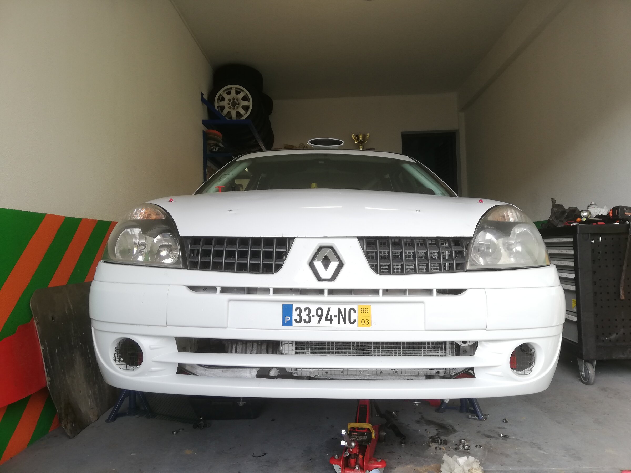

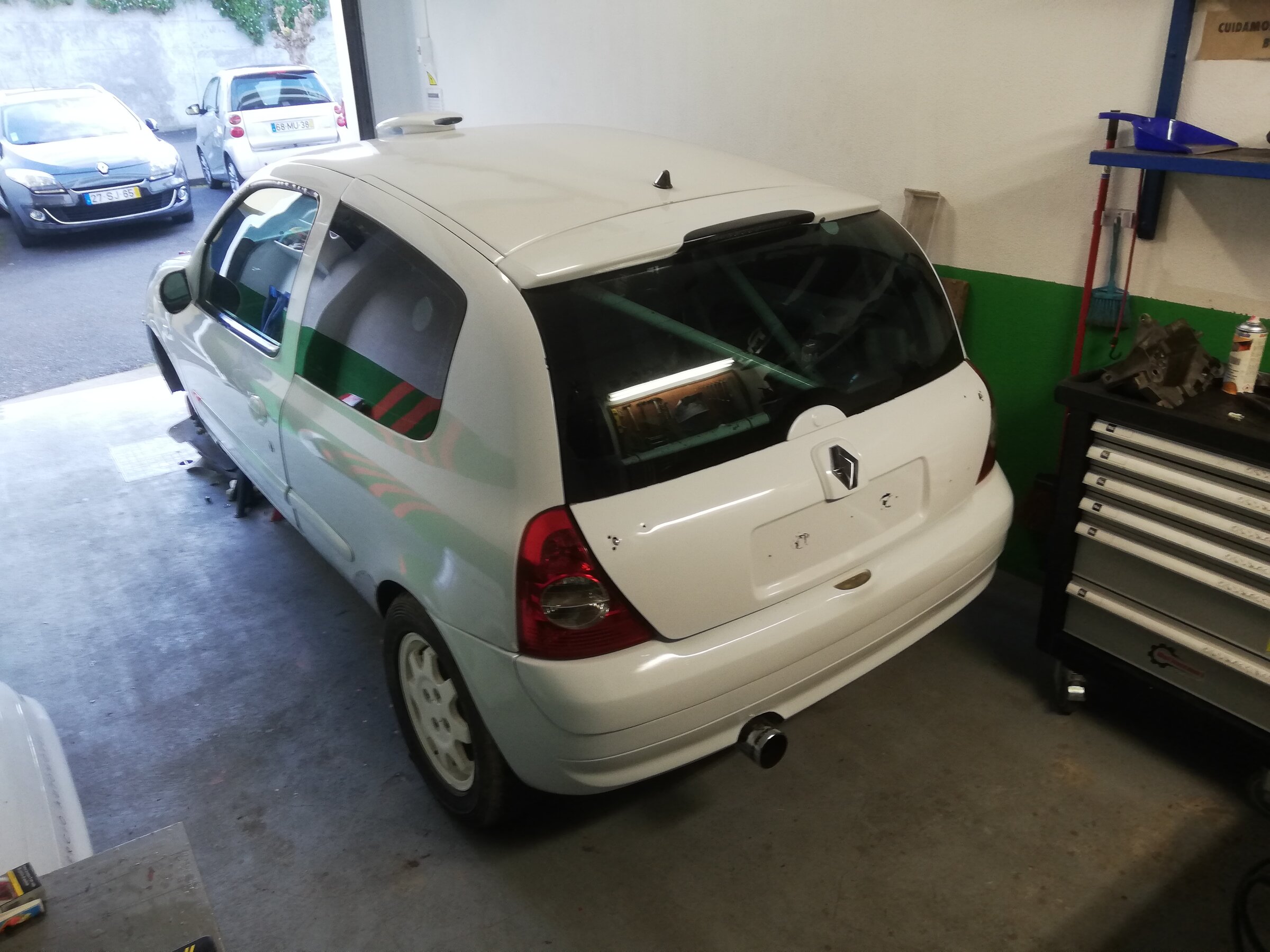

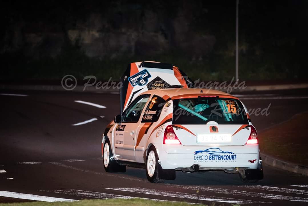

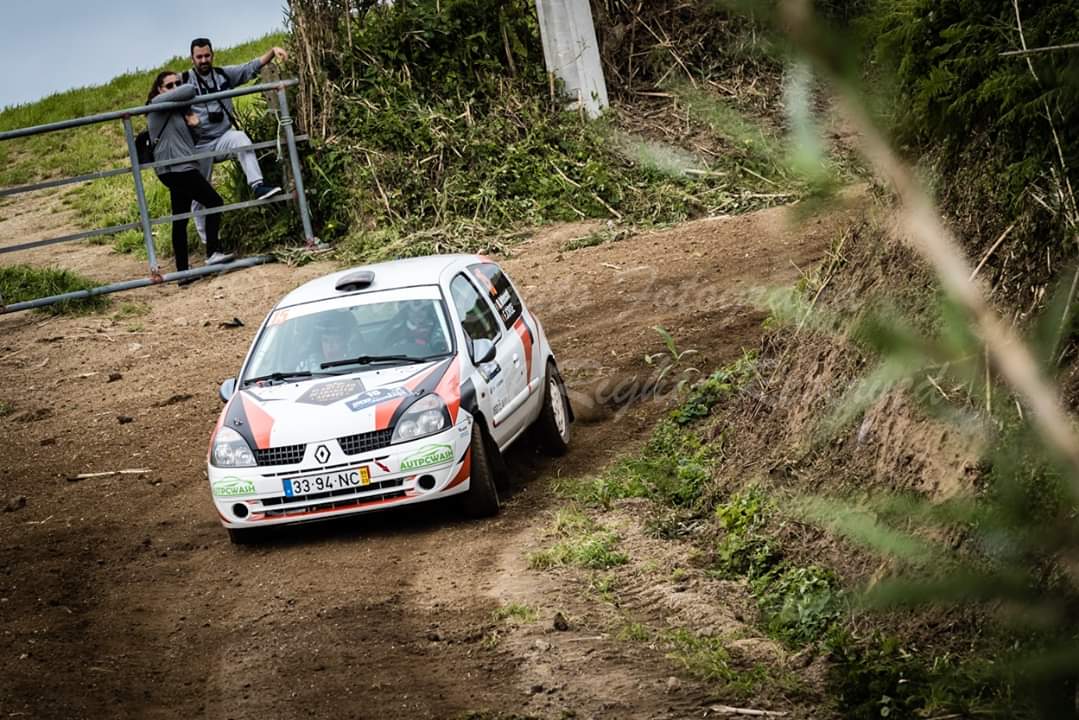

Here i present my k4m project rally car:
Specs:
-k4m stock internals
-bmc cda air filter
-lightened flywheel

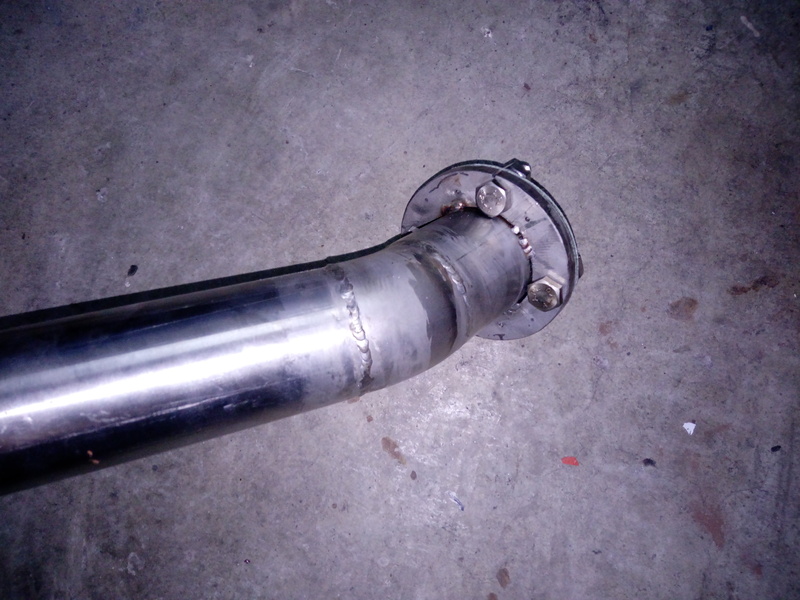

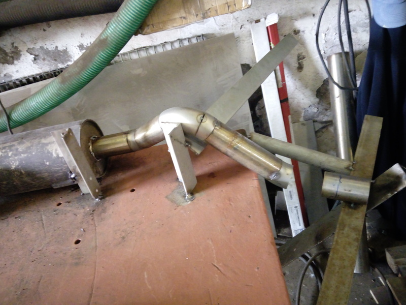

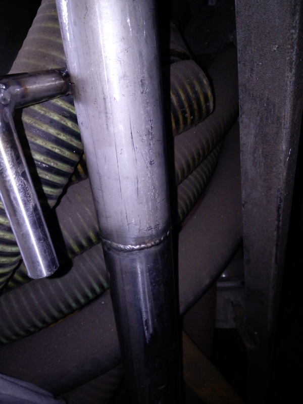

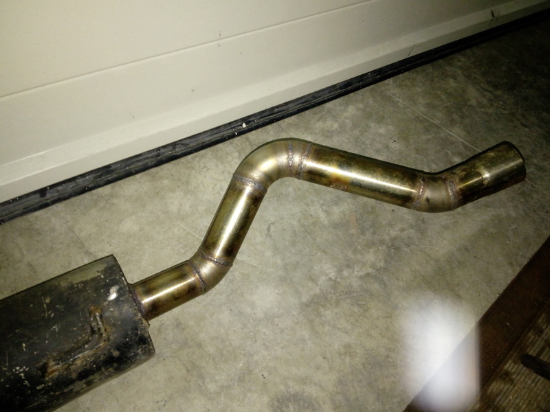

-stainless steel homemade exhaust with (temporary) remus back box
-gravel suspension set
-tarmac suspension set
-lots of tires and wheels lol

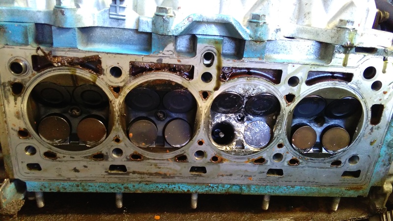

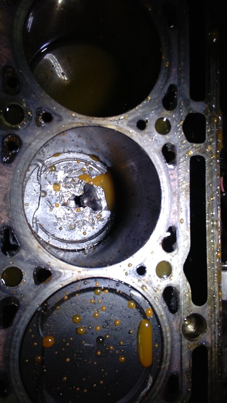

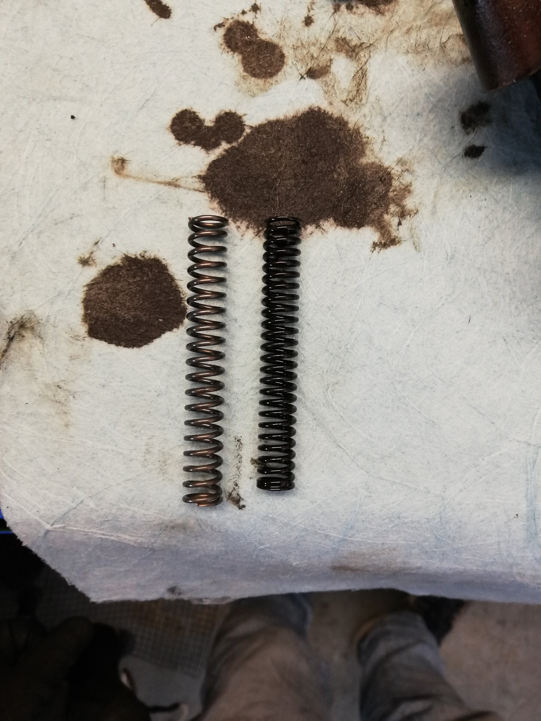

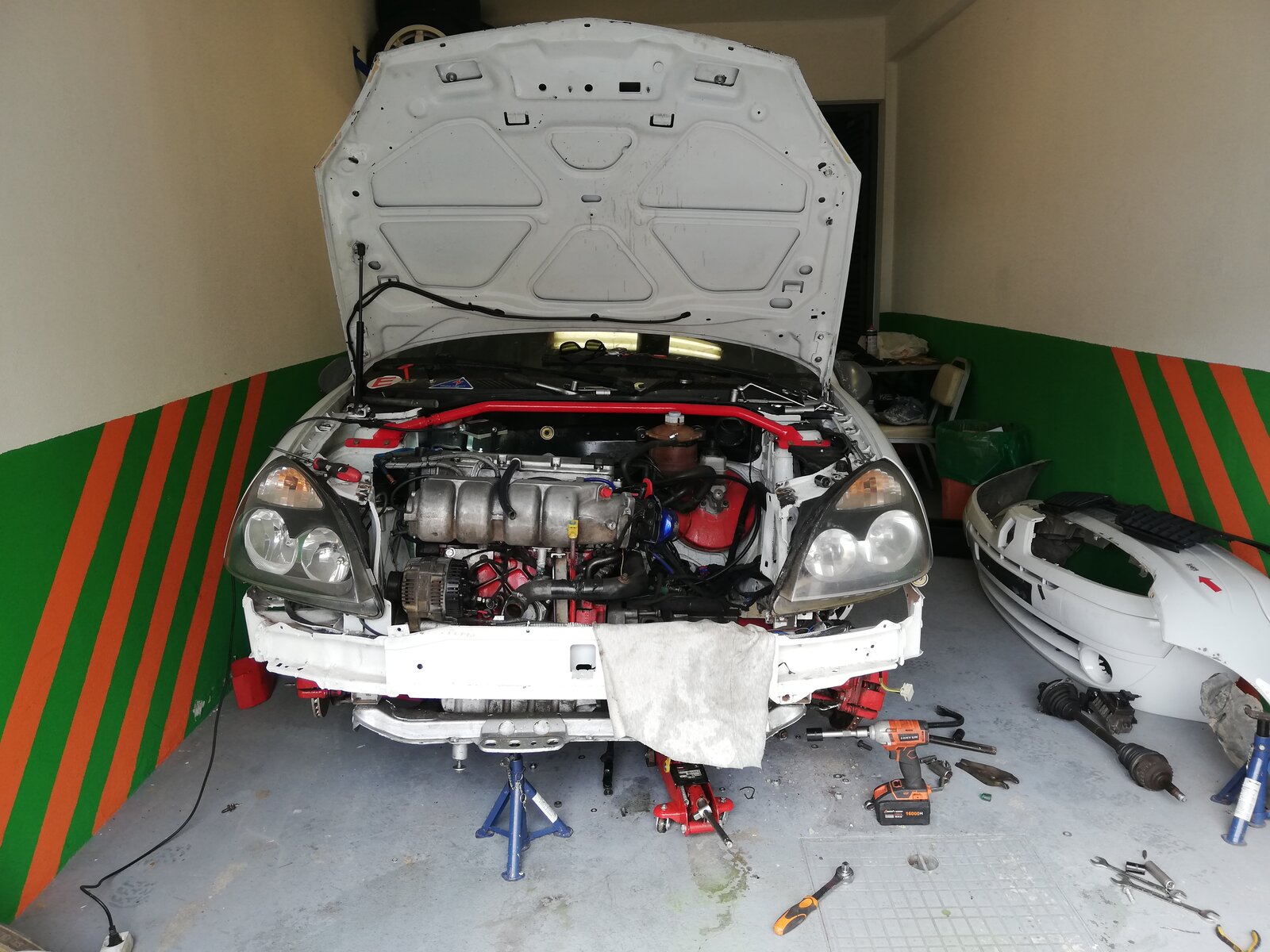

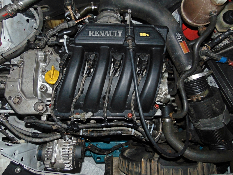

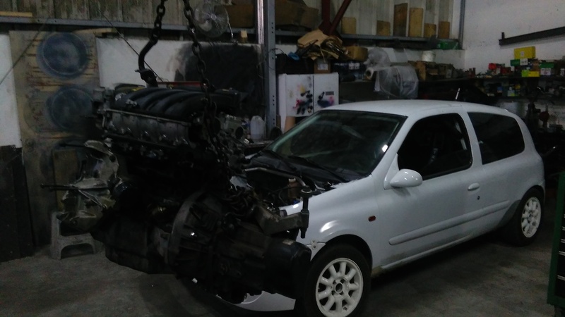

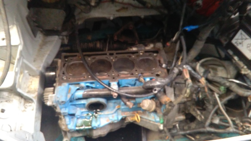

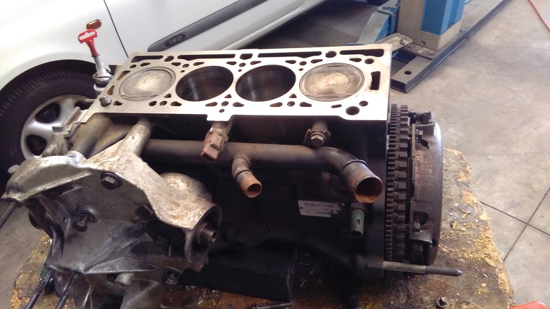

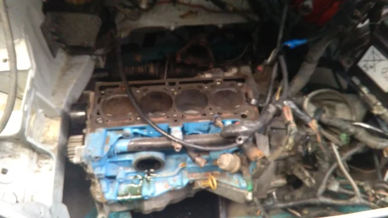

Bought it and repaired the entire engine:

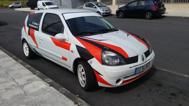

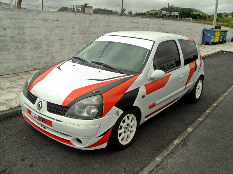

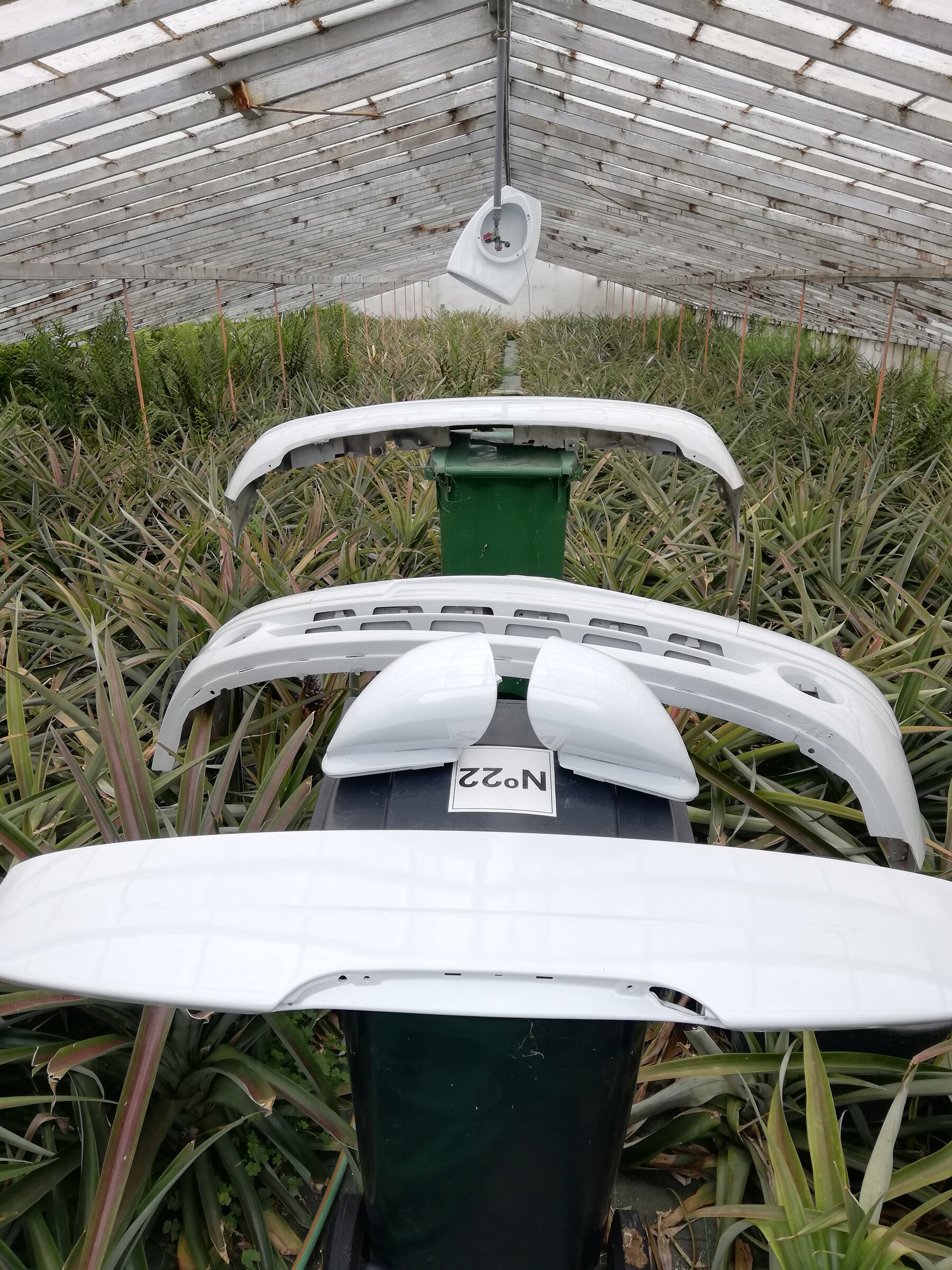

Home made decoration set:
After it's ready, tarmac and gravel rallying!
With some friends:
I wanted also that you guys gave me some opinions and possible upgrades to make!
Thanks a lot.
Mateus
Azores
