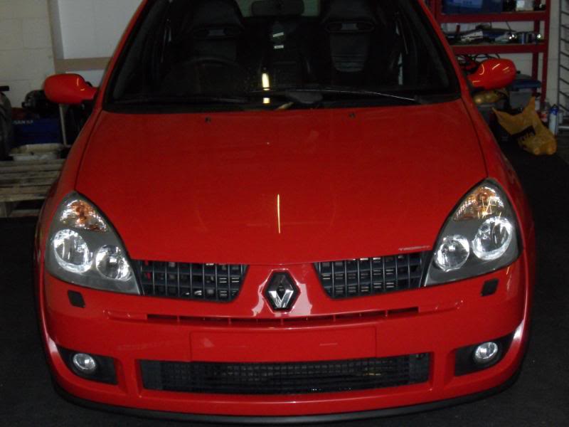

Car had around 70k miles on when I bought it with the added bonus of just having the belts done, this actually was not a bonus but a nightmare, read on to find out, but first, some pics after some TLC

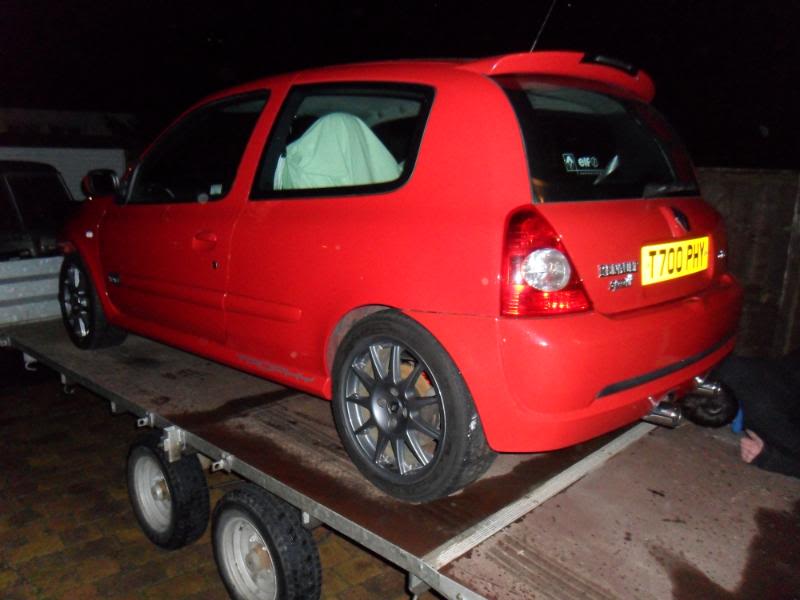

SO it was time for the trophy to come off the road for some TLC, front bumper painted, new tyres etc, the plan was to have the trophy off the road for a month to get some little jobs done I'd planned. But before that I had to have one last jaunt up to hartside in it, the night the insurance expired. After not even covering half the distance there the trophy died on me. I'd applied the throttle mid range in 3rd and there was nothing....oh no!

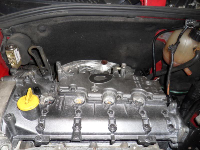

Upon further inspection the trophy has destroyed the top of piston no.4, snapped some valves, damaged the head and destroyed a spark plug. What happened is a mystery as we havent had the head off just put the telescopic camera down. What was apparent was whoever had done the 'big' service had completely threaded the spark plug and probably meant it wasnt sparking correctly. I found bits of smashed up plug and valve in the inlet manifold believe it or not :(

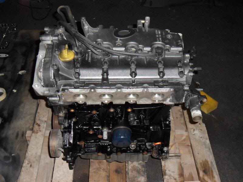

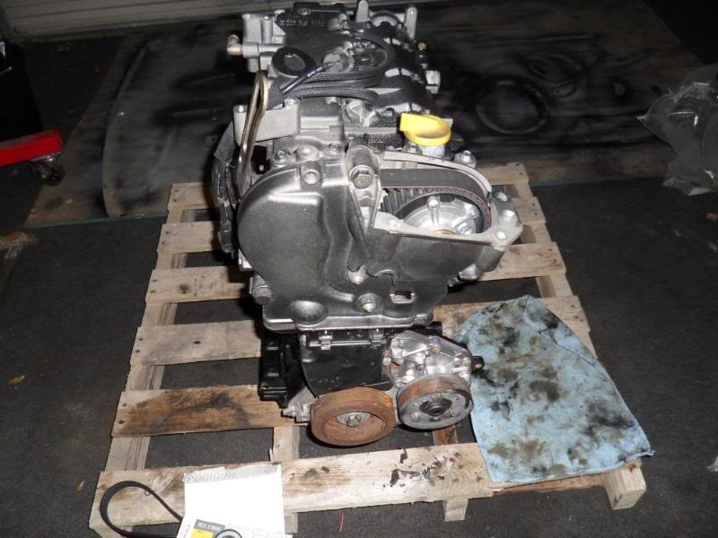

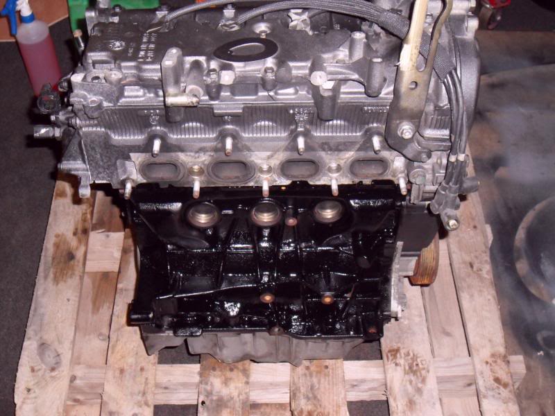

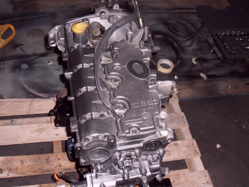

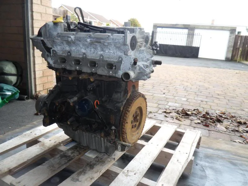

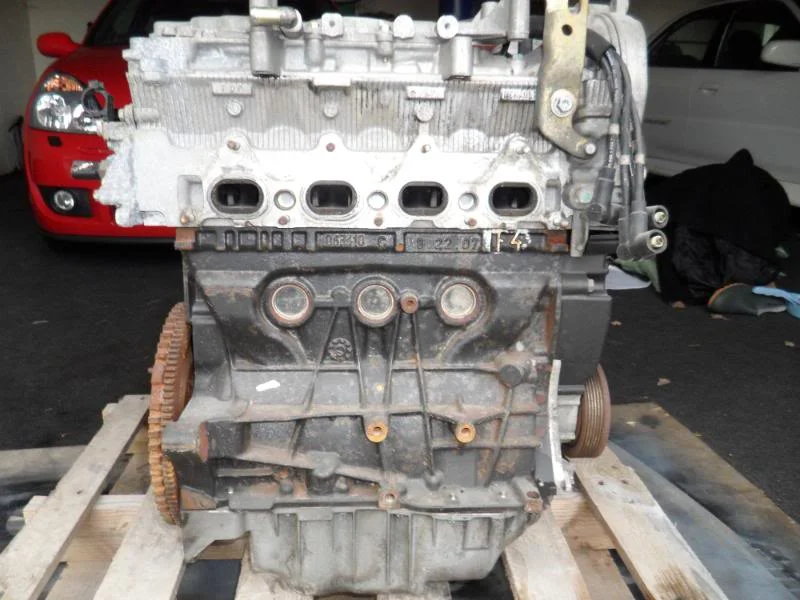

I've managed to source a 182 engine with 33k miles from local specialists N.E.R.P.

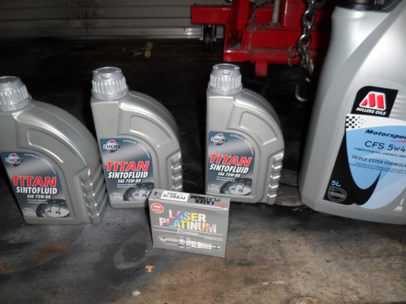

To go with the engine I'm also going to replace the original parts with the following:
Genuine Timing kit
Genuine Aux kit
Dephaser pulley
Waterpump
Clutch and master Cylinder

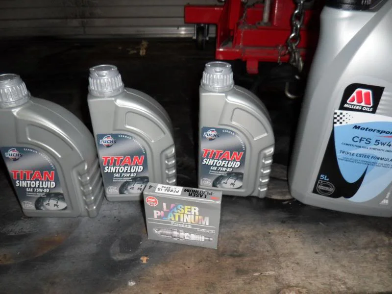

Millers Competition oil
Original oil filter
Clean ITG
Fit NGKR Plattinum Plugs
Replace gearbox oil with fuchs 75w80

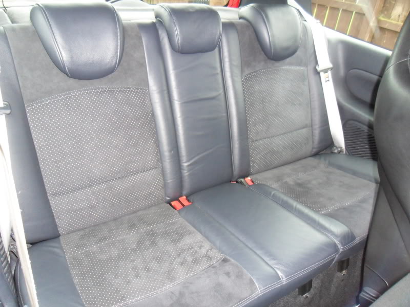

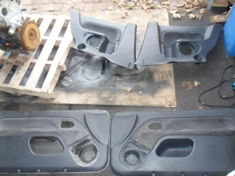

Half Leather Rear bench from 182
Suede door cards front and rear (still to be fitted)

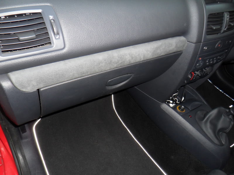

Alcantara A Pillars

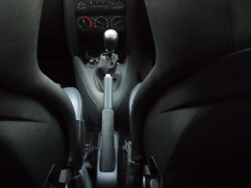

Alcantara handbrake cover

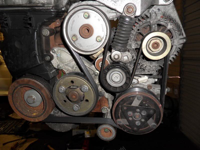

The trophy should be back up and running within the next week or two, hutchie is coming over today to do the belts, pulleys and waterpump.

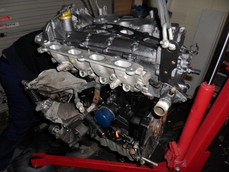

Some pics I've been taking of the parts arriving :)

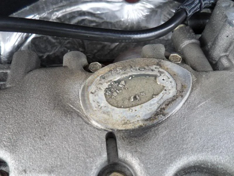

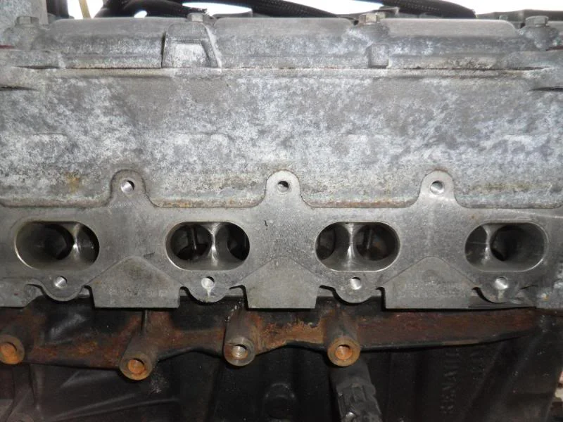

Some of the metal left from the inlet :(
As it stands
Somemore bits

Doorcards, still to be cleaned....

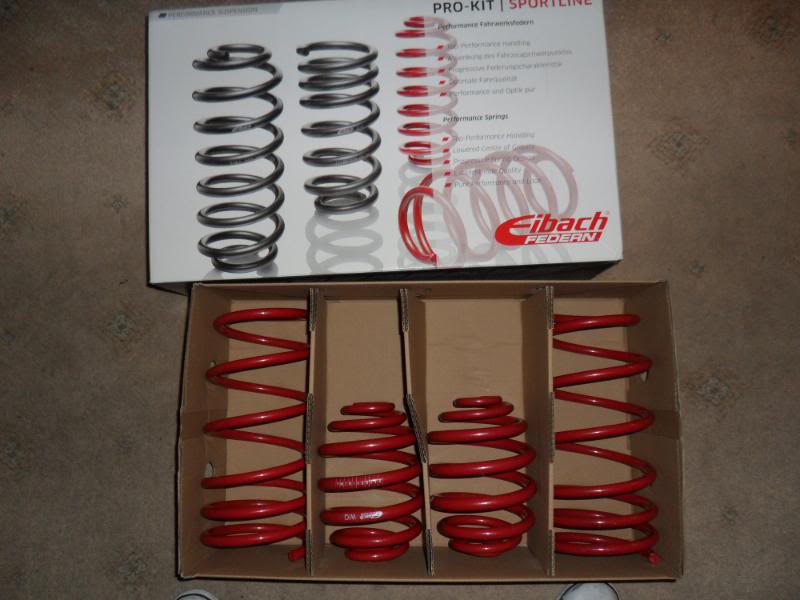

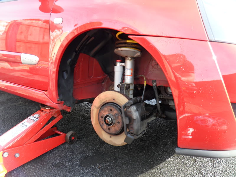

Eibach Camber bolts and sportline spings

182 Rear bench And alcantara bits

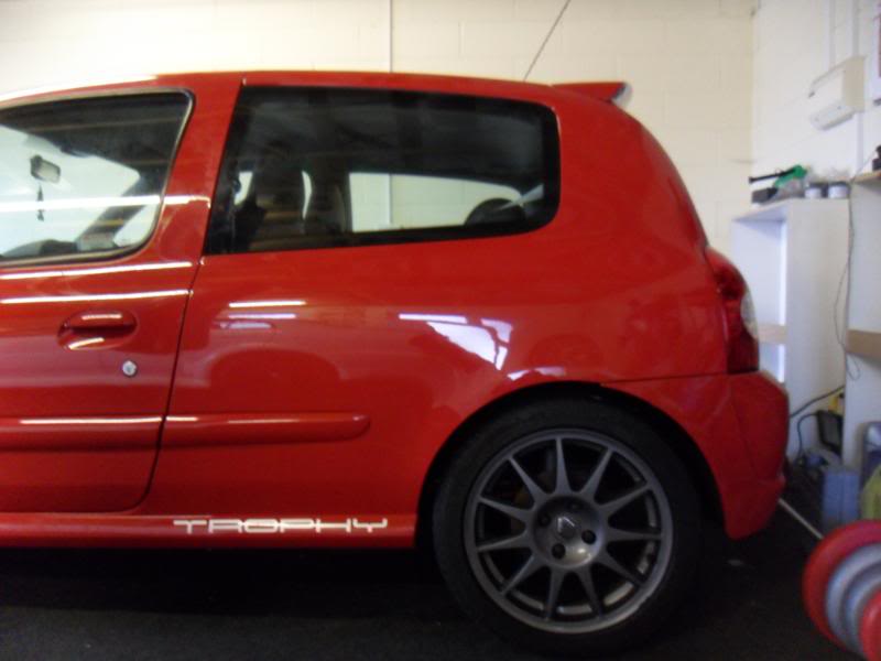

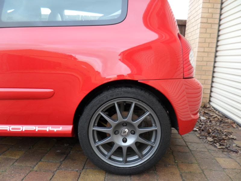

Archs cleaned

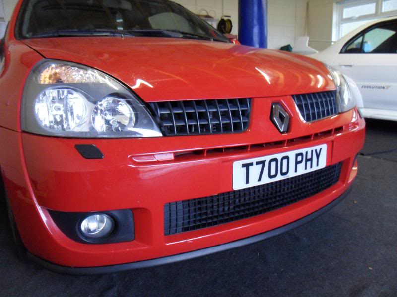

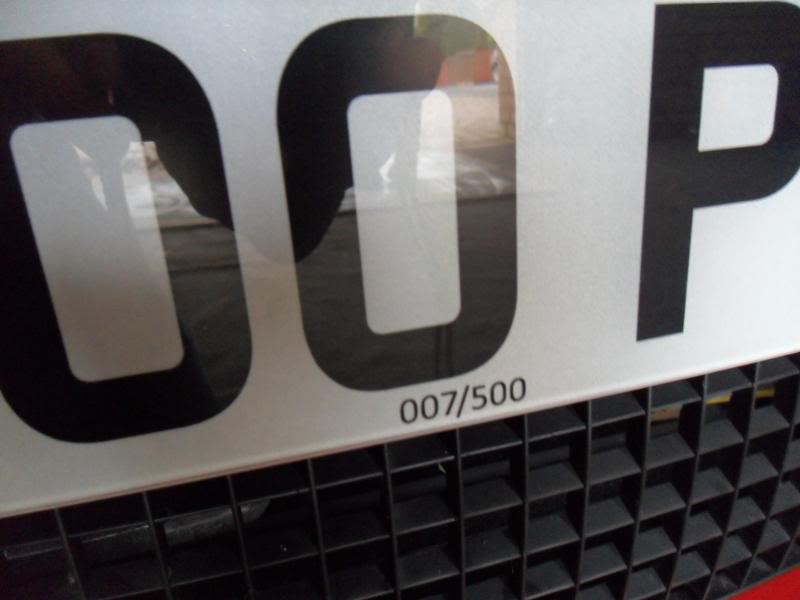

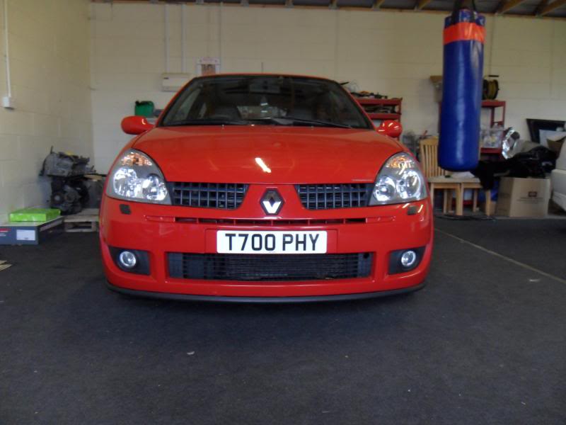

Front plate Removed, then smaller fitted, for ref its 440mm x 90mm

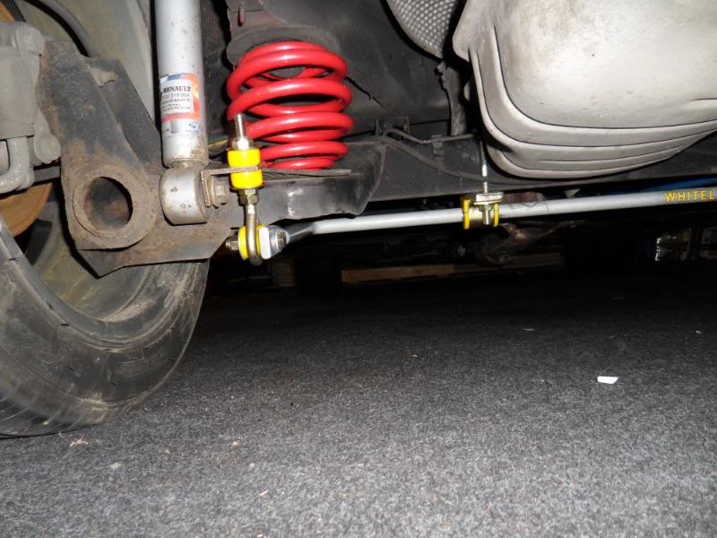

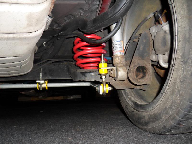

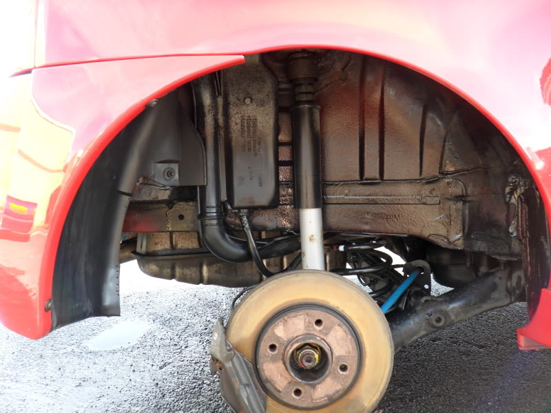

Whiteline and rear sportlines fitted
A little comparison for trophy springs. vs Eibach sportline springs

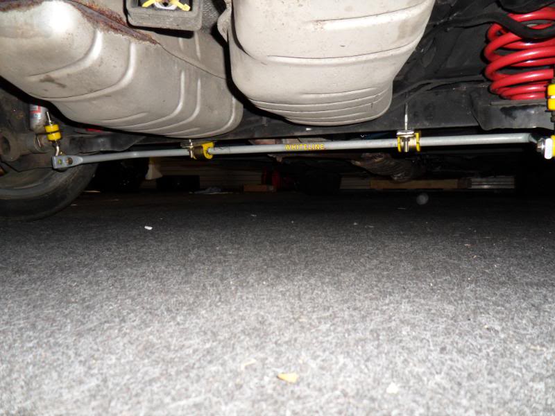

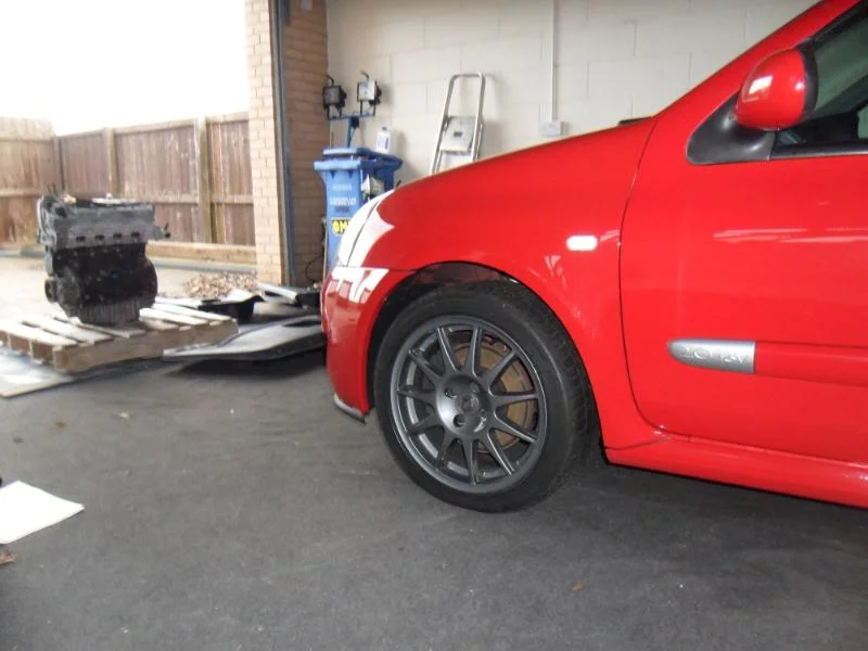

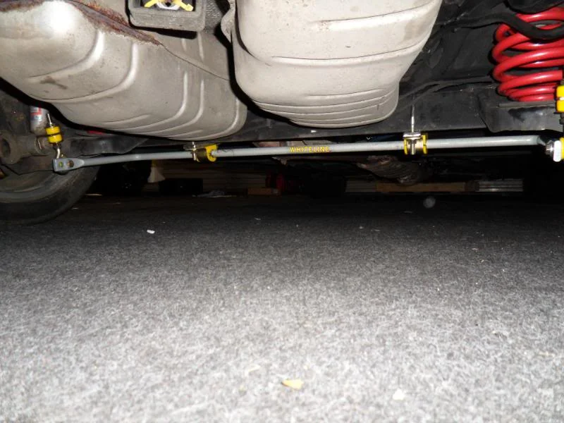

Yeah whiteline is easy, took about an hour including changing the springs over, not bad for doing it on my back, if you had a ramp it would be half the time or less

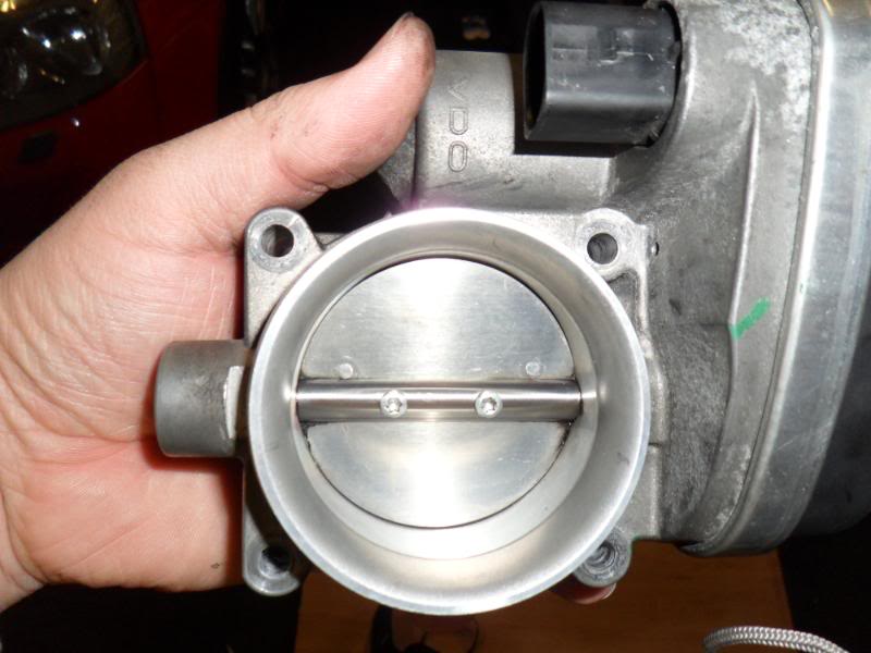

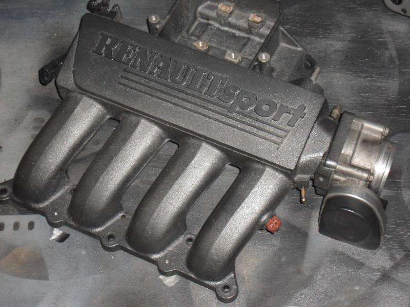

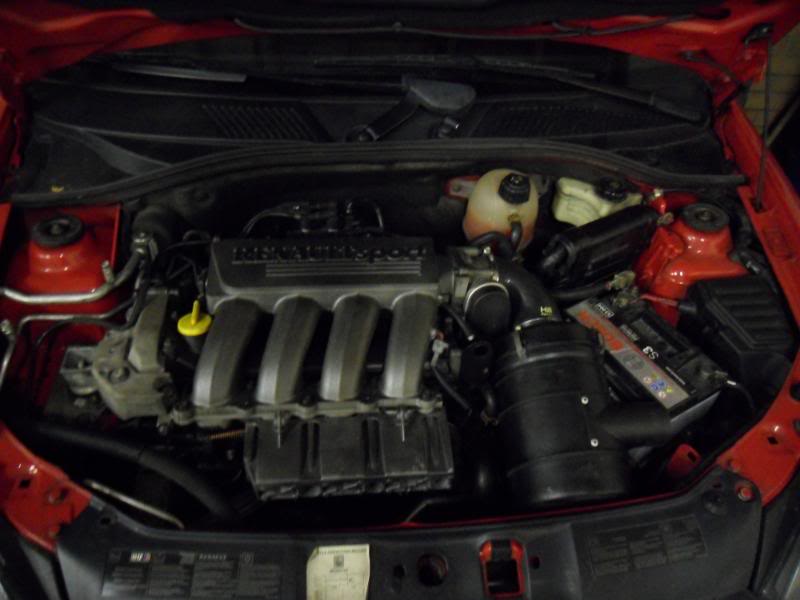

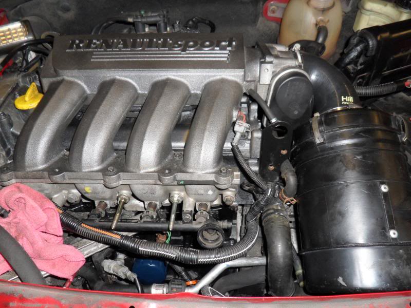

A little update, painted the engine a bit today, its not perfect but better than the rusty/oxydised look

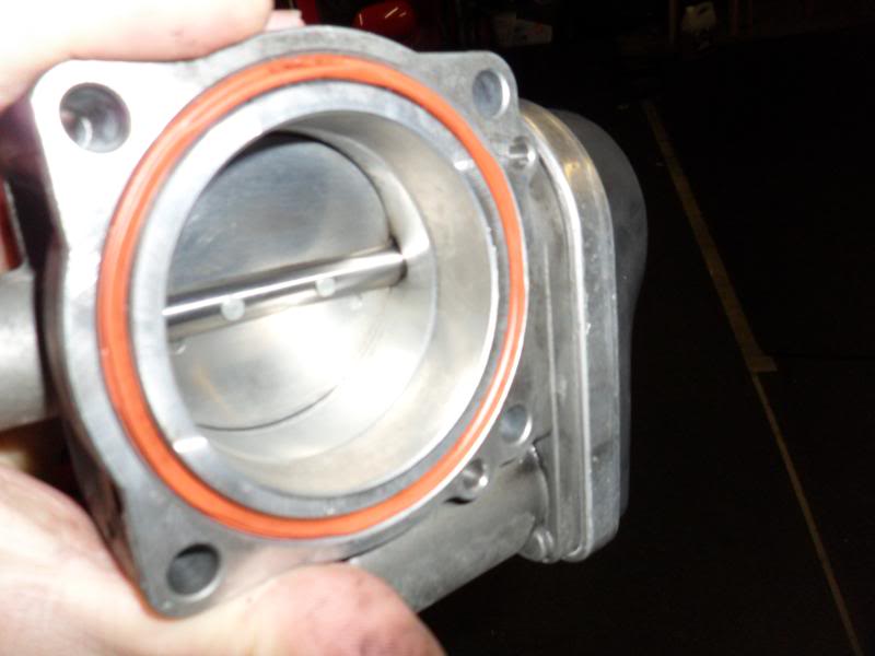

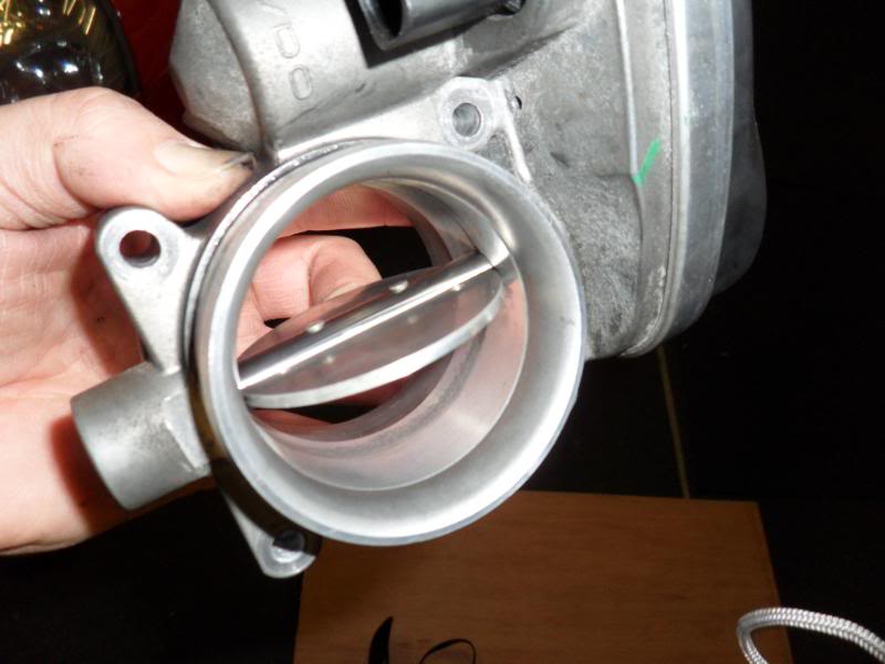

I also took the throttle body off to give it a quick clean as it was gunked up off the ITG

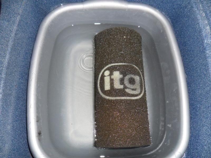

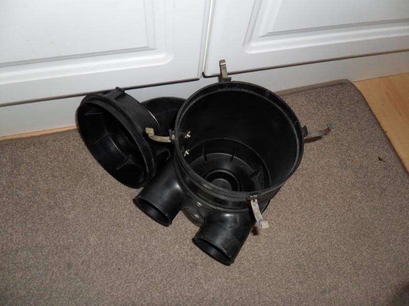

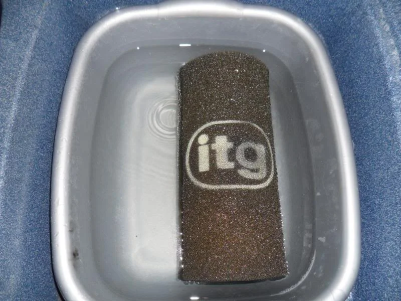

I've also bought a ph1 airbox, it has my old ITG panel filtler in from my ph1 172 so is about 2 years old, I thought it was a good oportunity to give it a bath. I degreased the filter, airbox and hillpower bend
I refitted the throttle body to the inlet manifold that I'd given a coat of paint
Tonight hutchie is coming over to do all the belts, pulleys, water pump and dephaser pulley :)

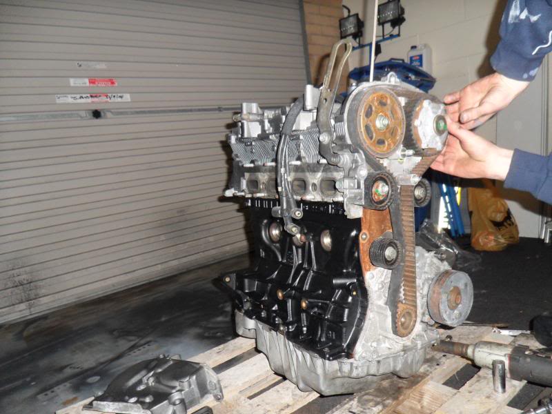

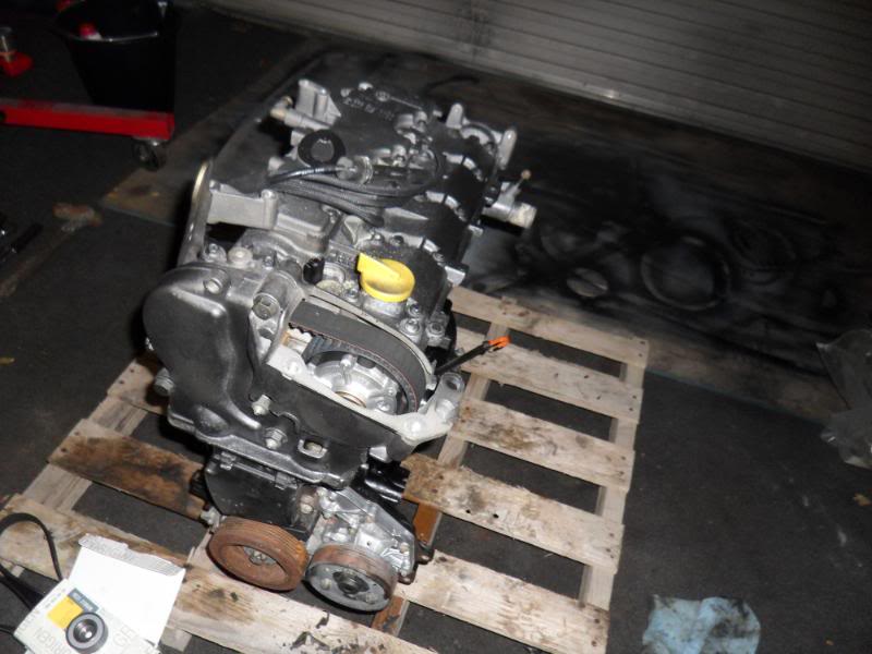

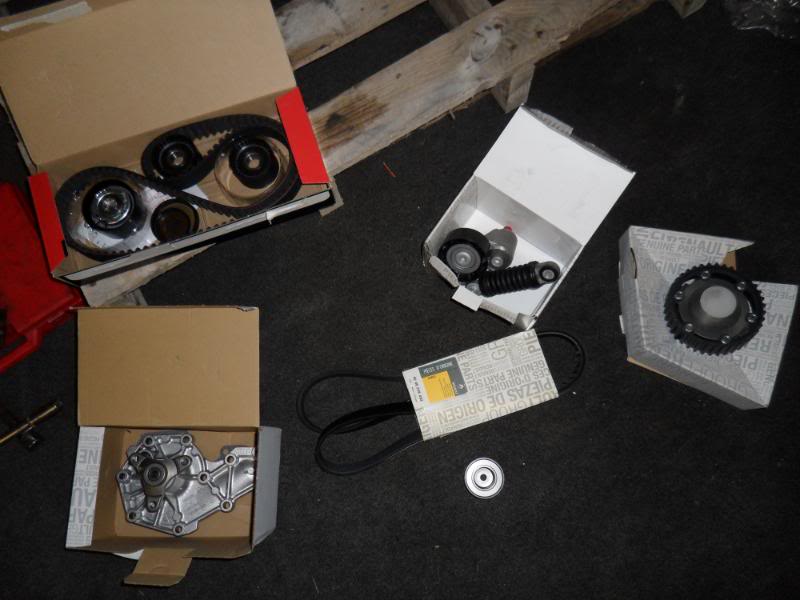

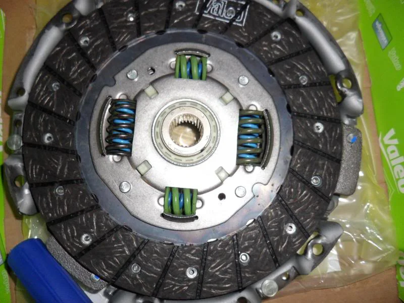

So a few pics of the 'goodies' my newly acquired f4r was about to meet.

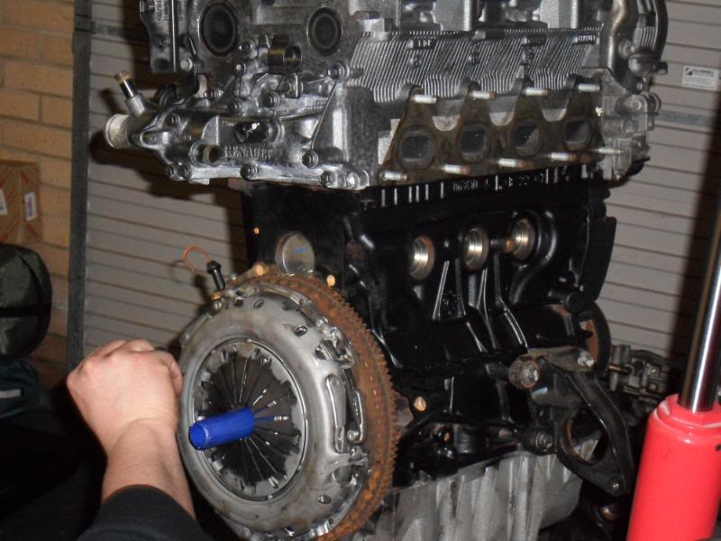

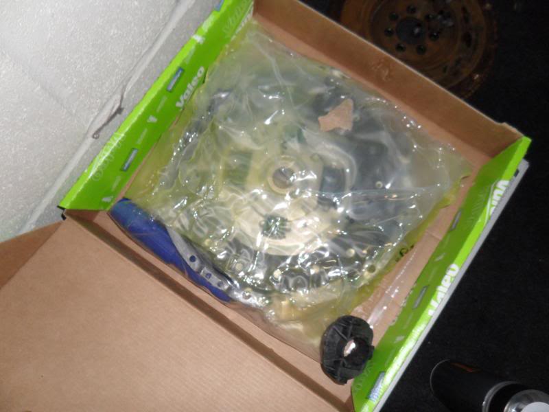

Valeo clutch kit waiting for install on saturday :D

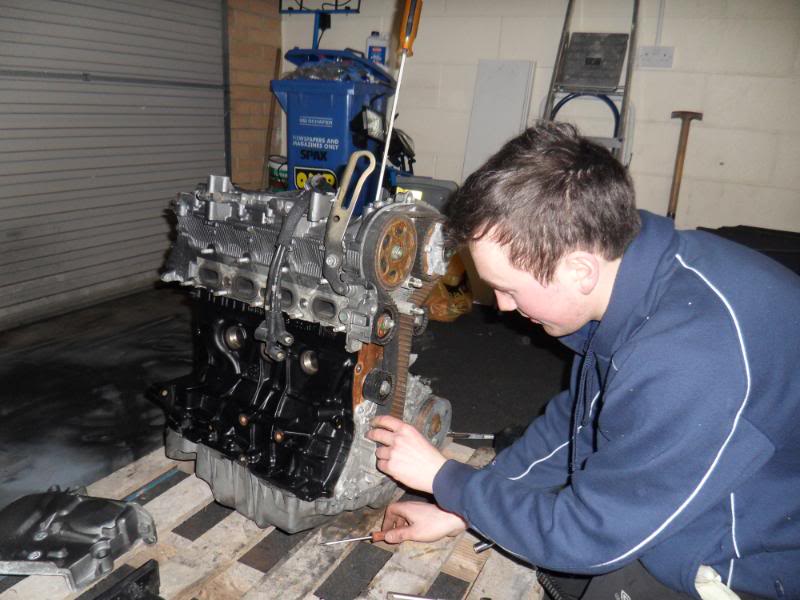

And the man himself dismantling the old stuff
All done, just have to put the aux kit on as obviously the other stuff is still attached to the trophy
Thanks again hutchie, top work

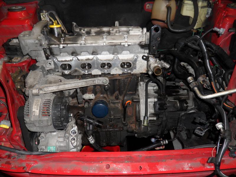

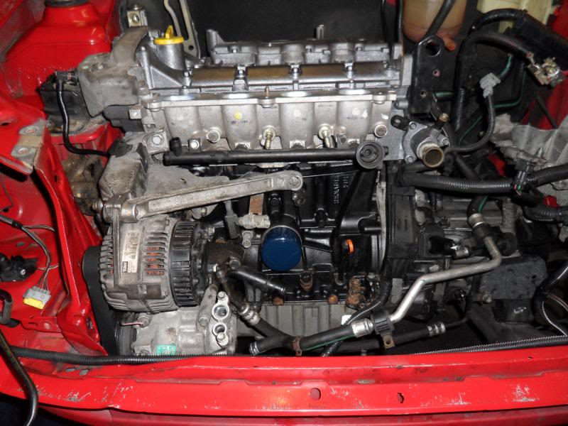

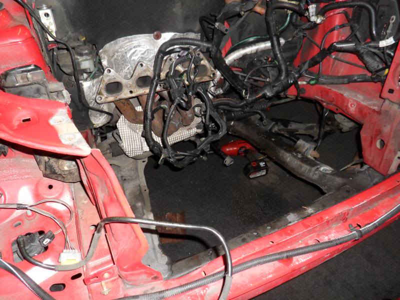

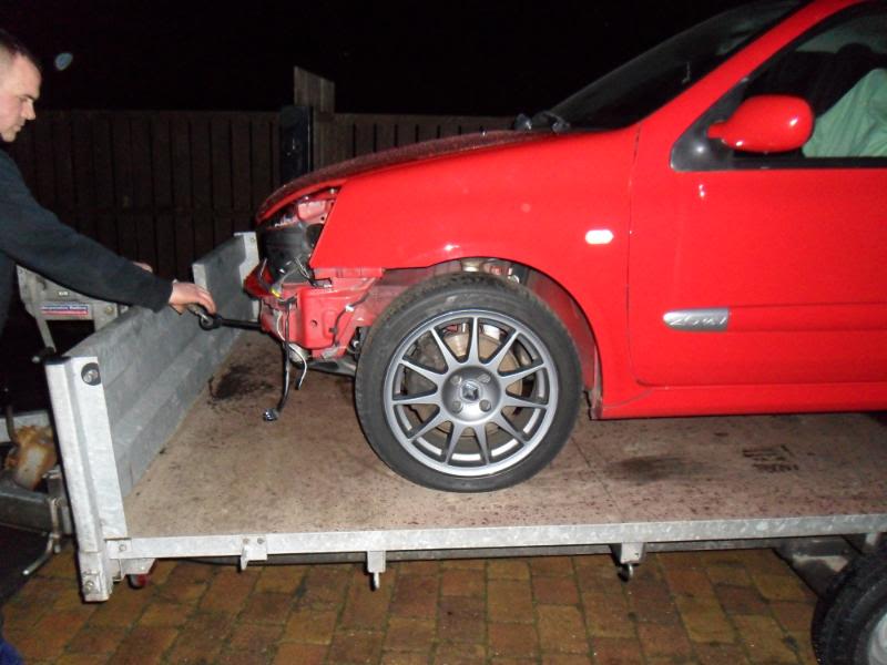

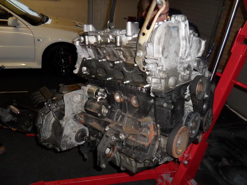

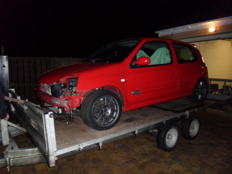

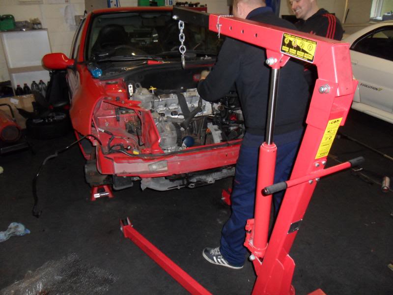

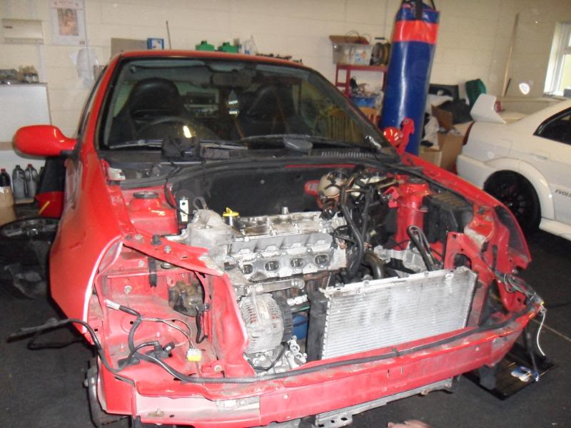

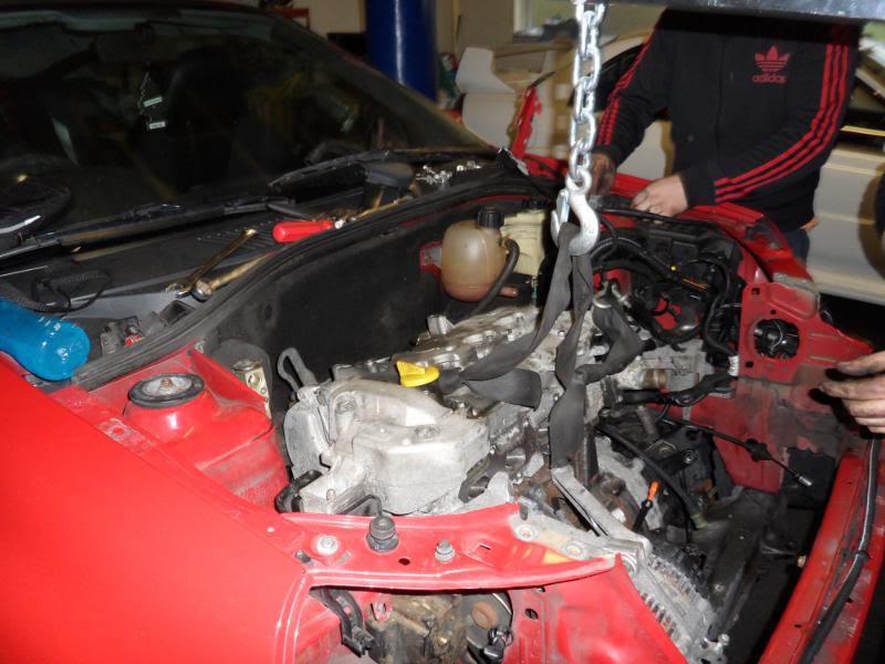

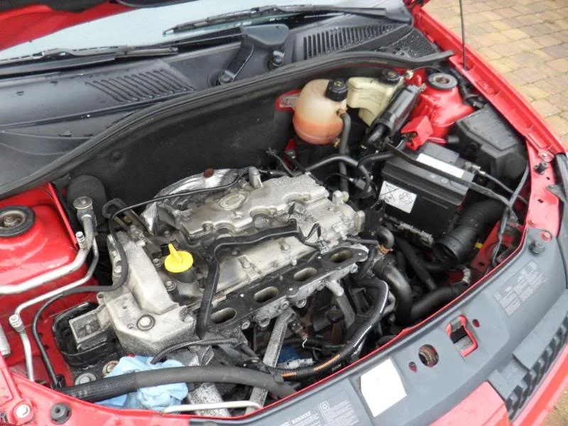

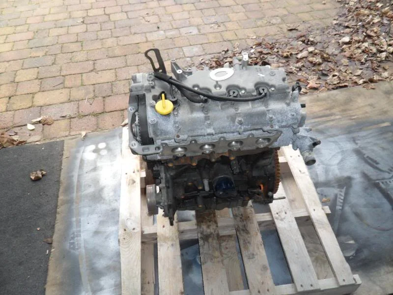

Car starting to be dismantled for new 33k mile engine
Out she comes
I couldnt resist

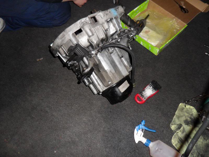

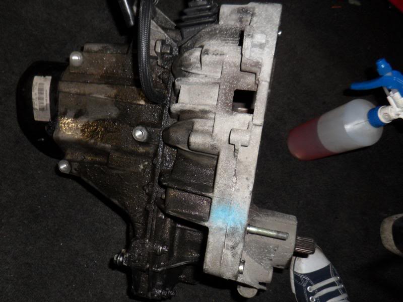

Gearbox looking a bit grubby after 70k miles
quick clean, still not perfect but seems I will have another oportunity to clean it next week :(
Lower inlet on
New clutch :)

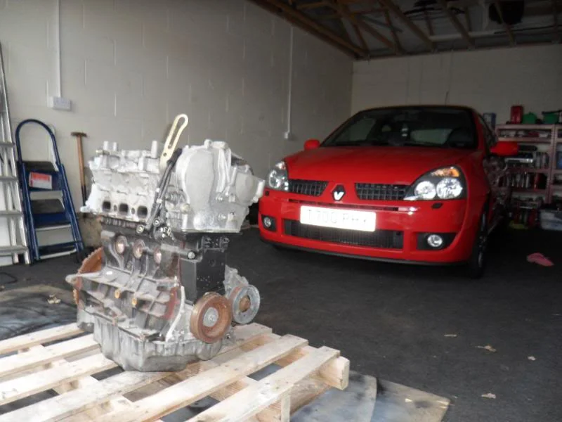

New engine in

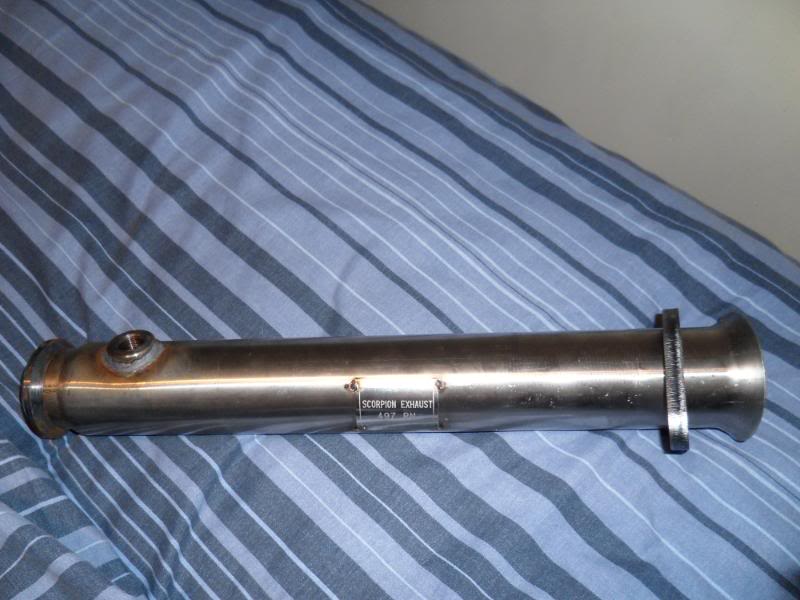

scorpion de-cat

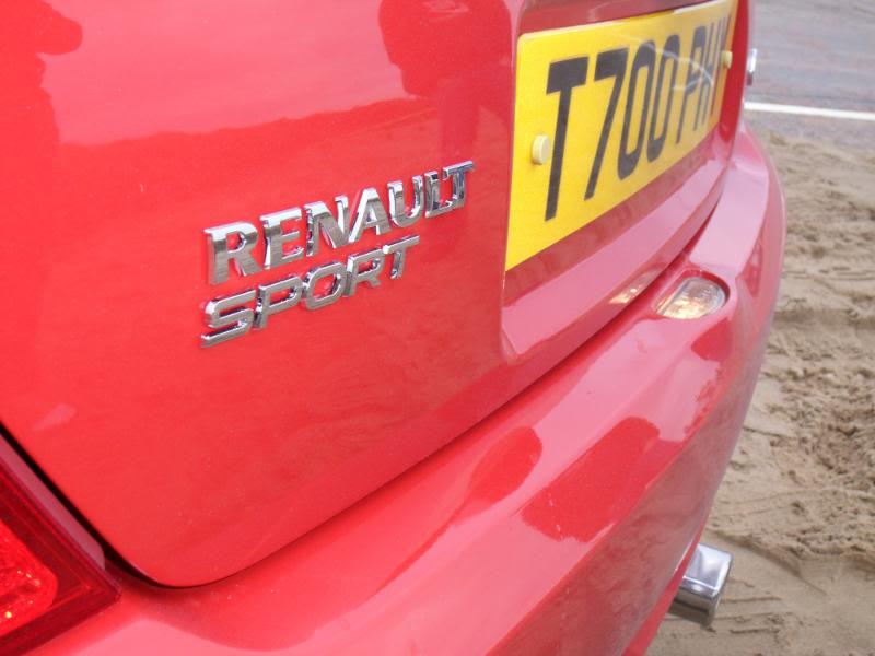

New Renault sport badge

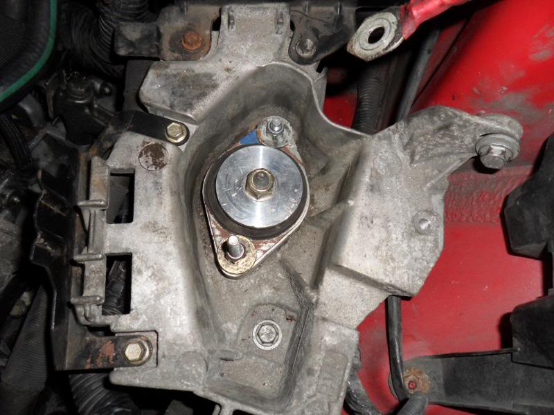

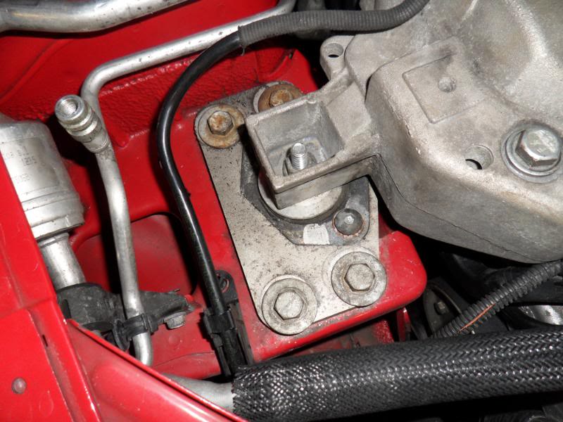

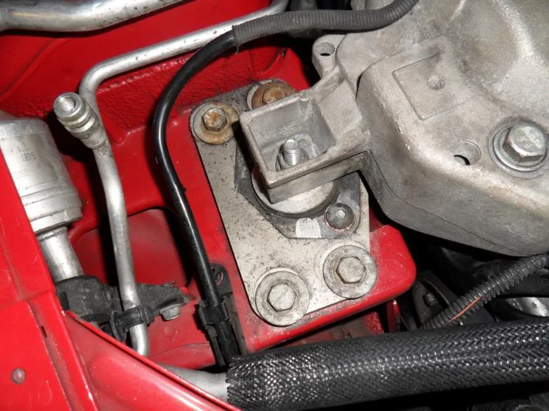

K-tec uprated engine, gearbox and dogbone mounts

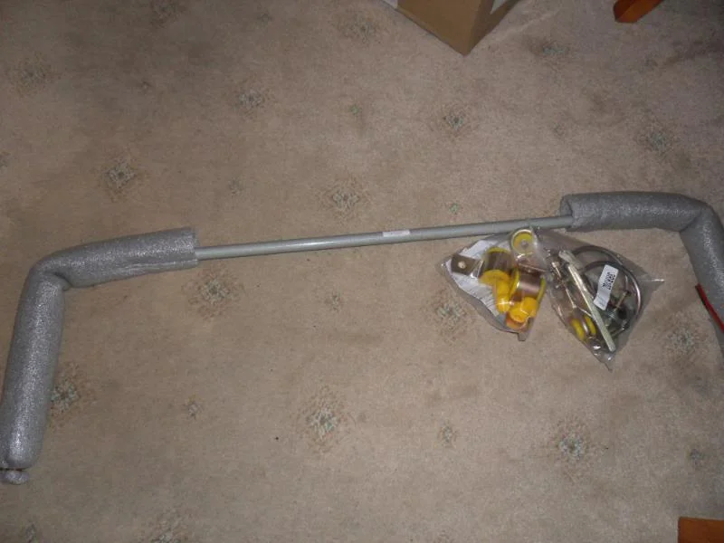

Whiteline Adjustable rear Anti-roll bar with eibach sportline springs

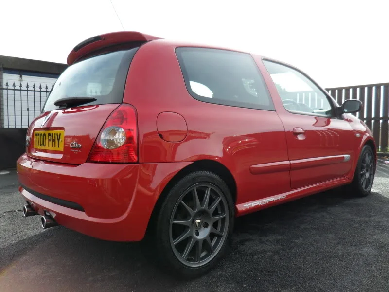

No plate <3
Small Plate

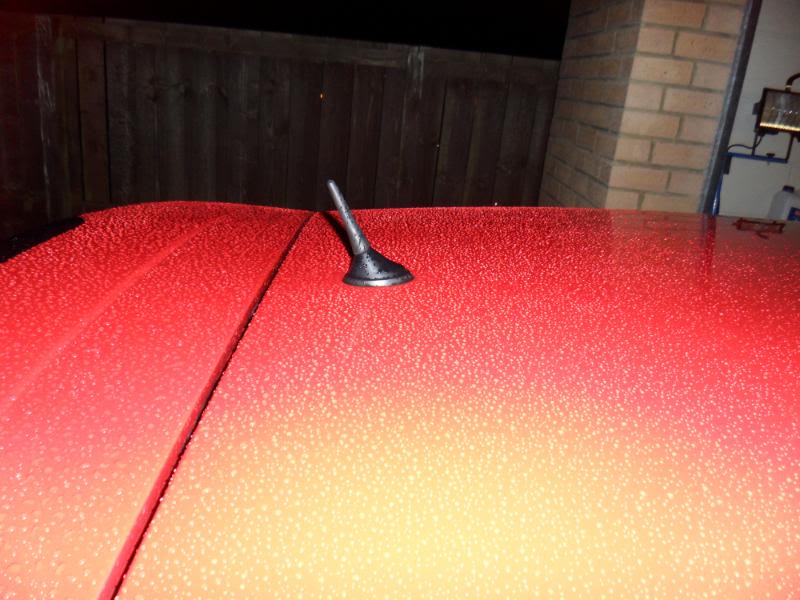

Reading through i noticed you mentioned about getting an alcantara gear stick gaiter, where can you get them from as i want to get one for mine as the clips on my leather one have broken so it's kind of wedged atm lol?
And also what is that stubby aerial off of?
Cheers
Chris205
  Many Things
Looks really good, love the plate too :)
Cheers
My mate Austin-182 is starting to do them and he's making me one soon, should hopefully finish the interior off nicely. Not sure what the aerials off mate I just got it off my mates 182 that's being split for parts
