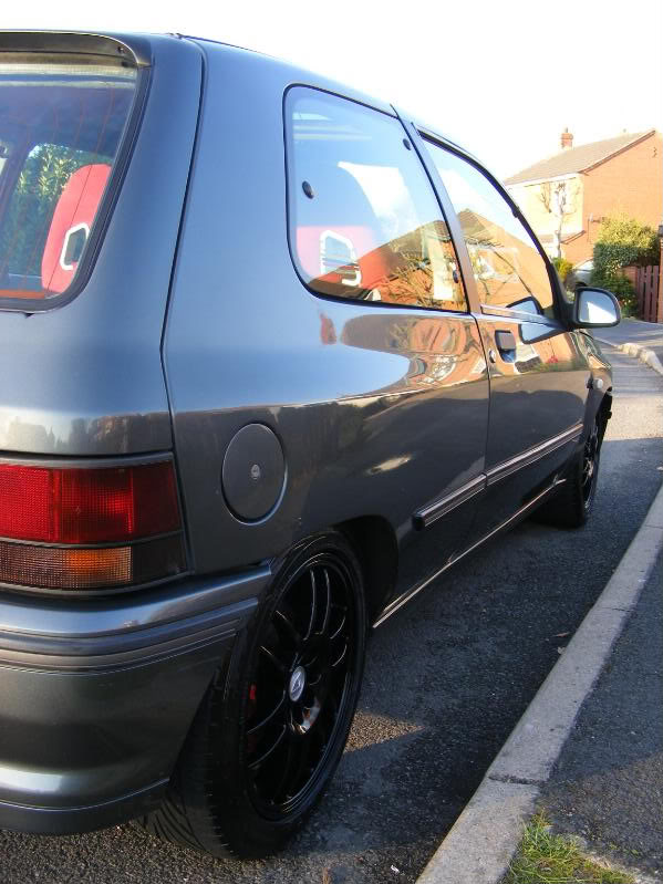

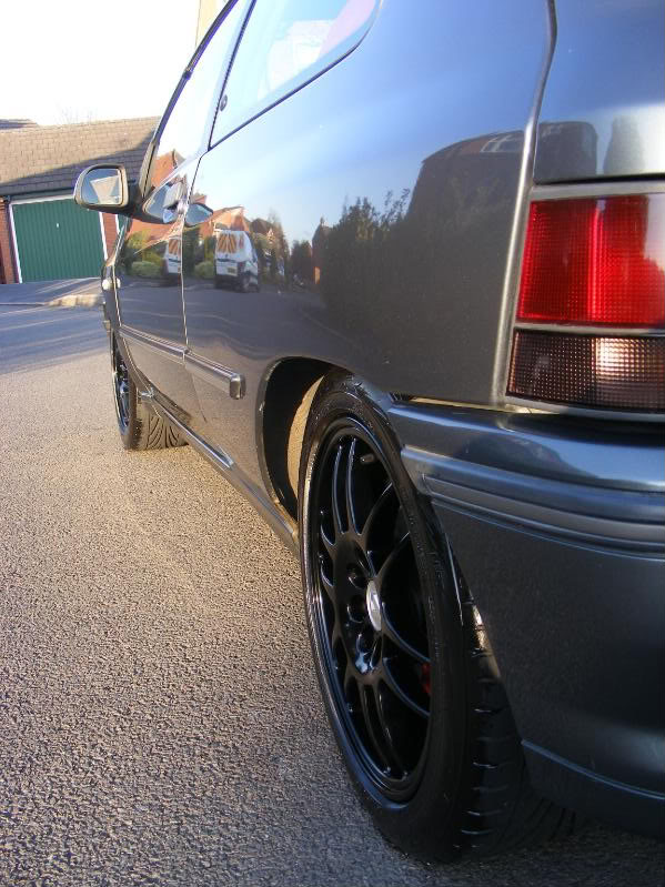

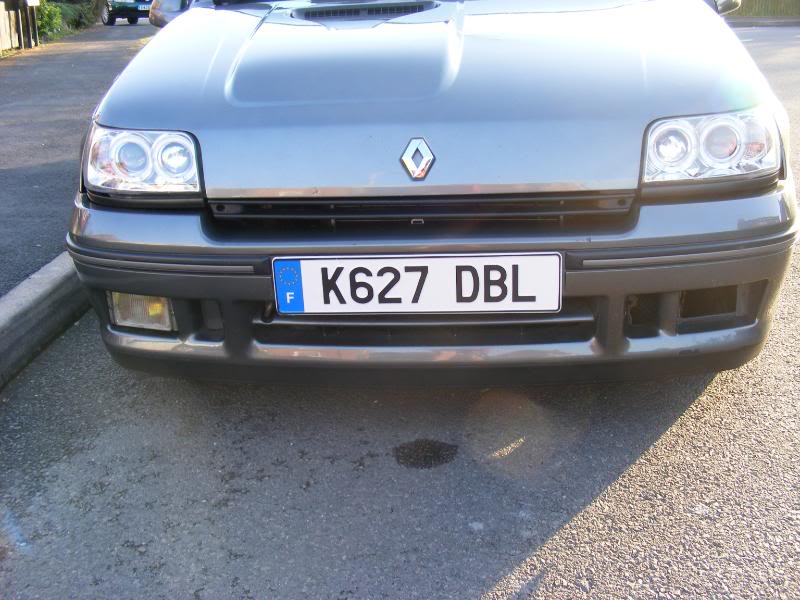

As some of you know I have recently fitted my Megane F7R engine and it's running spot on. I did have trouble getting it running but it turned out to be the fuiel injectors seized up. But it's fine now and does seem fast! I gave it a good clean and polish tonight and here are some pics! (not the best of quality but the sun was glaring and I was being quick)

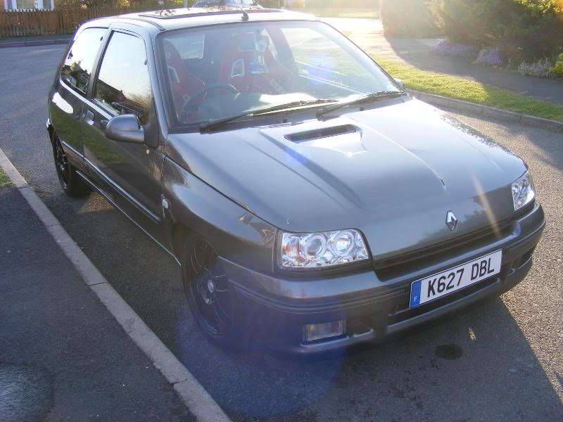

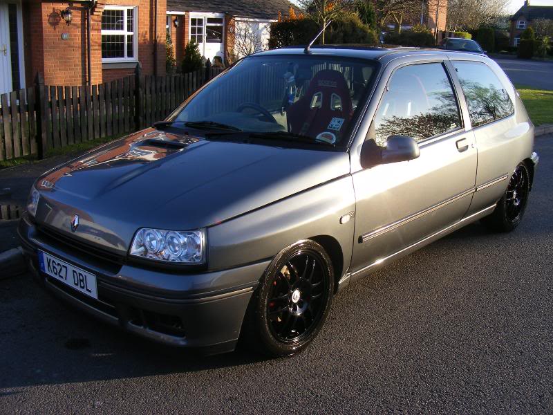

Back to ph1 grilleness! Ph1 ftw!

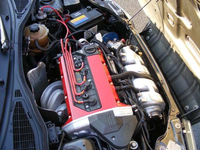

And one of the bay as it stands right now. Needs some covers and general tidying and stuff
Here's a quick spec list for those interested.
Renault Megane 2.0 F7R bottom end (55k miles)
Clio 1.8 16v head
Kent cams
Piper vernier pulleys
Renault 5 GTT uprated clutch
Clio 16v flywheel
JB3 valver gearbox
Standard 16v exhaust manifold
Gunnerchip in ph1 ecu
Hillpower Induction kit

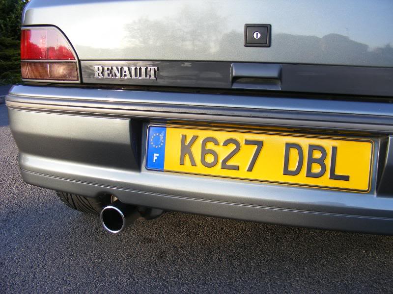

Magnex exhaust system and decat
New parts during overhaul:
Cambelt kit w/ tensioner and idler
Bottom end gasket set
Headgasket set
Valeo uprated clutch kit
Auxilliary belt
Waterpump
Thermostat
Spark plugs
Oil filter and oil
Thanks for your interest.

Brad, you know I like the Tungy! :Approve:
Looks very clean in the pics, unlike how it was when you came to Star City.
M
mini-valver
Dan, you'll just buy it, look at it and sell it ;)
The only thing I'd change is the lights as they dont seem to sit right, other than that It's MINT! ONe of my favourite cars on here since I saw it at last years Star city meet, credit to you mate!

Looks like all of the hard effort has payed off, imo i would get a new pair of headlights as it would finish it off. :)

Amirs did look nice but unfortunately he wasn't the worlds greatest engineer, and the current owner has had loads of problems. I'm tempted to put my standard lights back in if I can find them, and maybe get a HID kit this summer. The trims under the lights sit really s**t, they dont fit like they do on the originals :( Dan you just sold your 172 and looking to come back to the old skool then?

It's where the wing meets them at the bottom more fella....
Brand new standards and its perfect!...................................................IMO :eek:

What does it do if u reaplace the F7R head with a 16S/16valver head? nice car tho.
  Tungy
Cheers guys. Bash, the megane F7R head runs with DIS (Distributorless Ignition System) basically it's just one big pack that goes straight to your spark plugs, and it won't run in a clio 16v without
A. Standalone Management
B. Having head machined to fit a dizzy
So it's easier just to fit a williams f7r or 16v f7p head. Finding a williams head can be hard and I got quids in by selling the megane head and buying an f7p head.
