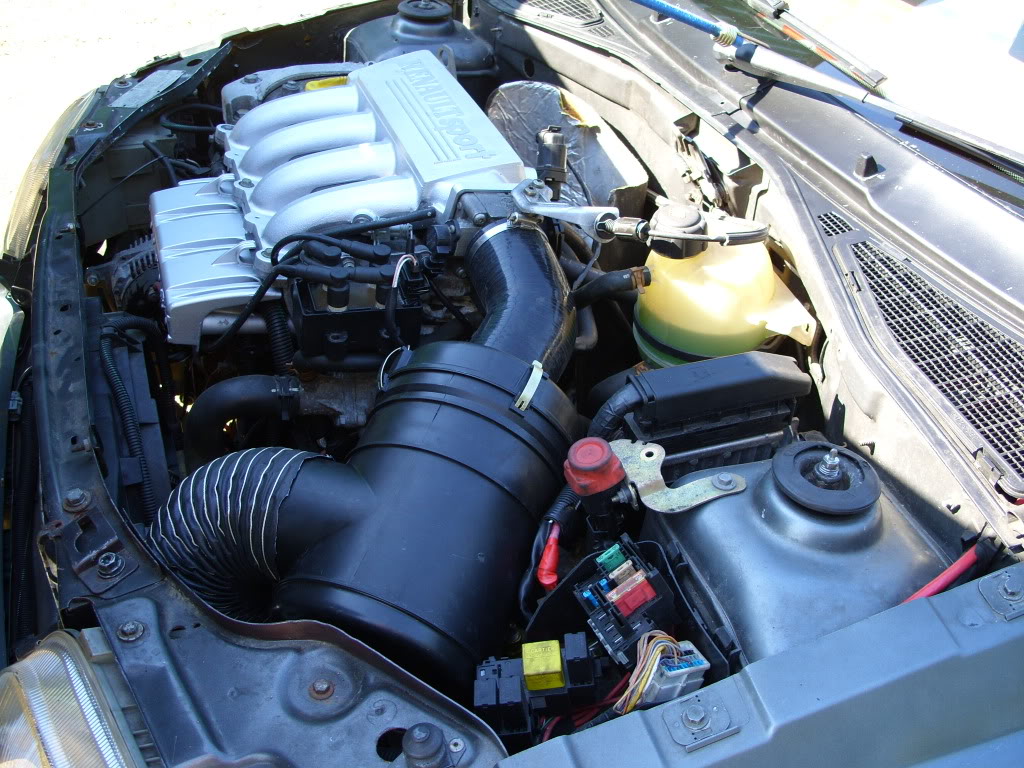

Cheers guys. Bash, the megane F7R head runs with DIS (Distributorless Ignition System) basically it's just one big pack that goes straight to your spark plugs, and it won't run in a clio 16v without
A. Standalone Management
B. Having head machined to fit a dizzy
So it's easier just to fit a williams f7r or 16v f7p head. Finding a williams head can be hard and I got quids in by selling the megane head and buying an f7p head.

I ran it for about 3000 miles. Was fine but there was room for massive improvement.
The 1800 head (imo) restricted the car quite a lot compared to Williams i've owned in the past.
He built a good engine though! Didn't use a drop of oil or water in the time I owned it.

All I can say is that I've had 3 clio 16v's, and 3 williams and the williams is a completely beast. I personally wouldn't bother fitting a 1800 head to a 2.0 bottom end.
Either fit the complete 2.0 or tune the 1800 with bodies etc.
