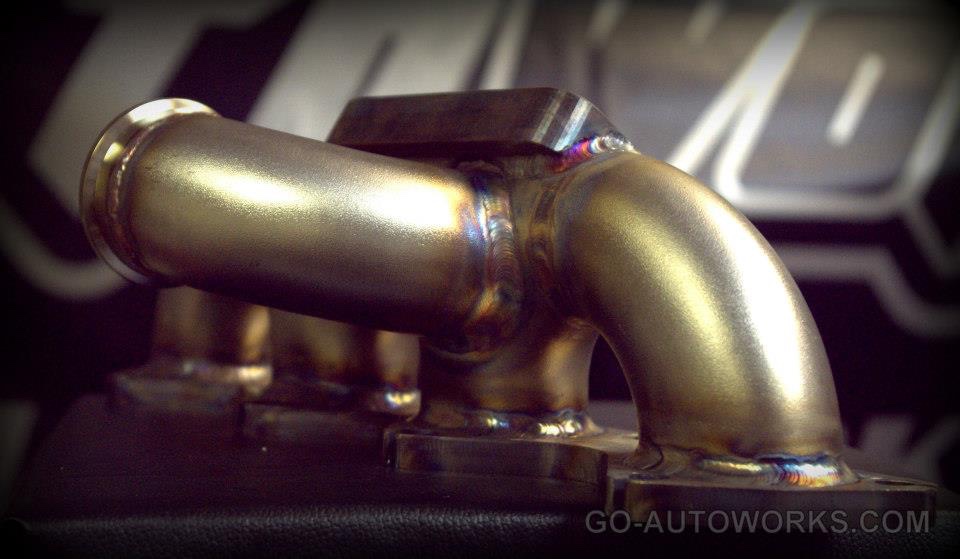

Have you any pictures of a tubular manifold in situ? Do you use yours regularly on the track?
think the only pics i've got are one on my lads twiglet?
View attachment 1429670[/
Nice! The problem is with internally gated turbos, not being able to clock them as easily, so I’m either going to run an external or keep the turbo off the back of a log style tubular manifold, or combine both with a v band flange and external wastegate.. going to be fun having a play
