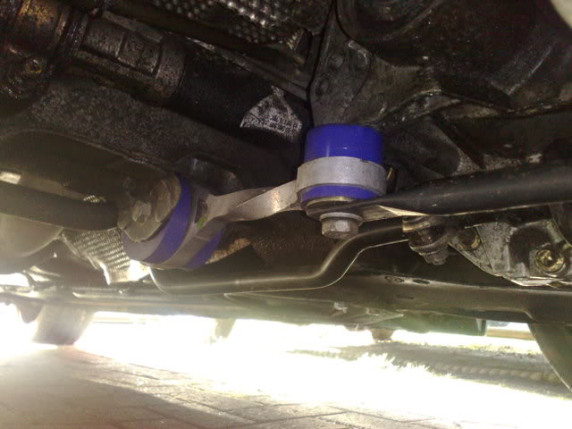

Got a new part come the other day so fitted it last night :) miles better now as the rubber went on the other one.
As for the boost leak i have no idea now whats wrong. Pressure tested the system and all is OK. Its very tight on the manifold and onto the engine. When you accelerate in 2nd it drops its boost faster than if your in 4th. If i take the boost controller off it still drops its boost even though its only boosting to 0.6. Could it be a map issue???
