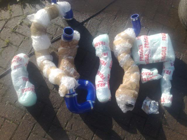

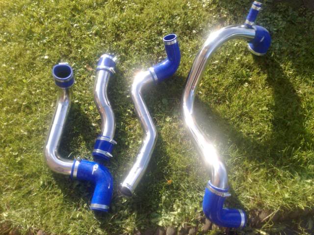

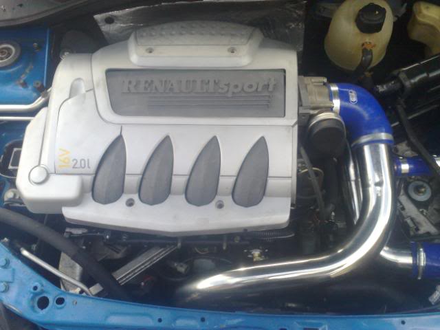

heres my pics from today, went down to help put the engine back in....
clutch arrived:
clutch fitted
bay empty ready for fitting....
after a few tries, ryan decided to listen to my idea about the way the engine should go in......and wola ;)
i then left....think hes got all the piping and wiring back on now....exhaust + downpipe are in place....
All wired up piped up etc 100% in now :) turbo will be here first thing friday the rest here tomorrow :) so long day tomorrow

Sensor have arrived ryan, so car is running fine now :) So let me know when i can pop round :)
Nar easyer to fit turbo in lol. you can come tomorrow if you like??
Try not to run the car much before you come here mate. I will run the car in on the dyno to try get the rings to seal on the bores :)
This is one of the quickest projects i've ever seen lol but it seems to be coming along nicely. Be very interesting to see how much power it produces in the end.
