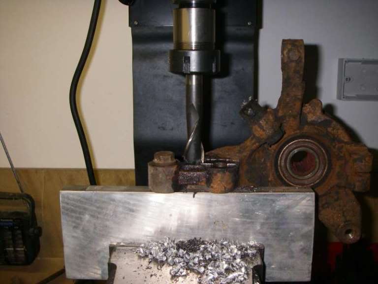

When it came to making the Twingo front dampers fit the 172 hub carriers the first job was to thin down the 26mm thick clio items to the 23mm of the Twingo. I looked at the carriers for a while before finally making a jig to hold them so that I could machine them on my mill.
when it came to it I was able to use the same jig to machine the dampers with 14mm holes in the correct position to both fit the carriers, and give a sensible camber angle. This involved a lot of dummy building, head scratching, and squinting. Strangely they came out pretty well.

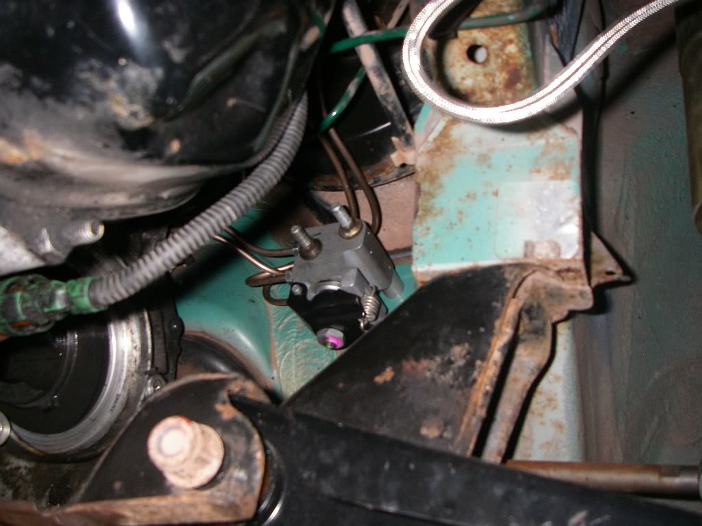

For the brakes I bought DS2500 pads, Brembo disks, and a set of goodridge hoses in Twingo fitment.

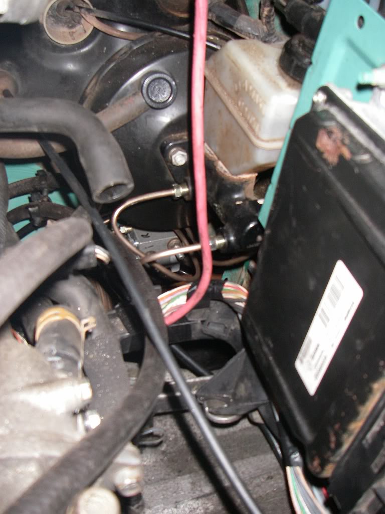

I couldn't find space for the brake pressure regulator at the rear of the car, so decided to fit it under the servo at the front, that being about the only space large enough that I could find.
I ended up making up all new brake pipes in the end as nothing was quite standard any more.
So that was it, fully working brakes :D

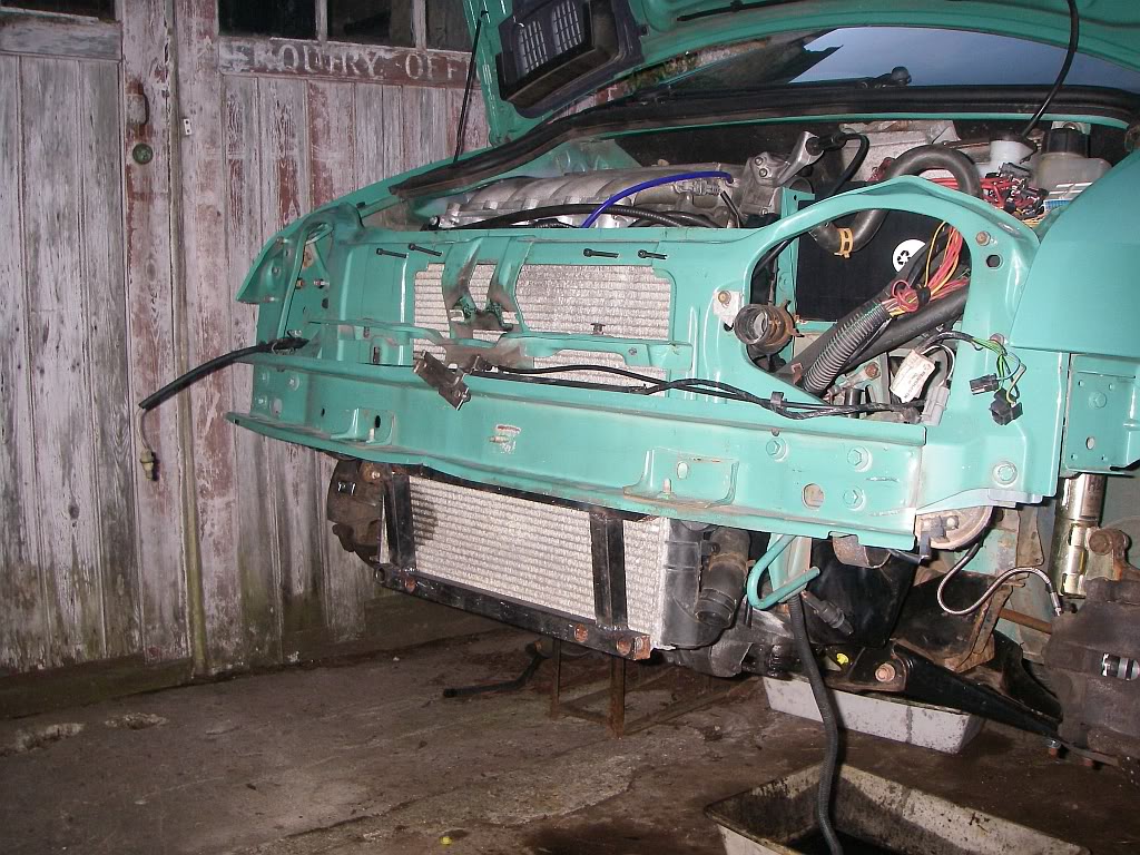

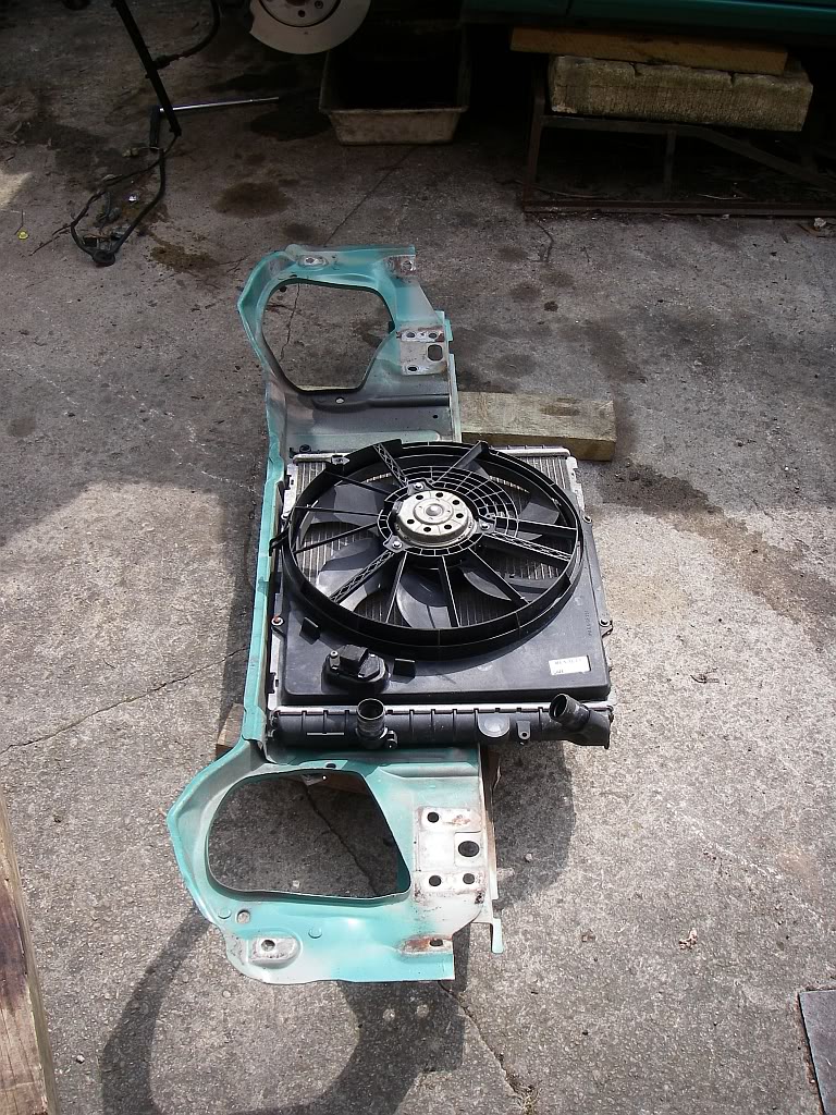

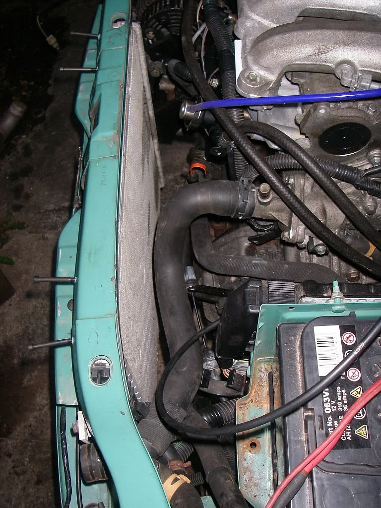

I knocked up a bracket to hold the 172 rad onto the Twingo front panel from a bit of my old trailer tyre rack, fear not, it was pretty thin, and thus light

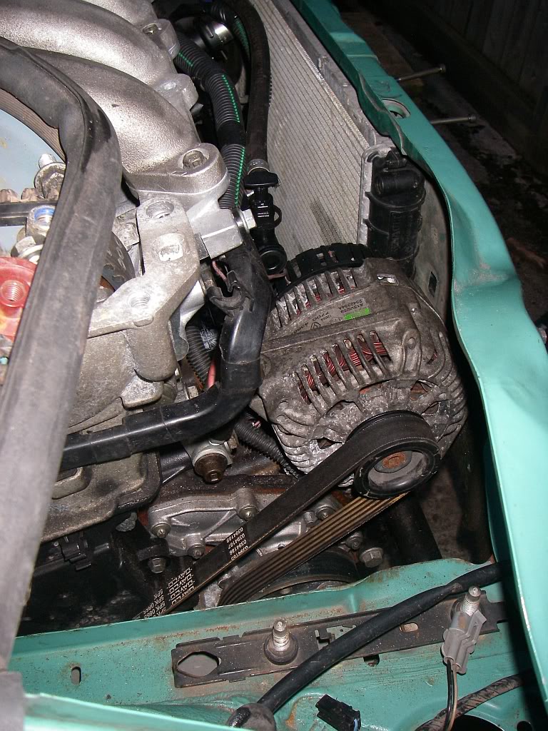

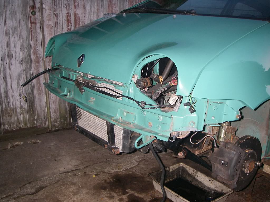

With the rad bolted on I tried to fit the front panel onto the car, first of all the water pipes were in the way, so I removed them and tried again. Then the clutch arm was hitting a fan support, snapped the support off and tried again. Then the fan was hitting the wiring support bracket on the gearbox, so I cut that off and tried again. Then the fan was hitting the gearbox - forkit, I removed the fan and tried again. It now pretty much fitted, although the rad hits the engine mount I made
. I'll need to cut the bracket down when I get 5 minutes, but for now the rad just about fits, albeit without pipes or fan.
It looks like I'll be able to use the Twingo fan with a custom bracket, and maybe the pipes will fit with a cut and shut.

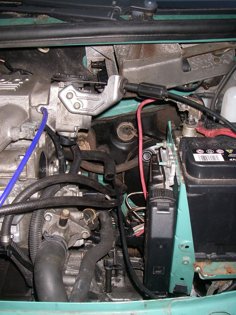

I've sorted out the throttle cable by rotating the throttle body 90deg and using the standard Twingo cable. Unfortunately the bracket does go right where I expected to put the intake pipe and filter...
The good news is that I can still close the bonnet
