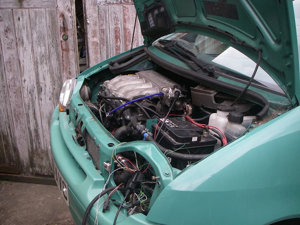

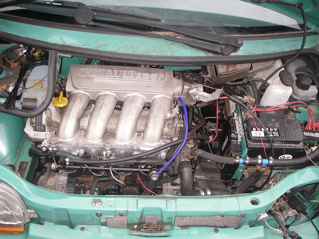

I've got some pictures showing how little clearance I have between a few bits, all being well I'll post them tonight.

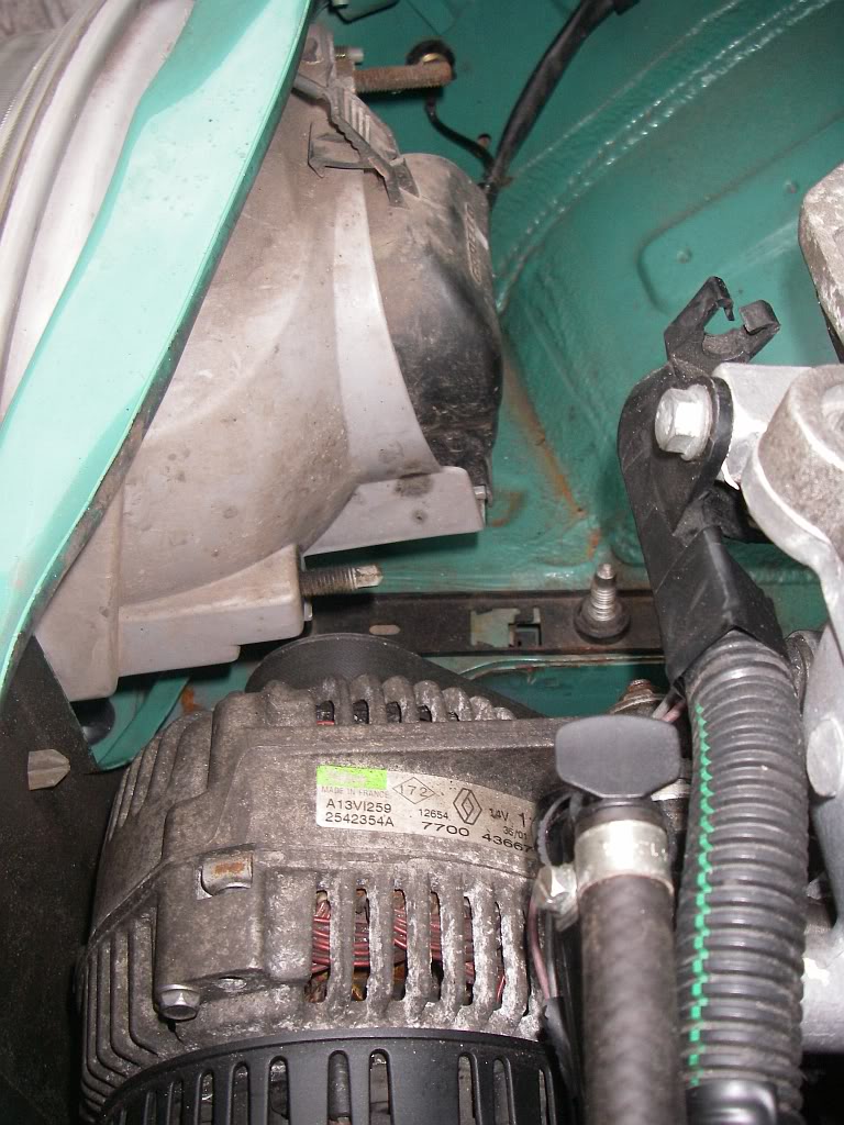

you can just see where I trimmed the engine mount to clear the rad.
The alternator pulley is pretty close to the headlight, and no it's not the angle making it look close :)

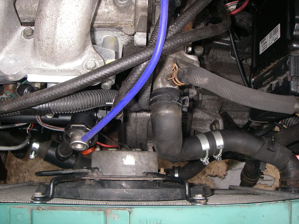

loads of space between the fan and the gearbox, although the top hose needed a bit of cut and shut to miss everything

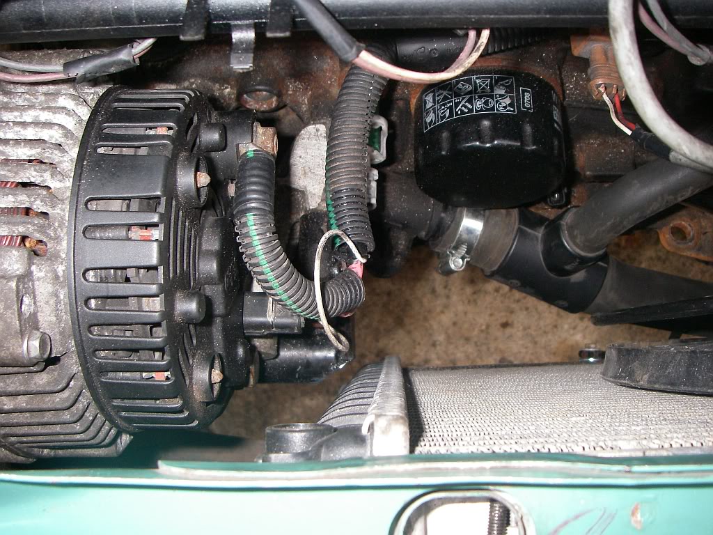

I found a space between the ECU and the engine for a small air filter, just need to get it now.
just a couple of wires to push back in through the headlight aperture.

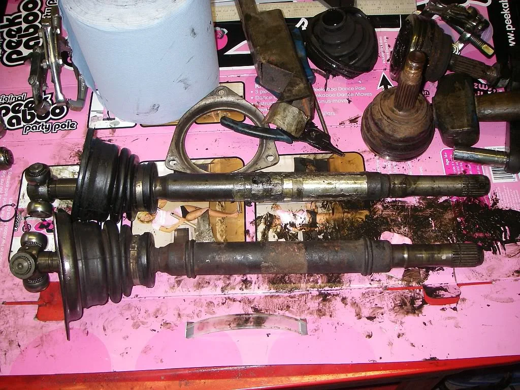

it finally looks like the driveshaft saga is coming to an end....
is it just me that had never come across a 'peek aboo party pole'?
Anyway, that's the packaging that the Williams driveshaft came in:D
I thought I was looking sweet when my new 172 CV arrived on Monday, and the Williams shaft was in the post. Unfortunately I found on Monday evening that the CV was wrong, I'm glad I checked straight away. I should receive the correct one tomorrow.
The Williams shaft arrive today, and this evening I popped the CV off (I'm getting good at them now :) ) I now know 100% that the 23 spline 172CV will fit the Williams shaft (these have a 21 spline CV) The length looks OK too.
All this means I can go on holiday happy that the driveshaft should fit, and the last piece of the Twingo 172 puzzle has dropped into place :cool:
