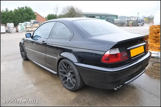

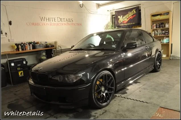

BMW 330ci – Sapphire Black

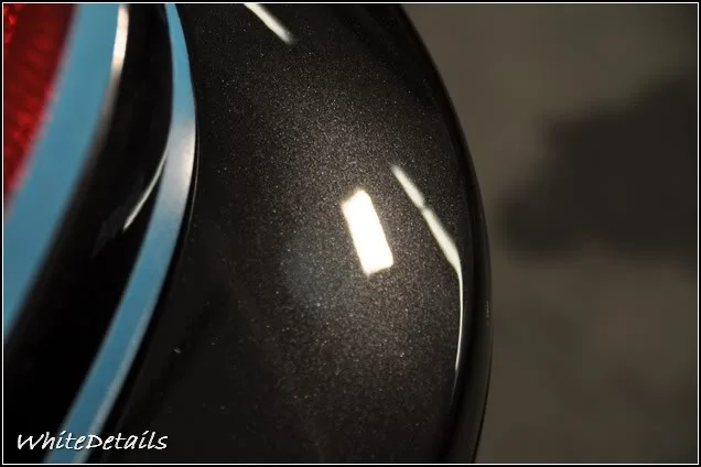

Working to a budget, the car was to go through a Major Paint Correction Detail to restore clarity and help remove some Random Deep Scratches (RDS) and swirls.

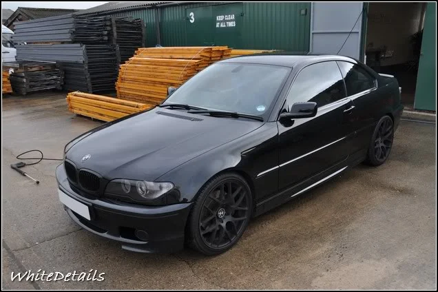

Upon inspection.

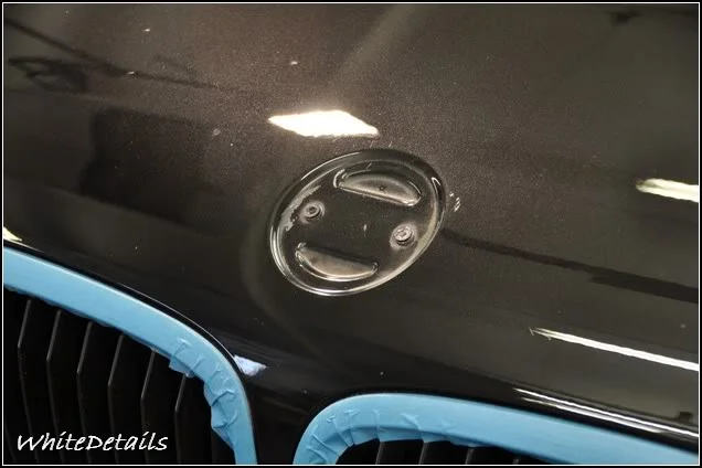

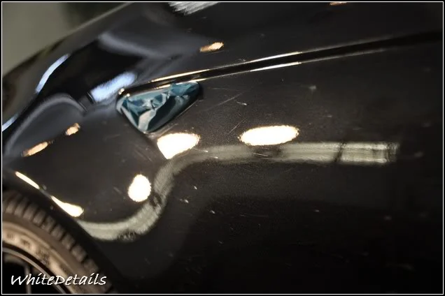

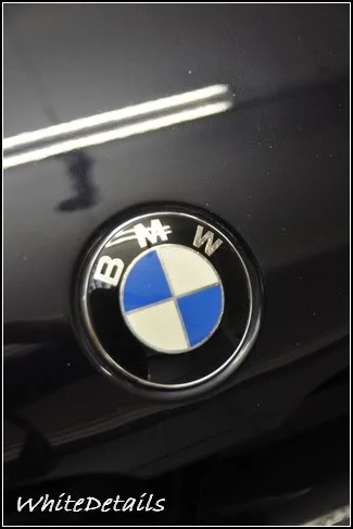

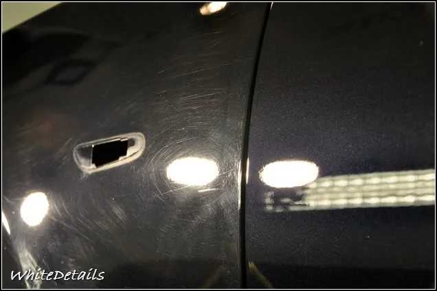

An area to focus on; nasty scratches around the BMW badges.

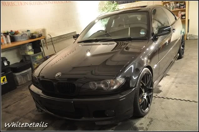

Usual wash and decontamination stage performed.

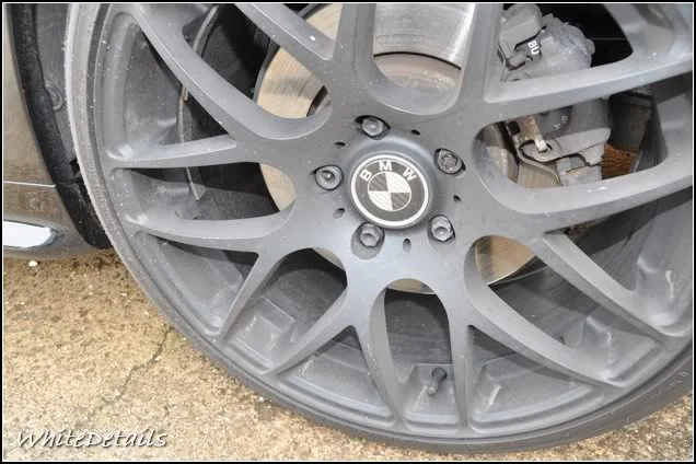

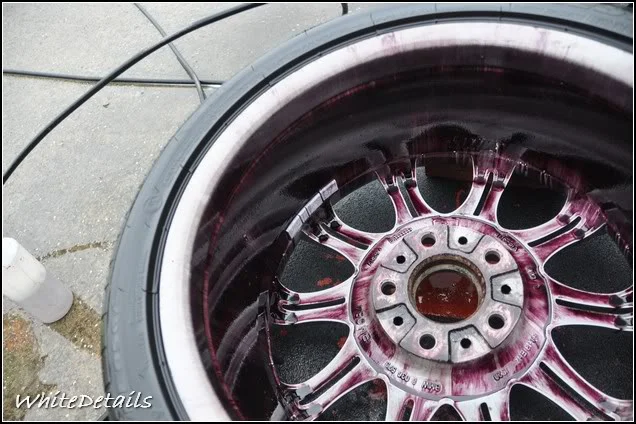

CarPro Iron-X deep cleaning the matte finished rims:
Once inside, clay barred and blown dry, it was time to fire up the rotary.

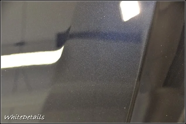

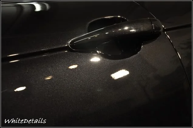

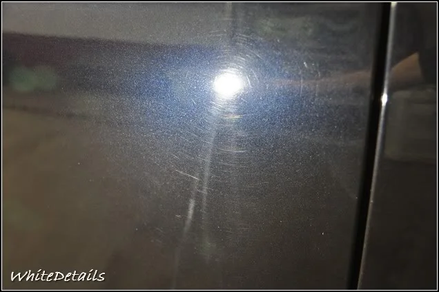

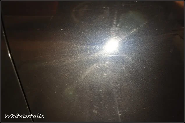

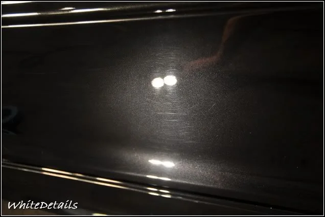

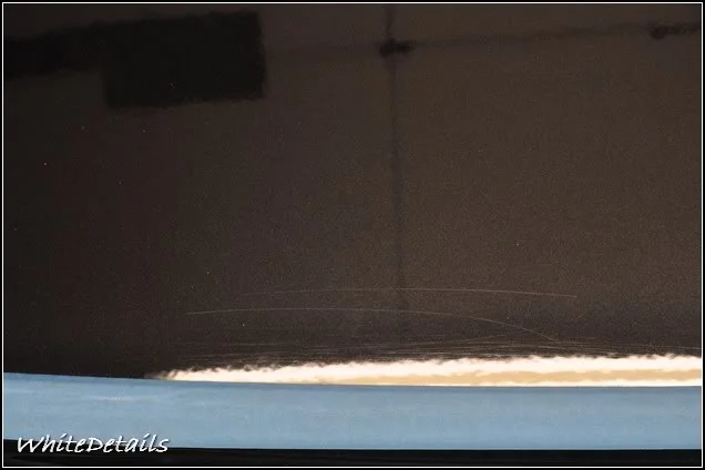

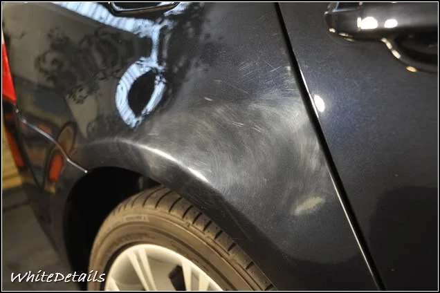

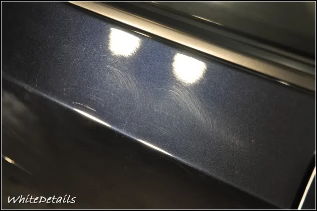

A few defects (difficult to capture ‘swirling’ on sapphire black; only visible marks are random scratches and blemishes)

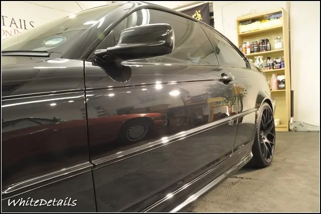

Working with Scholl Concepts S17+ and Lake Country polishing pads, results were pleasing:

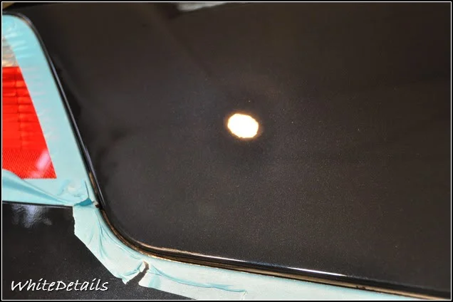

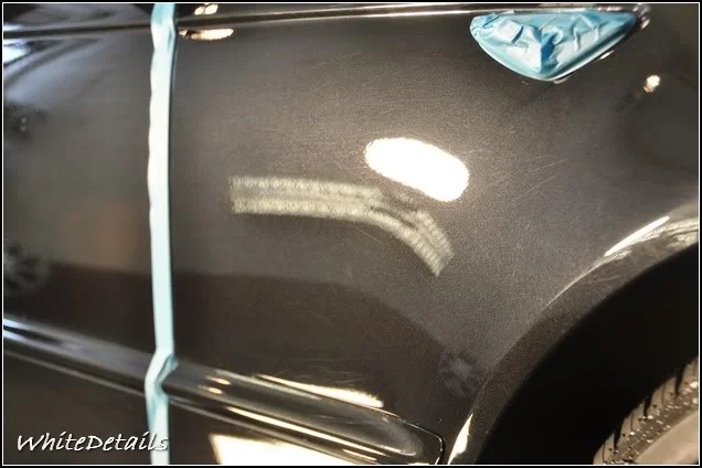

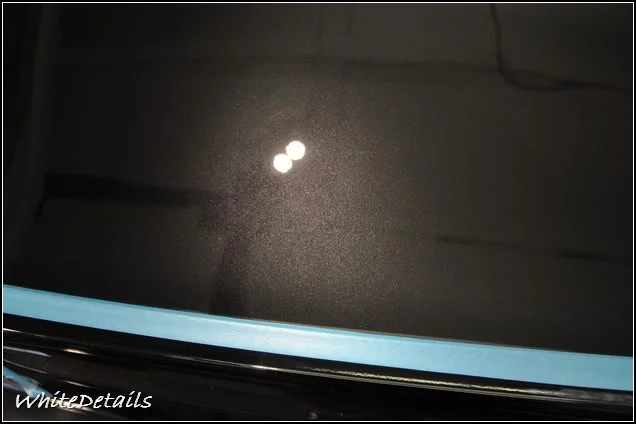

A ‘sort of’ 50/50 on the OS door:

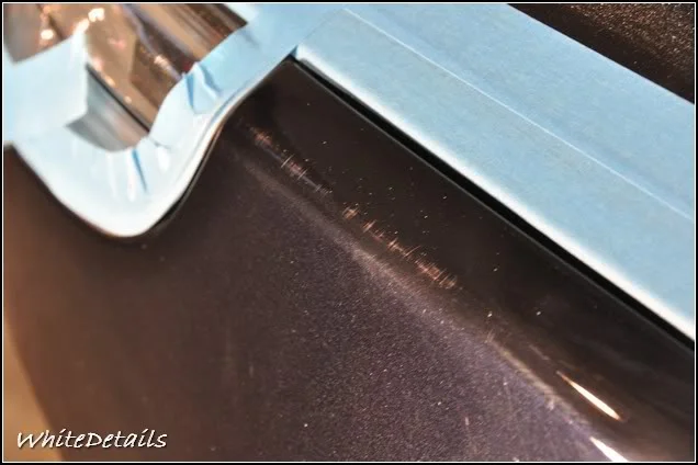

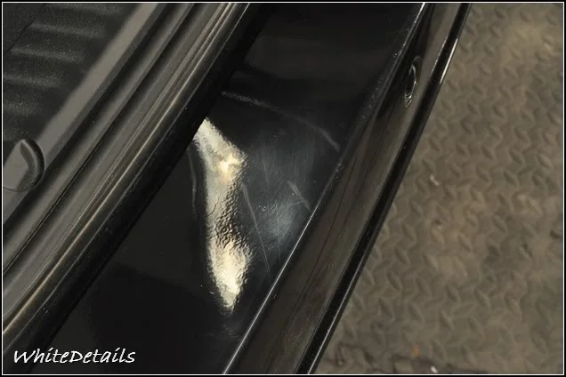

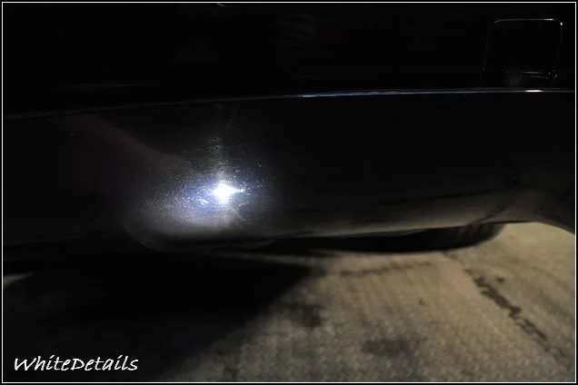

Nasty scratch:
After: (after many polishing sets)
Not completely removed if you looked ever so closely in the right light and at the right angle, but MUCH improved (would no longer be visible outside in natural lighting)

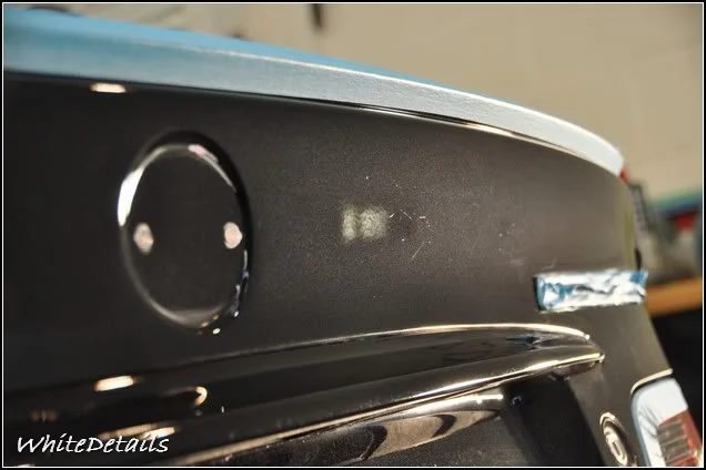

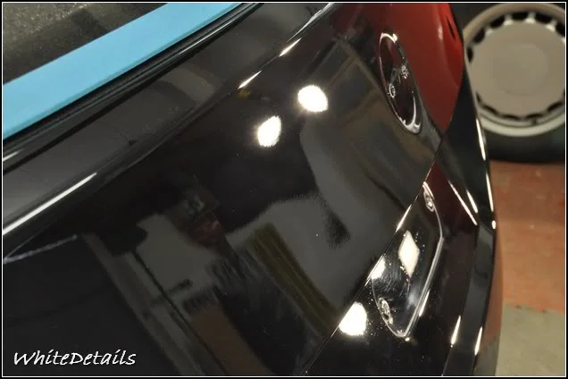

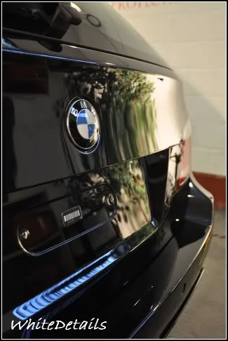

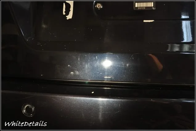

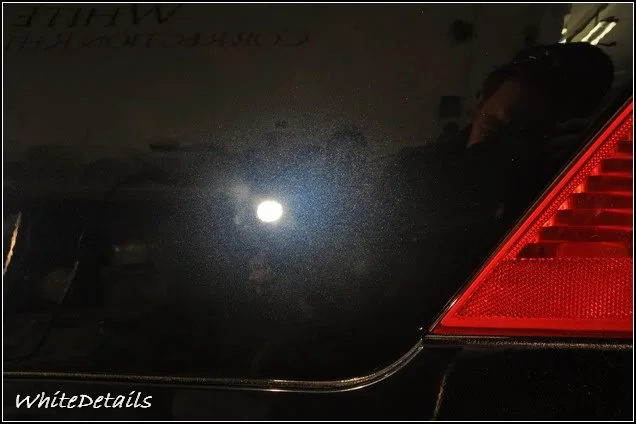

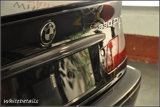

Bootlid before/after:

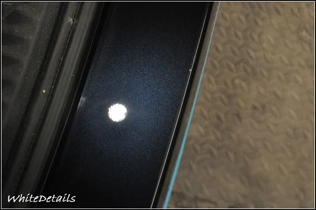

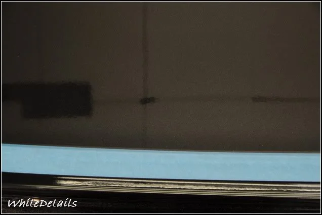

A small 50/50 on the lower sill:

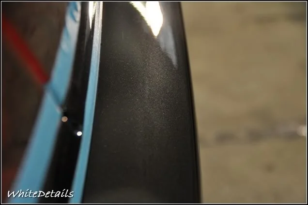

N/S/R wing before/after:

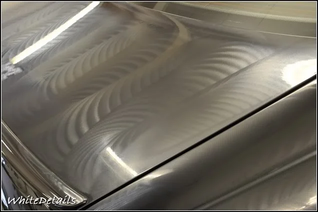

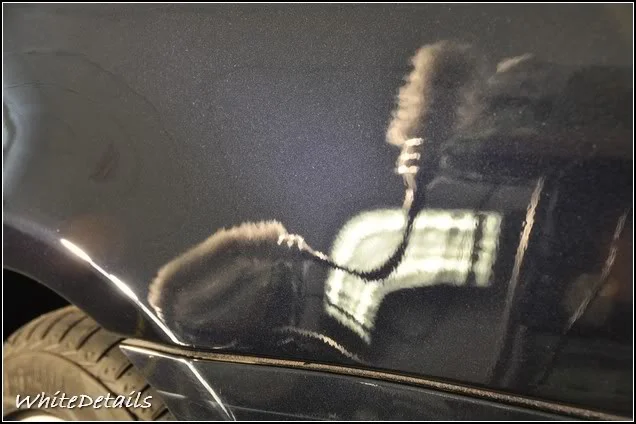

Bonnet was a little tired; requiring a wool pad and several polishing sets to get ‘right’.
After:

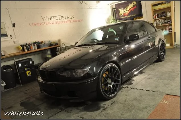

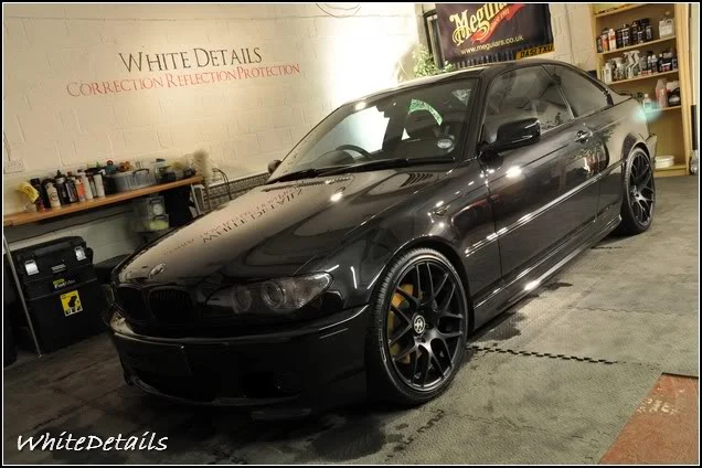

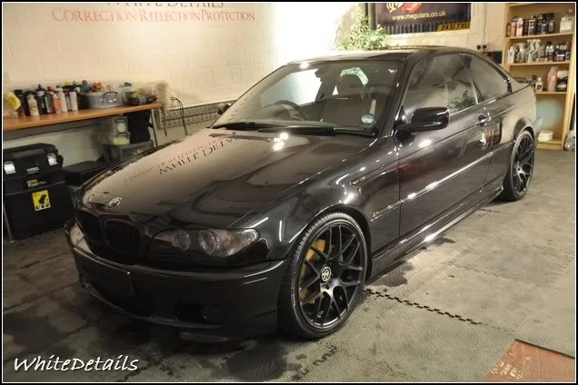

Glass cleaned. Interior tidied. Wheels polished and tyres dressed. Finished.
Very nice. Thanks for reading.

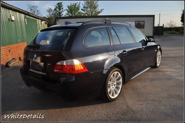

e61 BMW 530D M-Sport Touring
2005, 86k miles, FBMWSH with all the toys!
Vehicle was brought to WhiteDetails just three days after the new owner collected the car. Previously listed as “IMMACULATE”, as will be seen, this was NOT the case. Some people’s idea of “mint” and “excellent condition” does shock me!
My task? Restore throughout.
Full major paint correction

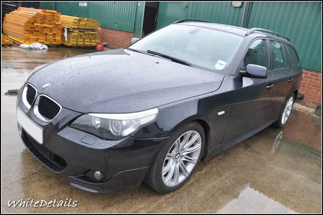

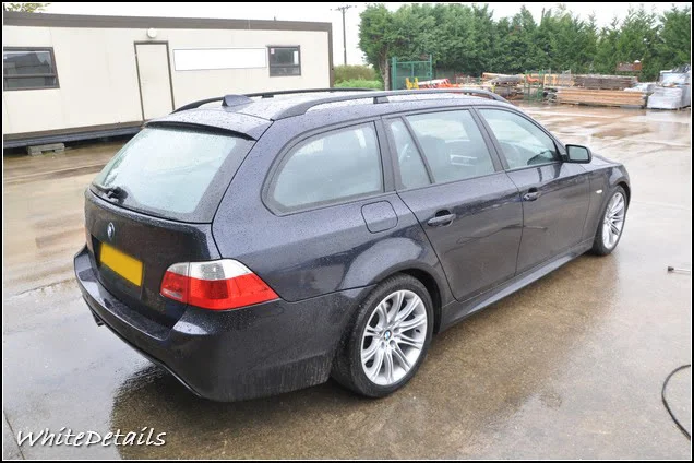

Vehicle on inspection:

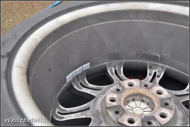

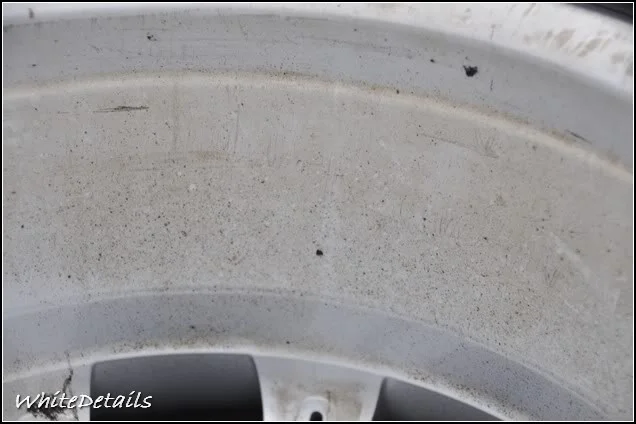

All four wheels had been previously refurbed.
Lots of tar, wheel weight glue and overspray to remove!!

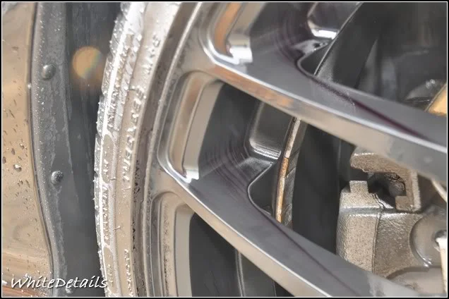

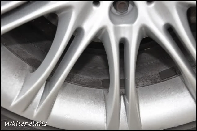

O/S/F rim before:
During:

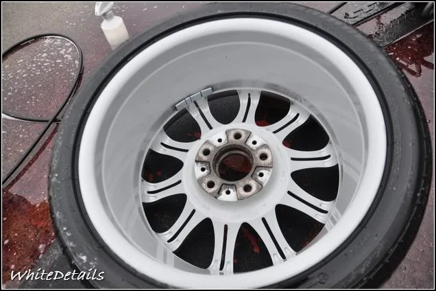

After:

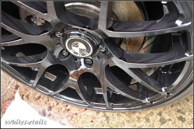

I kid you not, to clean this one rim, I was at it for well over an hour! 1ltr of Iron-X used in the process. Nightmare!

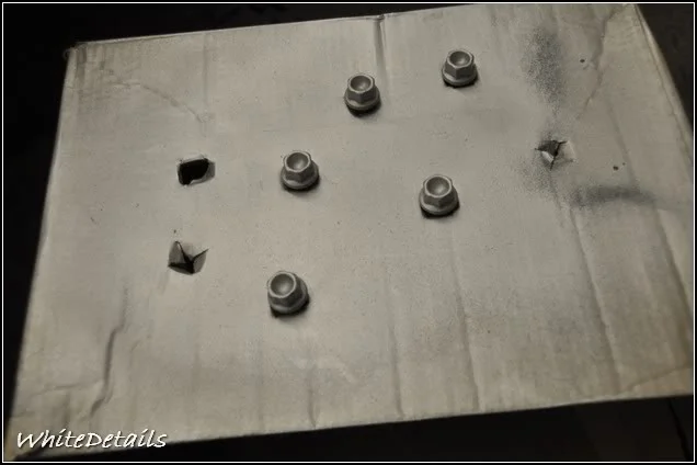

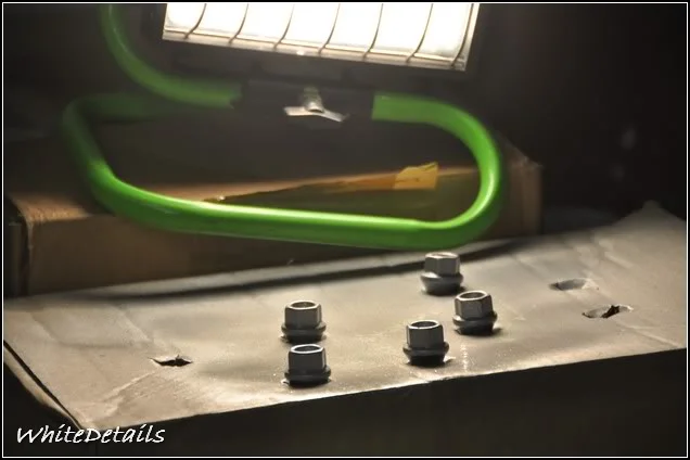

Wheel bolts also sprayed to give an even cleaner image:

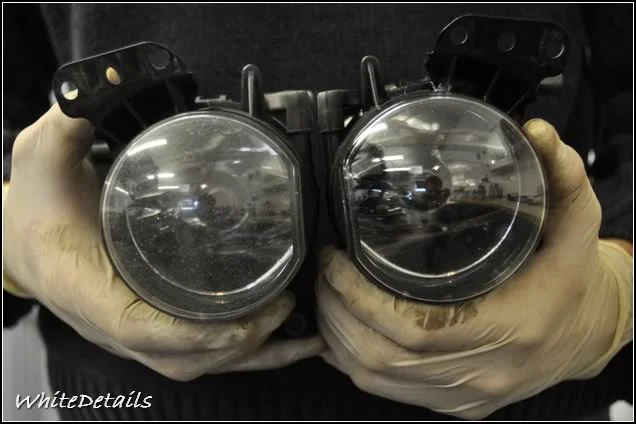

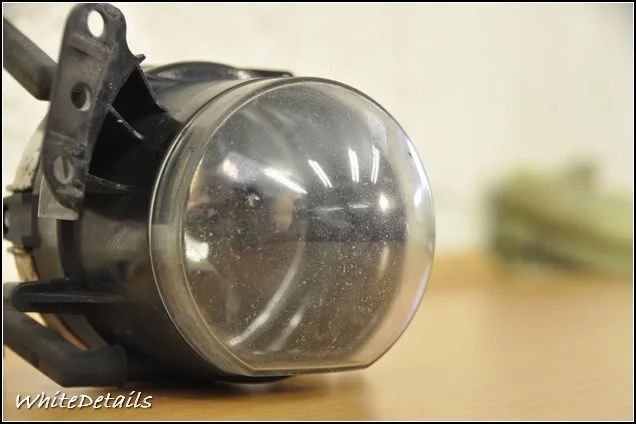

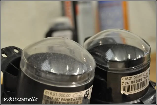

Whilst off, the pitted fog lights were flatted back and clarity improved greatly.
50/50:

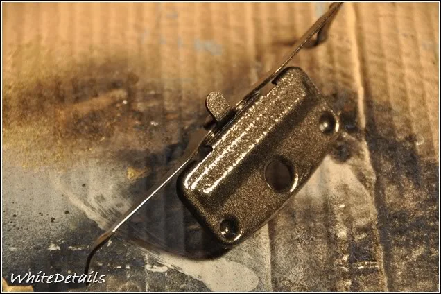

Fog light surrounds dressed. G-Techniq C4 Trim Restorer.

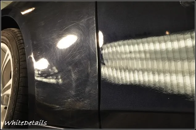

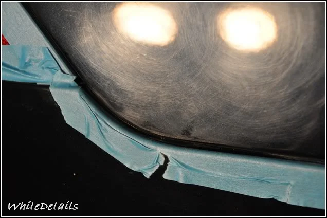

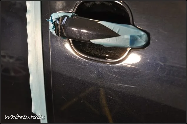

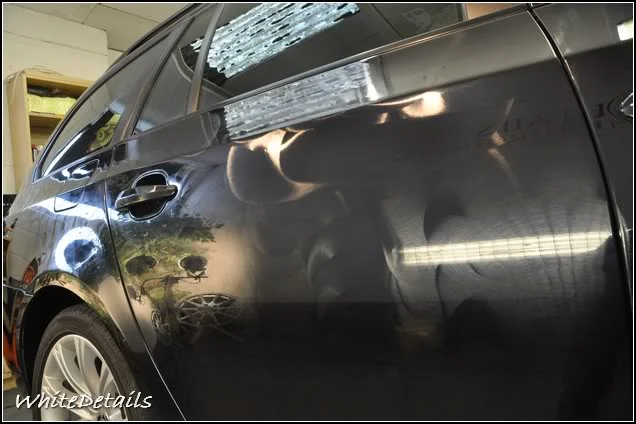

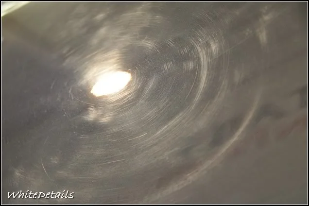

Since then, I think someone has been a little over eager with T-Cut or similar…? What a mess.
Elsewhere:

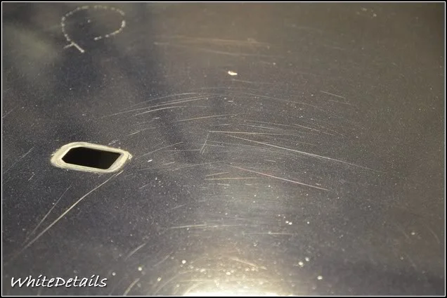

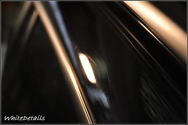

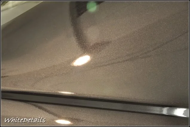

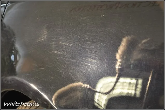

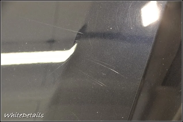

Some deep machine inflicted buffertrails:

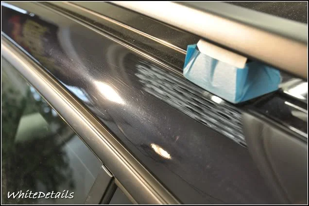

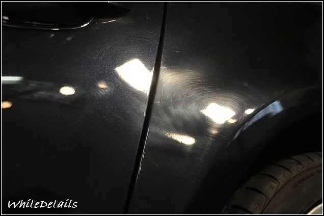

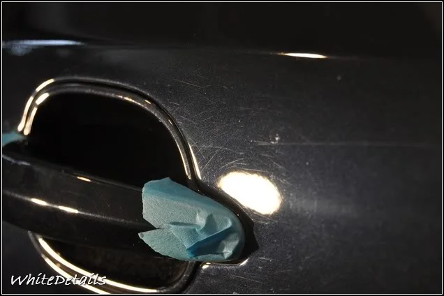

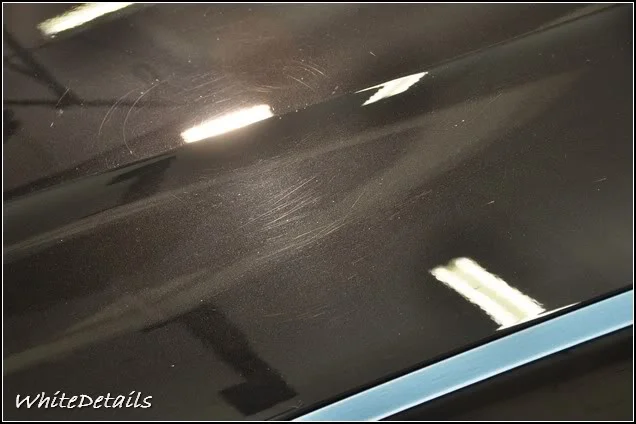

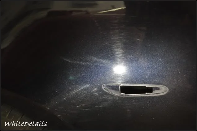

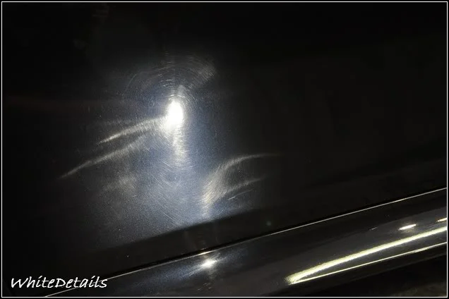

Lots of random scratches:

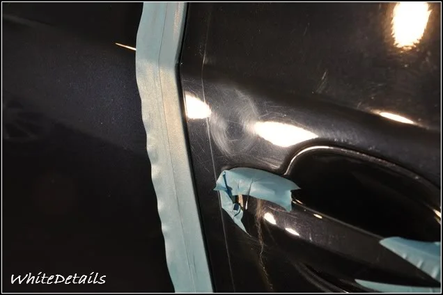

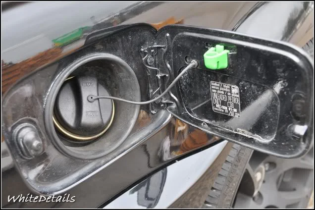

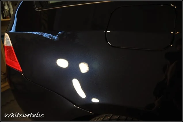

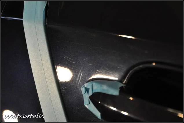

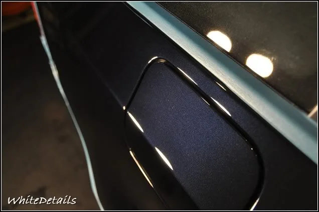

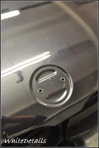

Some scratches from opening the petrol filler: (almost unavoidable)
And closing the boot by wrapping your hand round the paint: (avoidable)

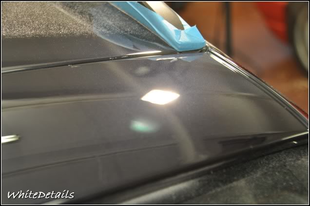

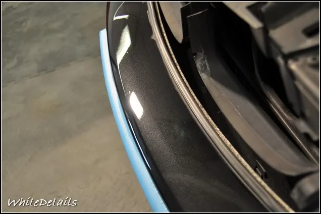

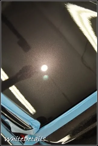

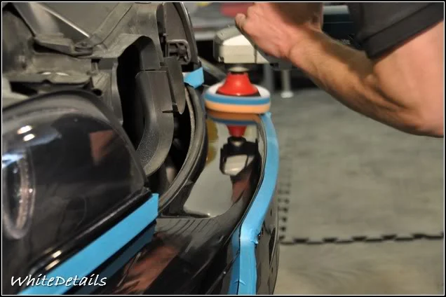

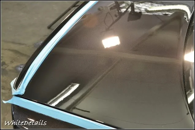

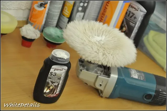

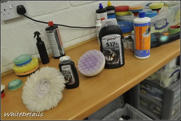

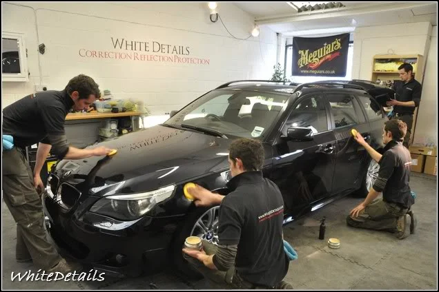

Starting high with the machine polishing, the O/S half of the roof was tackled first. G-Techniq Wool and Scholl S3 Gold for compounding, a white Hexlogic polishing pad and Scholl S17+ for polishing and finally a blue 3M finishing pad with Menzerna 85RD for burnishing to a high gloss.
Roof line before/after:

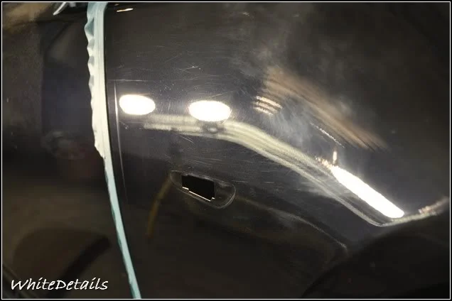

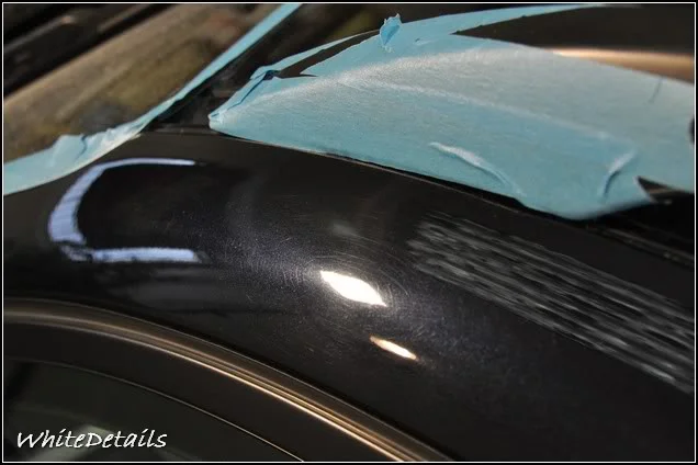

Lower down on the awful OSR quarter…

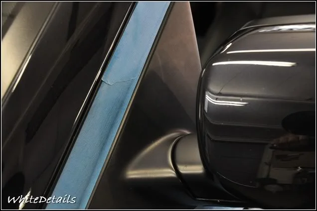

Look closely, someone, somehow, has managed to burn through the edge of the panel (lowest leading edge)
Caution here…
Panel corrected, polished and refined. No problem.

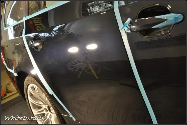

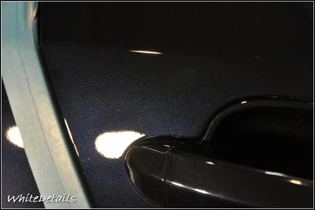

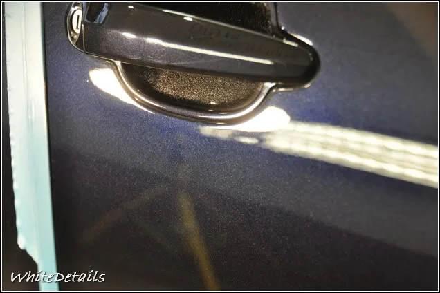

Some tight fiddly work around the door handles:

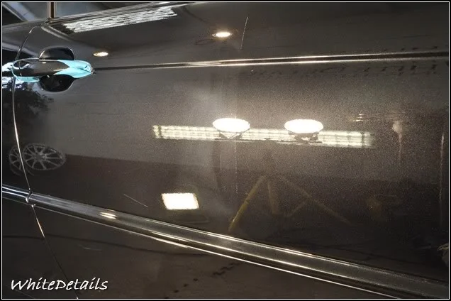

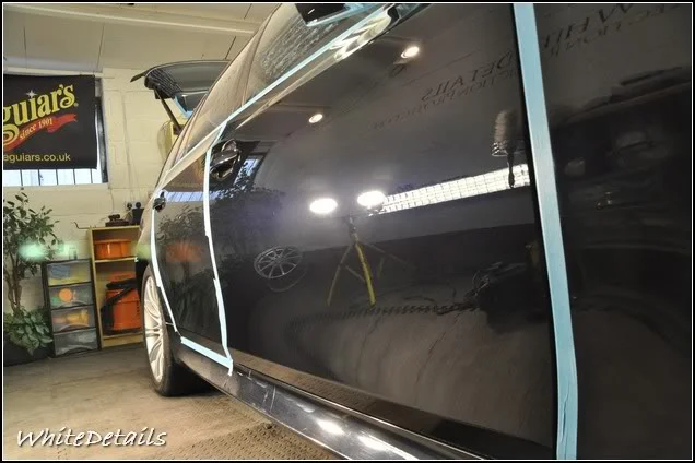

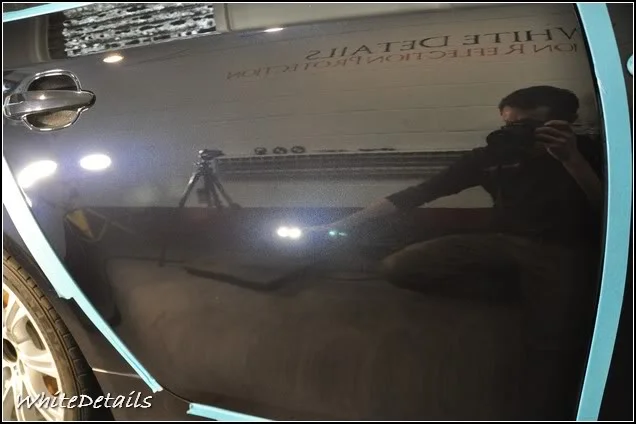

OSR door before/after:
OSF door:
Weapon of choice for the bulky areas:
After:

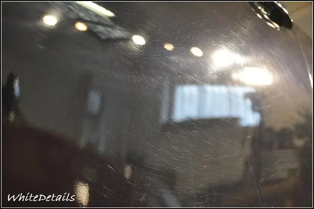

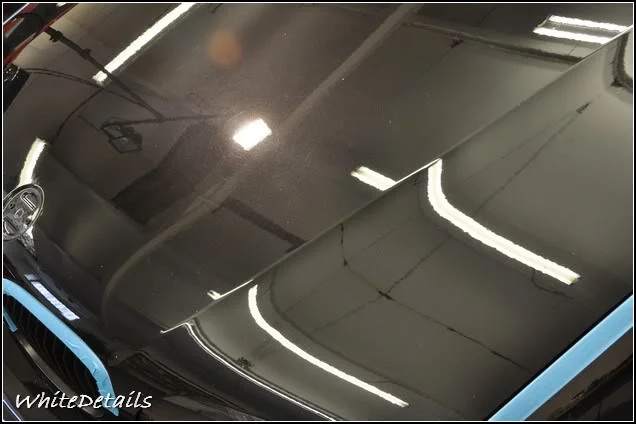

Bonnet before/after:

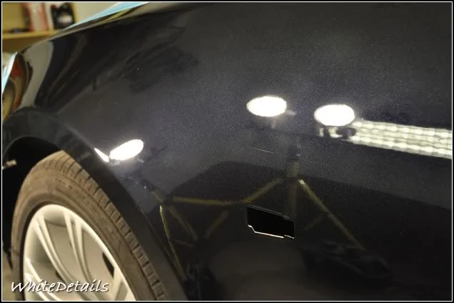

OSF wing:

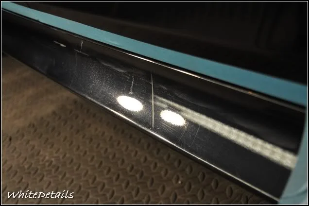

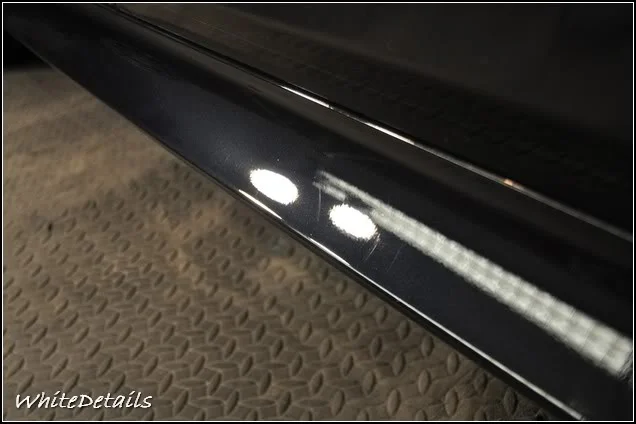

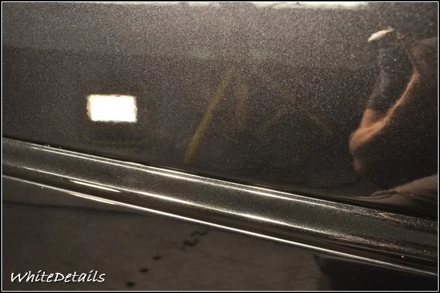

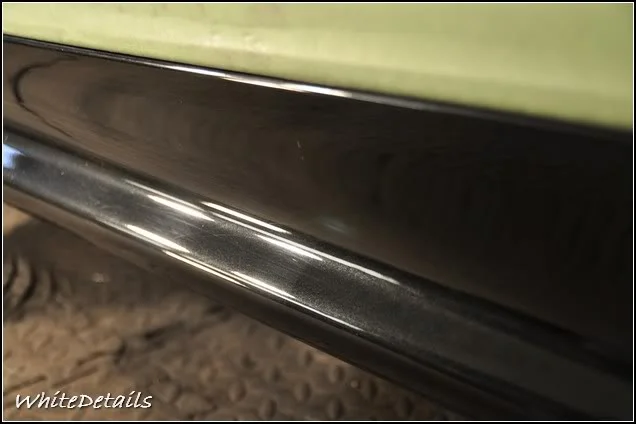

And finally the OS sill:

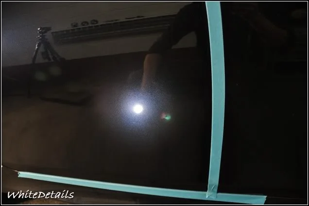

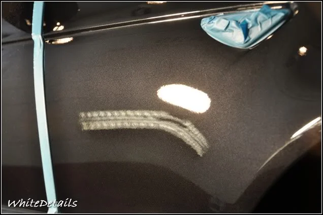

Nasty scratch; not quite 100% removal (but an improvement nevertheless)

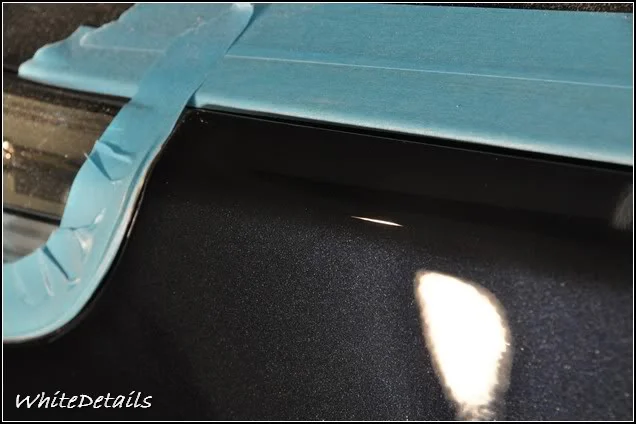

Spinning the car round. Roof completed:
Boot spoiler:
Roof line:

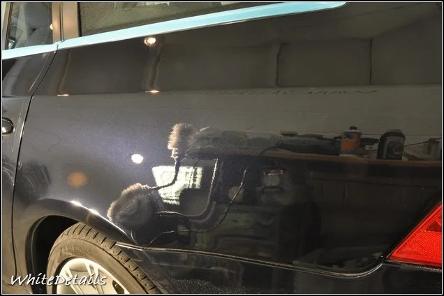

NSR wing/door:
Checking results:
1. Scholl S3 and G-Techniq wool for compounding. 2. Scholl S17+ and white Hexlogic for polishing. 3. Blue 3M and Menz 85RD for refining.
Before/after:
And 50/50s:
NSF wing:

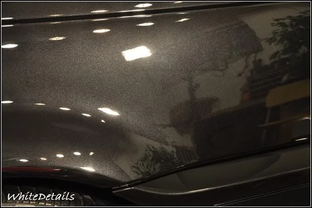

As you can see, not perfect (low paint thickness readings preventing me from chasing this one 100%)
This series of scratches however were removed altogether.

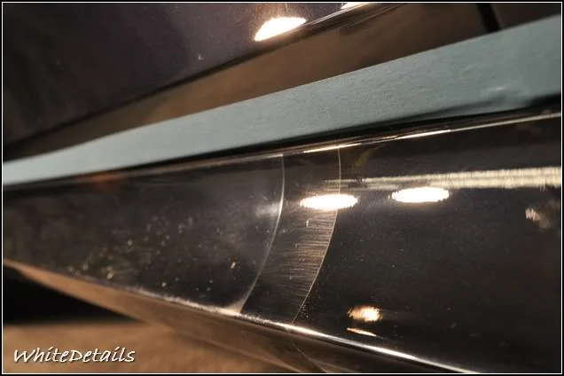

More sill action. 50/50:

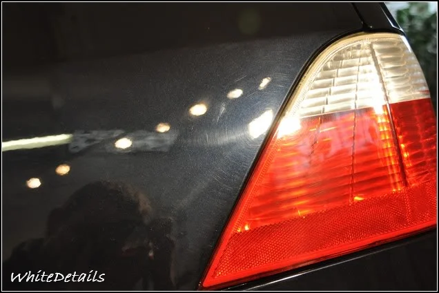

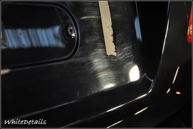

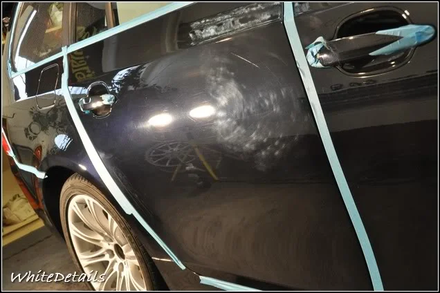

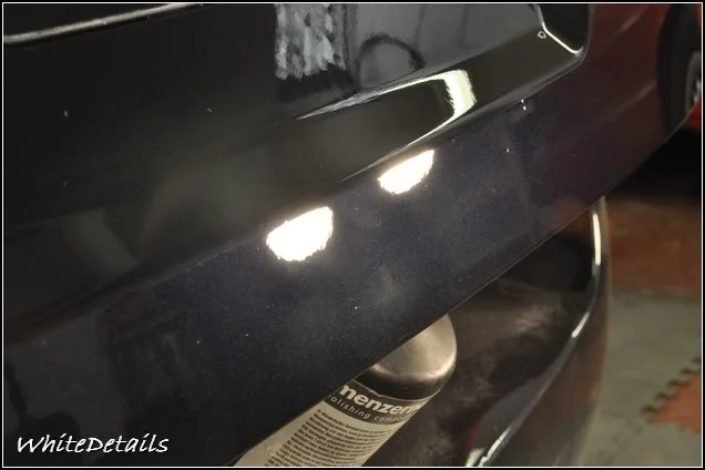

The boot lid was pretty bad. Lots of random deep scratches.
After:

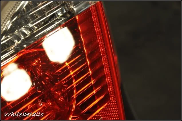

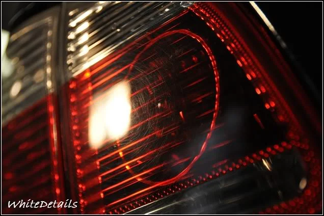

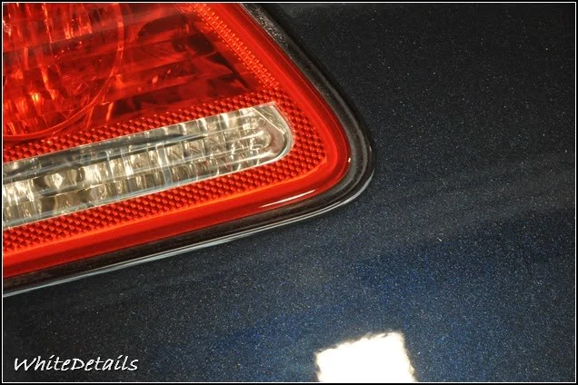

Light clusters before/after:
50/50:

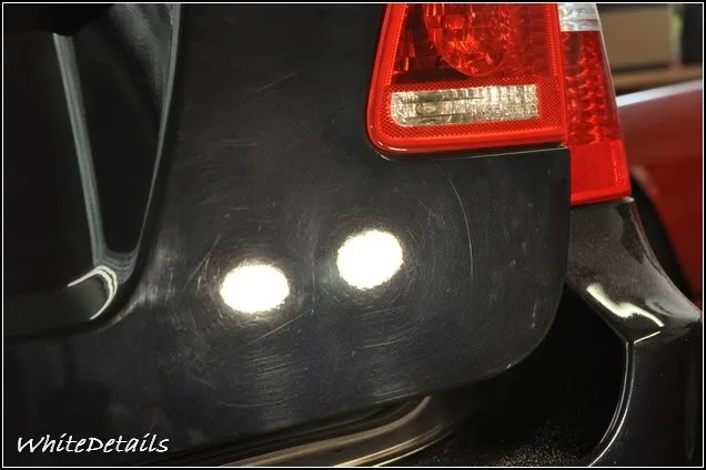

Rear bumper also quite tatty.
Before/after:

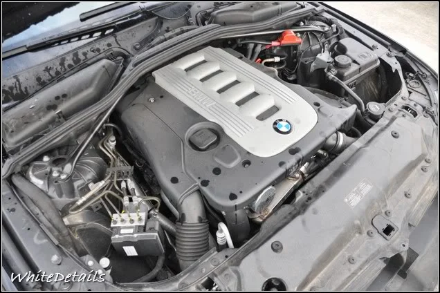

At this point, the engine bay was cleansed, blown dry and later protected:

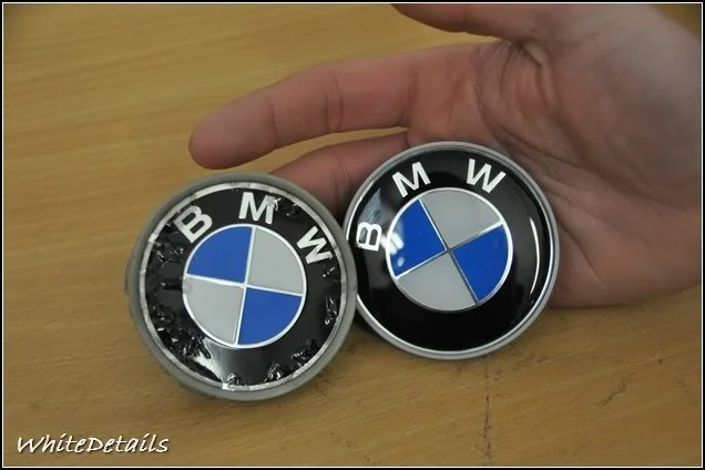

New BMW centre caps to replace the tired looking, corroded old ones.

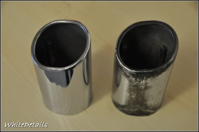

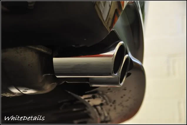

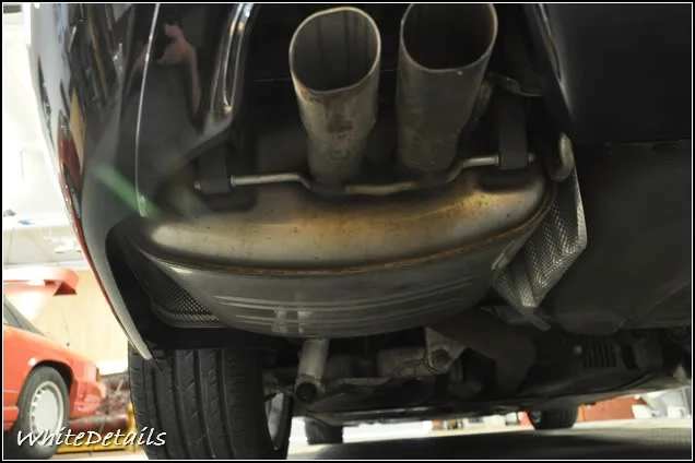

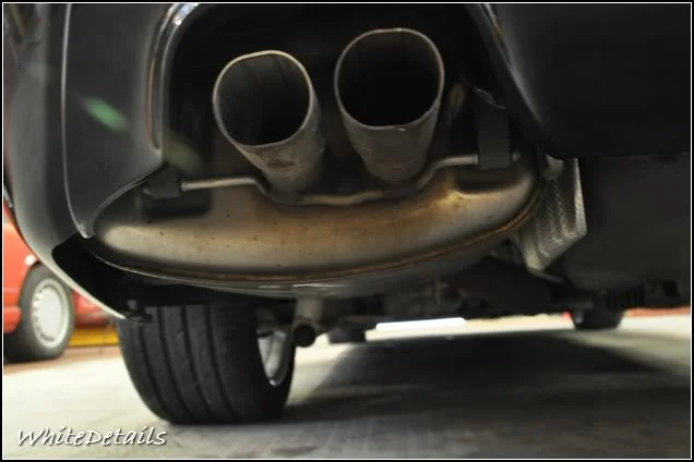

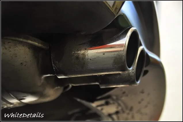

Exhaust tips removed for easier polishing:
50/50:
Bling!
With the car now blown dry, Auto Finnesse Rejuvenate was loaded onto a 3M polishing pad to further cleanse the paint.
To protect, Raceglaze’s Black Label Concours Wax was applied via a foam applicator pad:
Some ‘toothpickery’ work to remove trapped polish residues etc.

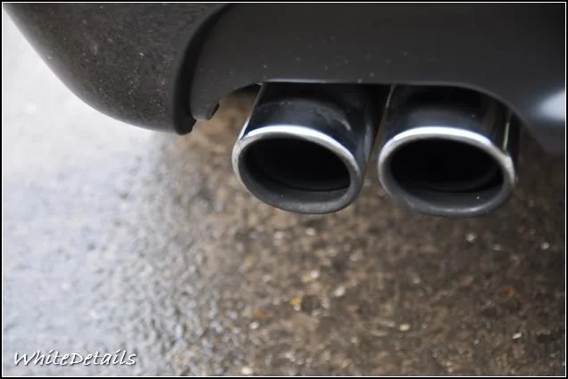

Exhaust box polished and tips installed:

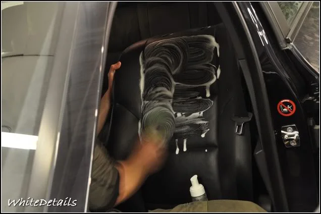

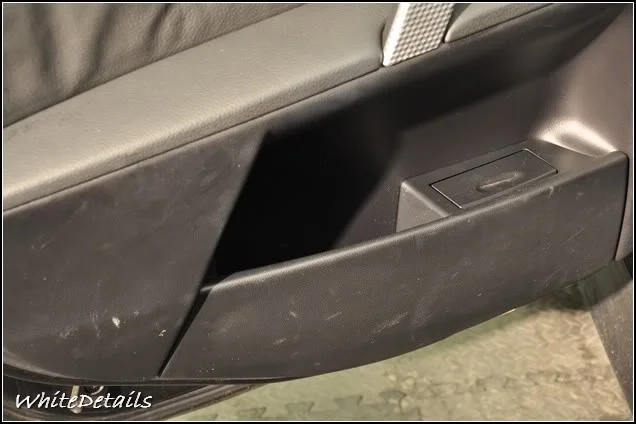

Interior also in need of a good scrub.
Plastics tackled with an APC and leather deep cleaned with LTT’s Auto Ultra Foam and ‘Protect’ to form a barrier against future build-up.

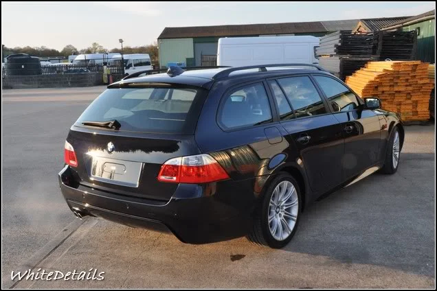

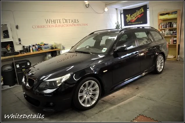

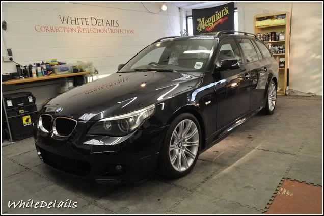

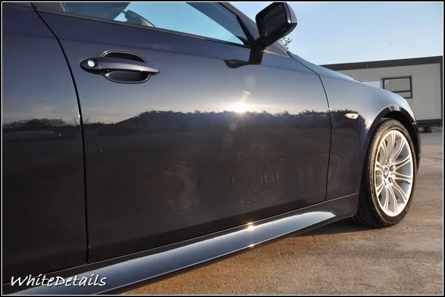

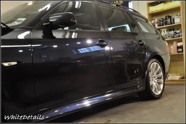

Some 40 hours later, e61 BMW finished:
Funny, on the vehicle’s V5, it’s actually listed as a ‘black’ car…
And finally….
If you made it this far, I salute you.
THIS is an ‘immaculate’ car.

What products do you use on the interior plastics to get rid of the mud/scuffs, just a normal apc?
Ta chap. An apc, yep! your best friend for interior work though, although go steady, is a "magic sponge". JML Magic Sponge... Deals with scuffs, kick marks etc quite easily (although it is abrasive so careful on textured surfaces etc)
