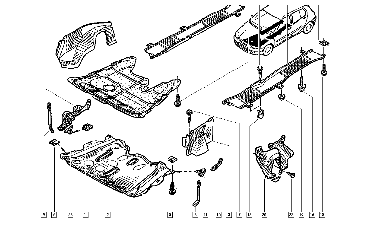

My car is without the undertray and I'd like to refit it.
I know about part no 6000073775 that attaches with four bolts directly behind the bumper. I'm confused by the diagram below though...do I need both items pictured or just one?
I assume they are two different versions of the undertray for different cars, and the one I need is shown above (not part #2 in the diagram)

6000073585 with the access cover for the drain plug, or 8200158866 without.

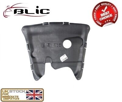

Post a wanted on here, but you will be lucky to find one with the drain plug cover, though a friend found me a grommet as a substitute.
If you get no response, there is a blic item on eBay.
