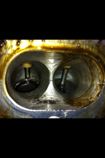

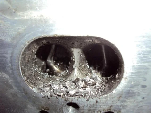

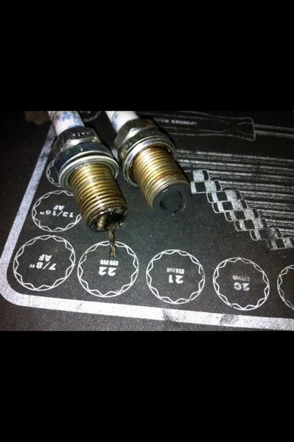

Hi all, new to the forum. I recently bought a 182 Clio sport in Black with 80k on the clock. Just had a full service on her; cam belt, phaser pulleys, oil etc (as per the guy who posted this thread).
driving home from work one eve and the engine cut out at 3.5k revs. Turns out the plug tip of No.4 is shot and the valve has dropped. (Pics to follow when I find out how to post up).
Wondering if anyone has a good engine for sale or can offer any other solutions?

I have been in the same situation. After a rebuild and new belts, clio dropped 1 valve, smashed the piston.
it was rebuild with a reconditioned head I bought off here. But mechanic said but wouldn't confirm if the heads had new valves and couldn't say if this was the cause.
now rebuilt with a new engine thanks to Fred and birchdown it's running good.

It's not a nice position to be in that for sure! I'm thinking rebuild head (but then you don't know what damage the valves have done) or replace the engine!
Anyone know how much would be to rebuild the engine?
