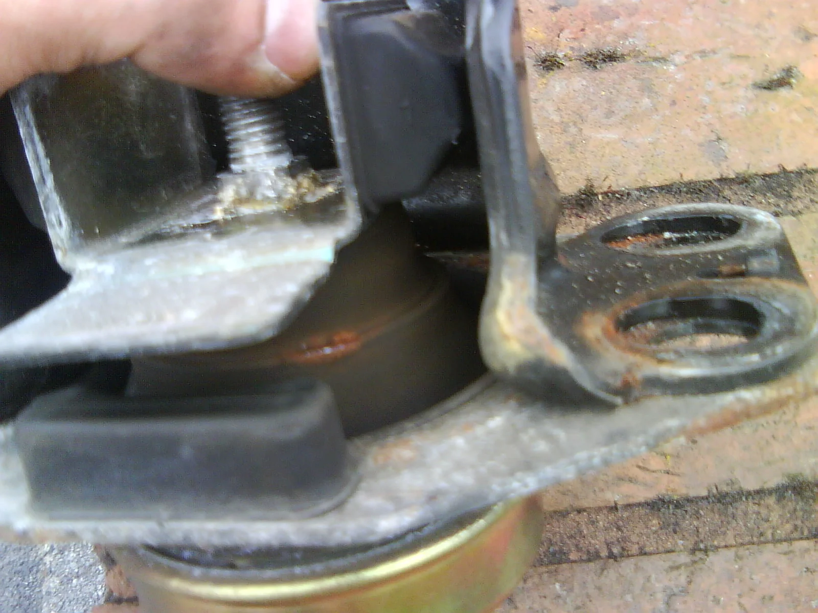

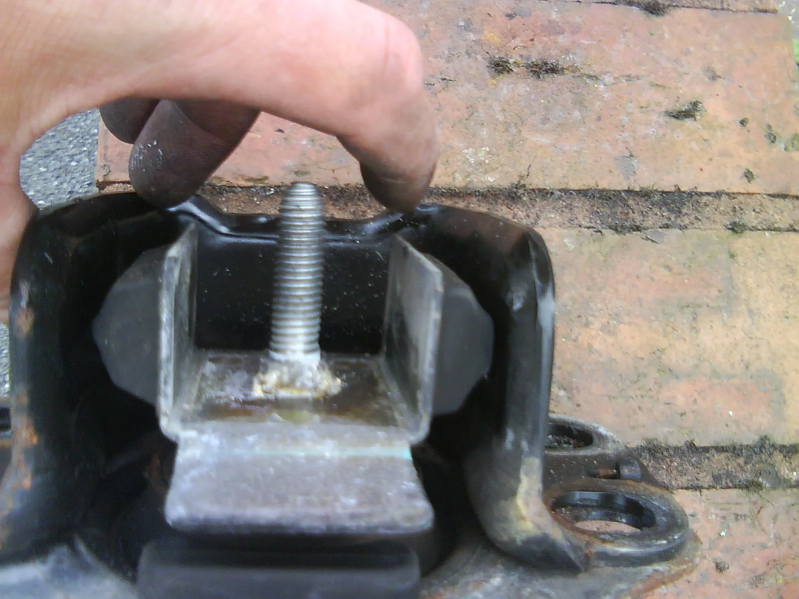

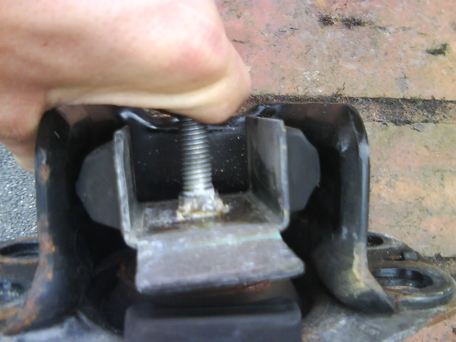

Decided to remove mine off my car to see if was split/worn. There seems to be a split in the rubber, I took some photos of it. Is this knackered and could be the reason I get the knocking noise on hard acceleration?

Also when I removed the under tray I noticed it was really wet under it and there was alot of black gunk everywhere. I know with under tray being attached it'll end up trapping some damp in there but is it normal?
by the look of the 3rd pic its easily moved around?

Yeah! That's what I was trying to show in the 3rd pic. There's a fair bit of play in it.

that bracket with the buffers on it comes off, which might give you a better view of the mount itself:)
Didn't realise that lol. Does it just screw off? I think I've knackered the mount even more when I was putting it back on to be honest as the rubber started twisting as I tightened up the nut.
looks like the "buffer" has been welded on for some reason. very odd. I wouldn't say that much play was bad in honesty, but a fresh mount probably wont hurt
On mine when it was knackered the rubber underneath was clearly torn.
I think the new Renault one I got could be moved fairly easily as you have done in the pics.

The rubber underneath the buffer is definitely split, the pictures don't really show how badly it's split. It'll be getting replaced A.S.A.P.
