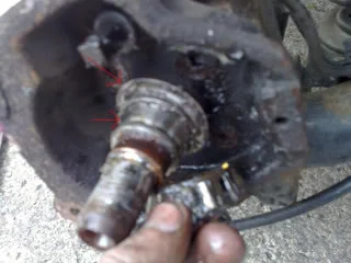

Changing rear discs.
Eventually managed to get disc off with force.
Is the the other half of the bearing that's ended up left on my car? I've broken the bit in my hand and the bit around the shaft is still on.
Cannot get it off.
Any ideads?
Cheers.

Crap!
Just phoned my break down and they're going to come and tow it to nearest garage :-S
Garage said they'll fit the pads and discs on the rear for about £40. Sick as a chip and I'm not a complete fool but just don't have a puller or a grinder and besides, working all weekend.

How the fook did you manage to leave the bearing on there! mine was stuck in the disc and it took me 8 tonnes of force to remove it.lol.
  ex Clio 172 owner :(
Guy just came and heated it up and got it off with a chisel!
Phew!
Just the other side now heh heh.

Incidentally, should I grease the shaft that the wheel bearing/disc slips over and onto?
I did put a small amount on but not sure if I'm meant to.
Cheers edde. I did put a small amount on, probably only a really fine layer of grease around the shaft. Not sure if that'll be enough to be fair. Is that likely to cause any problems?
See, I though the bearing was meant to pretty much grip the shaft while the outer casing parts span around that.
Got the car all back together now so it's gonna be a pain to strip back down if I need more grease.
Cheers.
See, I though the bearing was meant to pretty much grip the shaft while the outer casing parts span around that..
Should be fine I've had them in pieces like that time and time again. My on my own car have been in pieces like that about 5 imes and there still on the car after 117k.

Sorry edde, I'm not sure I'm with you.
I've put new discs on with new bearings. Just wasn't sure if I was meant to grease the shaft that the new bearing slides over.
Sorry to keep asking for help.
Cheers.
Cheers.
No problems ask away.
i meant I've had them in pieces like that before and put them back together without any issue. The set on my car have been taken to pieces like that a few time when I've had the rear drums off (similar setup) and there fine still.

ok I understand. Just wasn't sure if I needed to grease the shaft good and proper ready for the new bearing or just slide it straight on to an ungreased shaft.
I'm convinced I can hear a humming from the passenger rear. In fairness this was there before I replaced the disc and bearing. The old bearing was worn as I could rock the disc a bit back and forth. I expected the humming to have gone after fitting the new disc but I can still hear and am wondering if it's because I didn't grease the shaft enough for the new bearing. Like I say, I'm not sure if I'm meant to.
