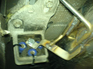

  Turbo'd MX-5 MK4
^^ what he said, but to be honest mate you will find that due to the extra weight of the magnex you'll need to improve the mount anyway. PM for pics of mine and I'll take some at the weekend.

  Turbo'd MX-5 MK4
the Renault mount is far too flimsy and will not support the exhaust properly. The thing to do is unbolt that mount from the car altogether, take a knife and cut the rubber mount out, go to halfords and for a couple of quid ask for a Ford (IIRC) fitment type rubber exhaust mount, this is MUCH more supportive and solid than the Renault one, (basically its like a huge solid rubber block with four small holes in it). Re-fit this back into the mount using epoxy resin and a series of cable ties etc for extra strength. This is what I have done with mine, it doesn't budge an inch and sits perfectly level now its been refitted.

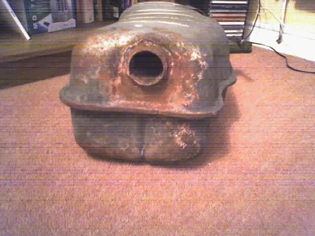

well long story but went to the gym (bout 30 minute ride) and back wheel fell off on the way back hence a 2 hour walk and no time...
everything seems to be falling apart recently!! lol
  172 M69 eater
these reno exhausts are good... 32k and look at this!!
  Turbo'd MX-5 MK4
this is my 'revised' mount. Ford Fitment rubber support, epoxy resin'd in place and cable tied either side. Tighter than a ducks @rse.
  Turbo'd MX-5 MK4
oh and rubber bits top and bottom looking at the pic. You can see the difference between that and the original 'X' shape rubber Renault mount.
