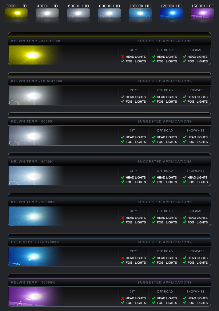

What are the lowest K xenon bulbs you can get?
4000k aren't too blue are they?
No, 6000k are too blue. 5000k is 'daylight', and 4300k is the one fitted as standard to 182/172s.
Anything less than 4300k will start looking more yellow.

4300k would be alright it's standard so police can't moan can they
