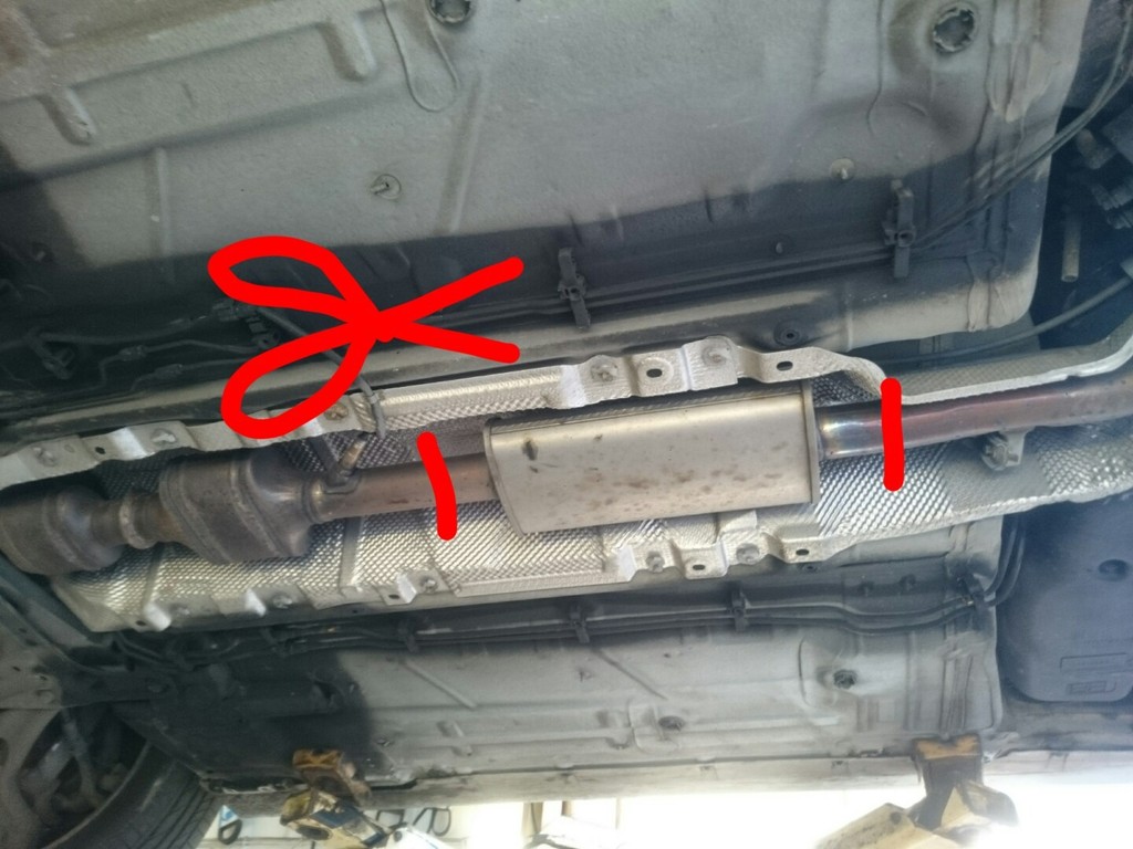

I wanted more of a sporty note but not fork out big for a full aftermarket system. Also didn't want too much noise as this is my daily.
This cost me £60 at Longlife exhausts in Brighton and took less than a normal hour.
Before pic, no after but yea, straight pipe.
Hope this helps anyone looking for a bit more rasp and sportyness from their standard exhaust.

My review on a standard car, standard exhaust with only the centre silencer removed, straight stainless steel pipe welded in and a performance panel filter.
Idle
a tiiiiny bit deeper and a tiiiiny bit louder. Passable as standard.
Gentle driving
A bit louder, non intrusive. It's not boomy or droney, more just a bit louder at the standard note.
Motorway
A slightly drone, nothing offensive or annoying, just a slightly more sporty note.
Giving it the beans
Raspy past 5500rpm, louder and plenty of little crackles.
Revving
We'll , see video
Pros-
Higher pitch tinny rasp, more drama on downshifts and high revs. Not overly loud, not boomy.
Cons -
Flatspot.. Yup, didn't have one before and now there is a small but noticeable hesitation /flatspot at around 2500-2800 rpm.
Can I live with it? Personally, No thanks. It's off to AMD in Essex for a remap next week once I have fitted a 64mm throttle body. That will be a custom one to suit all mods, help with cold start driveability and wipe away flatspot.
Hope that helps anyone that Is unsure about doing good it.

The flatspot is still there. But only just! They had it on the rollers for quite a while and it did feel more urgent lower down in the revs. My exhaust, well, middle section has developed a rattle so I'll have the mid silencer chopped out again I think, true test is to see how much of a flat spot I'll get again now that it's been mapped!
Was the ramap worth it? Probably not for me. But might be a different story with an actual aftermarket exhaust.
