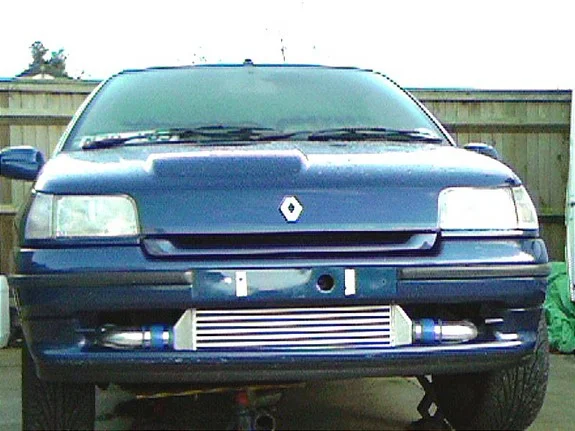

djw dave: you alright mate, spoke to you on the volvo fourom the other day about intercoolers - i posted a pic of mine up because you were finding out what ppl used.
anyway, hows yours going? if you need any info or help at all, on all aspects of the 1.7 turb conv, just pm me.
