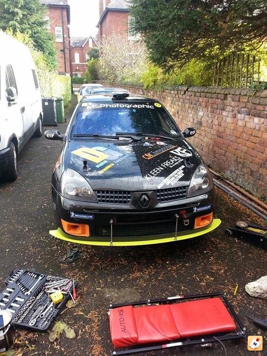

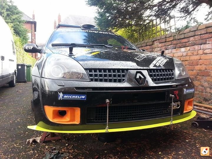

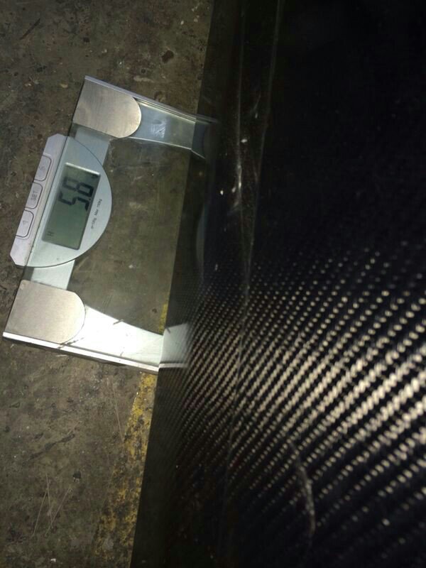

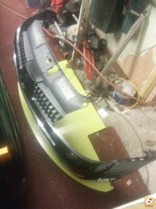

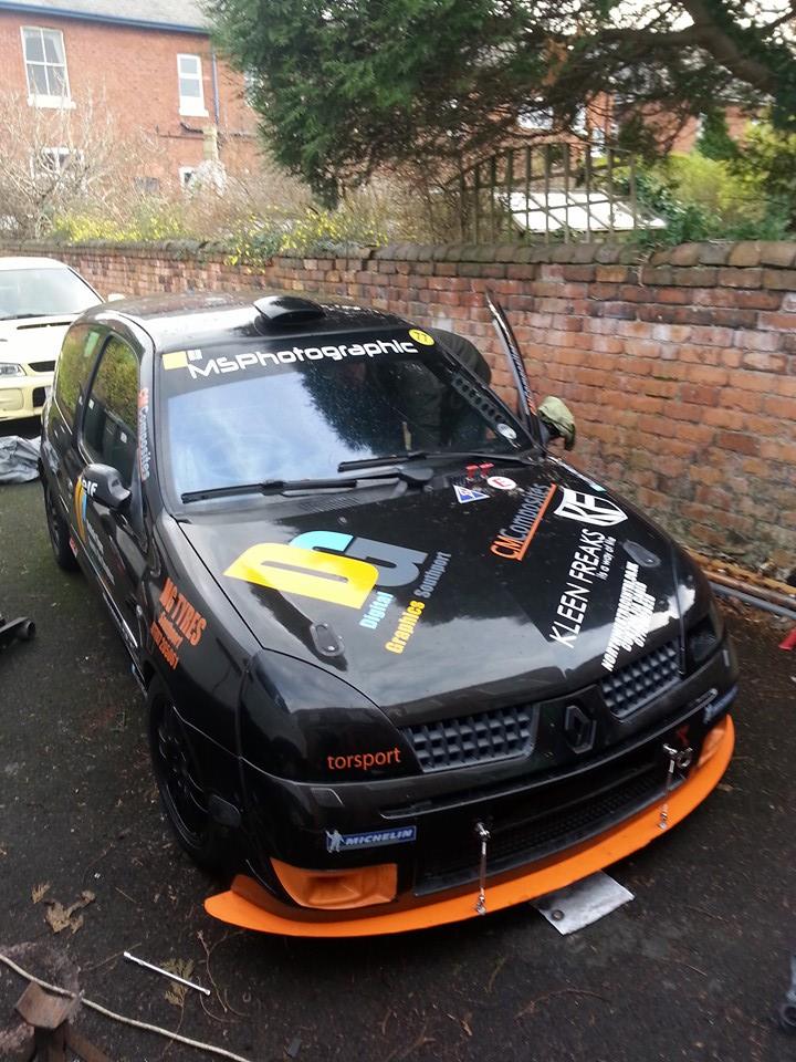

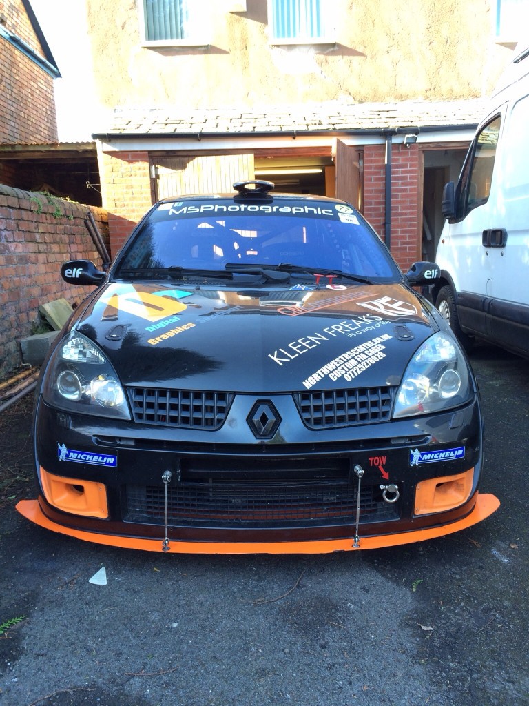

As my shocker has died and im awaiting the spare parts from fk I cracked on with some of my winter jobs iv got planned . First up changed the front discs as I recked the last lot on track . Once that was done I started witb my new splitter iv been designing. All fitted just needs wrapping and then il be selling these. :) also bought a yozza sport exhaust so will get this on at the weekend :)

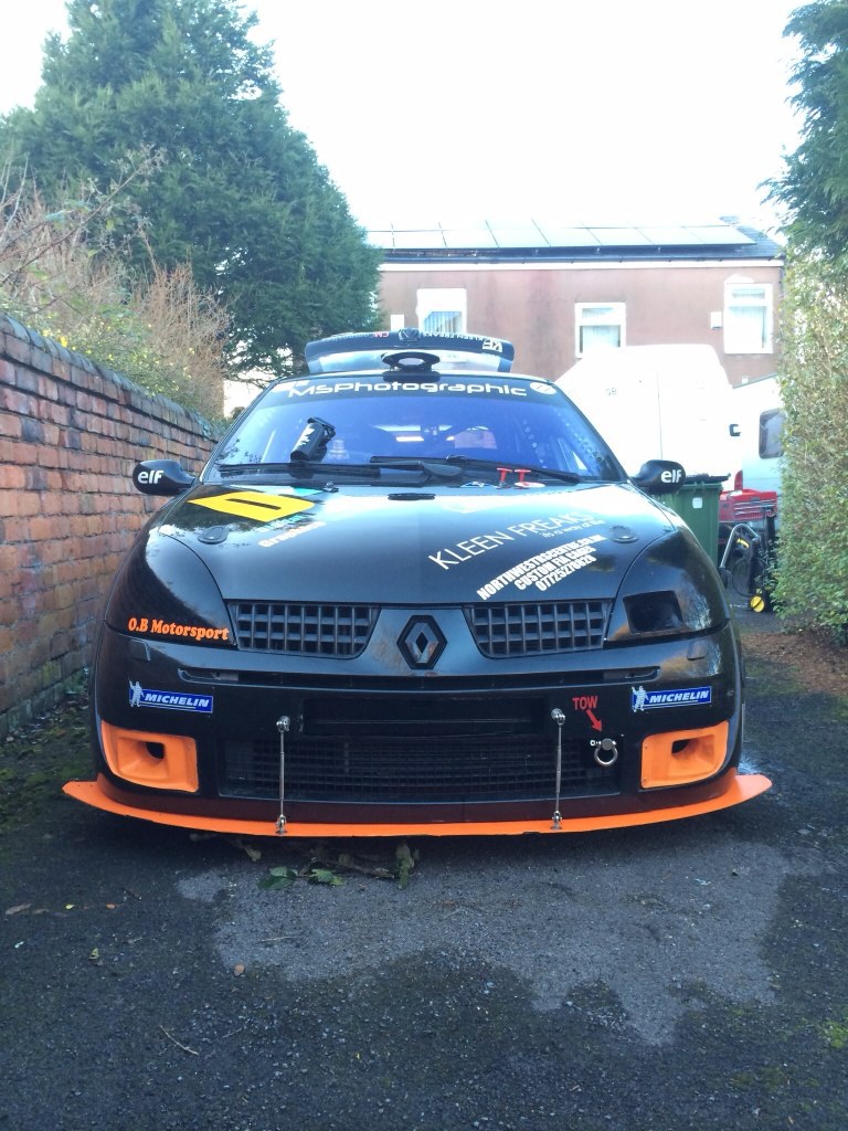

They have been cut on a router directed from a pc. Iv a couple of final adjustments to make and to tell me mate to add the attatchment holes and then they are ready. It bolts onto the sub frame in existing holes
Looking good mate, I would personally, trim the sides of the front splitter so it comes in line with the sides of the bumper, that splitter will exert about 60kg of weight at speed so make sure the bumper is secured properly as well as the splitter itself. (I looked into this previously)
  Cup In bits
Yeah I would most likely buy one to save me bothering if it tapered into the bumpers width at the sides.

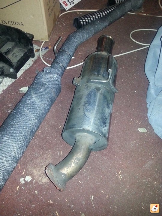

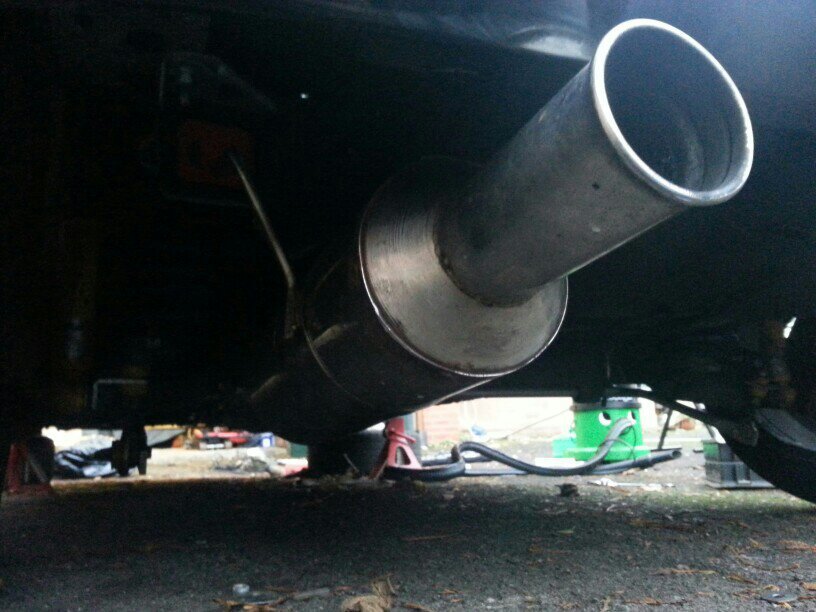

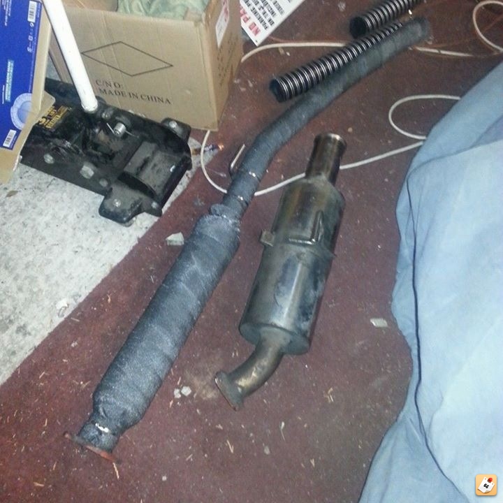

Just fitted my new yozza exhaust, made up with how it sounds and looks, iv done a db reading of my phone at 5k and it's peak was 100db now I know the iPhone isn't the best but I gets rough idea, when it's backon the road I'm going to take it to oulton park and get the to test it for me .il get some Piccys in the morning

Aye true. Had contemplated buying a db meter from the likes of maplins but one thing after another.

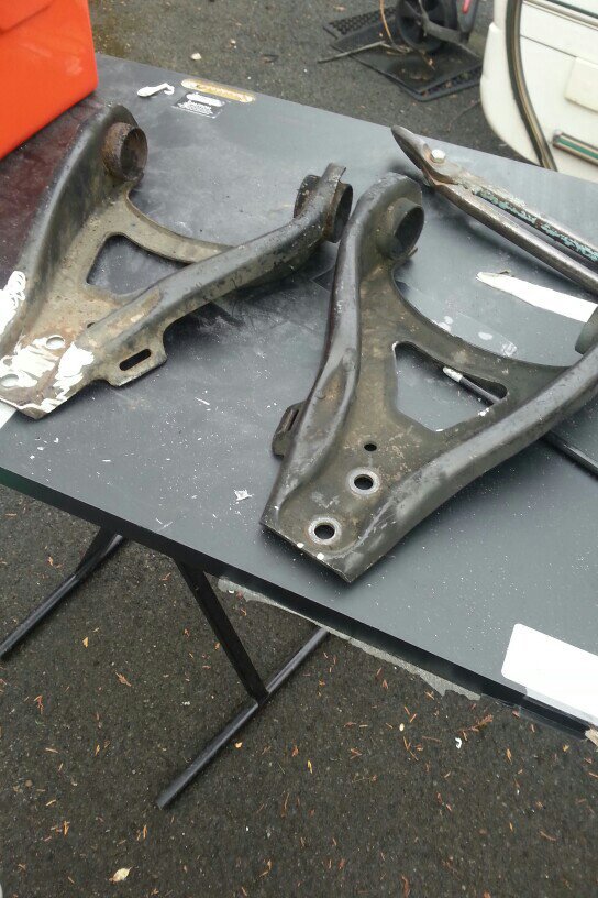

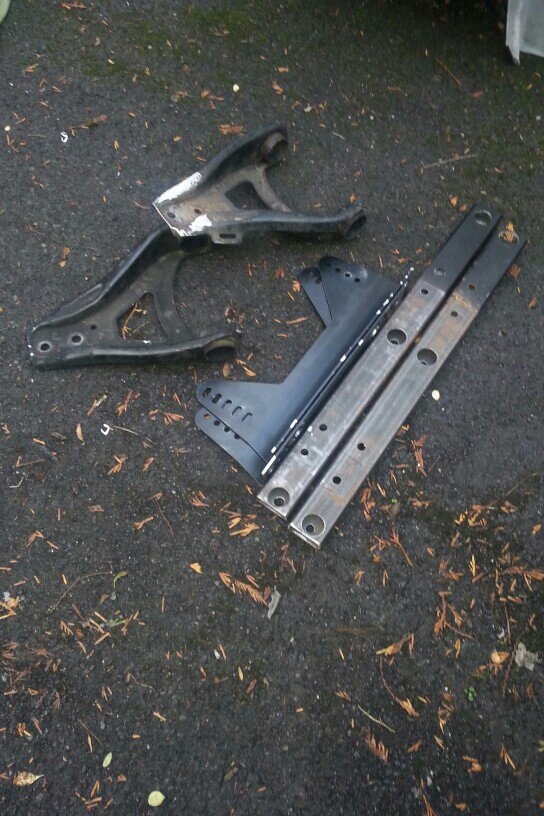

new cup lower arms of at the powder coaters going orange
More bits of to get coated

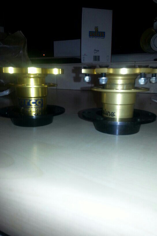

I bought a what I thought was a good removable boss which turned out to be a fake (left) so bought a genuine lifeline unit :)

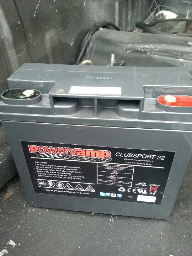

New batrery

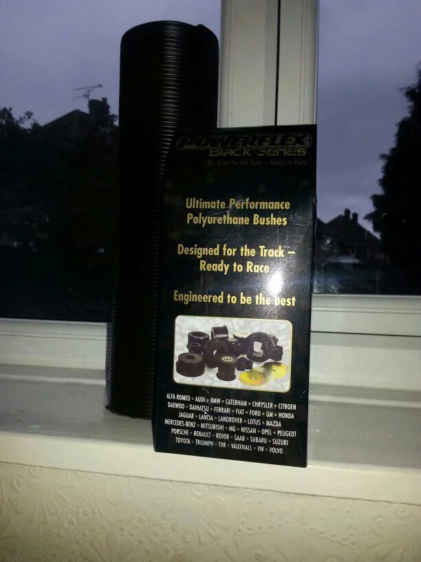

Lower arm bush kit for when the arms are back

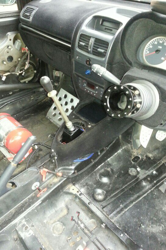

I went in on the group buy and bought the pure motorsport shifter .got it fitted today just need to make some final changes :)

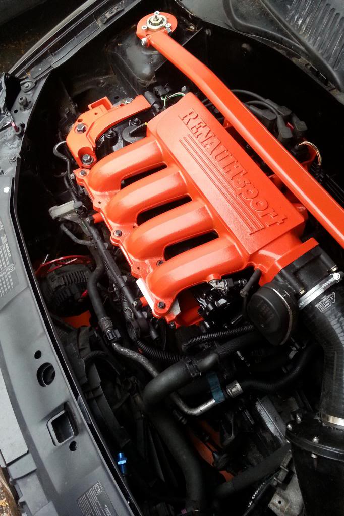

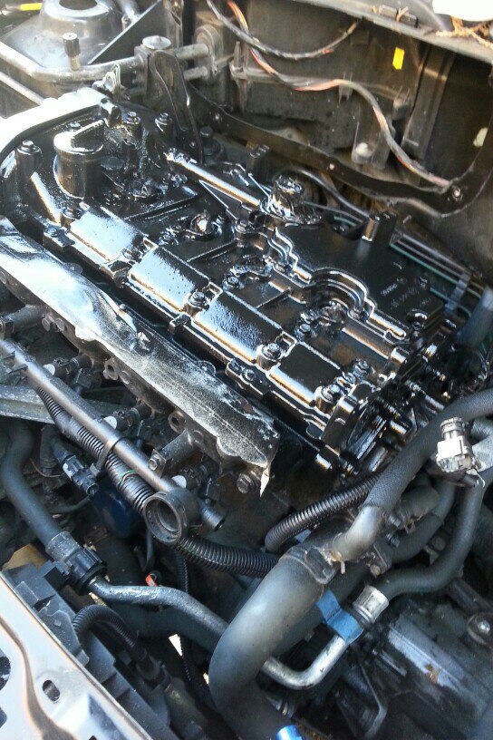

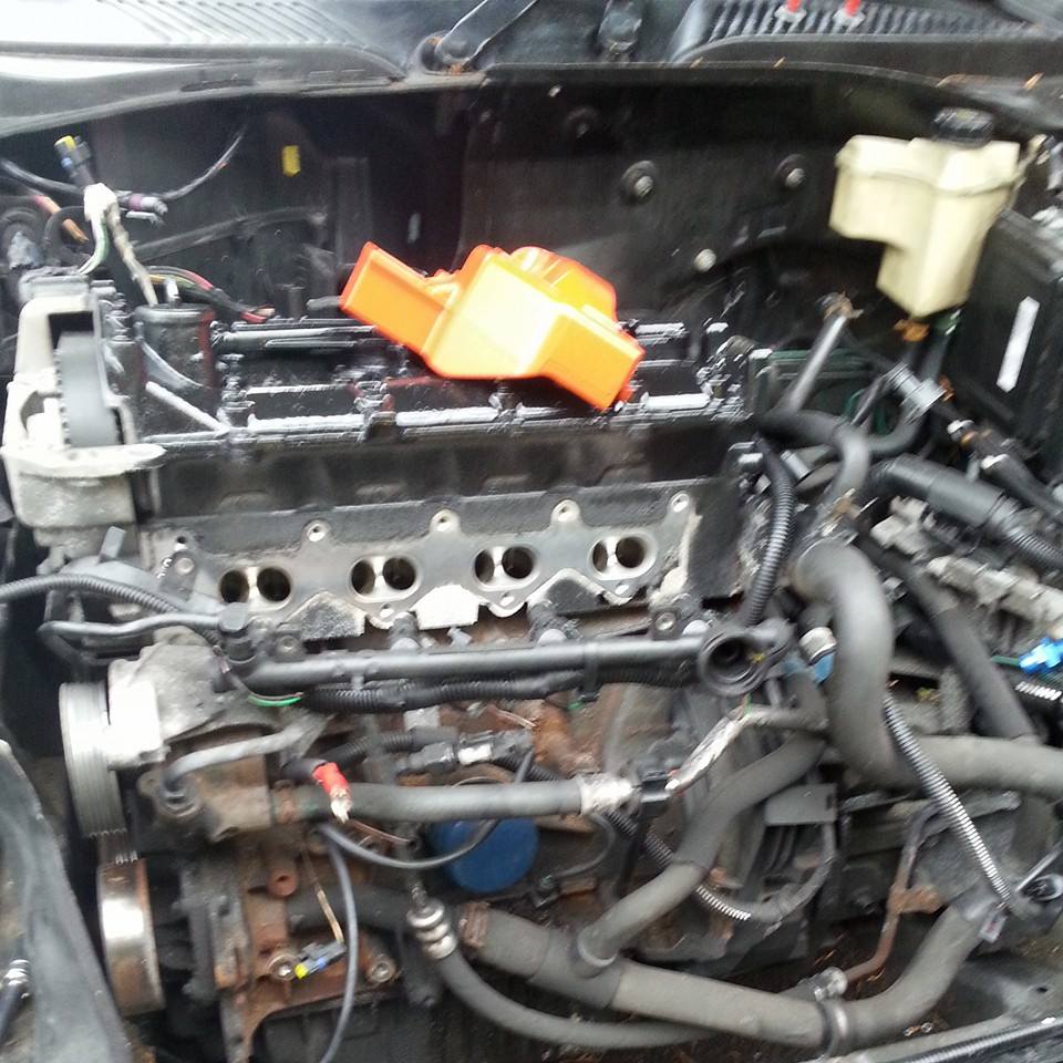

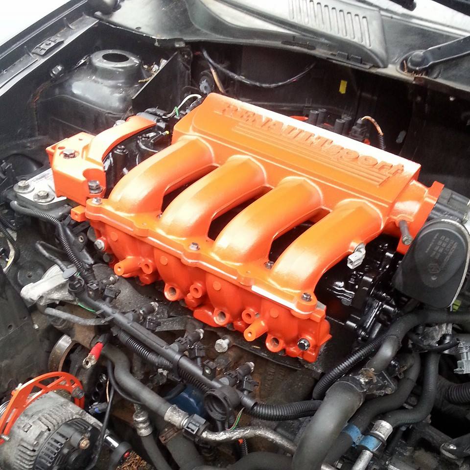

My inlets are away getting ported and matched so gave the cam cover a coat of gloss black crackle paint

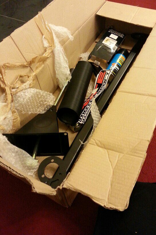

2, pure motorsport air con delete kit

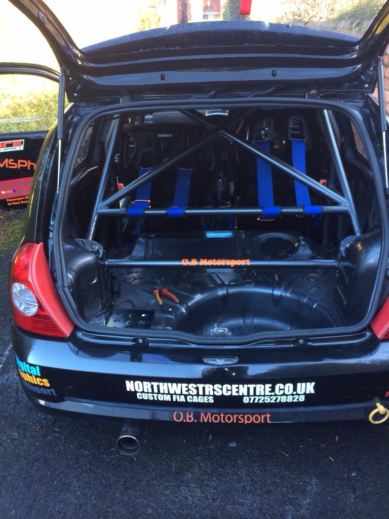

The car is also going back to northwest rs to have some bits added to the cage as my fiberglass doors will be ready soon .

Managed to get my pure motorsport shifter working apart from the self center .

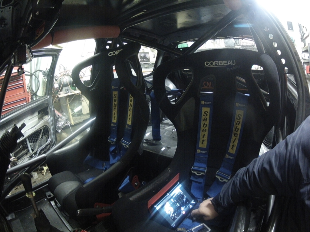

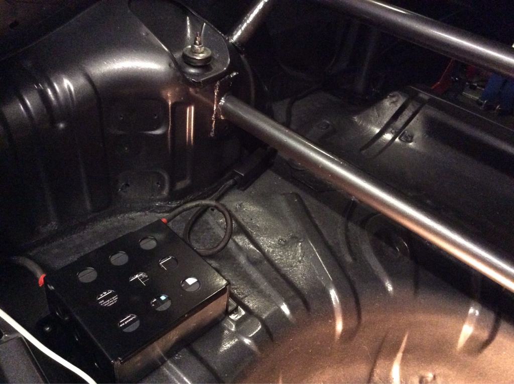

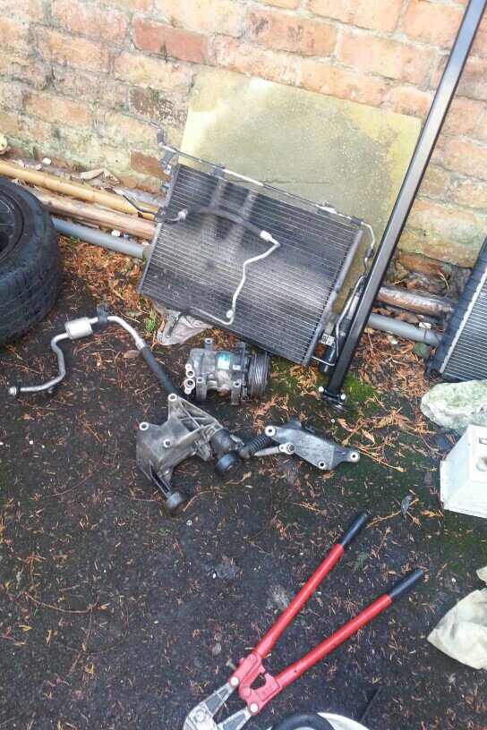

Also we made a start on getting the aircon out .:) just waiting for my pure motorsport aircon delete kit to turn up :)

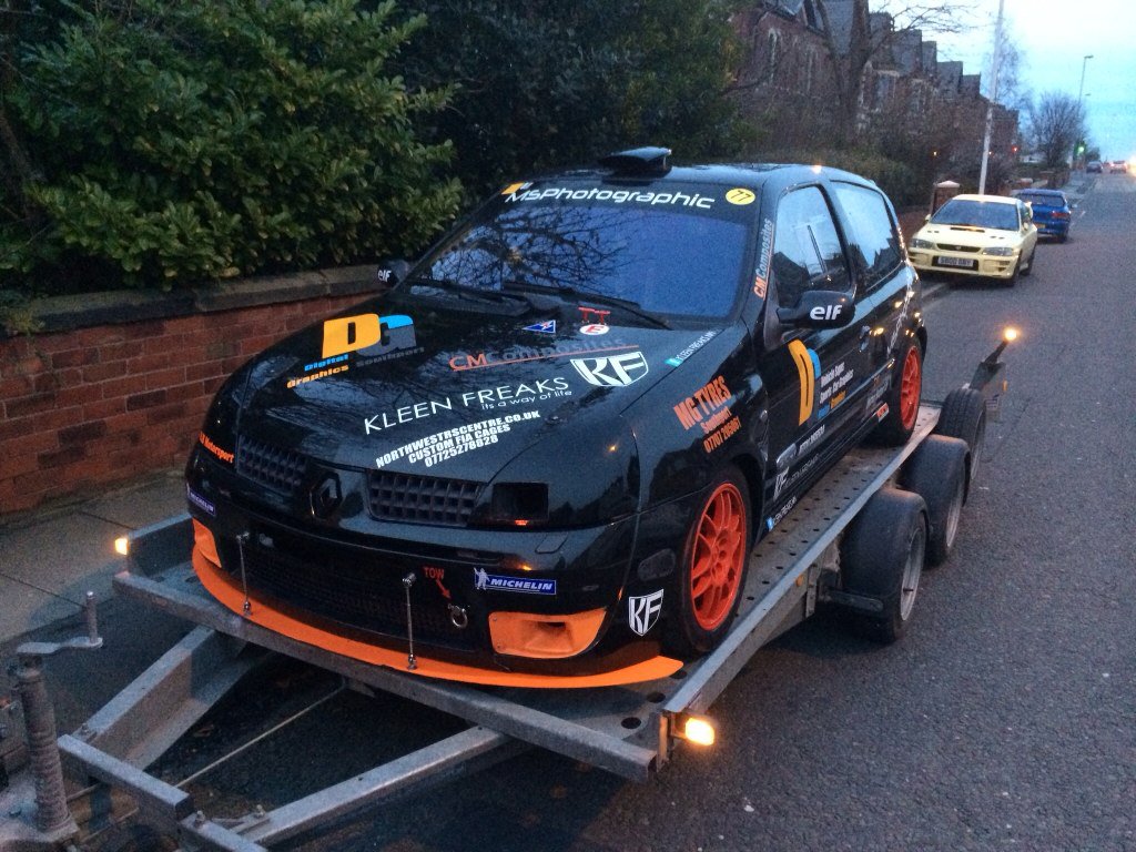

We'll I've not updated this in a while as to be honest if fell out of love with the clio, a couple of weeks ago I got the car to Anglesey with a couple of my mates ,the weather was ment to be horrid but turned out to be great but.... My car ...was not so great ,it was my own fault really. After changing loads of things over winter and the car not being road legal or me not having an trailer or means to tow the car to get the ego setup properly I stupidly tuck it to Kwik fit near my house ,I wanted the lad to set the tracking straight as I have changed the coil over springs ect this winter and also asked him to add 2 degrees neg camber on the front, once if got back to my car after him having it for an hour I noticed the wheels did have more camber on so I was happy, my dad towed me back to my house where I washed the car and we stuck it onto an hired trailer, so when we got to Anglesey the first lap out I had a misfire but with the car not really been run for a couple months it thought it could just need running ,sure enough one more lap and it was fine but the engine man light kept flashing, the car was running ok and spoke to my mate he said ignore it , so I did, we'll once I'd let the tyres warm up and everything was going well and I started to push harder into the corners I realised I had no control during cornering , it was that bad even at low speed it would under steer horridly , after ages of playing with the tyre pressures we realise that instead of putting just 2 degrees camber on he had in fact put near on 4-5 degrees and 3 deg toe in, honestly I could not control the car, so at one o'clock I called it a day and packed up and headed home.
So now the plan was to get it road legal so I could drive it to blink Motorsport and get a full corner weight and geo setup, so I taxed and insured the car as it still had an mot on it but now if traced the miss fire fault back to two faulty injectors , I've got some on order and should have them soon so will get them fitted and see what damage has been done. The dephaser seems to be getting abit loud as we'll so I'm going to get that done and a new Cambelt soon along with some cams.

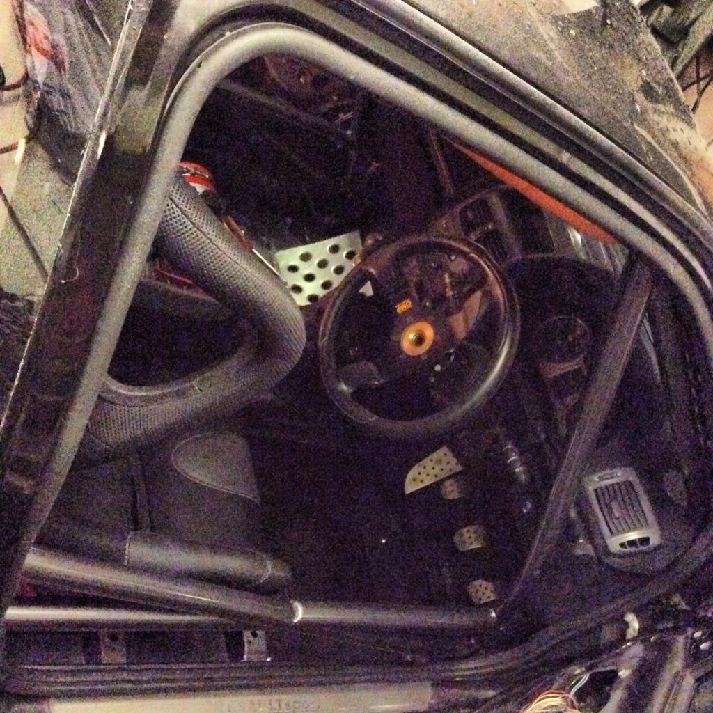

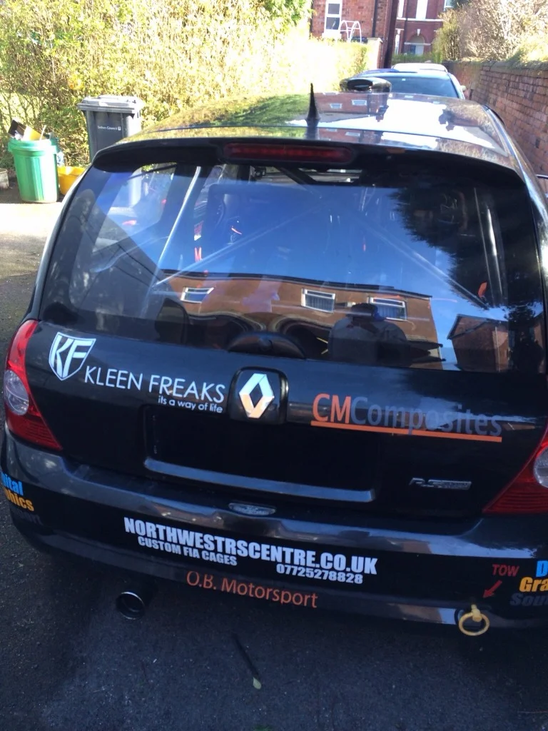

Forgot to add I have had some more bars added into the cage as I was only running an single door bar ,also had the entire of the inside sprayed an really nice grey freshened it up abit :)

I didnt enter pal . But as I was leaving my pure motorsport shifter hit the floor and pulled the circlip out again.had to get the rac to come put it back in.im just at my mates unit with the car now got sone bits to fix and replace as iv booked on at Blyton on easter monday :).
