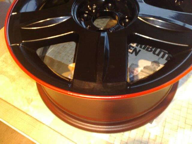

did you take the wheels of the car and the tyres of the wheels to do it? how did you prep it? thinking of having ago myself.
Bascially i had them powdercoated black then masked off the wheel, used a really thin detailing strip to get the curve then used just normal masking tape and newspaper for the rest of the rim. Used wet and dry to sand the bit i wanted to spray, then primered it using Halfords red primer. Two or three coats of red paint and a couple of coats of laquer and this is the result! Taken me a while to do them, but i wasnt in any rush to get them on so just took my time
They look like this without tyres
looks quality mate. really suits the colour of the car. i wouldnt do the diamonds the same colour, if anything id do them black.
