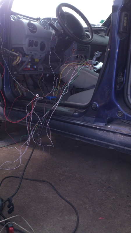

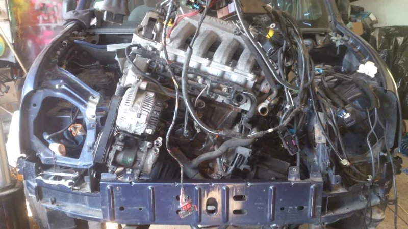

Just did Kangoo 4x4 F4r 736 for myself :)
It was quite a journey through connecting it to 4x4 gearbox but I managed to do it in 4-5 months(electrician broke my ECU and I was stuck on this for 1,5 month...)
Few pics from build
[/B]That's what is left from clio wire loom inside car(apart from full wire loom on engine).
It works, drove it for the first time 3 days ago, already did 100km eliminated most of rattles and bouncing exhaust pipes, only one rattle left at about 6,5krpm but I'll fight it in few days :)

It was 1,6K4M 4x4, it's done 500miles already and so far so good. I expected a little bit more(exhaust behing cat is too restricted but I need money so...) but if the driving gear will survive a year with this engine I'll buy F4r from megane with turbo.
It's really fun on wet. :)
Few things are mixed up. Right mounting is from kangoo.
Flywheel is from clio with "spacer" ring from some diesel flywheel to fit my kangoo clutch clamp(dunno if it's right name).
Starter motor has bigger holes for adjusting it to flywheel in different gearbox.
Exhaust manifold was cut into pieces and rewelded(dimensions are the same as original) because original colided with power supply for back wheels.
Had to cut hole in floor on passengers side for end of manifold to fit :)
