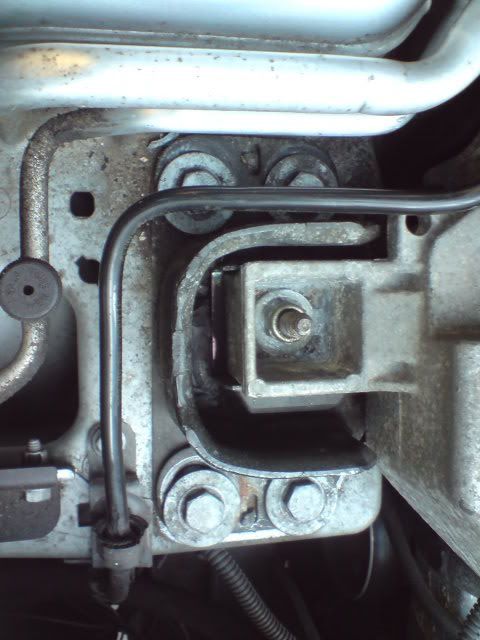

So heres the prob :

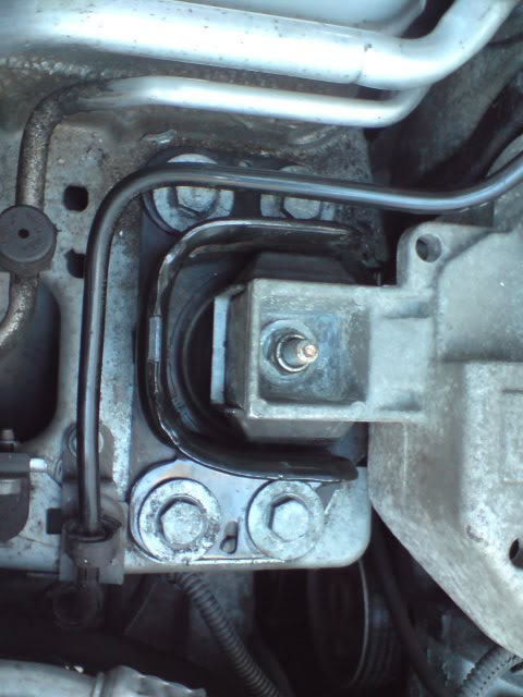

I've manged to unbolt the mount & move it around abit but it still aint right though :
I've pulled the engine forward & it does shift but as soon as i let go it goes back... Now my guess would be that one of the lower mounts is of some where so was gonna strip it all down at the weekend but before i start just wondered if any one else has had a similar prob.. will save a few hours head scratching lol

the buffer inside the mount looks like it's worn right away on 1 side. Renault wont sell them separately so it's a new mount or find a good used buffer piece from someone. Looks like the mount has seen better days anyway to be honest

is the mount itself still intact - not split in two? it looks completely shot - the base plate is pushed in in the bottom photo, but the mount is still way too far back
should be possible to get alignment by slackening the other mounts and hufting it about if it's the same problem with the new mount - unless there's something up with the shell/subframe?

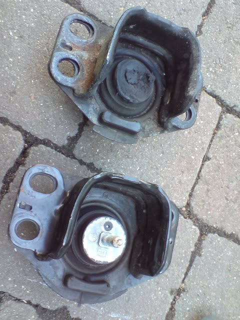

Decided to start it tonight, So, supported the engine & started to remove the mount.. to my horror it had completly snapped, old next to the newish one

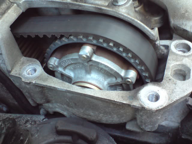

Cambelt was looking good :)

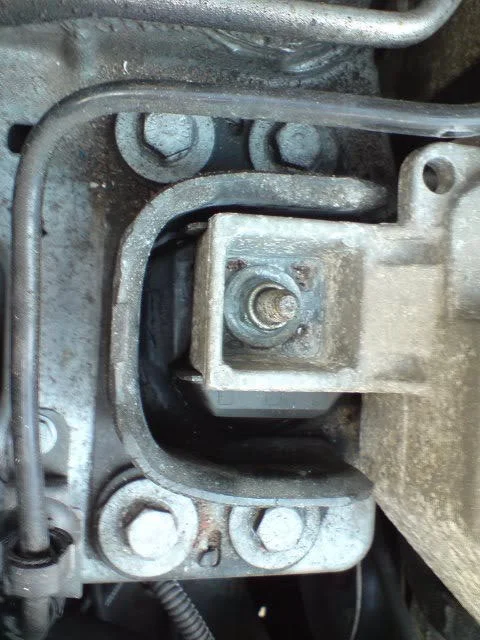

So then i loosened off the gearbox mount & gave the engine a good f**king rock & bolted it all together...
Walla :approve:
Just gotta go for a spin tomorrow & hopefully that was making it feel nasty to drive, engine is nice & solid now ;)
