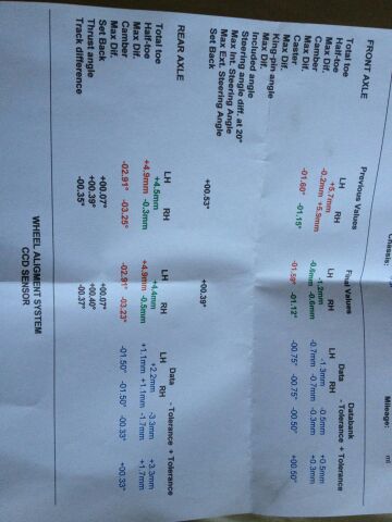

What do you guys think of this? Bent beam or stub axle?
Car  Clio 182
I Had my tracking done a while back and heres my print out.
Sorry about the sideways-ness but not sure how to turn it around on my tablet
So yeah i know something is bent but not 100%, as on the n/s i have 2 degree camber shims and on the offside i have none and im also toeing in nearly 5mm on the n/s. I did have an incident where the caliper fell off after collecting it after i bought it whilst going down the motorway, i have a sneaking suspicion it has something to do with that.
Opinions welcomed.
