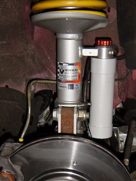

what is so special about the trophy setup?
The remote reservoirs allow for thicker and stronger strut for enhanced camber compliance as well as thermal stability. Are they gimicks? Autocar doesn't think so:
"......the Clio Trophy is a car with so much damping sophistication that it achieves the impossible. It rolls less than the Cup, has less suspension travel at the front, and yet it rides fully 30 per cent better than that car. To drive it fast over virtually disintegrating asphalt and feel just how well controlled each wheel is for bump and rebound is eye-opening......" http://www.autocar.co.uk/CarReviews/FirstDrives/Renault-Clio-2.0-Renaultsport-182-Trophy/216093/

Full rebuild of both front dampers is £300-400.

Why do you ask ? The fact that its inverted or not doesnt really matter. Whats important is how the damper is made, how its valved, what spring it is matched to. then all that depends on what the damper is used for. all this is far more important than whether its inverted or not.
Is the sach damper inverted? Why do i have to keep asking this question to be ignored?
Inverted or not?
Sorry didn't realised you were asking me personally. The answer is no.
