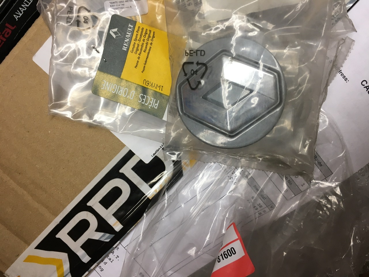

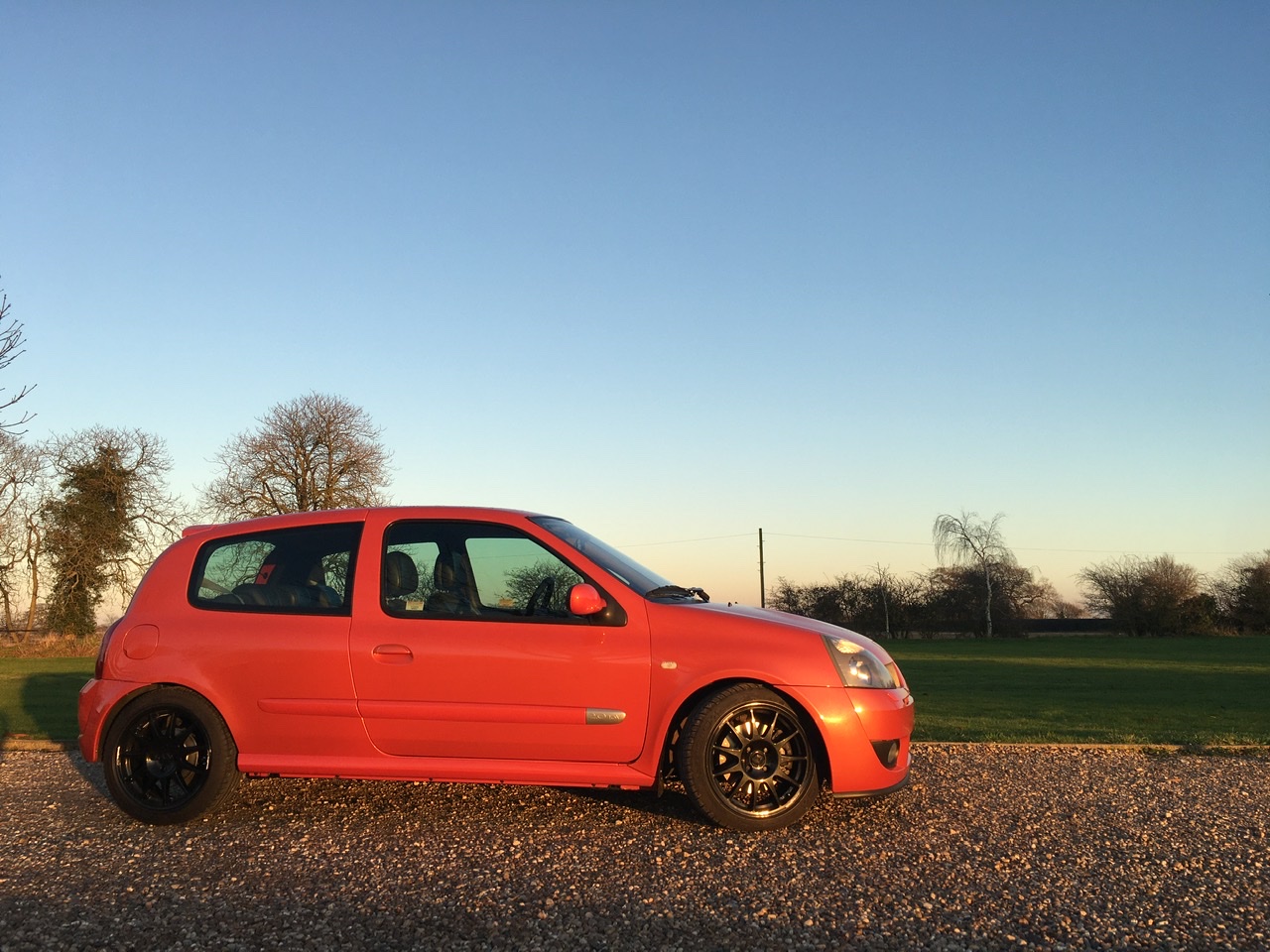

Ladies & gents,
Does anyone have a colour code for the OEM trophy Speedlines? Assuming its different to the OEM Cup chassis wheel colour?
I want to swap my wheels to anthracite and have subsequently purchased 4 new OEM Trophy centre caps with a view of getting my gloss black Turinis done in anthracite.
Can anyone help me get the correct colour match?
Also recommendations for wheel places in Essex :)
frayz
Only because i purchased 4 brand new OEM trophy centre caps and wanted them to match.
No other reason, so im guessing providing the colour match is pretty close it will look fine anyway.

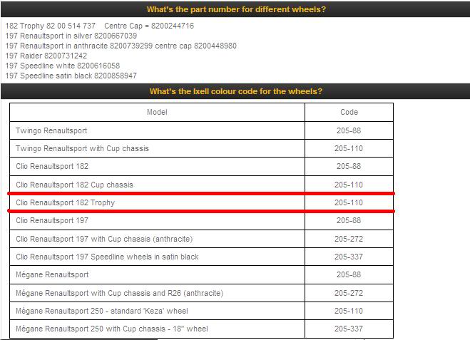

@frayz
The paint code is different to the powder coating. Powder cant be mixed like paint so the code will not be applicable.
I have seen powder coaters wet paint the wheel with the 205-110 and then use some sort of clear powder coating to cover the wheel rather than lacquer.

Hey there, what's the part number for the turini center caps? Thx!
