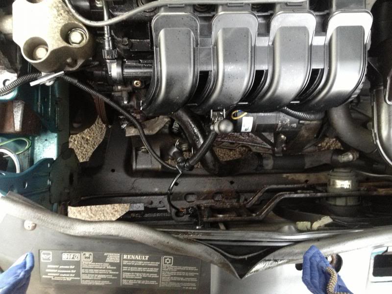

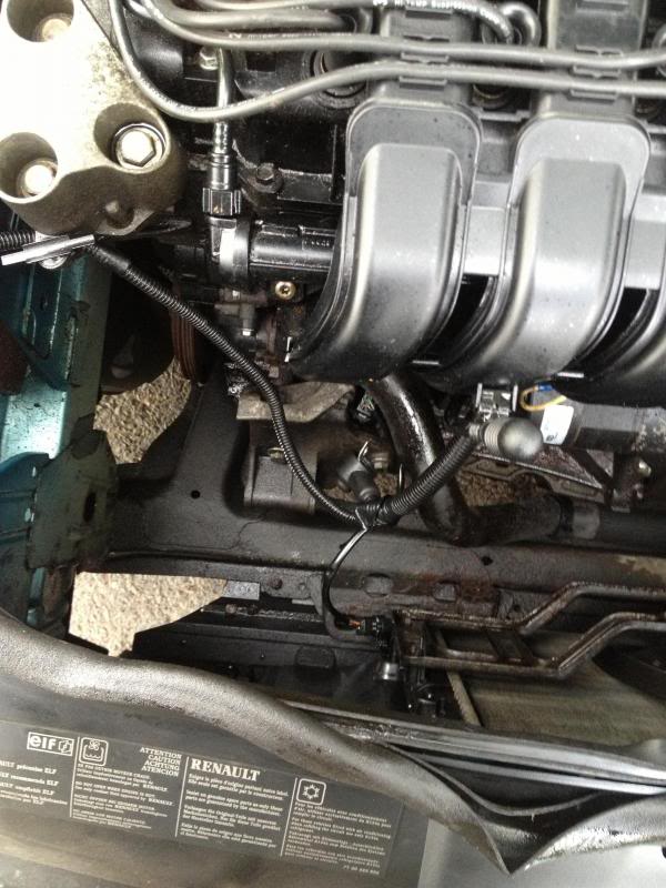

What's this engine bay missing please?
The brakes are non existant on the car btw - is this lack of something the cause?
The two wires come off that main loom and go nowhere
There's also a pulley with nothing on it
Any help appreciated.

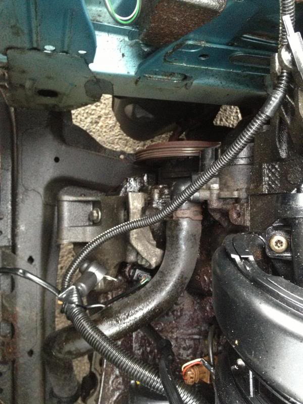

Surely it can't be driven that far, brakes working or not.... Your water pump won't be working!!
Yep alternator is missing
You can see in this pic
The bottom bracket is there - the top bracket is there - the big power cable with the O-ring on the end is the mains feed from the alternator - and the wires going nowhere also should go to the alternator
You need the bottom bolt, to bolt, alternator, belt etc...
But as said that same belt runs the water pump so if you drive it much it will overheat and the head gasket will go bang pretty quickly
You wouldn't have a PAS pump as it's electric on those cars
I guess the alternator packed up, the guy took it off to replace it and then gave you the car
No no!!
The two ph1 1.2's I worked on both had the alternator at the back of the engine!
​some renault 19's also had this setup!

Fair enough, I've never seen one with that setup. Pics ;)
Simple enough way to find out, does the charge warning light come on? He says it drives fine so presume not which means alternator is present???

Looking at the pics again Danny is definitely right, that big pulley is actually your crank pulley by the looks of it.
Angles of the original shot made it look weird
You can see on that pic where the hose goes to the water pump - so it looks like you're just missing the alternator and an alternator belt
Brilliant thanks for the help from the useful people, I'll grab one this weekend. By runs, I meant it ran fine when I took it off the lorry and stuck it in the yard.
On the hunt for an alternator, belt and brackets this weekend then!
