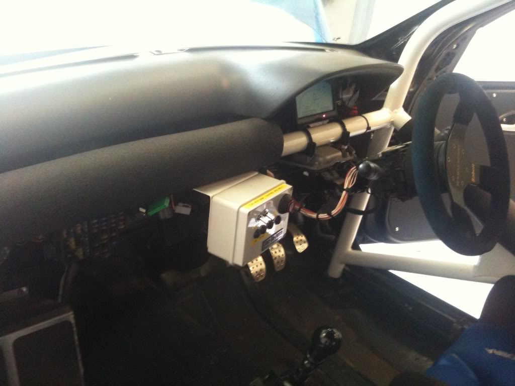

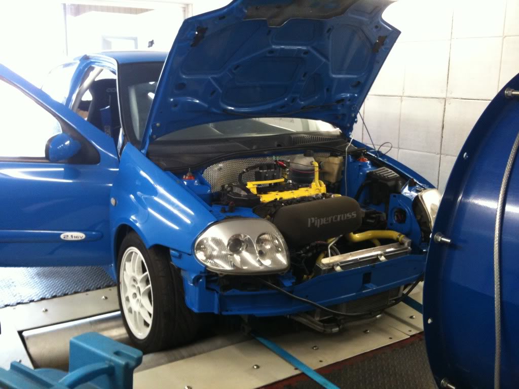

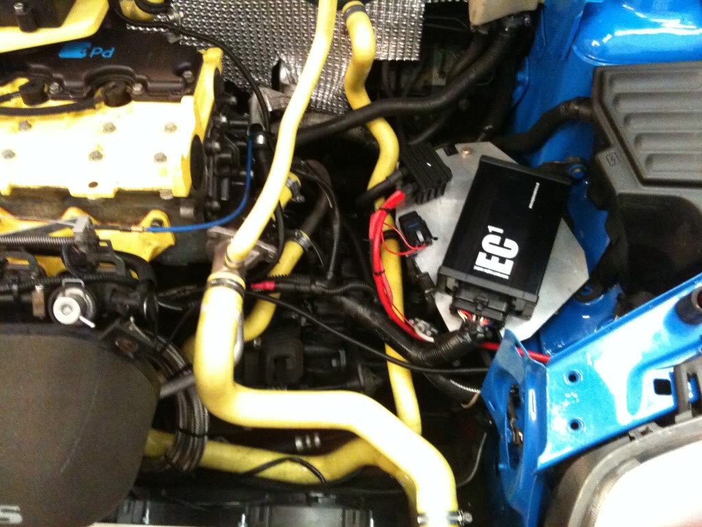

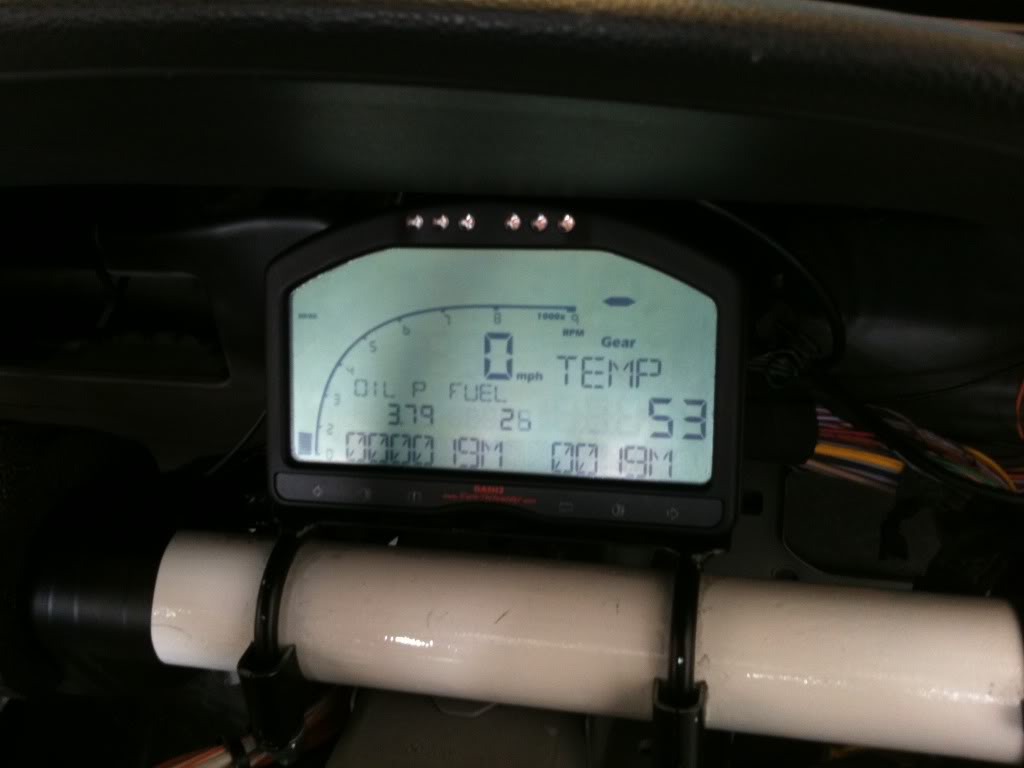

The work by Tour-De-Force has been completed. Its had a new EC1 ecu + cal, Renault ecu removed, engine bay loom separated and removed what wasn't needed, control box wired up, DASH2 fitted and calibrated, heated windscreen wired up and much much more.

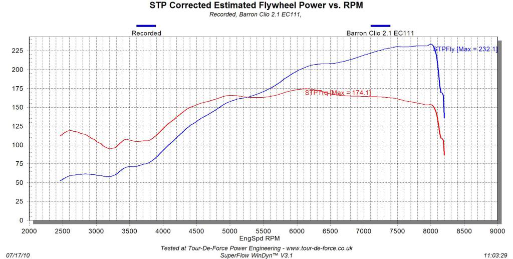

The car made 232bhp and 174ftlb
The Spec;
F4R engine re-bored to 2.1ltr (2066cc)
Wossner Forged Pistons (12.8:1) 84mm
Catcam Forged Conrods
Catcam 423 Race/Rally Cams (VVT Delete)
Jenvey 48mm Throttle Bodies
Jenvey 120mm Trumpets
Catcam Uprated Valve Springs
ACL Race main/thrust bearings
King Race big end bearings
Full Race spec Headwork (AP Developments)
TDF EC1 ECU
Lightened Billet Flywheel
Catcam Adjustable Vernier Pulleys
Catcam ARP Bolts
Full Samco Hose Set
Helix Paddle Clutch

Good gains, but a Honda H22A7 is near the same CC a few more and has that power standard on a good one.
Be nice to see a 250hp+ F4 though.
