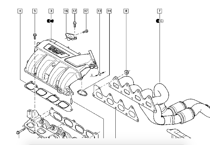

What size are the 10mm plenum bolts?
Hi guys what size are the 10mm plenum bolts changed my plugs today and the rear left was missing also plug number 4 was very oily hoping I can go grab one from halfords
Thanks
Make that 3 bolts needed torqued to 11nm two bolt heads went am I missing somthing here f**king scared to touch it now lucky just heads went to took plenum back off and was able to get grip on them
Item No 5
FLGD HEX HD SCREW M6x100-25 8-
7703602272
£0.89 = Vat Each
I would buy dealer only but thats just me.
Try B&Q or a hardware store if you just want a bolt.
Will just get what I can from halfords tomorrow then order full set monday am I using the correct 11nm?
Also hoping oil in plug 4 was from recent oil top up anyone have any ideas if I check again and it's still there

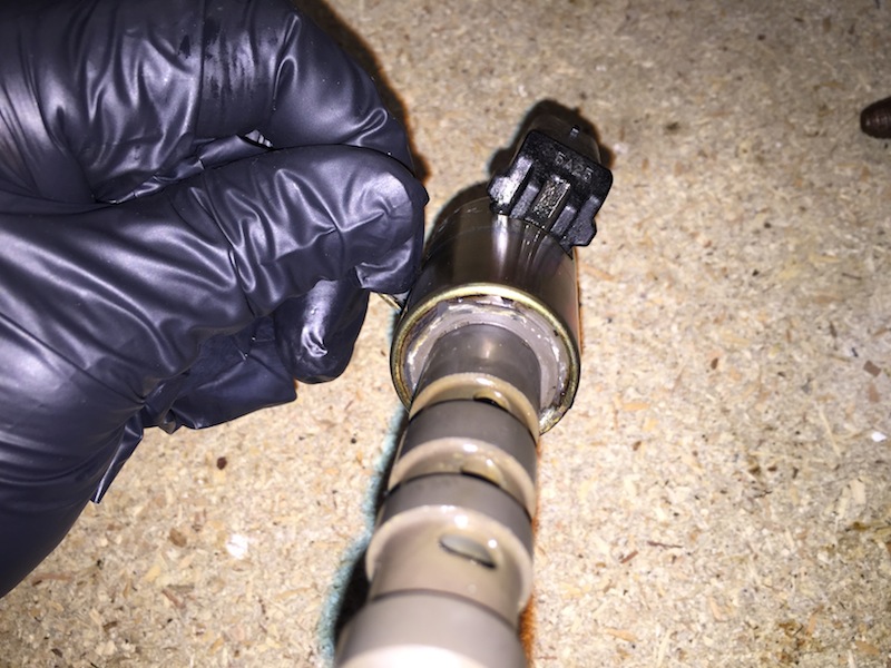

VVT Seal can also leak.
Worth changing that also if you are in there.
The part number is on the bag - 7700106385
Undo the electric connector, Undo bolt and the VVT Solenoid will come out as so -
Then use a hook or small screw driver to bend the seal as it is Rubber & Metal like i have posted before and then pop it out.
I used some oil to lube up the new seal and then tap it into place with a socket thats was the same size so it went in evenly
Cheers sorry didn't spott that think I may need to look for a guide more for dumbys as I don't have a clue where to start on that ha thanks for your help though if there's a link for it from start to finish that may help
