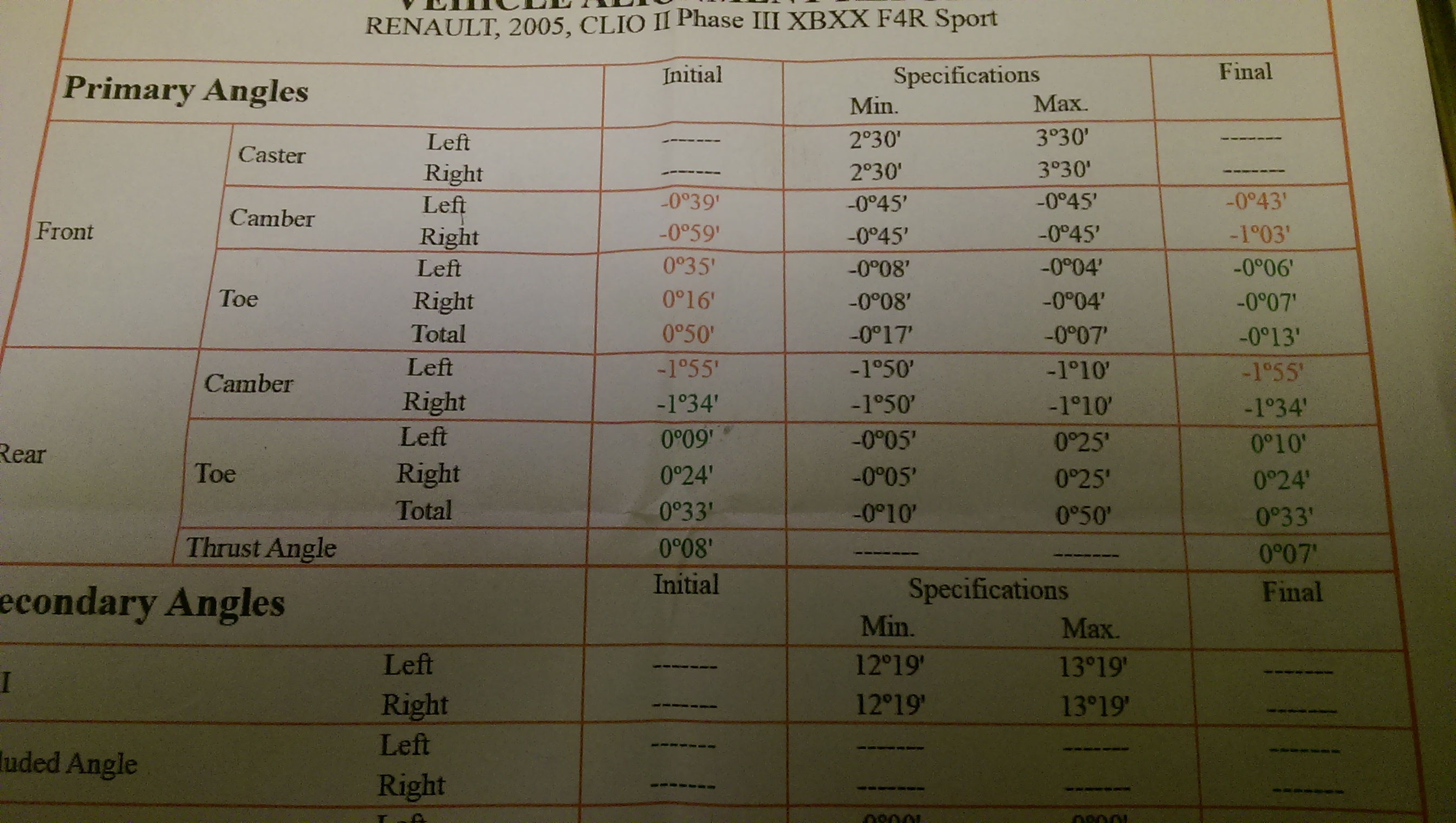

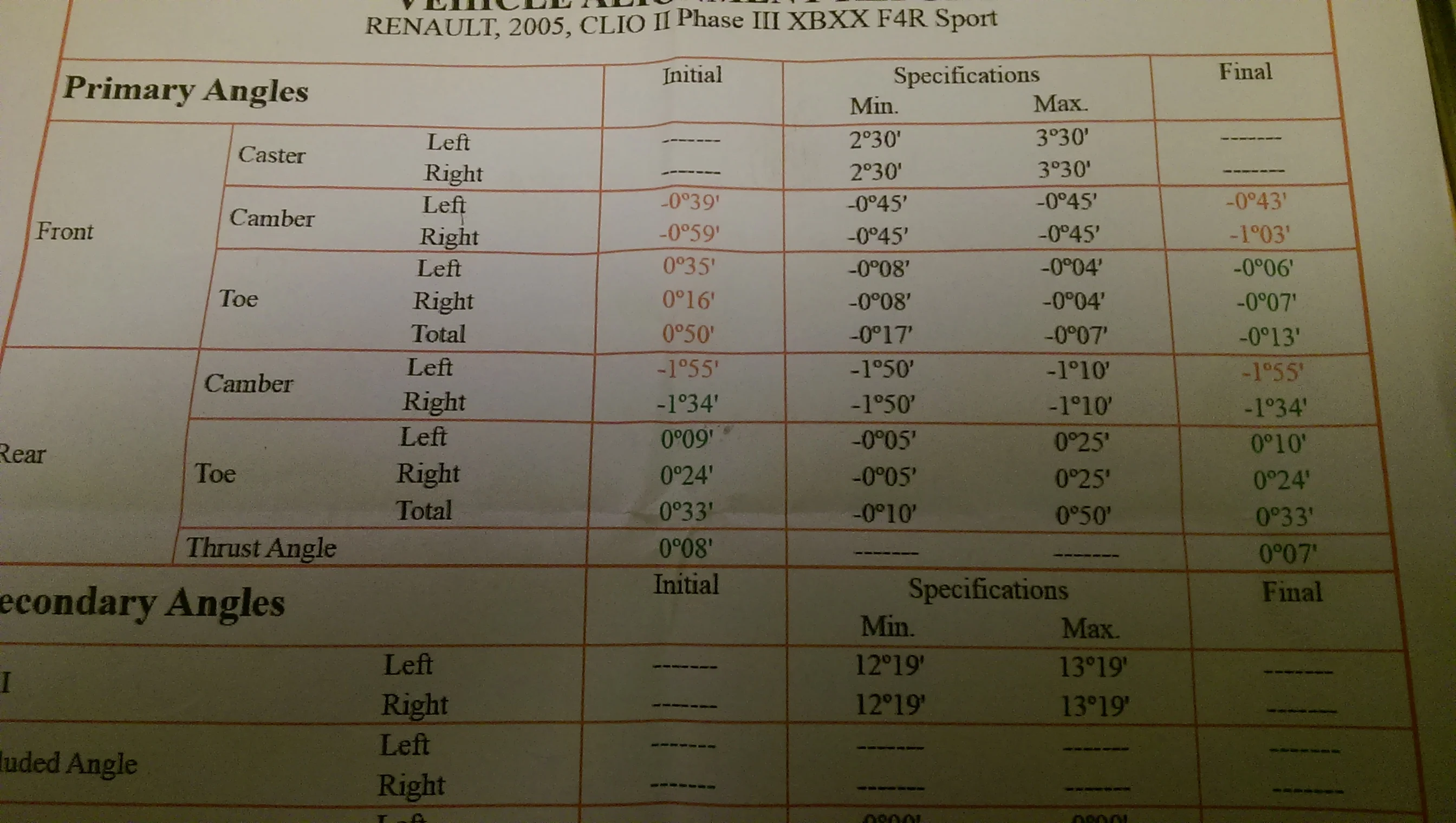

I'm in wigan , north west . i have Eibach springs front and rear , ( not low ) new rear shocks as well
as fronts , attached last one the did . ta guys for all this help and suggestions .

Thrust angle should be 0 IIRC?
OP, unless you have camber bolts, there is nothing adjustable on a 182. My 172 had +1 degree of camber on one side and -1 degree on the other. That's just how it is sometimes, you need camber bolts or adjustable top mounts to do anything about it.
The final figures look ok to me though, if it's all over the shop then it suggests something's not done up correctly on the suspension. If it drives fine but the steering wheel is angled then they've done it right, but not aligned the wheel properly.

Yeah, it's exactly as I thought. 13 minutes total toe out is a fair bit, although it's still within reason for what these go to. The more toe out you go, the more the car is going to wander over the road, following the camber and bumps. It's the hit you have to take for the increased turn in response and general handling improvements that toe out brings.
If you want it to drive straighter I'd suggest getting it set up so the toe figures are closer to zero. There's nothing wrong with having them set to straight ahead tbh.
Also, the fact the inital readings were so massively toe'd in means you were always going to feel a HUGE difference in how it handled.

thanks for your help guys , i have no camber bolts so no way of adjusting the camber or castor on the front
this is correct isn't it ? so i need to sort the toe in closer to zero ,

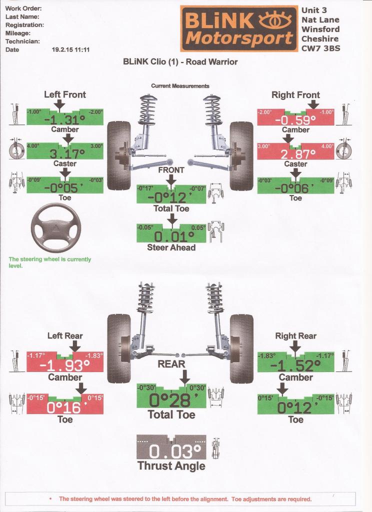

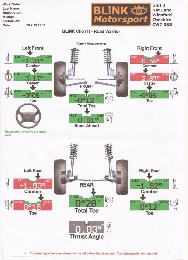

Here is my trophy trying to fit their fast road settings. I didn't have camber bolts at the time so you can see what needs improving on mine and the shims i need to bring the rear more symetrical.
which reminds me i need to go back somtime ;)
