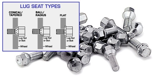

Are you sure its the correct bolt type?
The passenger front wheel is the most likely to come loose compared to the rest, had this happen on my last clio.
These are the different types, id compare your new bolts to your old ones to make sure their the same tips.
It should be the correct one, the conical type with 17mm head
