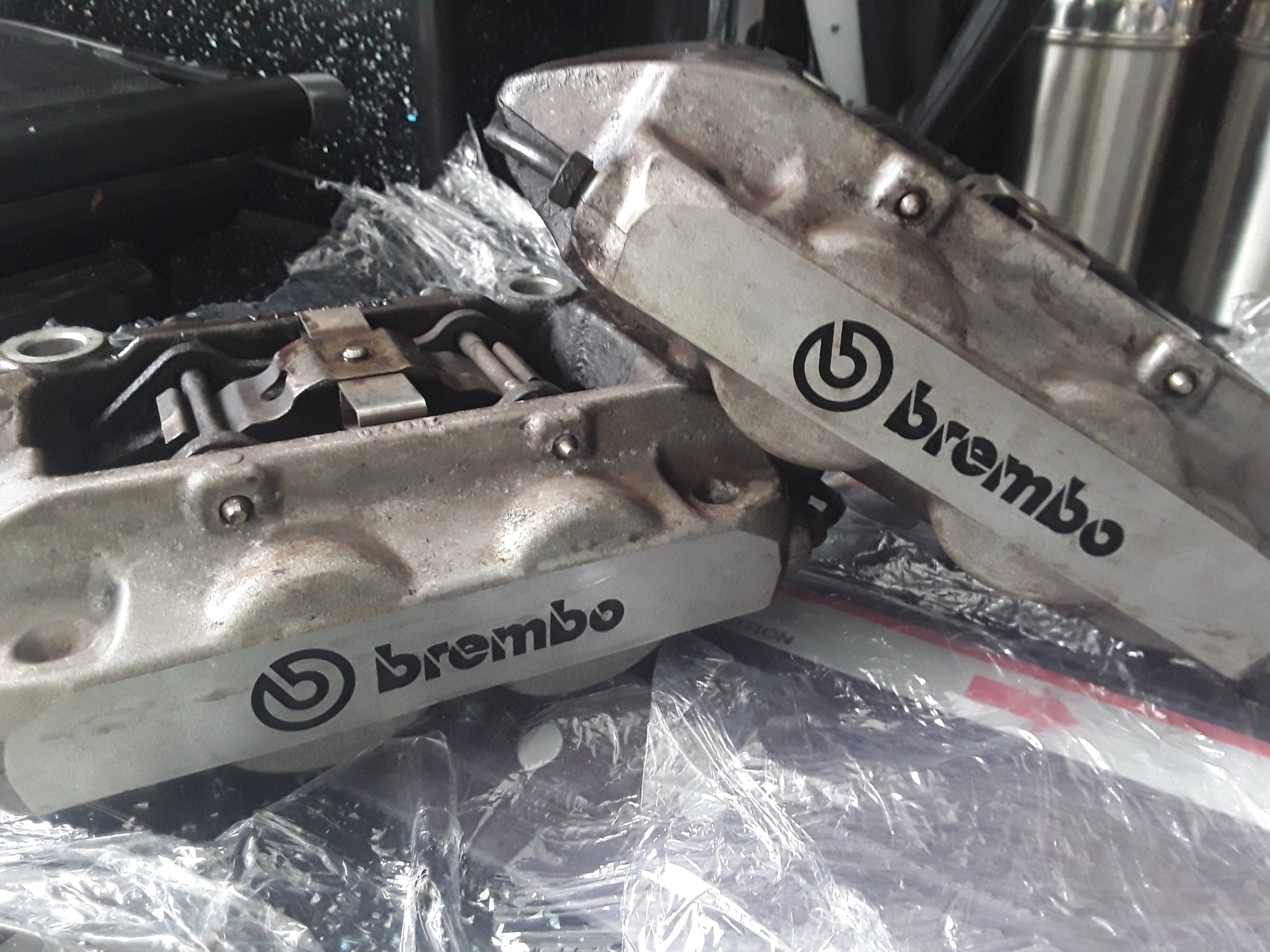

Morning folks, I know I've asked this before but I've completely lost the thread.
I have everything to fit a nice set of 197 brembos onto my 182 ff. Only thing I don't have is the wheel spacers.
My question now is, can anyone tell me the exact spacers I'd need for these bad boys for the wheels to clear the calipers?
Standard clio 182 16"wheels
Cup hubs
Standard cup shocks and springs.
300mm discs and brackets to suit.
Hubcentric or not?
Any help would be greatly appreciated folks.
Thanks in advance.
Dave Q.
bozothenutter
10mm, I use my standard wheels for winter (cup pack wheels btw)
and they just clear with a 10mm spacer.
the spacer will need a bit removing off the rim around the nut to seat the spacer properly though.
