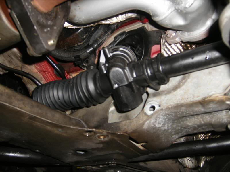

Will not help much maybe , but its supposed to look like this..
Got a pic from mike rentech.
  RS RIP
nope.. can't be bothered without knowing the correct one before starting on it.. i've been to the scrappies and they showed me a rack which lookes nothing like the above.

Update! (Good news!):
Wise-Kev ('Birchdown' on here) at Birchdown has sorted this for me...
He has sourced the right DCi rack, confirmed by the pic kindly supplied by Mike at Rentech to Franx to me (thanks guys!). It has arrived and already been fitted!
Feedback is that it is nice and 'short' from lock to lock - which sounds ideal...
Sorry I don't know the make and part number (PM Birchdown and Wise-Kev will confirm) but I do know it was only £57 + VAT on an exchange basis from Birchdown's friendly parts supplier (who is welcome to my accident-damaged slightly bent 95k miles 172 rack!)...
Happy days! :D
Thanks to all that chipped in with advice and suggestions! :star:
