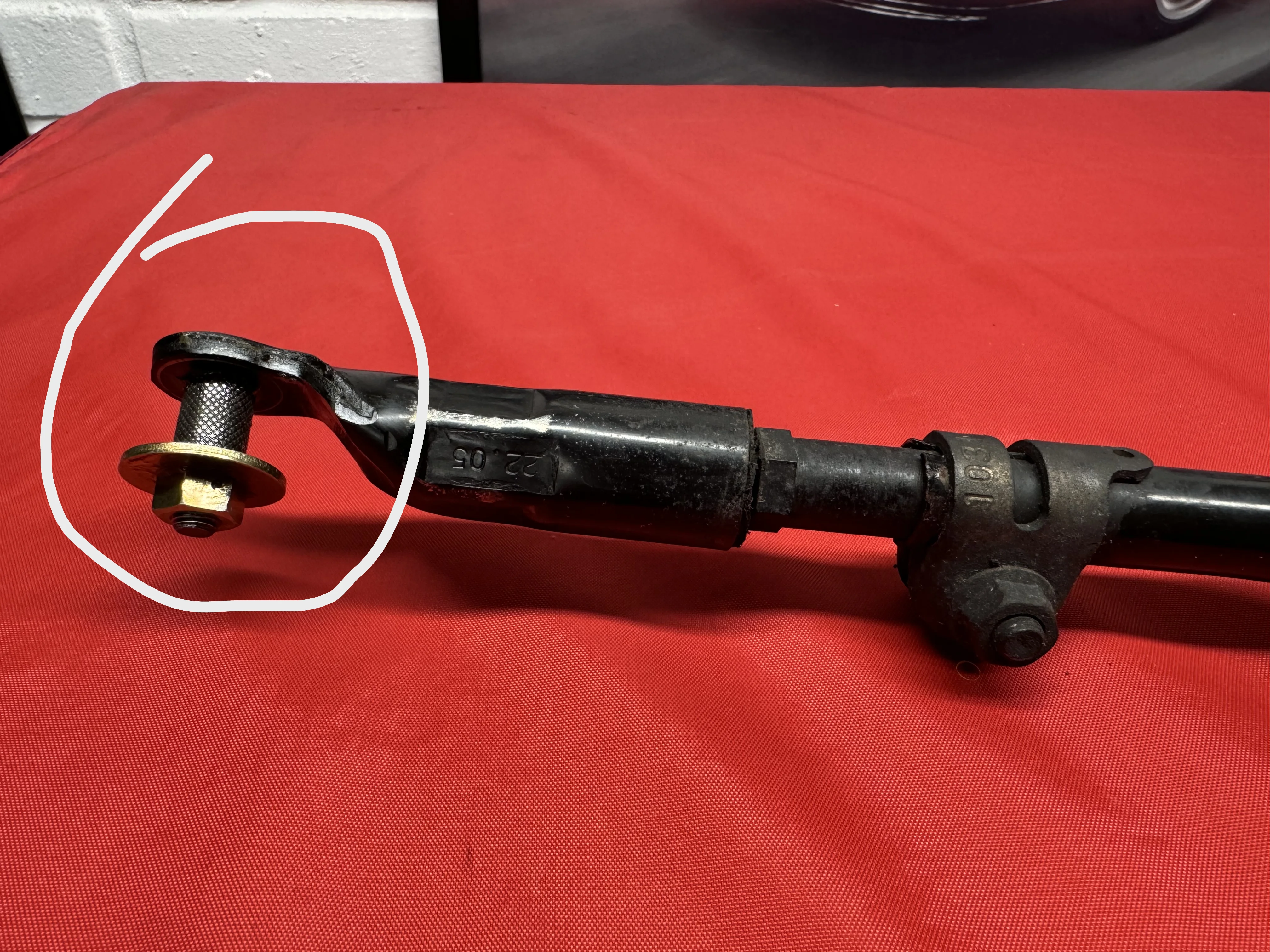

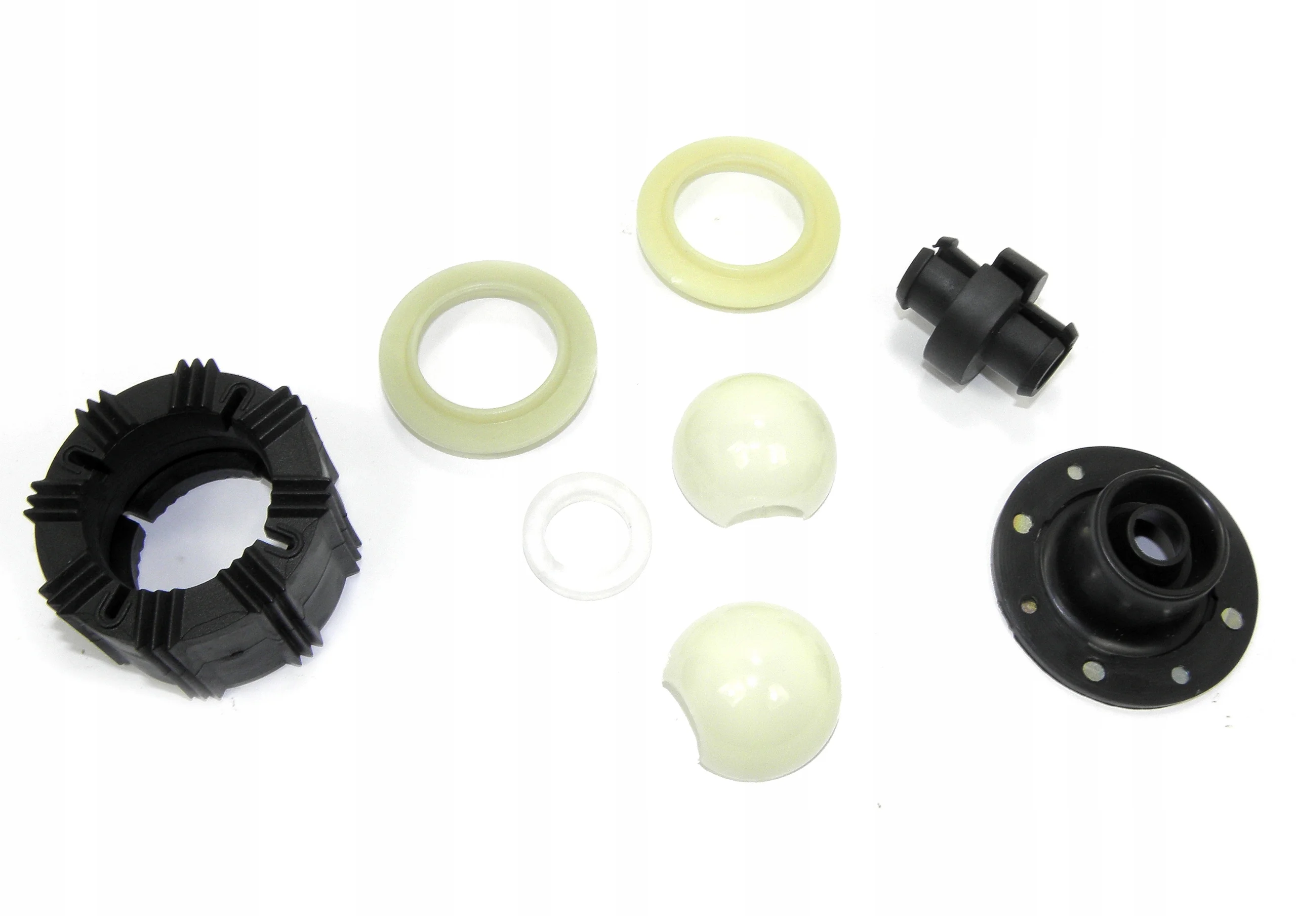

No, not the two piece one with the circlip. I replaced that last year. If you look at this pic (not my own) it's the bush that the circled part sits in, at the gearbox end of the linkage. It was extremely loose on my car but on a box he had on the floor it was tight. He didn't have a spare bush so he just tightened it up and that is what made the difference. This problem only started after I had the box refurbed by Mark fitted. At first I thought it was suspension related but as we started to replace worn out parts I noticed that this noise was always present. The new pin (the part that ends in the little white bush) is not an OEM part so the nut tightened today could have come a bit loose. What i'm saying is that this sound wasn't there before the refurbed box went in so mixing two worn parts (the refurbed box from a 182 and the original linkage) wasn't a good match and the area where they join has been the source of the noise. When driving a lot happens under the car which is hard to replicate with it sat still and me lying under it. On the move the gear linkage will be in an 'in-gear' position and the engine/box will be moving about and with the slop there will be contact. I had a go of the gear stick in an old 172 they had there and there is not as much loose play as my car. Lorenzo also checked the bolt/pin that is part of the gearbox mount set up and there was no real play felt (apparently this was a problem on some 172s back in the day). So, the new bush will be fitted and we'll take it from there, but I think we have found the cause.

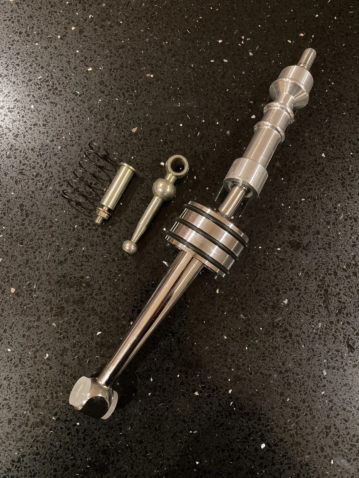

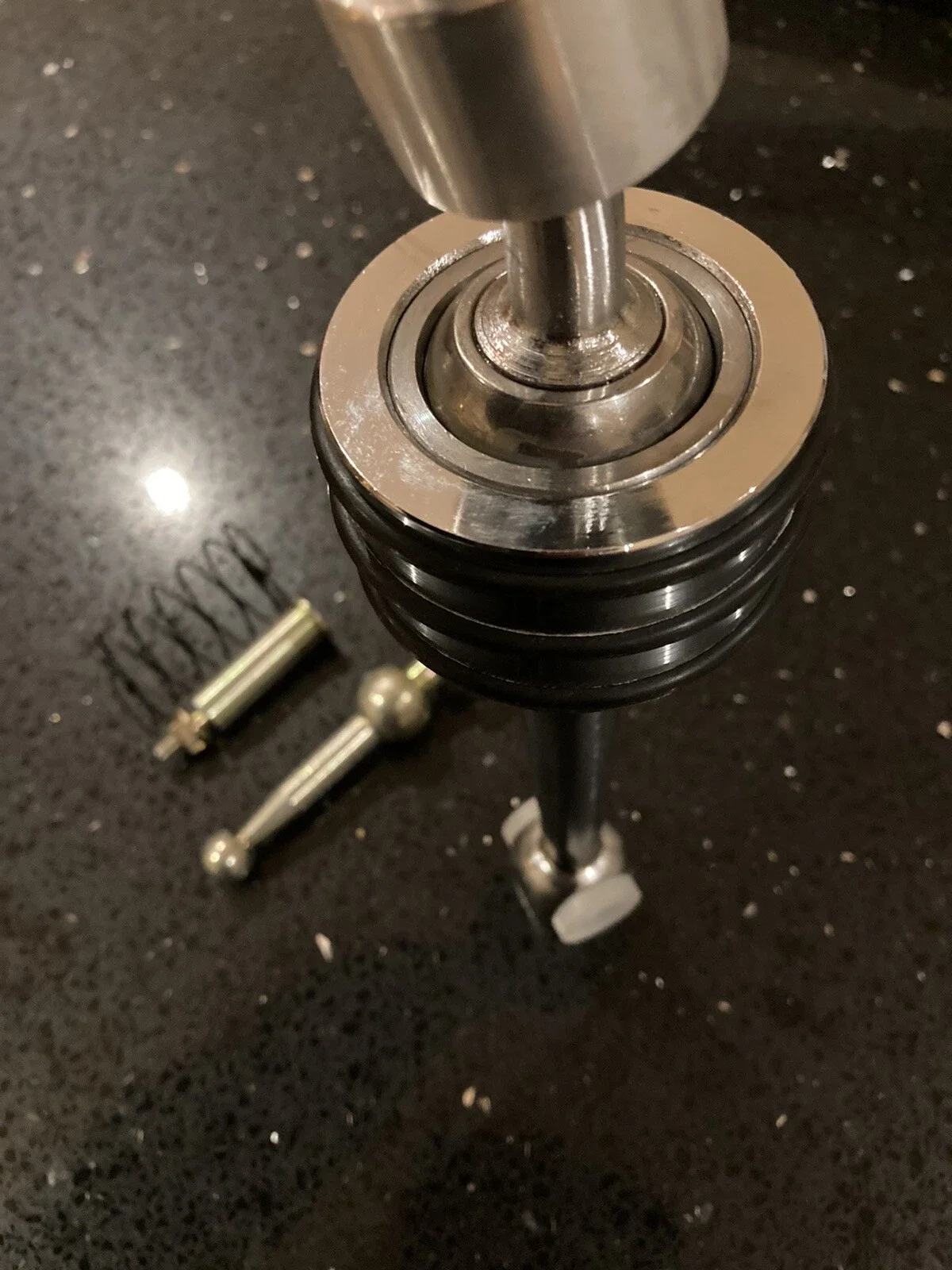

Can anyone tell me what kit is needed to replace the bushes under the gearstick? Is there a kit or do I have to get the individual parts? I think I’ve done everything forward of this point.
In a perfect world you would sack off the rubber pivot for a Yanoo Stiff Shift kit (which I also really rate) but unfortunately he passed away.
There seem to be aftermarket shifters with spherical bearings (that are not PMS) but no idea what they are like
It’s just under the gearstick stick that needs doing. Everything at the gearbox end has been done, including the tiny white plastic bush.
