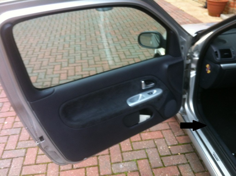

As above please, does anyone know what the wires are for that run down the passenger side of a clio 182, under the plastic cover that runs parallel with the renaultsport door sills?
Heres a pic of where i mean, sorry for stealing it but i didnt have one...
Thanks Tom.
I've just taken the loom out of my 172. The o/s had the fuel pump and rear lights for the o/s . The n/s had the same plus boot lock , wiper , boot light ,alarm wire and speakers also the top brake light. Also on both sides You find the wiring for the airbag sensors. Hope this helps!
