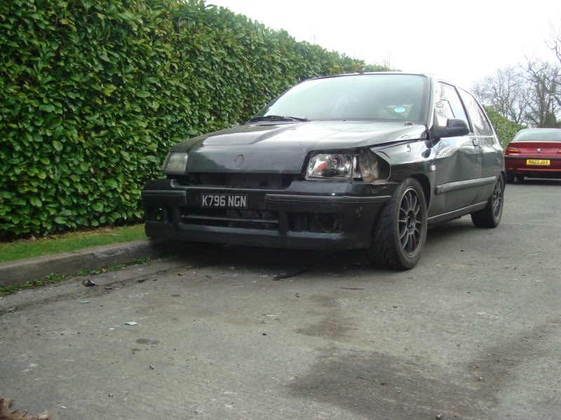

This is my current car, which is currently sitting in the garage with the engine half hanging out and the interior all loose falling about.

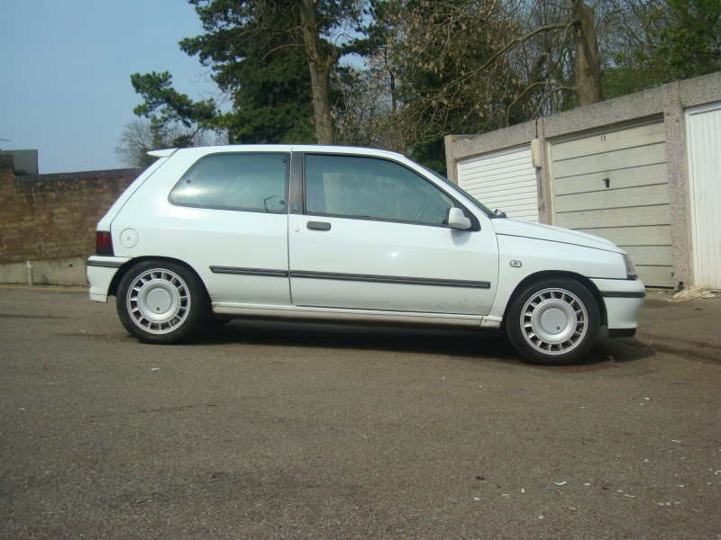

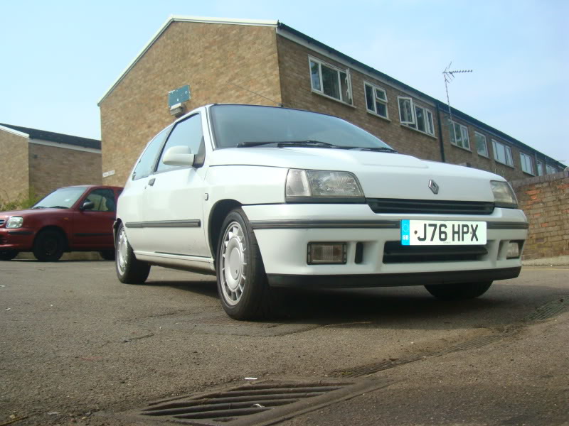

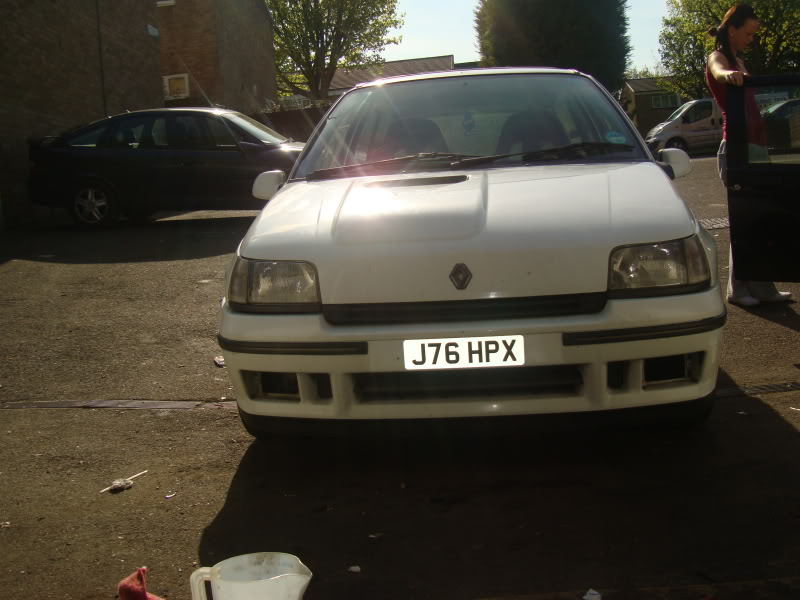

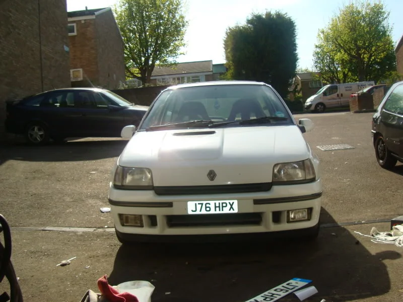

Right yeasterday i picked up a white valver for £850, a good price i think, the engine and box are mint, 4th mount powerflex dog bone, stainless heat sheet, others bits e.t.c.

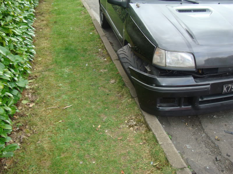

I finished work and met the scrap man who took my car away

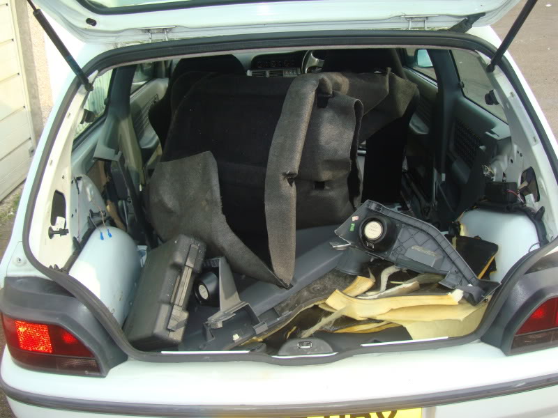

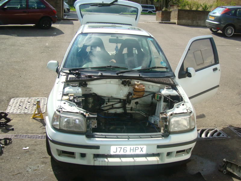

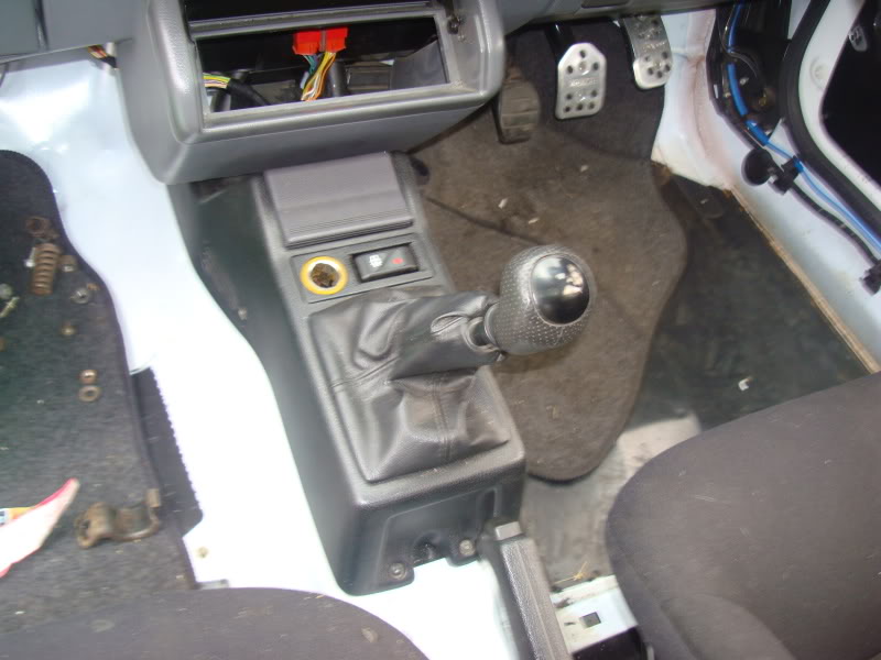

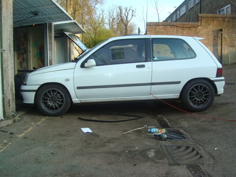

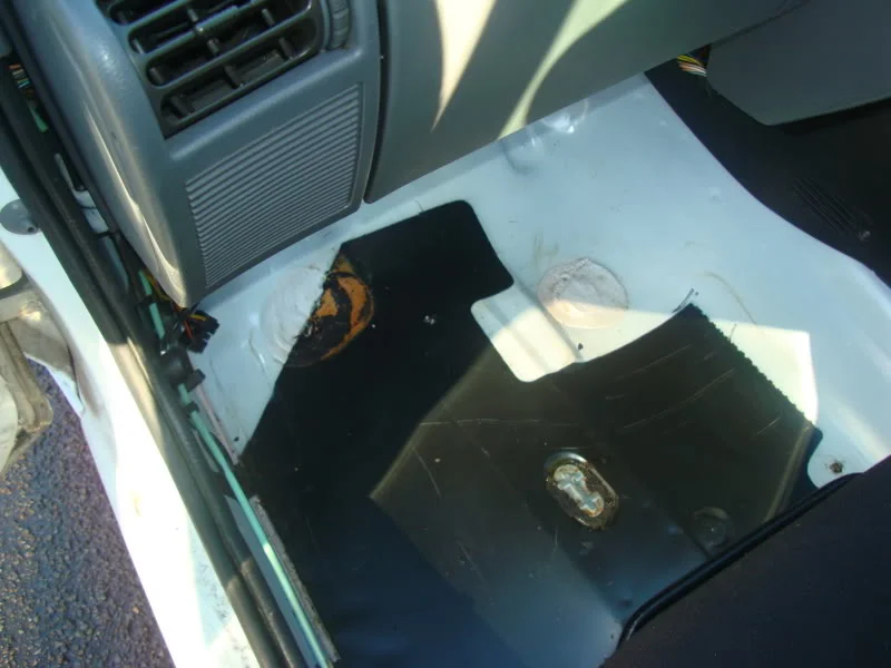

Today i stripped alot off the interior out, my heat gun broke so i still have the tar to look forward to, i also need to swap the seat runners around as thier diffrent, i did also change the wheels as ive sold the turbines, i left the car like this (In the garage)
a selection off stuff ready to be thrown out

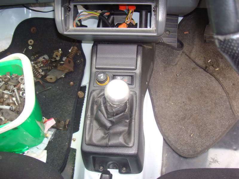

progress over the weekend, interiors almost done now, just need to change the steering wheel and lose the half working stereo.

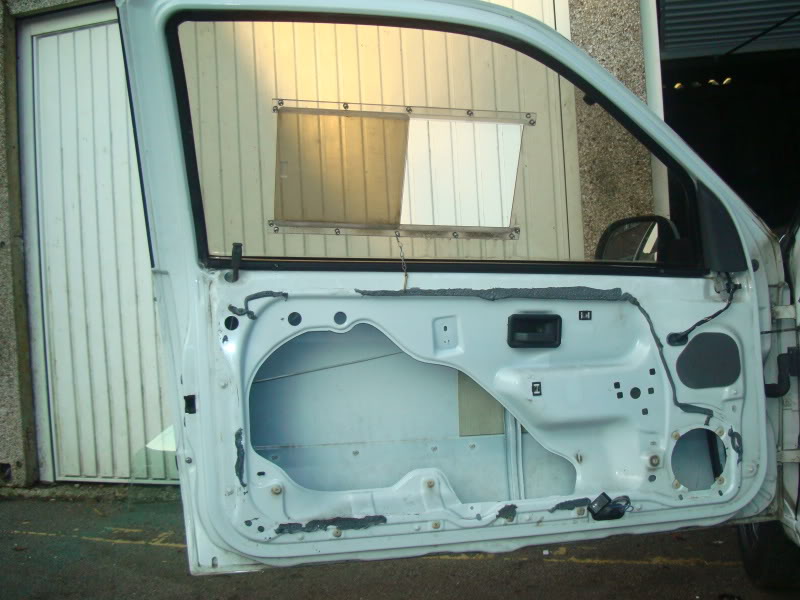

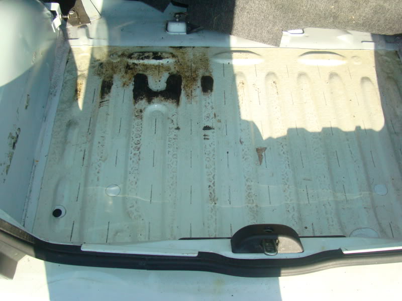

Tar

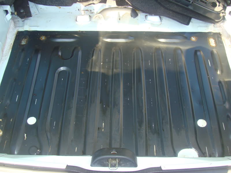

No Tar
Glass window removed, and the electric motor systems

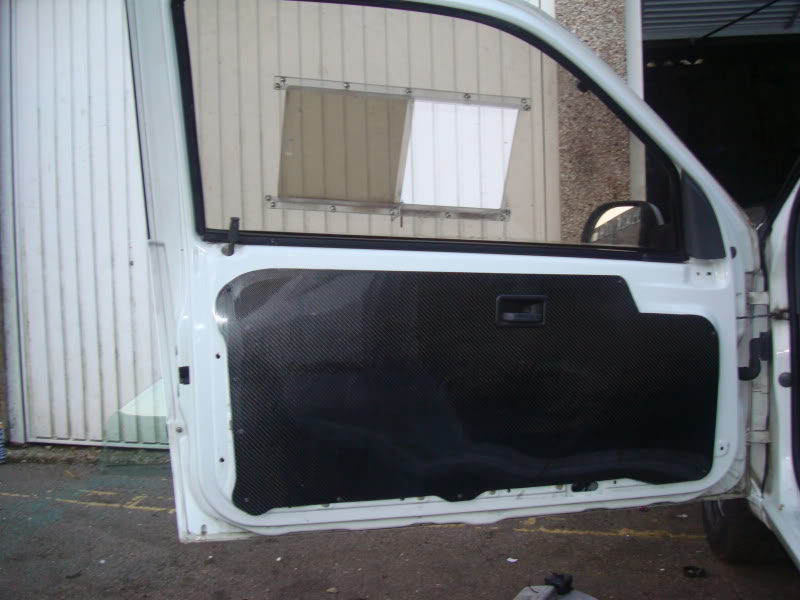

Carbon door cards on!

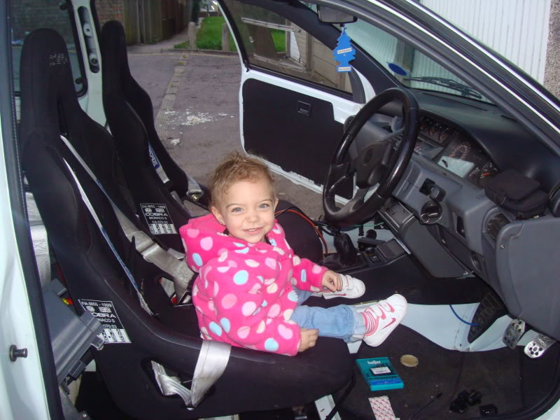

Then my niece came out to help
Broom Broom!

Change the steering wheel
remove stereo
fix in the harnessess properly

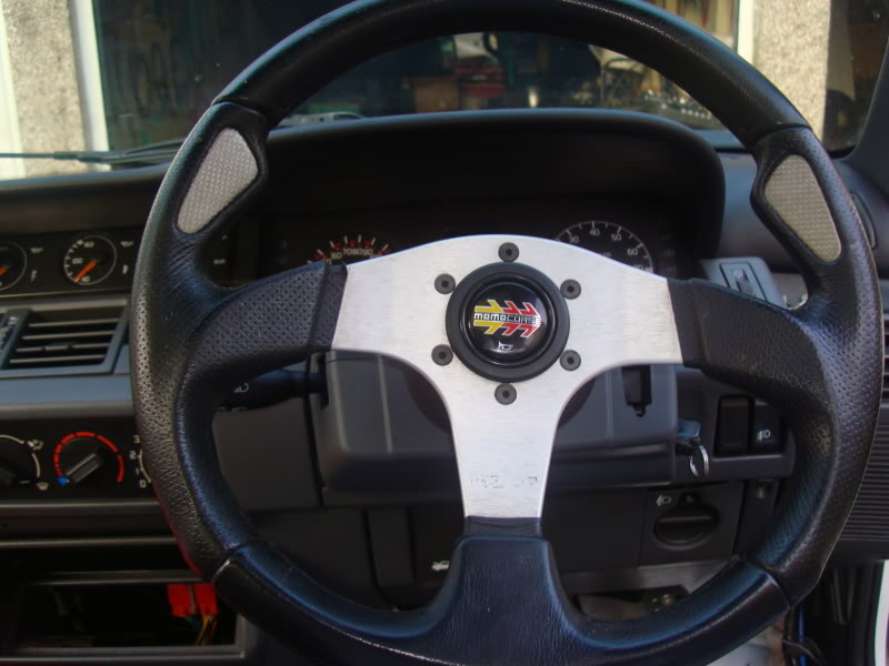

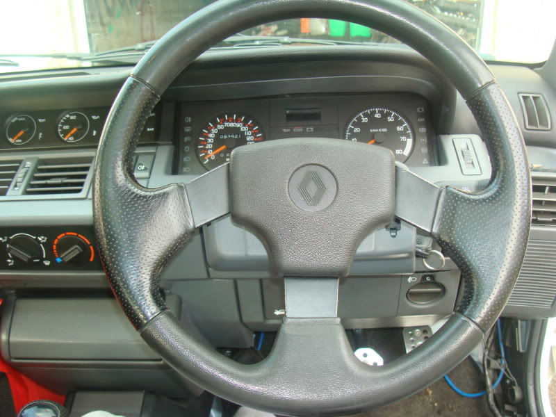

steering wheel changed

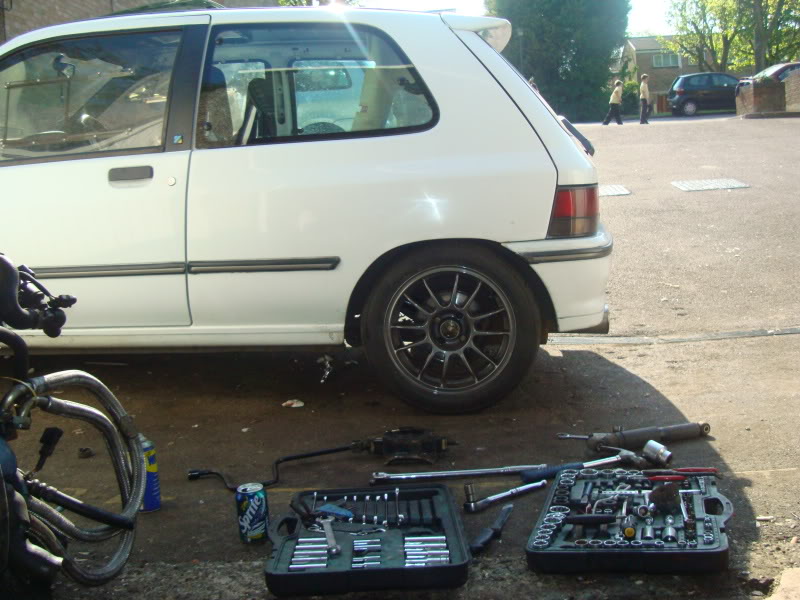

I changed the rea shocks to the avos from my coilover set and lowered the rear, i havnt done the front yet as im waiting for my friend to put the polybush's in my new wishbones.

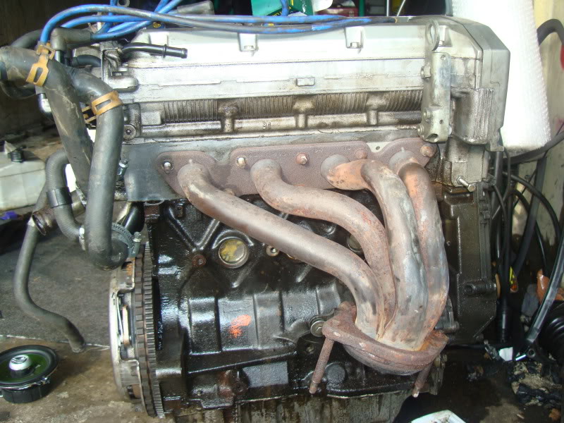

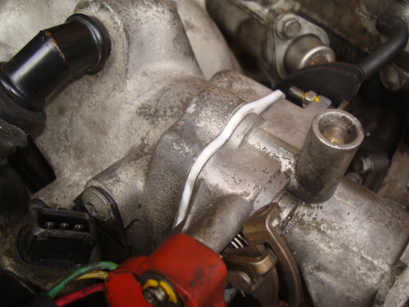

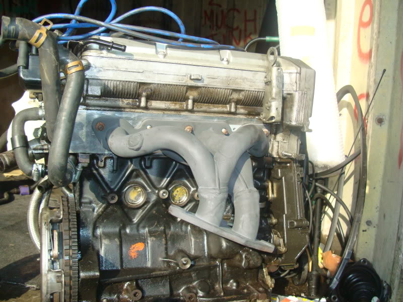

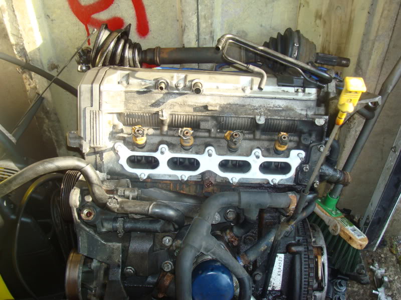

Then i stripped the manifold off the 2.0 so i could put the ptfe gaskets on
Then of course i bolted it all back together also adding the tb ptfe gasket.

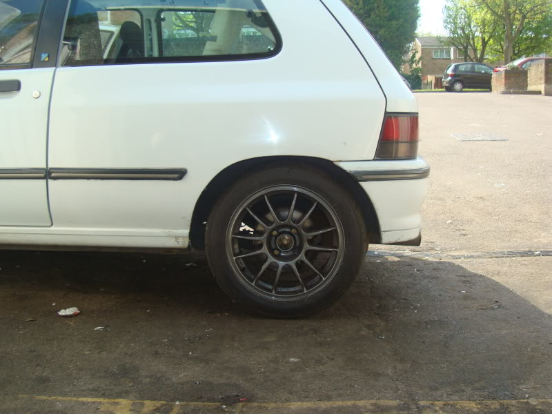

They are fresh ones, turbines are to heavy for me! and they dont provide any cool air to the breaks (wilwoods to go on)
i used petrol, the windows cant be opened as thier locked from the inside using a split pin.

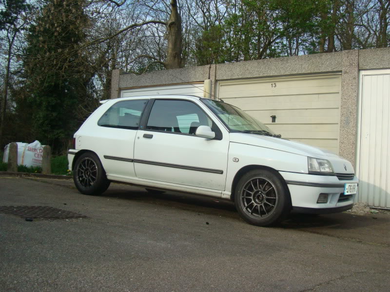

Todays work/progress -
I finished work got changed then went straight to pick this up

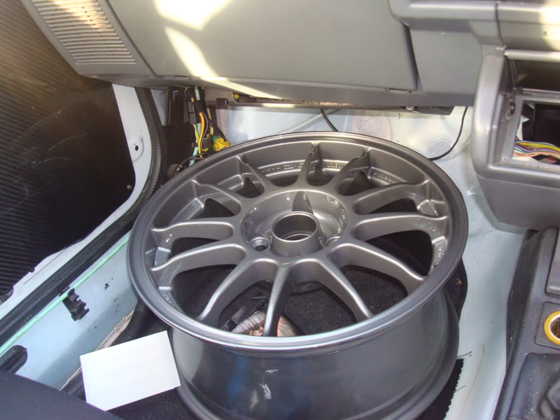

Newly powdercoated wheel

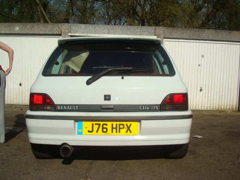

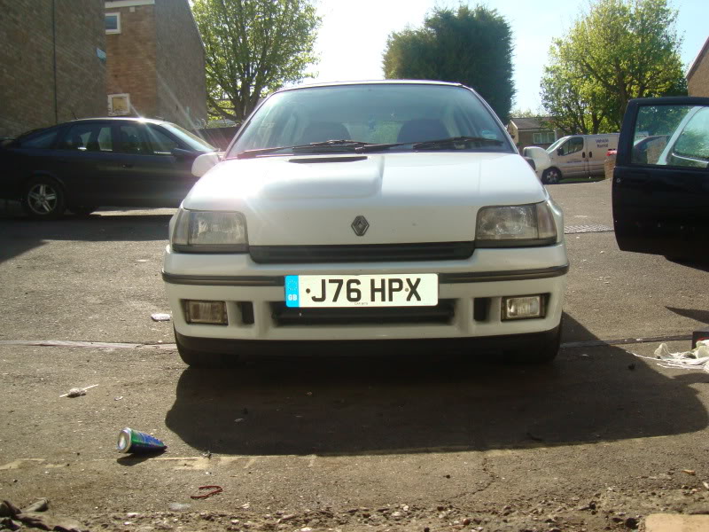

Then when i got back i changed the plates over, i ordered some new ones as i didnt like the gb thing on the old ones
Then removed the fogs

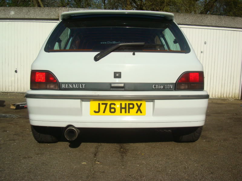

rear

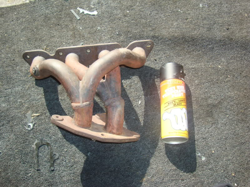

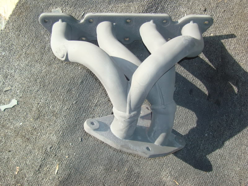

I then got out my megane manifold (modifed to fit on the clio) and painted it in uht

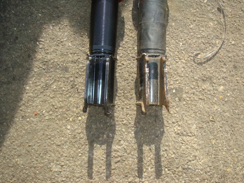

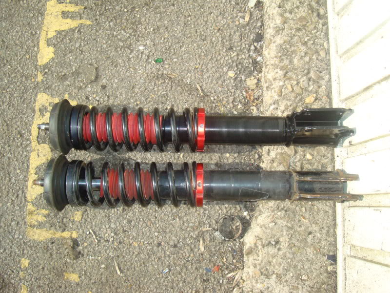

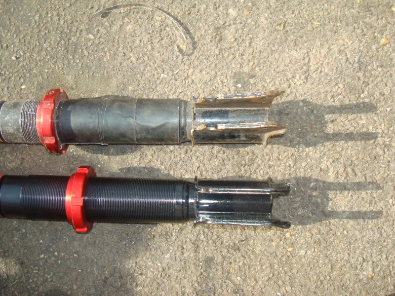

my replacement coilover had also come, heres a couple of pics off the new vs old (yes that is duck tape on the thread, to stop them getting ruined!)
Then i set it to the same setting as the one that isnt fucked, saves me doing it when i put the widetrack all on

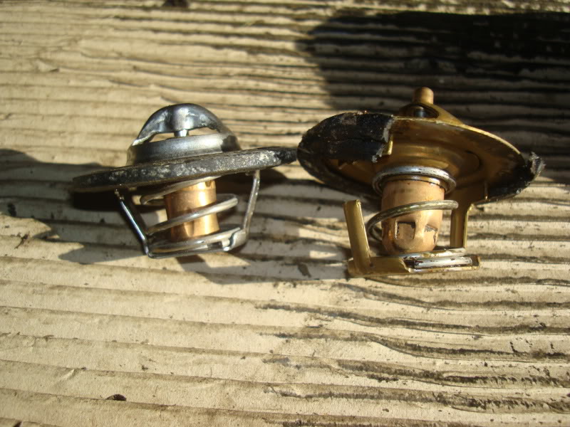

I removed the thermostat from my engine and replaced it with a low temp one i got from Matt Brown, my old one was a bit ruined!

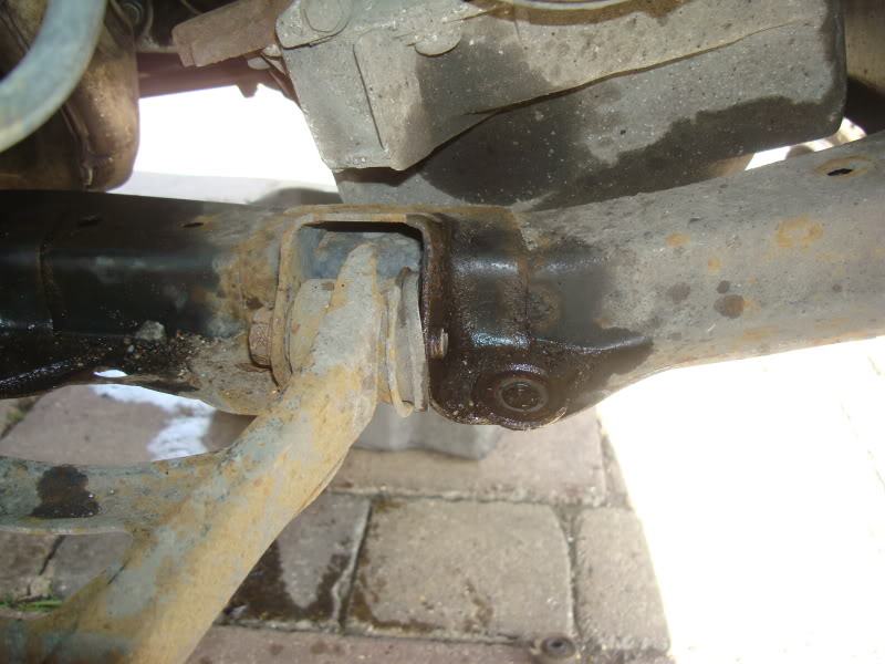

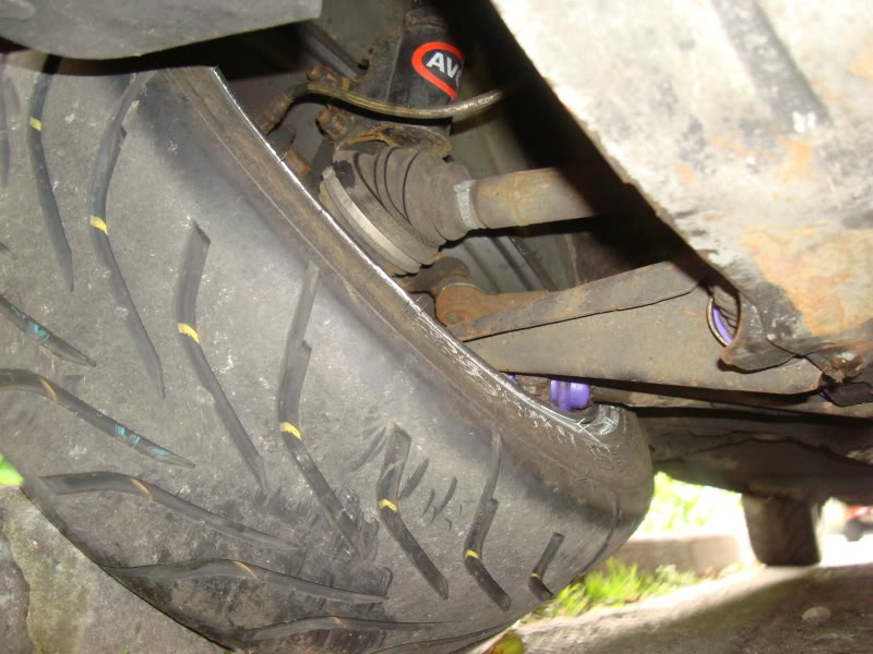

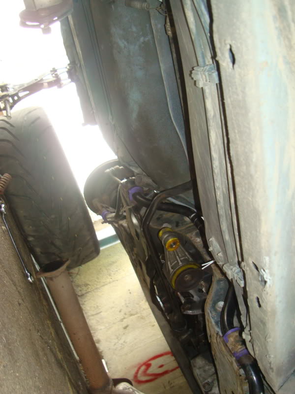

Right my wishbones were finaly ready on sunday so i fitted the wide track, didnt take many pictures as i was just getting on with it, fitting this lot is a real pain, especialy the arb, i changed the inner arms to the williams ones as i didnt want the track rod ends almost falling out (they sit in on about 3-5 threads if you dont change the inner arms)
PAIN IN THE ASS

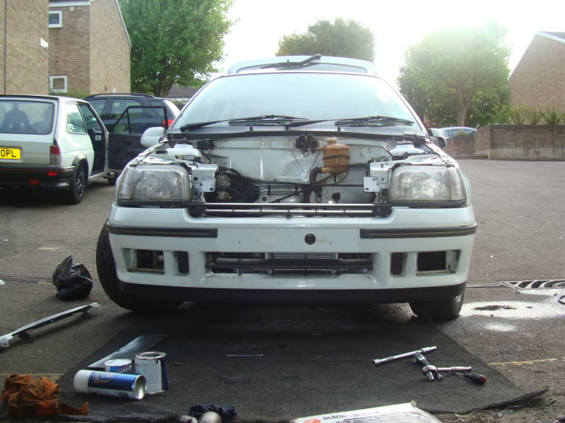

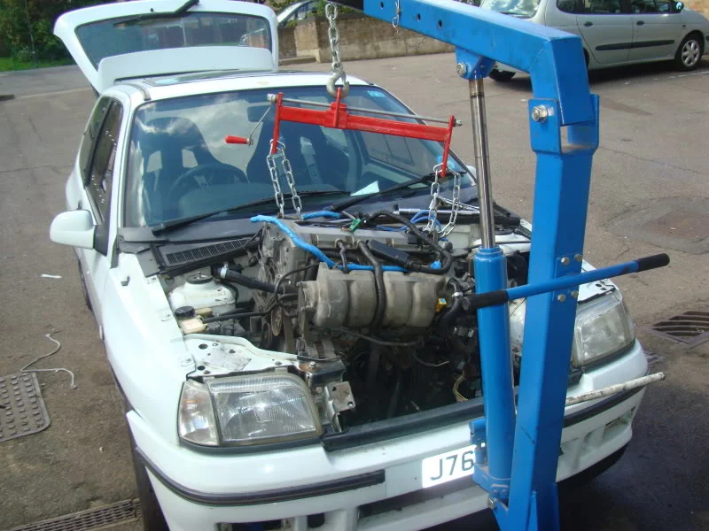

and removed a load off stuff from the engine bay, the engine is ready to lift now, rad, clutch and throttle cable disconected, loom unplugged, ecu unplugged, pas disconected e.t.c e.t.c
Tommorrow i will lift the engine out and clean up the bay, im dropping the engine off for new lifters to so hopefully ill get it back thursday

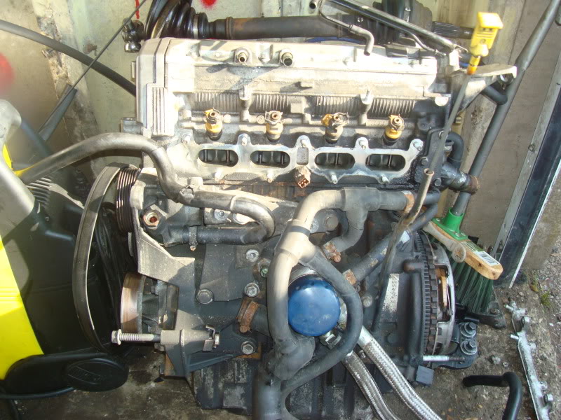

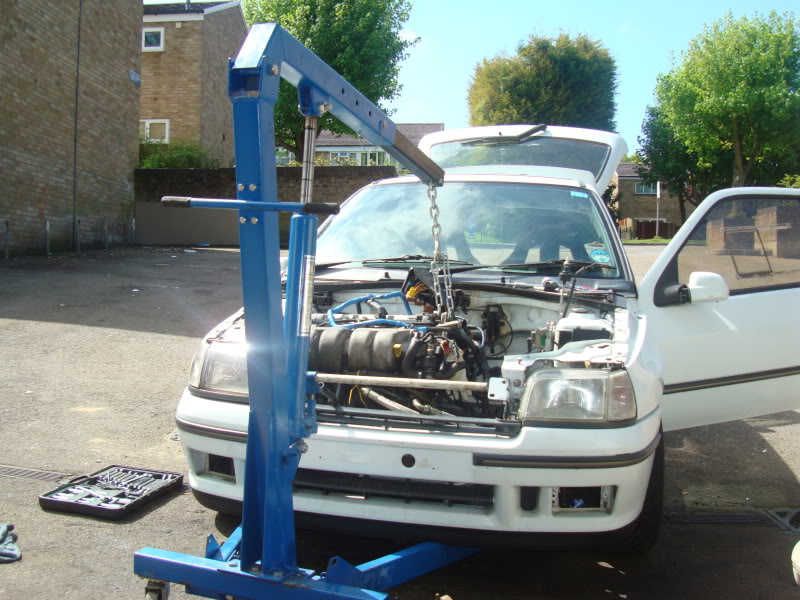

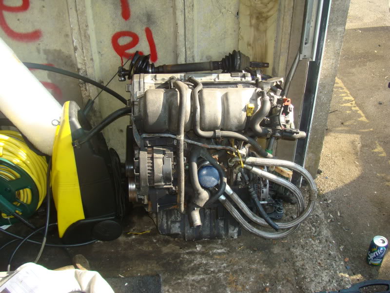

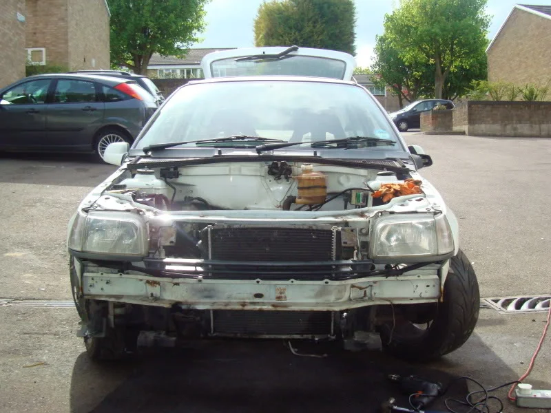

today i dropped my engine off for the new lifters to be fitted and took my engine out
load leveler makes it a million times easier

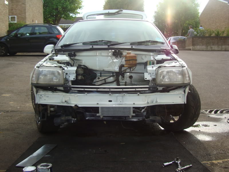

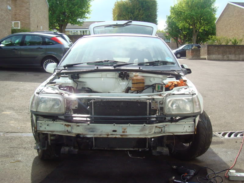

yesterday (thursday) i fitted the oil cooler and anywhere in/around the engine bay that had a hint off rust got abused with hammerite! started by removing the bumper and fitting the rad to check clearence
fitted and the grotty mess cleaned up
bumper back on

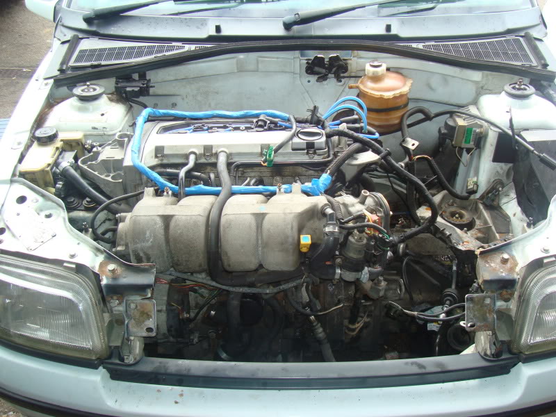

refitted almost everything, rad/pipes/battery/dowpipe e.t.c e.t.c
But as always there is stuff to do! i broke one off the fuel lines so i need to sort that out also need to fit the injectors properly and fit the driveshaft's (need to change one off the cv joints before being though) then with a bit of luck it will start up! though of course there is more to do, brakes wheel bearings,arch's,rear windows e.t.c e.t.c!
