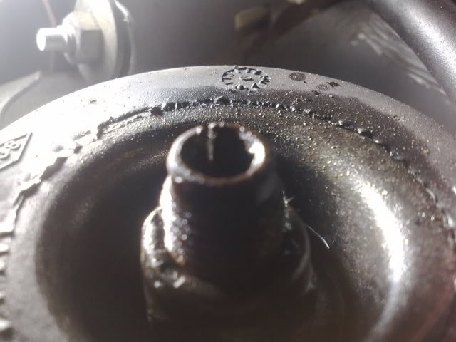

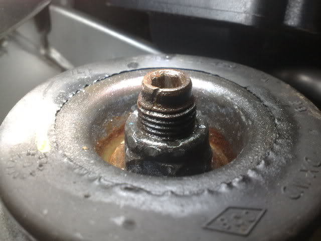

Meet my top mounts. The nuts have been way over tightened and the allen key holes are cracked/rounded.

Drivers side
Passenger side

Mole grips on the damper shaft and hope they hold? Failing that stilsons, not doing to do the dampers much good though.
Will give it another go when i'm not so stressed.
Either way i don't think the dampers are loving it.
"propa" impact gun ( 150+NM ) will have them off in no time, make sure the wheels are on the ground
I've got a 300NM air impact gun but am i hell as using that. It'll spin the damn car round lol
I've got a bigger one. I'll try and find it.
Will be fine ;), Just make sure the wheels are on the ground, should be off in 2 secs a side!
f**king hate getting rounded off bolts!!
a too regular occurrence on renaults though
try the big impact though ;)
Blow torch?
Know exactly how you feel though, just have to wait a day or two to cool down and get back on it. Good luck
Surely thats more of the monkeys fault who fitted them rather than the Clio itself?
