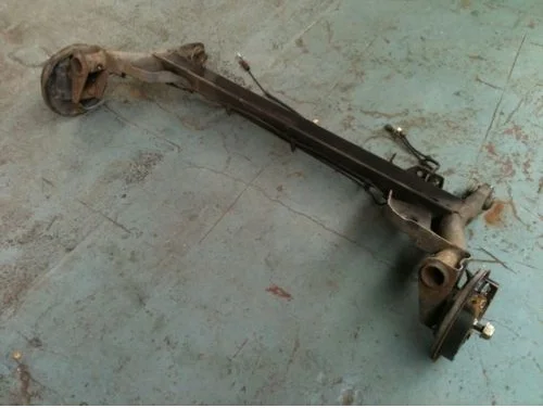

I'm not doubting that people are getting good results with this setup. However, can someone explain why you would put an additional trailing arm-link when the existing trailing arm setup has a bloody big steel beam linking the two arms?
Would it be worthwhile just welding something the existing trailing are link beam to increase the torsional stiffness?

The reason people do not weld something in the existing beam is because there's no way of knowing (without making a large amount of calculations) how much stiffer the beam will get. If you go too far and it becomes too stiff then you have a problem.
Also, different people prefer their cars to feel different. With the adjustable rear anti roll bar you can have more or less understeer depending on which mounting hole you choose.

Makes sense to have the adjustability; although I'm sure 80% of the people just have them set on the softest settings.
Perhaps. Personally I use 2nd softest at the Ring but harder at other tracks where there's more run off.
