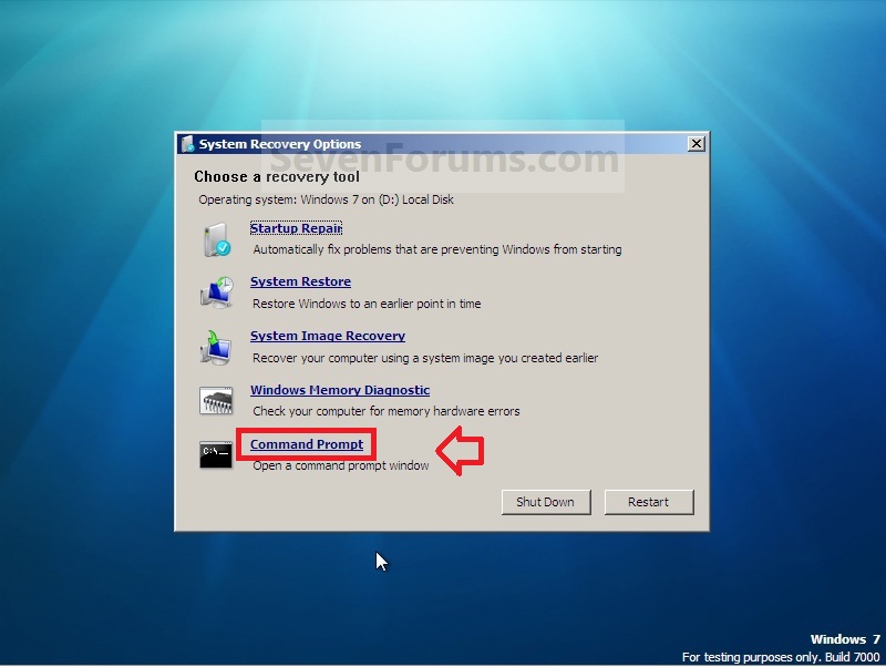

Do you ever see this screen?
Nah mate that never showed up, it just loaded and went to a black screen, and hanged there...
Cheers
I think you need to go into the bios and tell it to boot from disk, it's still trying to boot up windows from the hdd as normal otherwise.
Cheers
If you don't get that screen then you can't have done a Startup Repair. Startup Repair will do a Fixboot & FixMBR for you as part of the process. Agreed that you need to ensure that you are booting from the DVD. do you get the option to press a key (usually esc) to enter boot options?
